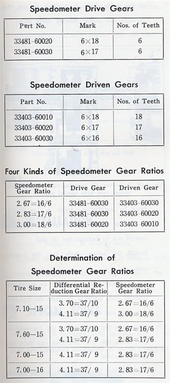

I know that toyota made various different speedo gears (that go into the insertion of the speedo cable into the transfer case): 16, 17, 18, 19tooth gears and a couple of different diameters of speedometer driven gears to mate with two different speedometer drive gears 6x18 and 6x17. So, figure out what you need: they are available from SOR and probably Toyota. These are the part numbers and the corresponding ratios. :D

IDave, You're the man. many moon ago I read some of this info on the LCML but never saw this table before.
With 33's on my 75, my speedo was off about the same as the above example. I put in the smaller 16 tooth driven gear. The speedo was now considerably more accurate as verified with a GPS. The problem was that the driven gear was slightly smaller in OD than the 17 it replaced so it lasted all but 30 minutes before the drive gear wore the top of the driven gear's plastic teeth off and then it would not engage. Moral to the story? Gotta do both the drive and driven gears together. I'll have to check their availability w/ CDan and report back.

Just for kicks and giggles, I've looked up the same stuff in a later Body and Chassis manual (unfortunately, they don't seem to have this info in the 1970s manuals, maybe someone could check for the 2F stuff.)
Anyway, in short, assuming a 4.11 diff gear ratio it appears you want a smaller gear ratio the larger the tire diameter (makes sense). I've listed the actual diameters (as best as I can determine from tables) in pencil to the left of the tire sizes from the table in the lower figure. They are recommending ratio of 3.0 for a 28 inch tire, and 2.83 for 29 to 30.8 inch tires. I would extrapolate and say that you'd want 2.67 for anything bigger, and beyond 33 or 34 you'll lose accuracy again.
Note the sidebar says you can only match 6x18 drive with 6x18 driven. But that would be for the 28 inch standard FJ40 tires most of our trucks came with (FJ45 lpbs came with 31 inch tires according to my owner's manual). In other words, for most bigger tires we need the 6x17 drive gear that didn't come with our truck as well as one of the fewer teeth driven gears.
I would match a 33403-60030 with a 33481-60030 for a ratio of 16/6 or 2.67 for 33 inch tires.
