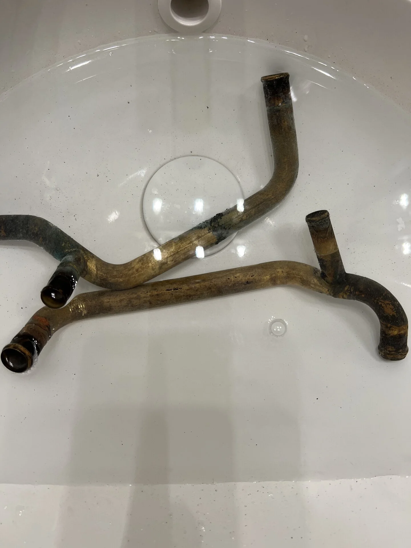

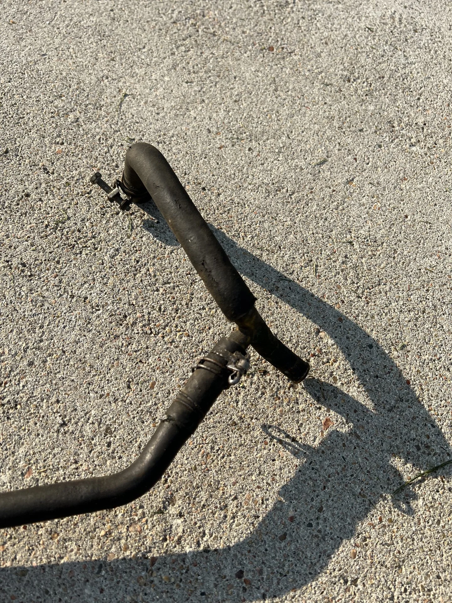

On deck - heater box and more lines - because it is nasty inside the pipes and the test pipe went well - Won't be a perfect refresh - thinking of AC down the line... maybe... the goal is move the ball down the field for a first down - else my OCD would just buy new everything I can, then refresh what I can't.

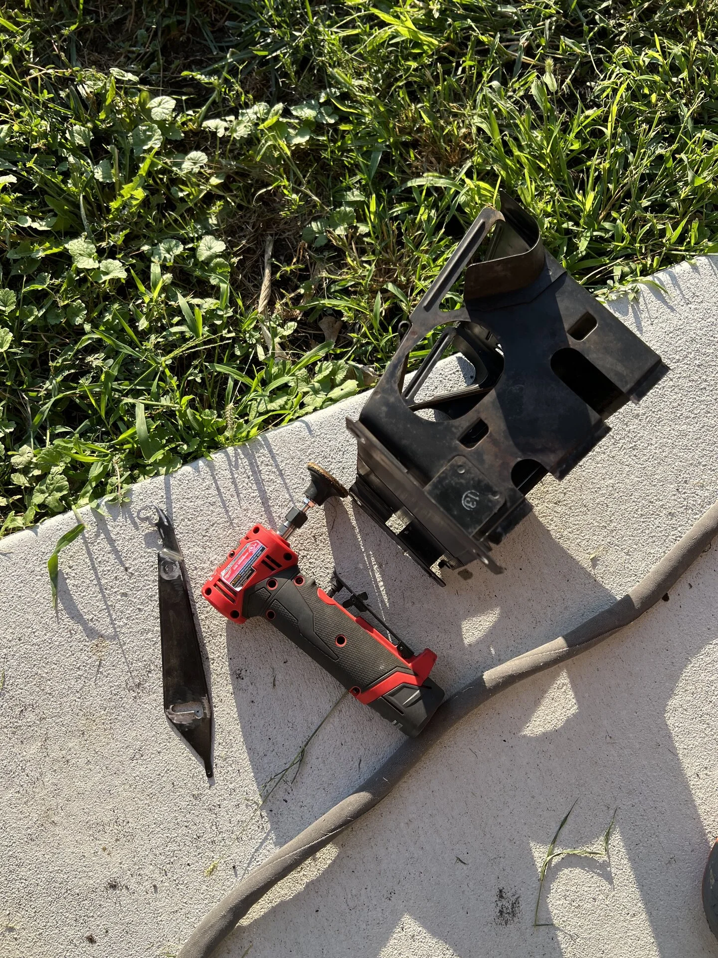

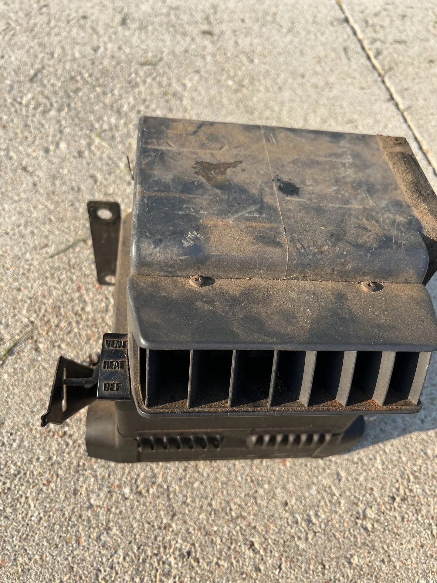

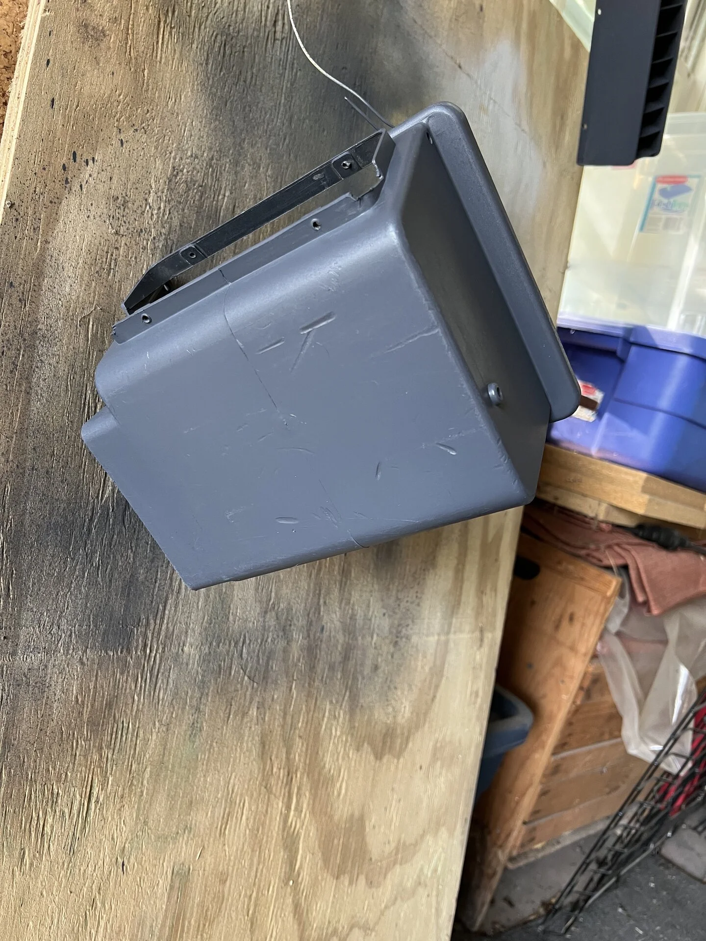

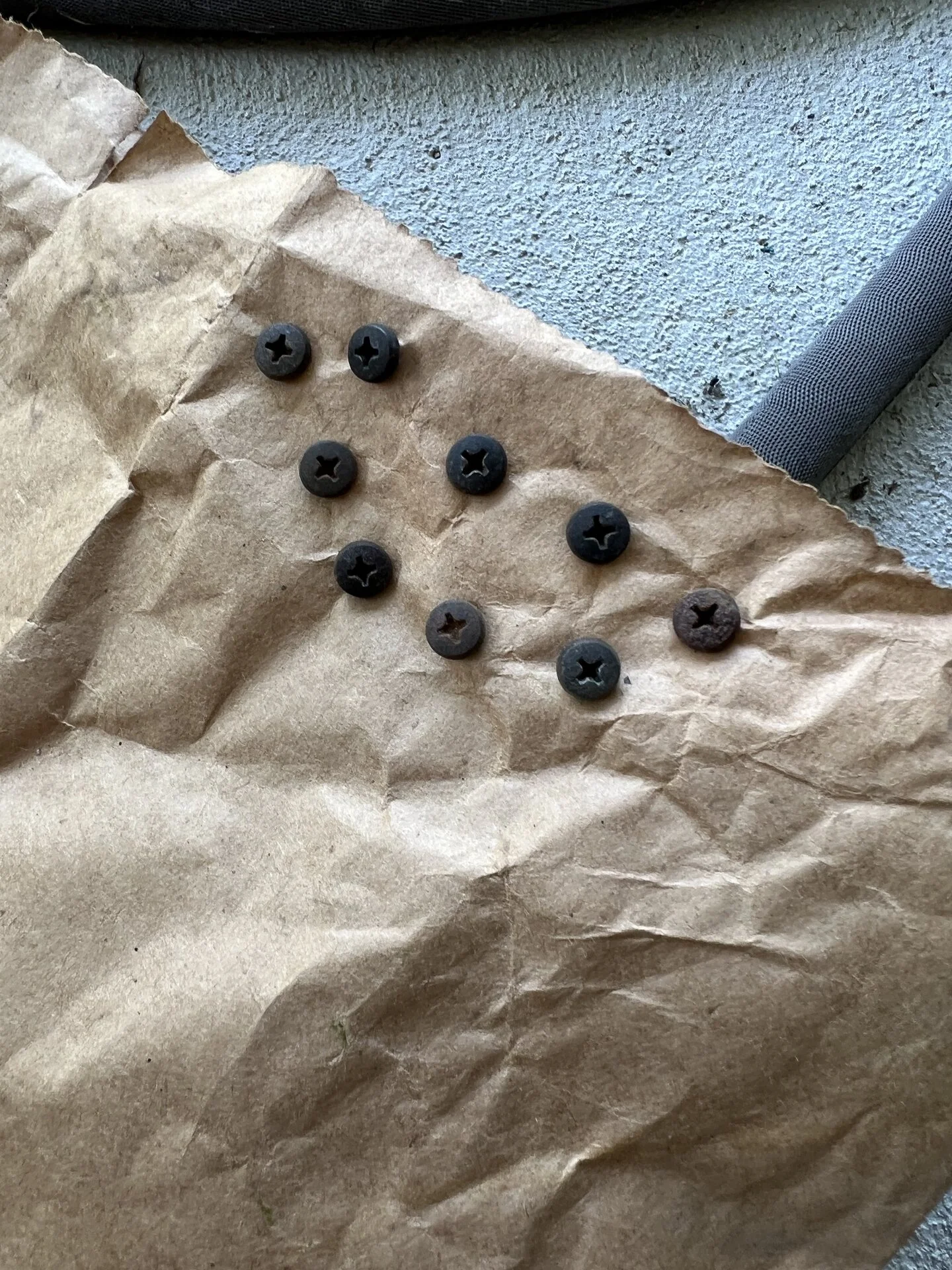

Basically today was speedy heater/water line refresh - the screws that hold the plastic top to the metal bottom were rusted - I called for for parts - all will be a week or more - I have til Sunday when I go back to KC to do some more work on it before the engine - Looks like engine starts 6 pm Tuesday and ready to stab and start Wednesday - good, Heading up to MN on Friday.
Anyway - decided to use Rust Converter that Nolan mentioned on his Patina thread - it turns the rust black - so double play in my book.

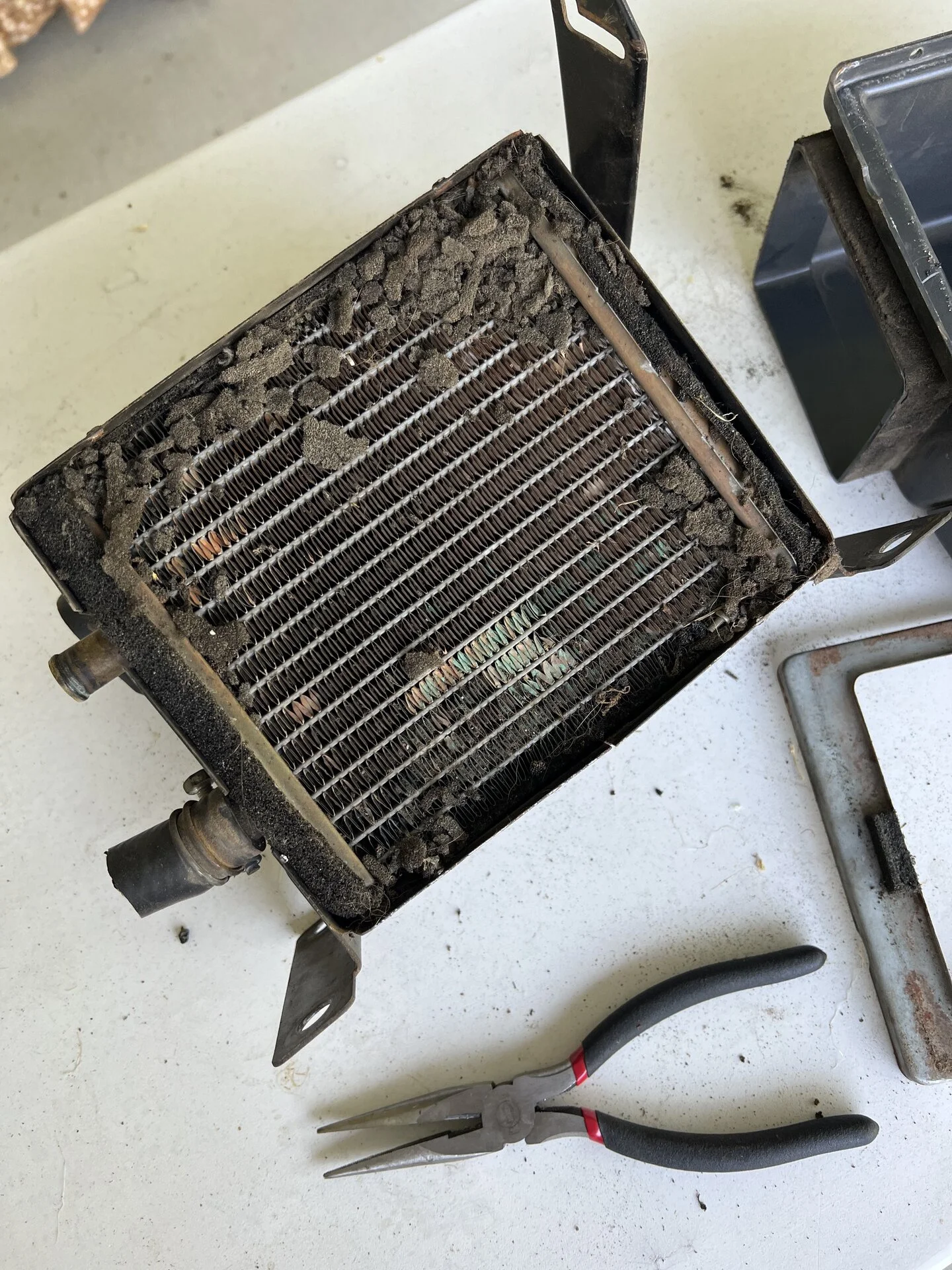

Took rest apart - kind of a general mess - flushed out the heater core - I feel like an automotive cardiologist - I think Yellr got a double bypass with cleaning the pipes and heater core.
I didn't get a before paint picture. The plastic top is more of a grey - The roll bars and seat backs are a grey to - I think in 79 they started using it vs black.
Tons of scratches etc and fading. Darn I really though I got a photo before the first coat. Away - grabbed this - close enough for a rush job - consistency is credibility as I like to say.
Used 320 sand paper, prepsol then got 2 coats on - will do two more light coats tomorrow. Did a really good job.

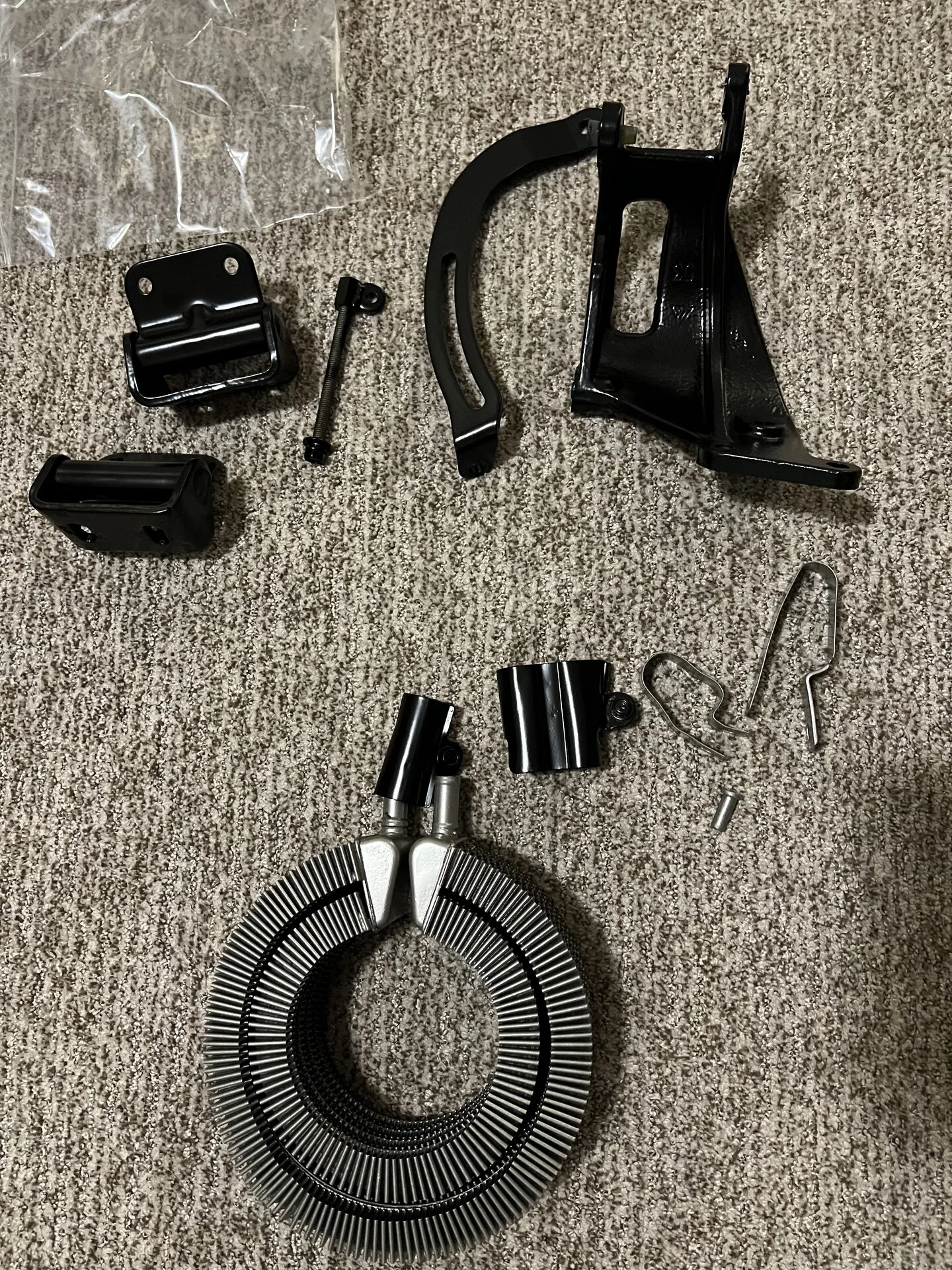

I did the hood support and got that back a week ago or whatever it was - and when I took it to KC to install, the pin holding it to the hood like like crap so yanked that and asked it to be a priority. Not in the close up are two grills (are in first pict) - one for Yellr and the other will ultimately be wall art when the bib get coated. I got an OEM badge for my grill. Love the rear water heater.

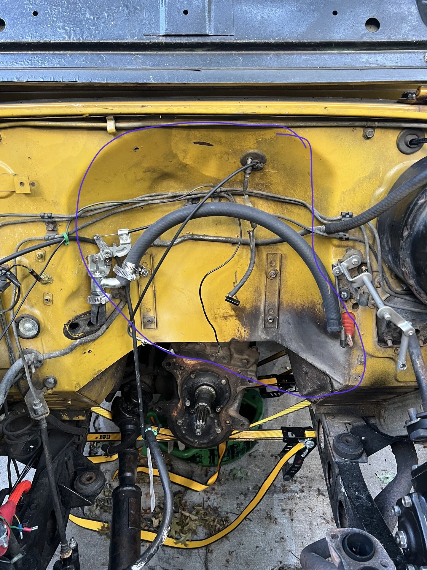

Cleaned the firewall too. Got that big spot on the firewall removed (lower right in the blue circle) ... I wasn't wearing gloves and I am pretty sure I got ride of my finger/hand prints too.

Heater box after 24 hr refresh - I'm missing a part - I didn't lose it; never had it and explains why I didn't think it was working right - It hold the shaft for the bottom flap in place. The to-do list keeps getting longer not shorter.

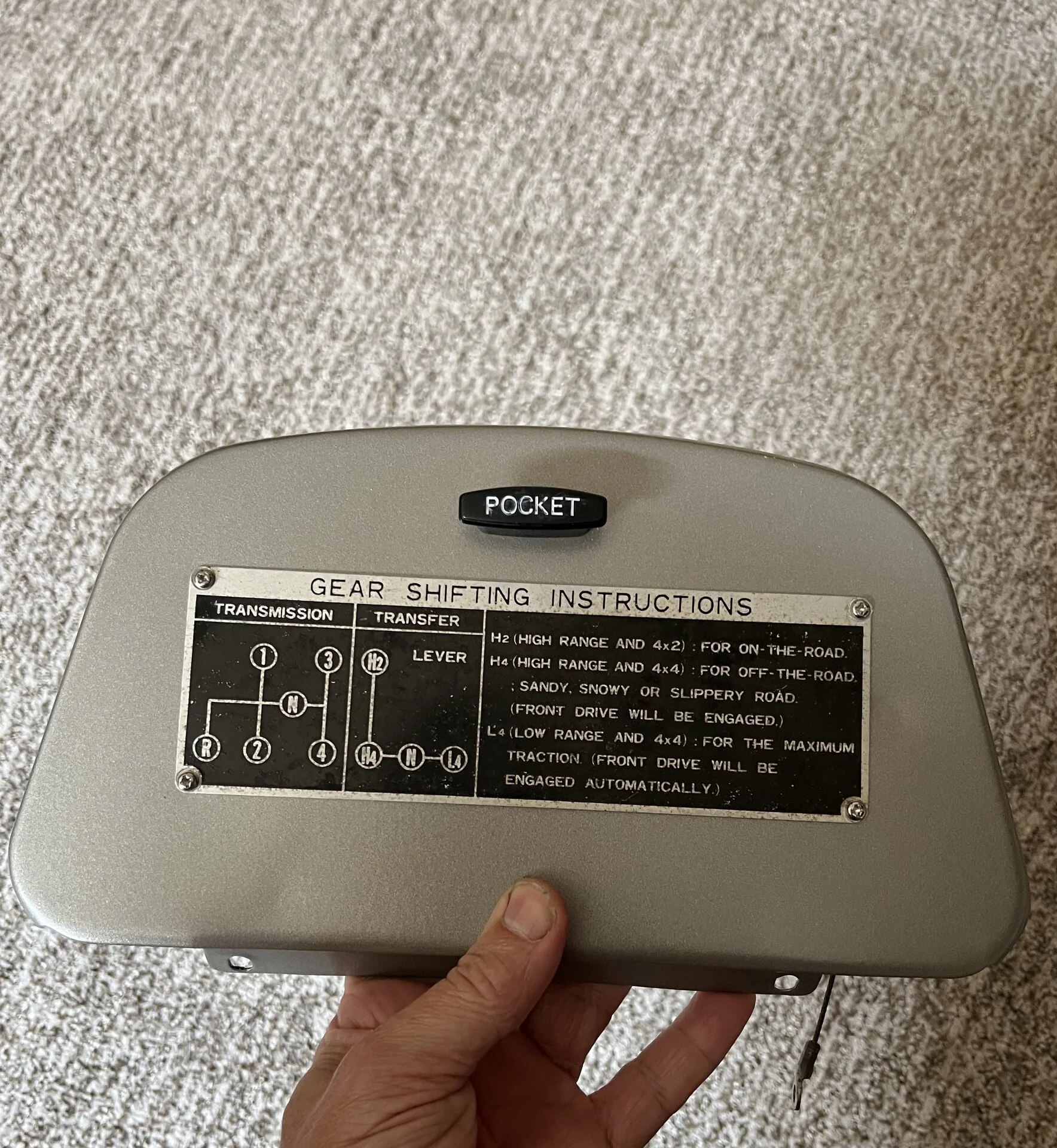

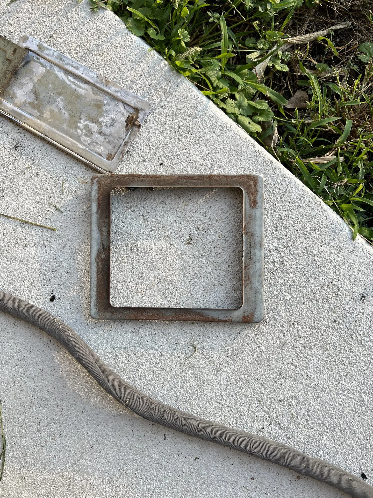

Got the shift plate back on the pocket door - I know rivets - this is the bandaid. Didn't repaint the Pocket handle, yet the powder coating on that, the meter plate, and ashtray frame turned out really nice.

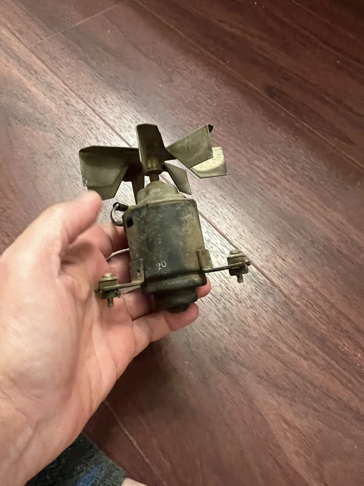

Finished cleaning the other heater pipes and installed new insulation - Also cleaned the rear heater motor/fan -

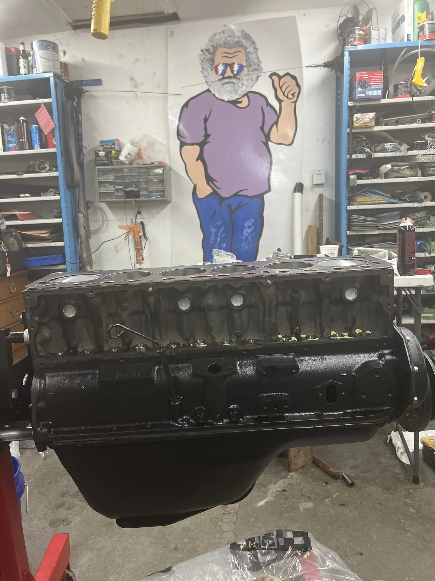

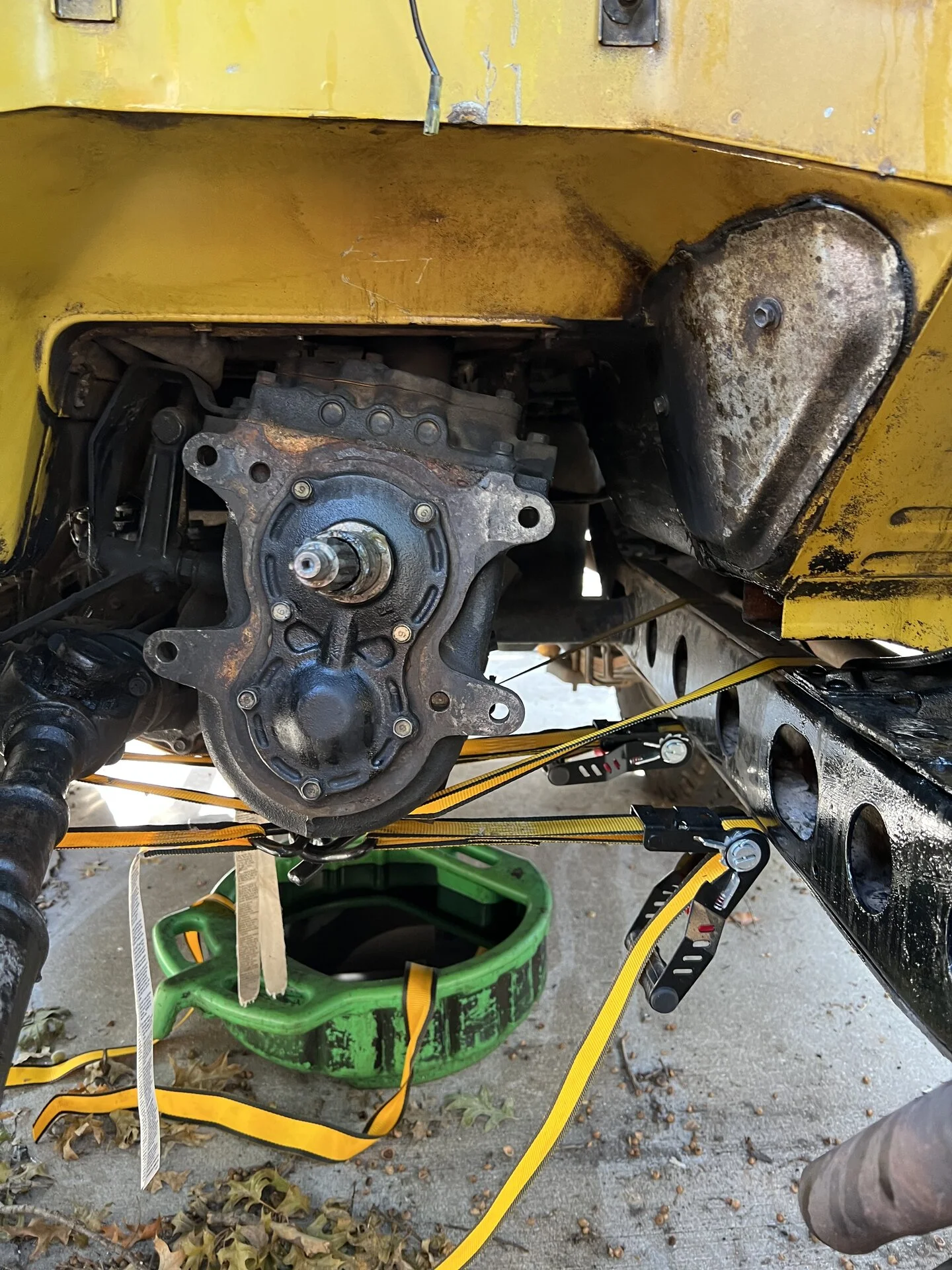

Some pictures from yesterday- did more cleaning around the transmission—

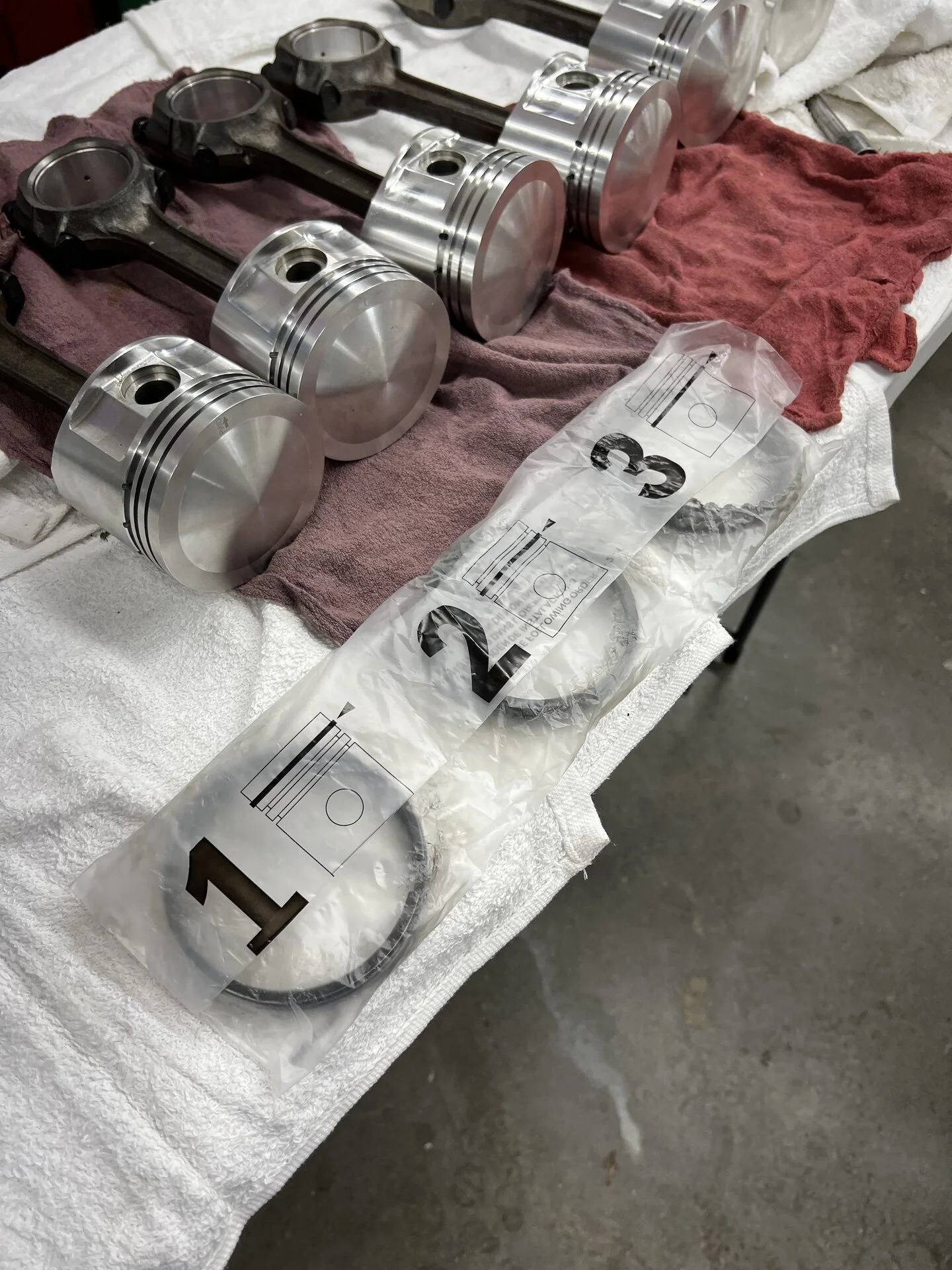

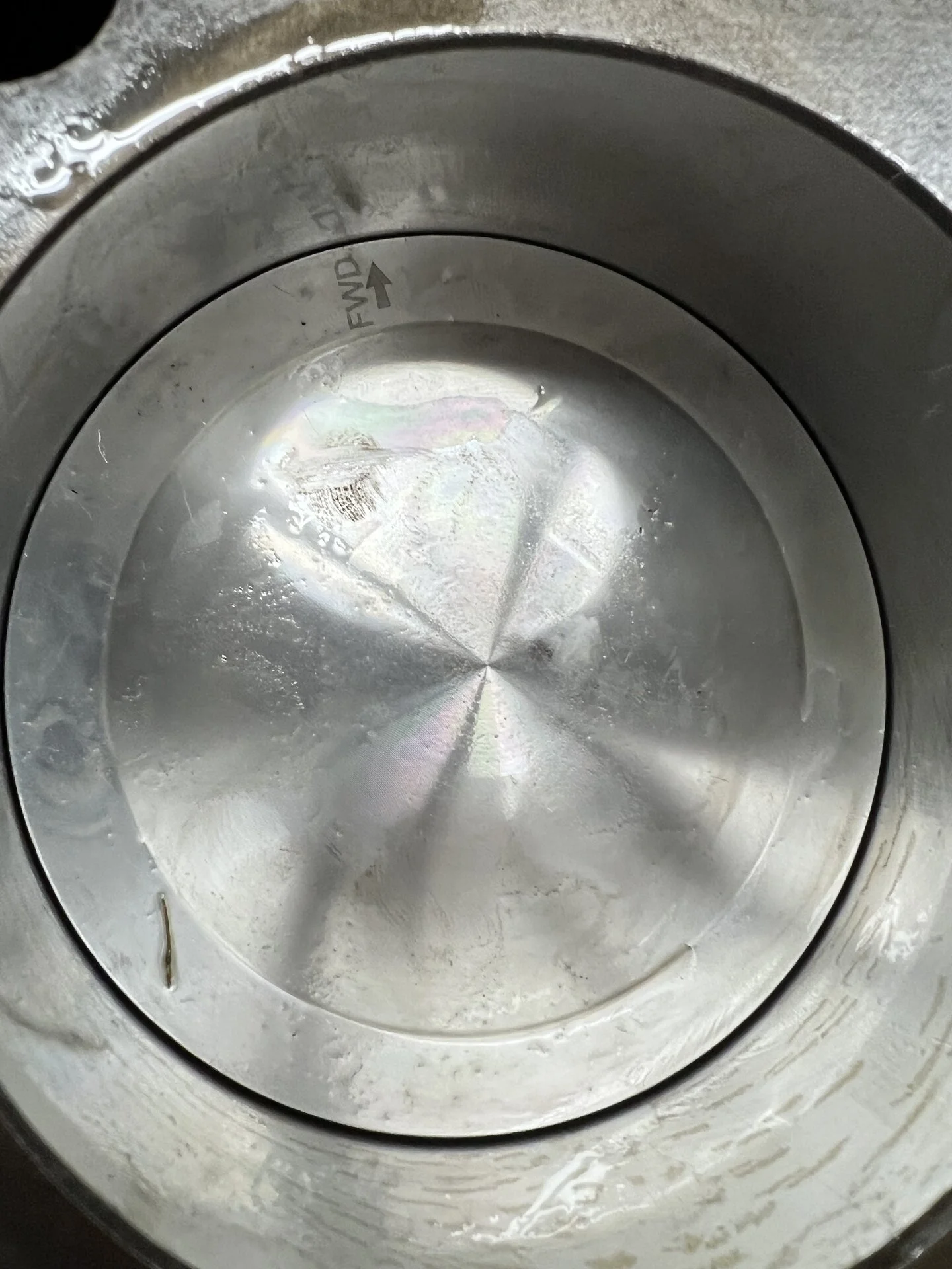

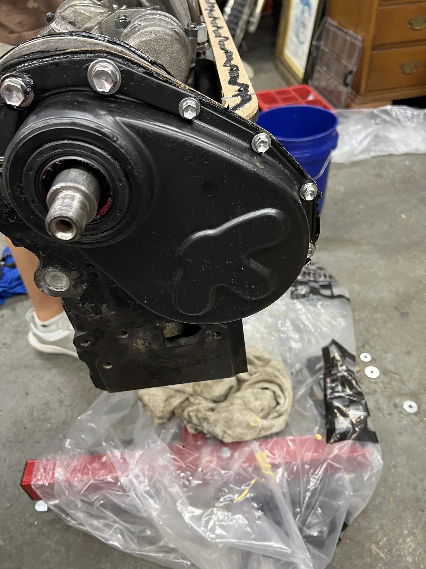

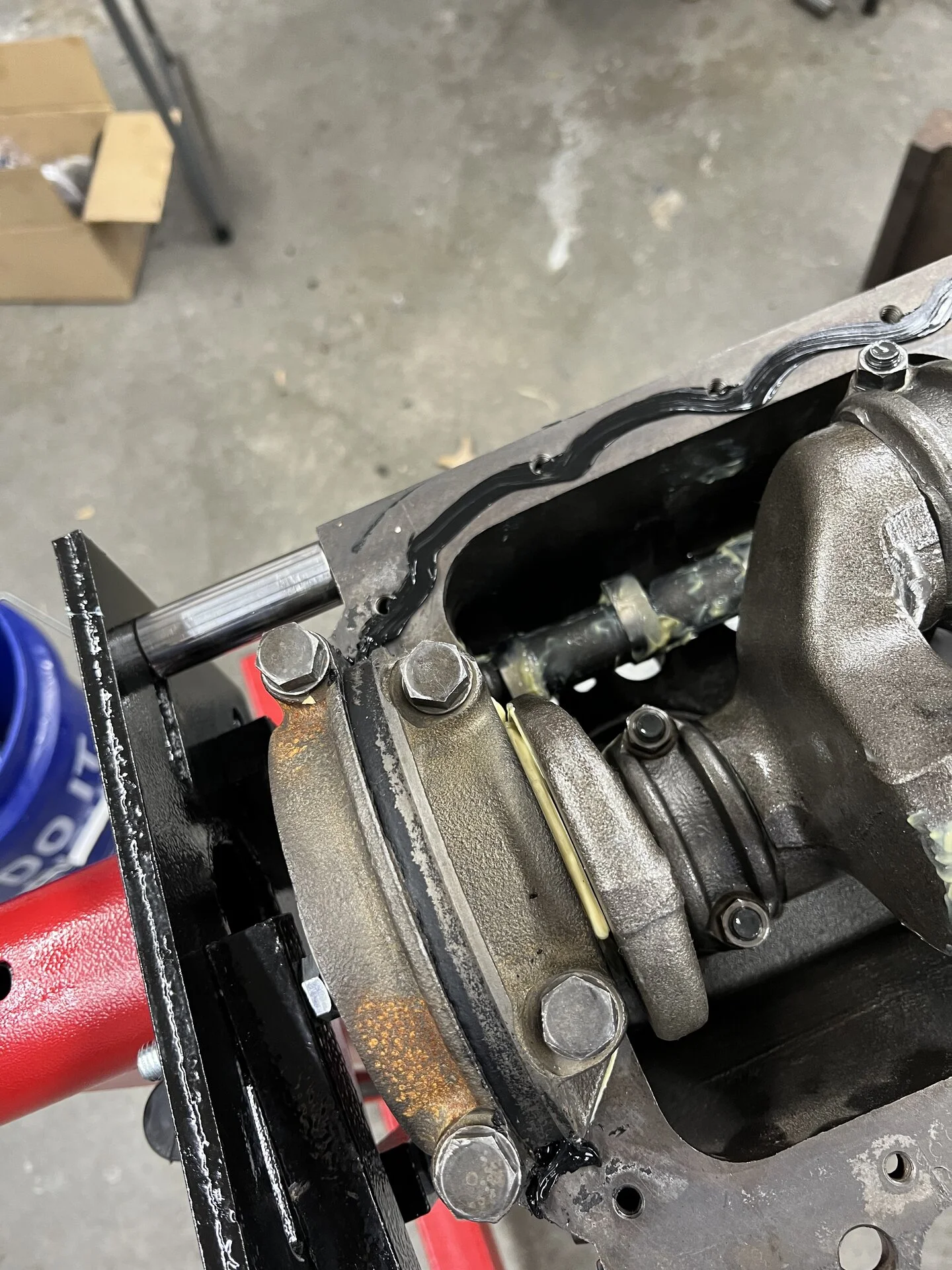

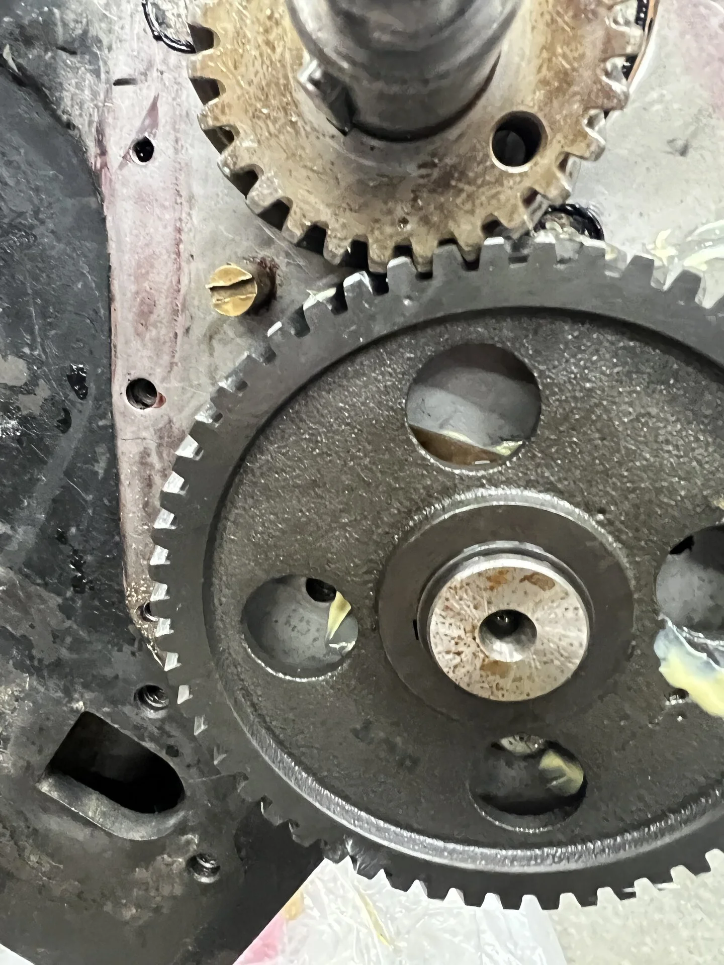

Picture of the old piston and various stages of construction- the rings took a while to get right … the bottom ring took patience.
Took a lot of pictures to record “did we make sure the markers lined up… etc)

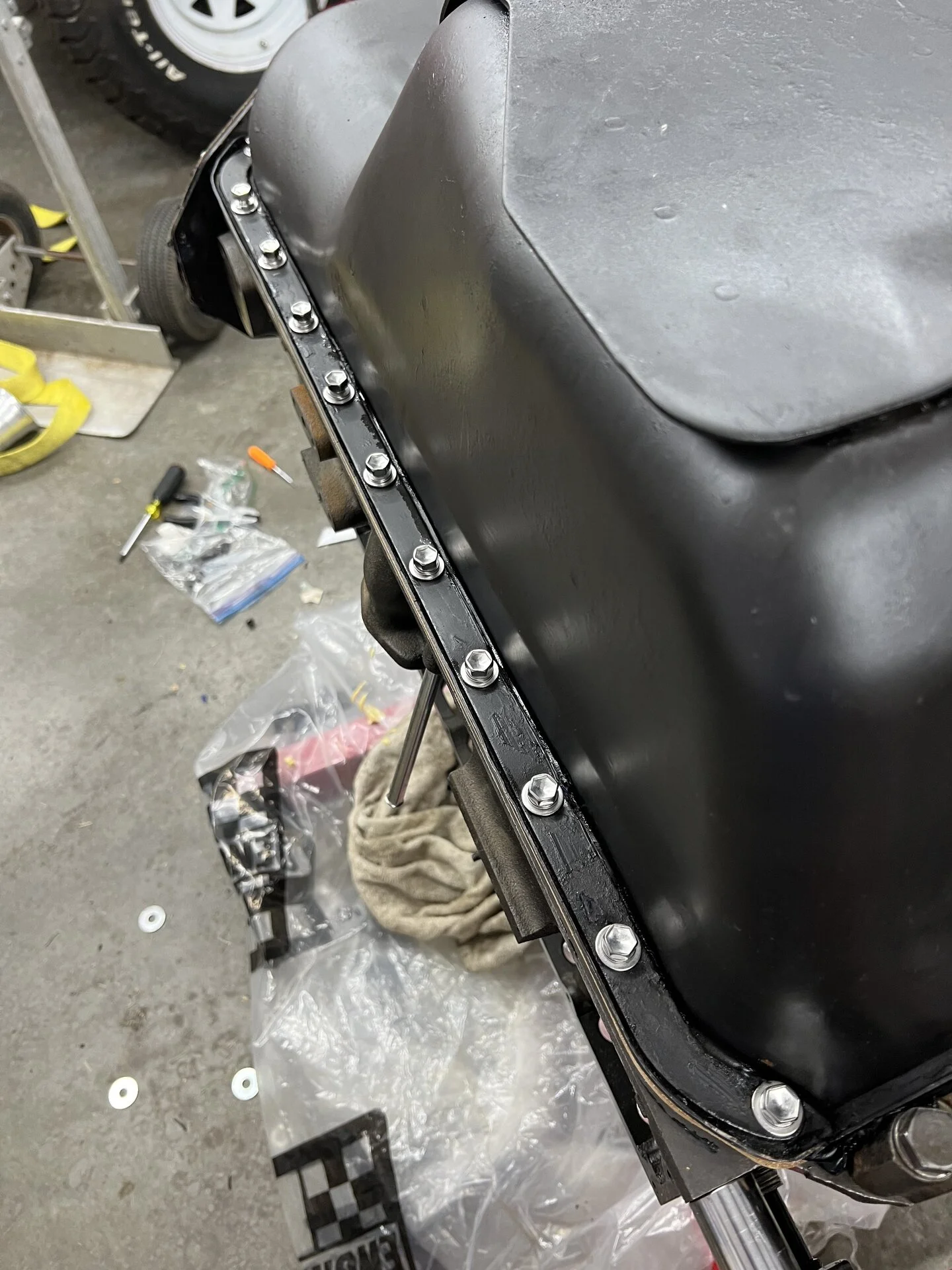

Me being inexperienced- didn’t realize what a gap and pain the oil pan is to get on.
With Jerry approval, we called it about 1:45 am.
