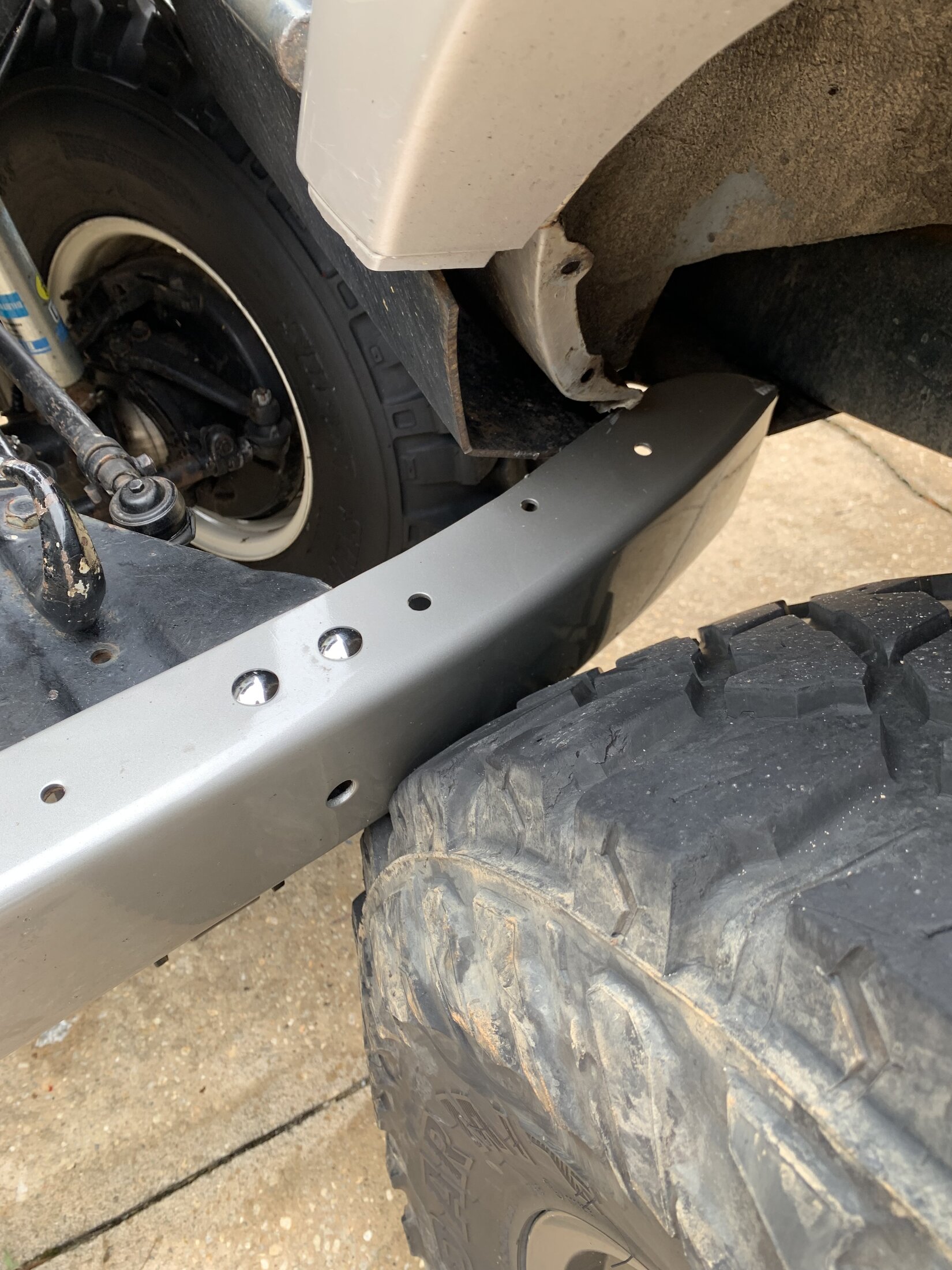

^This. Hell, I wrecked mine into my 80 in my own damn driveway… And I wasn’t even driving it!
And look at the conundrum. Stuck together. HOWINTHEHELL?! Had to release all air from tire and remove it and then remove bumper to separate.

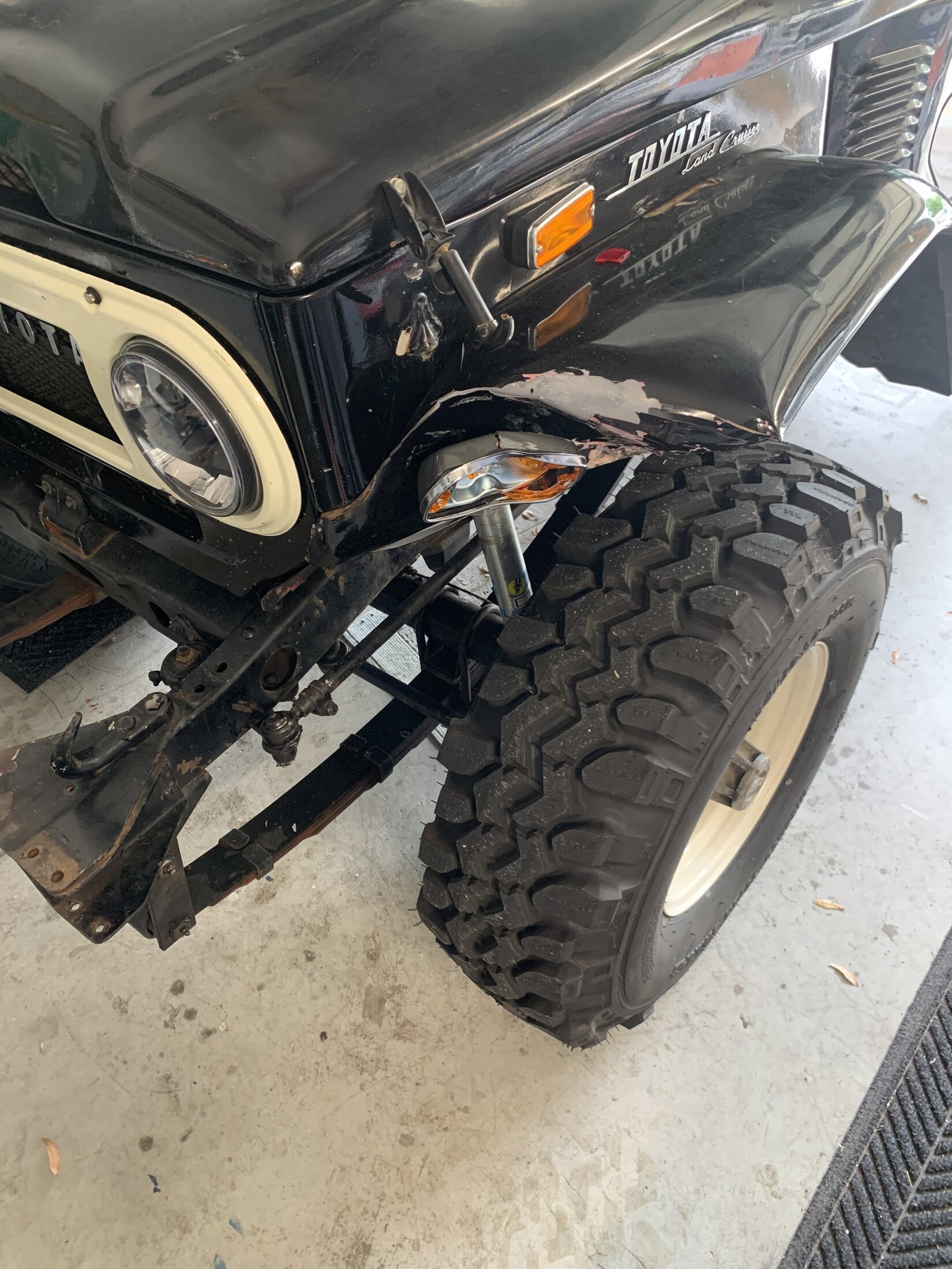

And funny enough, I got the temp repair fender from @OlYellr 😁 It was even black!
It could have been a lot worse. Fender bits and running board might get you back? Sucks to just see it all. You had it dialed in and ready for SAS.
Holy smokes! I thought that fender looked familiar!!! Well it lasted almost a year.

Nah, I put yours on due to that. 40 fenders are good to have spares of. Have a set of new OEM stashed for next time. Lol
