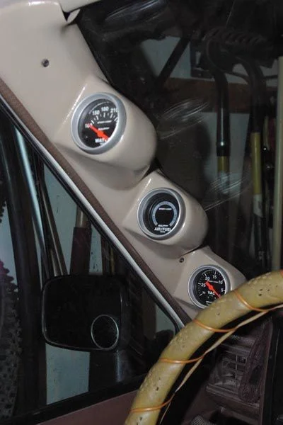

Dan, haven't you see my pillar gauge pod? Install one of those.
attachment.php

Pappy - is this the pillar pod that a guy wasmaking limited quantities of? Roughly $60 and has one, two, or three pods?
Looks nice!
Yes, Jeff Moskovitz is his name. I thought he only had 2 or 3 gauge pods. Doesn't matter since you should have no problem finding three gauges to stuff in there. Also, there was another company out there selling them, but I would rather do business with Jeff, Truckpillars.com.
