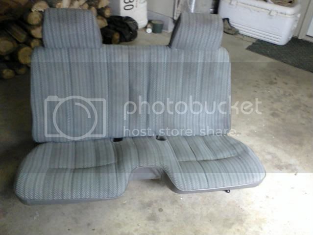

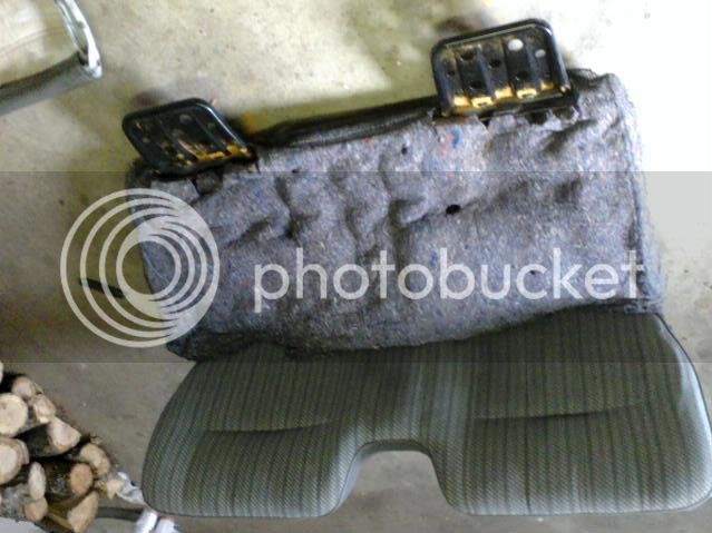

I did yank the seat out and replace the padding/foam as the original was almost totally gone.
I got a quote of $450 to do it at a professional shop. They were going to completely recover it also, but this seat was in good shape except for the foam so I decided to do it myself.
As it was when taken out

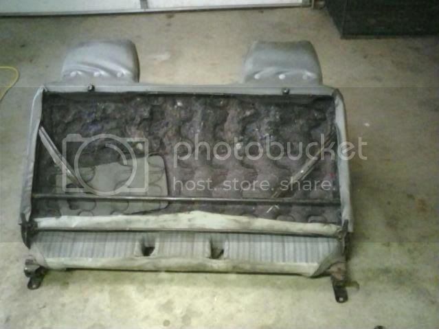

PO's attempts at fixing the problem.
Original padding that measured less than 1/2"

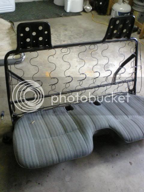

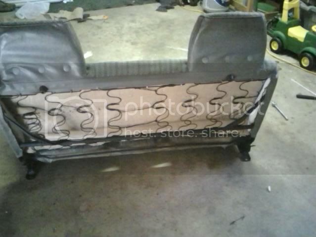

Hard to tell but two broken springs behind drivers back. I removed the center spring and replaced the main spring behind the back. Then used a portion of another broken spring to repair the second broken spring.

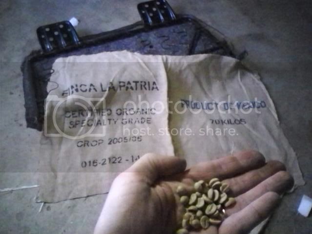

Local foam shop had some coffee burlap bags.
I got on a roll and forgot to take pics. I placed 2" foam over the burlap, then used the original seat cover.
I used the seat back padding under the molded polyurethane seat foam to give it some extra firmness also. I also placed burlap over the drivers side springs in in hopes it would firm things up also.
Over all it took about 3 hours. I'm very happy with it, and SAVED quite a bit of money. SO much better when your lower back does not hit the lower crossbar every little bump you roll over!
