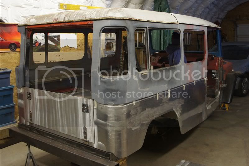

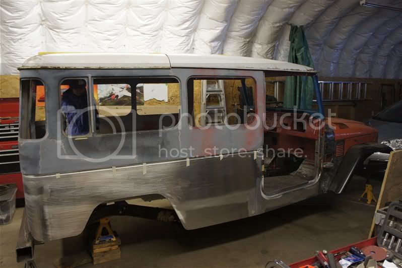

Well I got the the stretch on the hardtop sides done and the doors have been fitted and all I've got to do is finish welding the bottom of the doors and grind.
A buddy and I got the 2 hardtops out of storage last night and cut them up to fit on the stretched sides. Now I need clean off the glue from the inside, give the outside a quick pass with the orbital sander, seperate the steel from the fiberglass, weld up the steel frame, make sure the frame lines up with the sides, reattach the fiberglass to the frame, join the 2 fiberglass pieces and refinish the entire thing... sounds easy :rolleyes:
Here are a few pics of the first fitting of the roof.

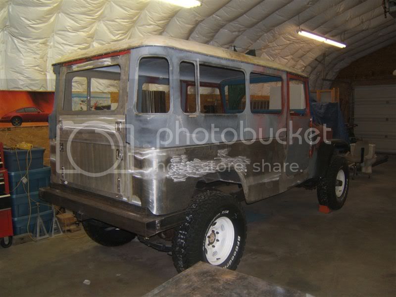

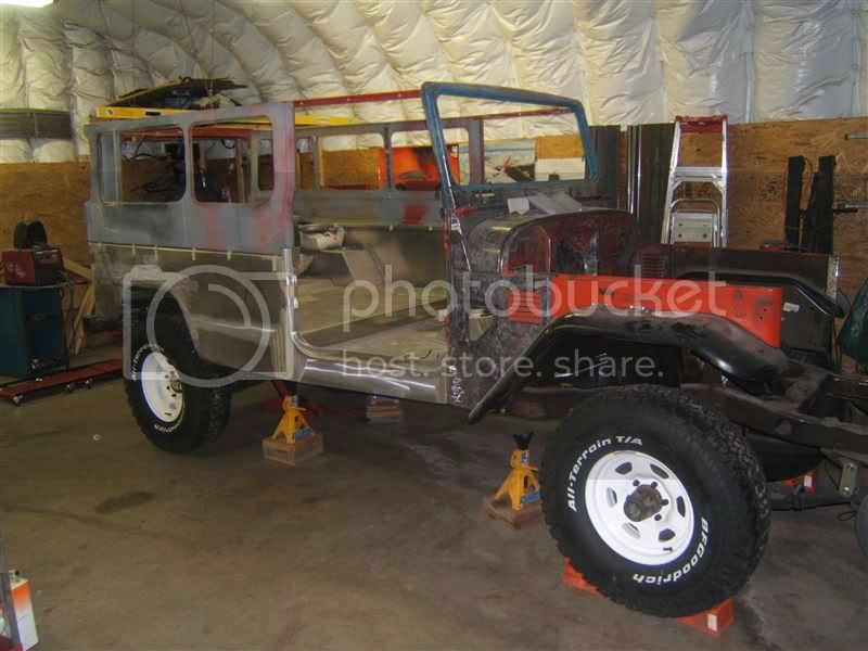

Axles and wheels are back on and the roof is almost completly fiberglassed.

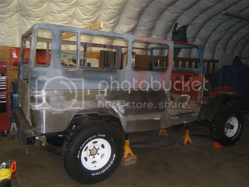

I've finally had the time to update this post a little. The sheet metal work is finally done. The doors are all repaired, the roof is just missing it final coat of bondo to finish smoothing it out and the rear hatch is installed minus the shocks.
I finally ordered my front seats (Corbeau Baja RS) and should start building the base for the rear seats this week. The role cage is supposed to get started at the end of the month. Happy to have things finally really moving.
Here are a few pics of what 40 looks like now... :)
