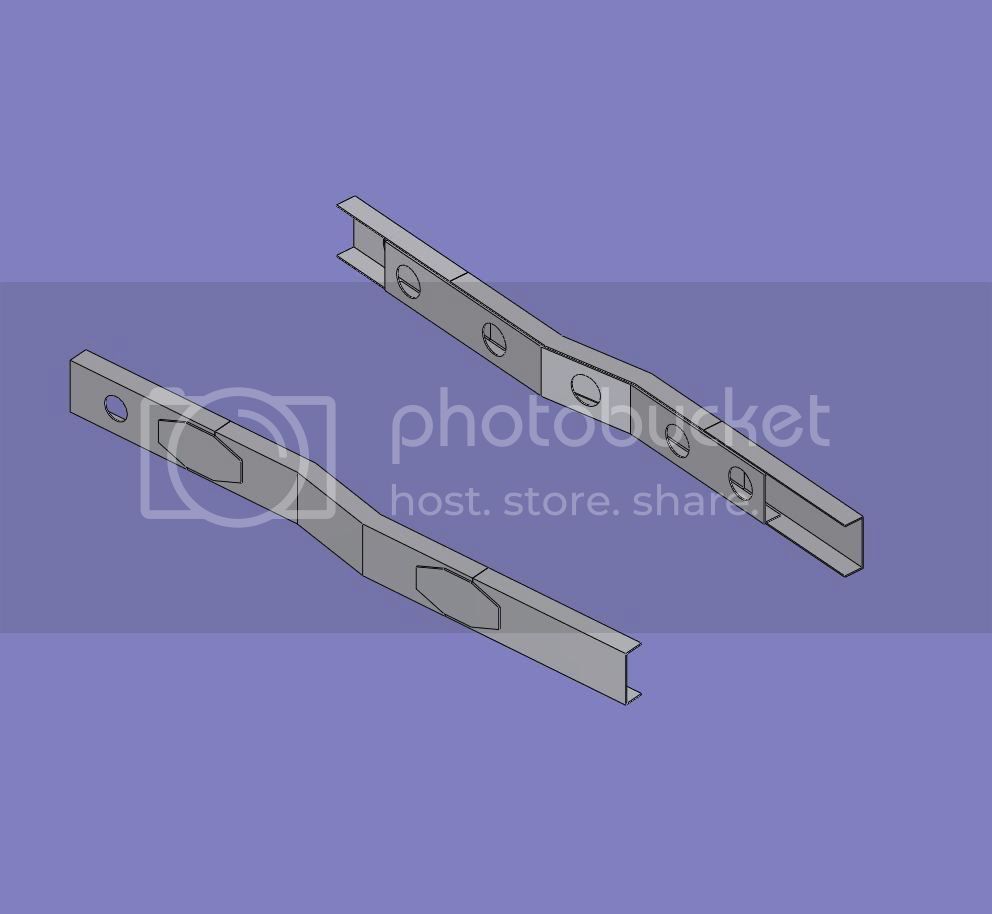

For the frame stretch I'm thinking of cutting between the center crossmember and the front body mount. Here are a few pics (made in Solidworks) of what I think the strech will look like.

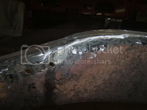

I also managed to finish most of the repair work to the from cowl. This link is what I started with: cowl before repairs, and the picks below is what I finished with. There is still a little welding to do but it can wait for a bit.
passenger side
driver side

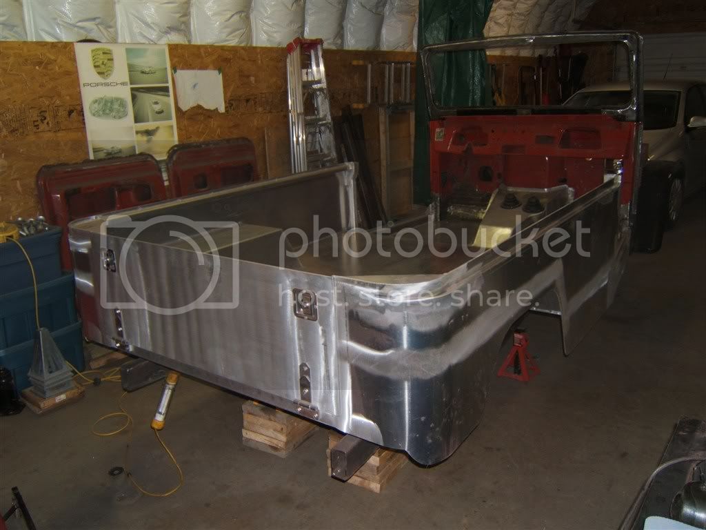

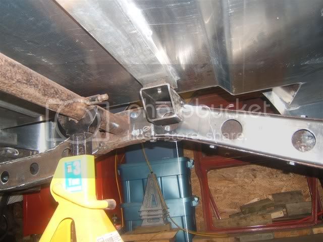

A little update for the people that are interested. Most of the metalwork on the cowl is done and it has been re-attached to the frame. The new Aqualu tub is finally attached to the stretched frame with some new body mounts and the new rear bumper/body is 80% done (missing hitch receiver, end caps and center supports). Got a "new to me" windshield frame from a 77 and got it installed (needs minor rust repair). Now for a little "fun" and I'll start repairing the doors and stretching the sides and the hardtop.

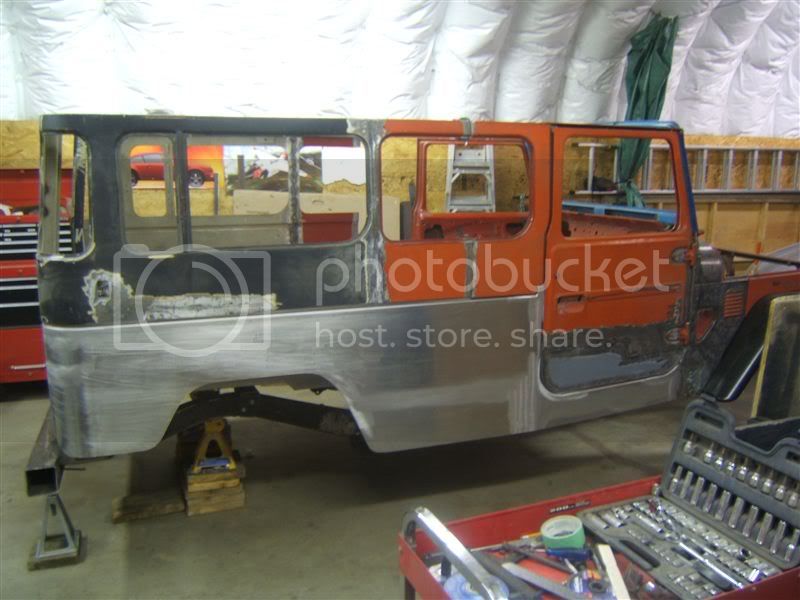

Some minor updates. Project isn't dead. Now that winter is here and that the house projects are done, I'm back working on the LC as much as I can (8 to 10 hours a week). I'm back working on the sheetmetal. I hope to have most of the sheetmetal done by the end of February and then I can start working on the roof. Below are some picks of where I am now...
Once the sheetmetal is done, I'll get the roof done, then I'll get the axels back under the truck, then the seats, then the roll cage and so on and so on...
