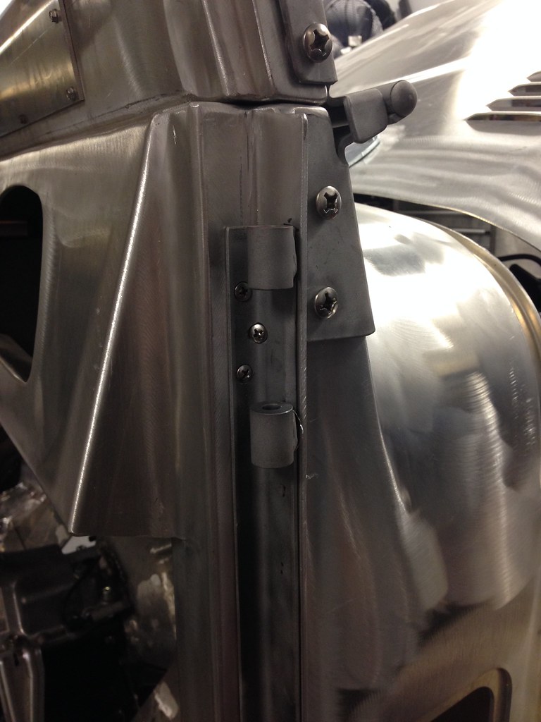

I talked to todd at aqualu. His frame jig cannot do the mandrel bend so the stock bib hinge is NG. I am mounting with no hinge. Looks good
Wish I didn't buy that bib hinge now:( I know the fenders don't bolt on like stock ones do, what supports the front clip on the frame?
It's drilled, but it doesn't work well in stock form. Todd told me you HAVE to modify the stock hinge to even get close. For me, adding some rubber mounts was good enough. I don't need a hinge, as it's never going to swing out withy winch and accessories.
He knows this is a problem and is working on a countermeasure.

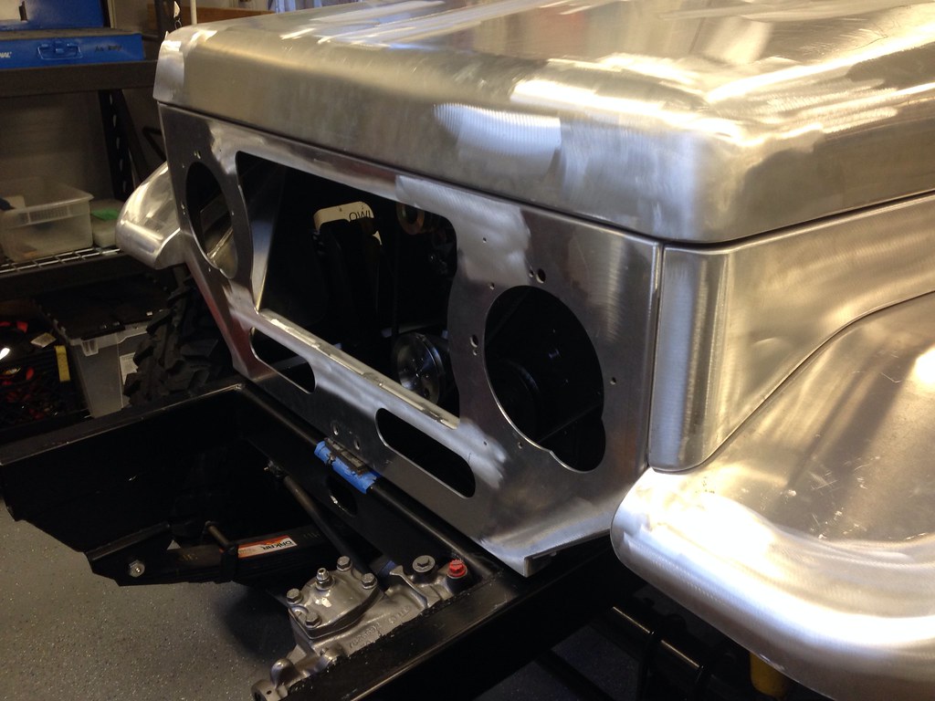

First up, fitment issues with the Aqualu frame and stock hinge.

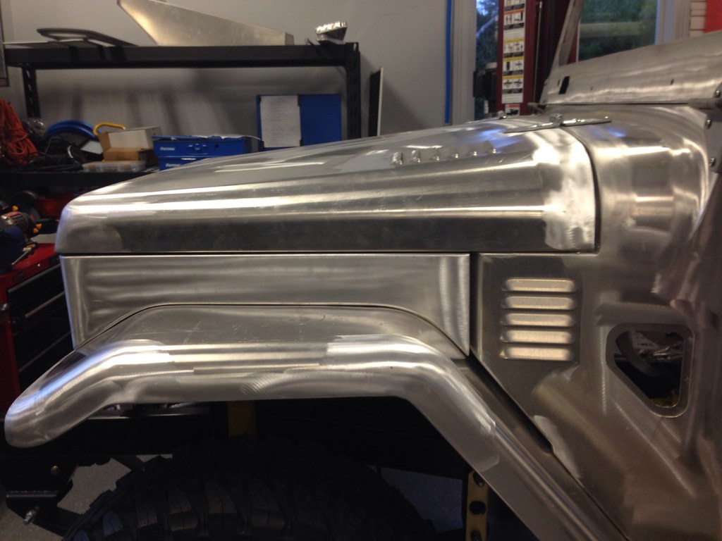

Here it is all the way forward on the drilled out holes, but still way to far high on the cowl...
And here you can see the the overbite from the hood.
Now no hinge, just body mounts. All better

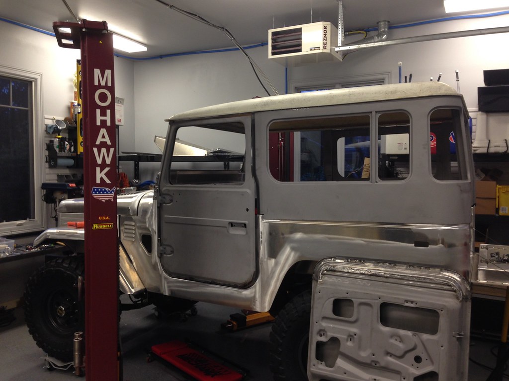

Doors up
All fixed on the passenger side
AQ door hings bolted on...

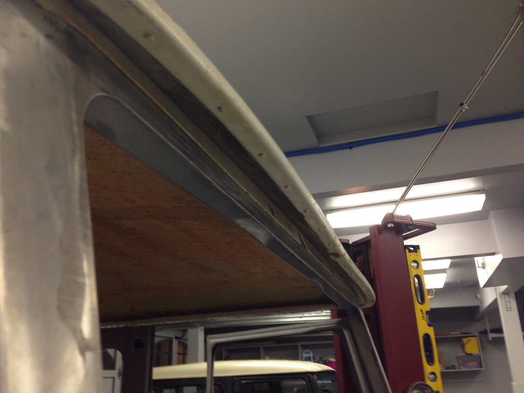

Roof fits perfectly on the AQ windshield frame

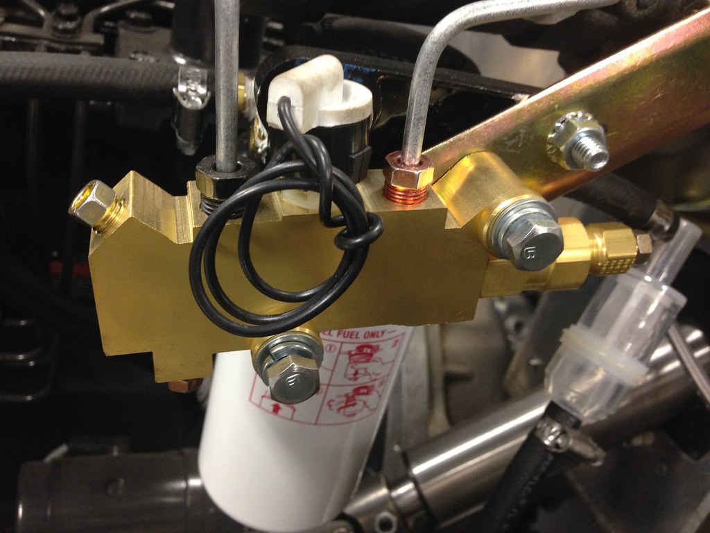

brake lines, there are different grades of brake lines ... i use the bronze colored, they are supposed to resist rust better than the cheaper version

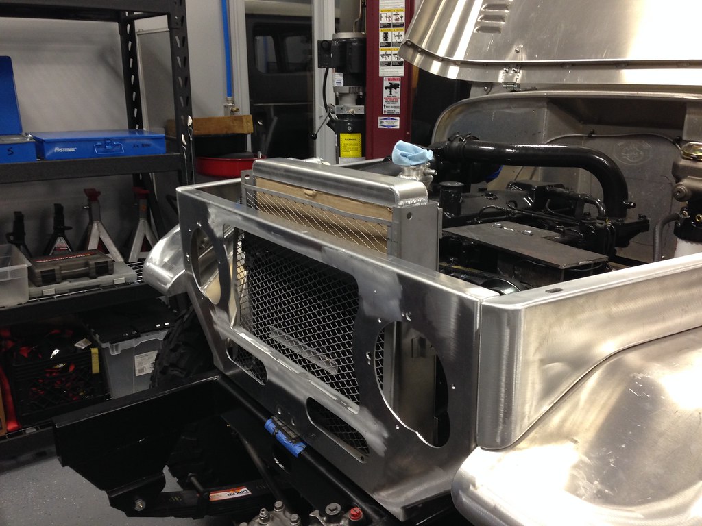

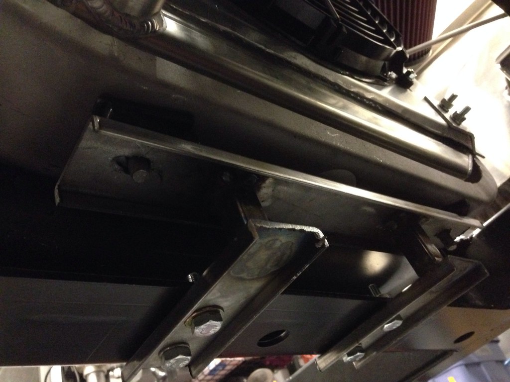

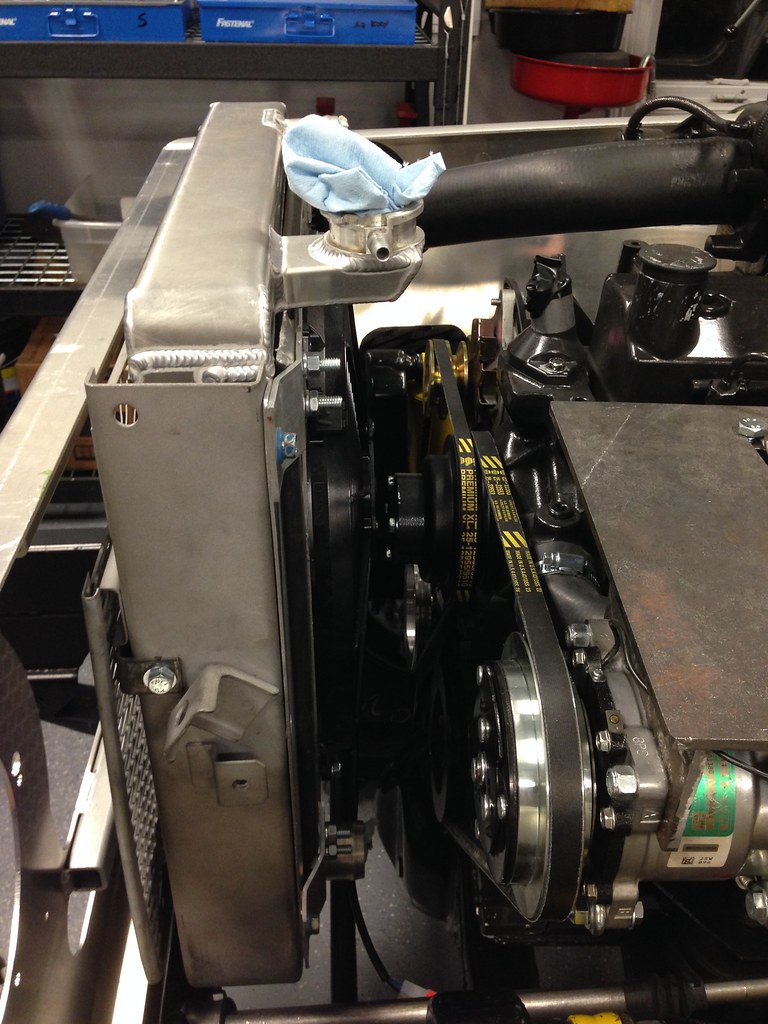

Radiator mount is all finished up. I ended up bolting it to the frame as I didn't want to grind the frame down to bare at the front of the rig (gets the most weather). I actually like the flexibility of taking it out when servicing the rig.

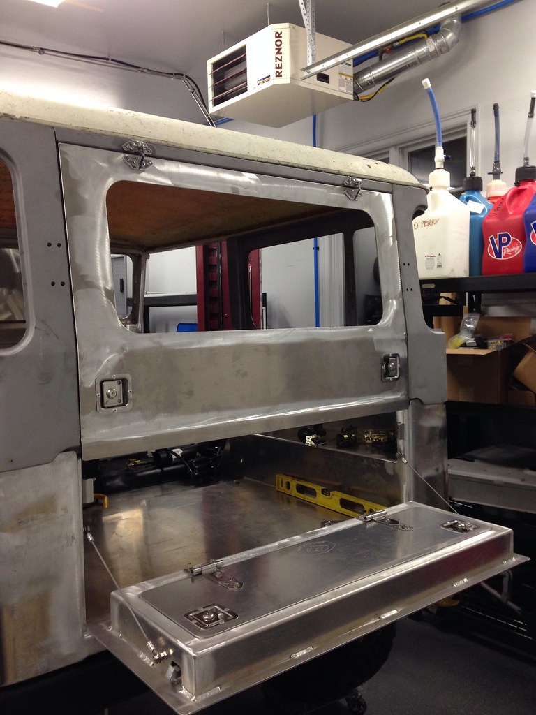

Put the lift hatch on.

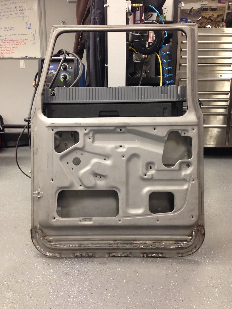

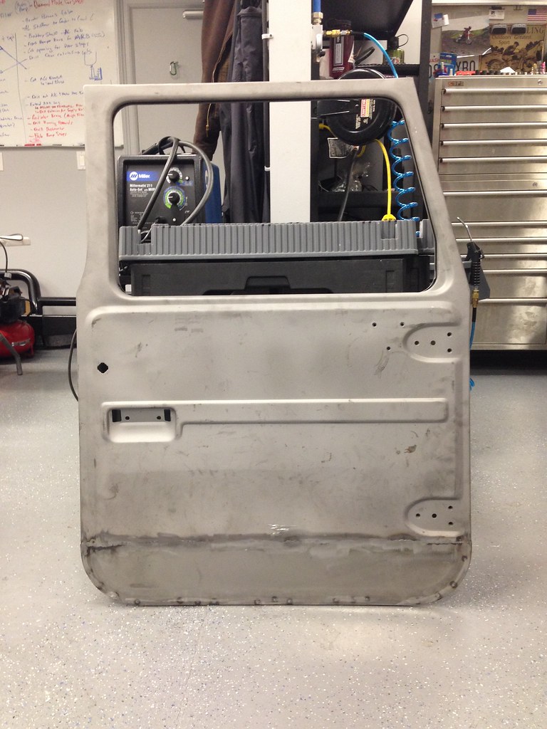

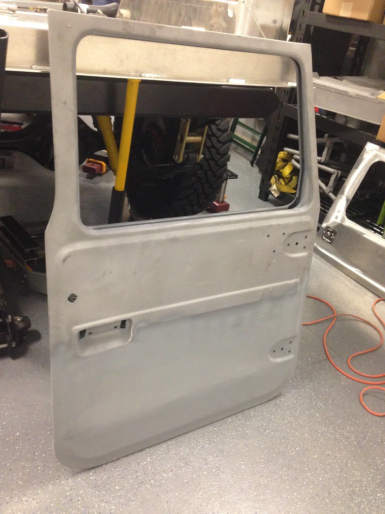

Finish up the doors (bondo)

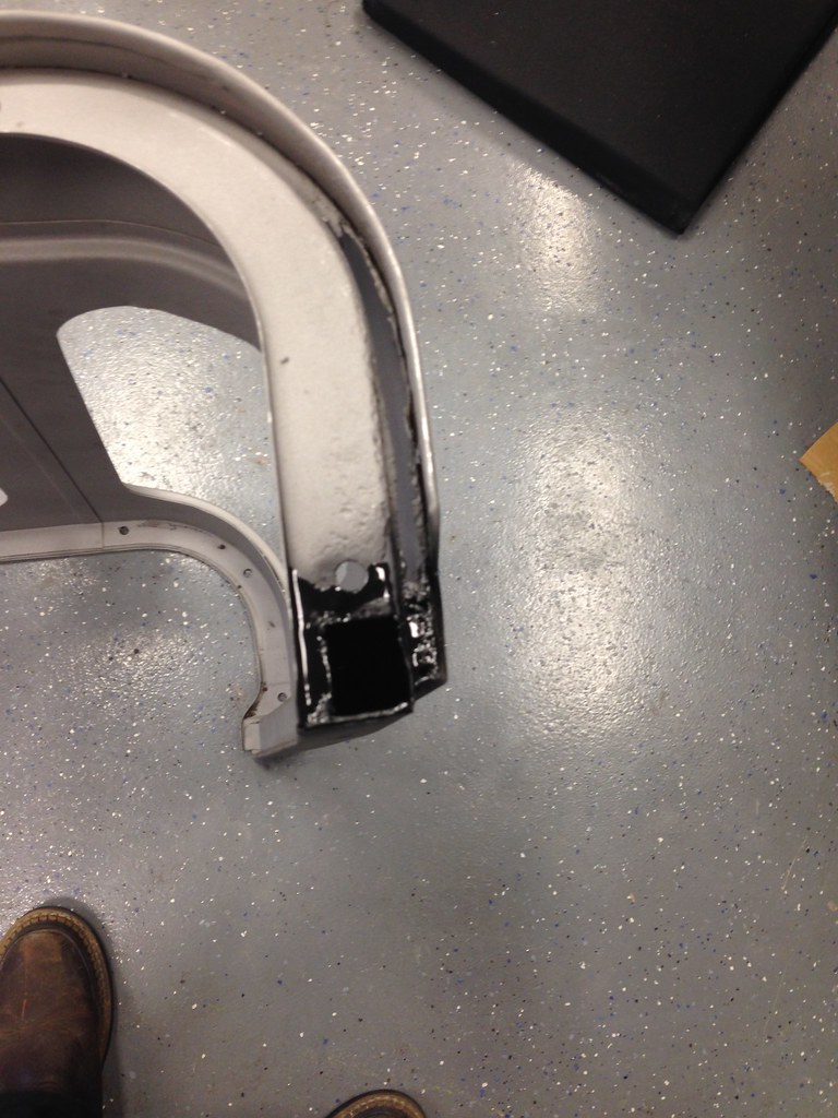

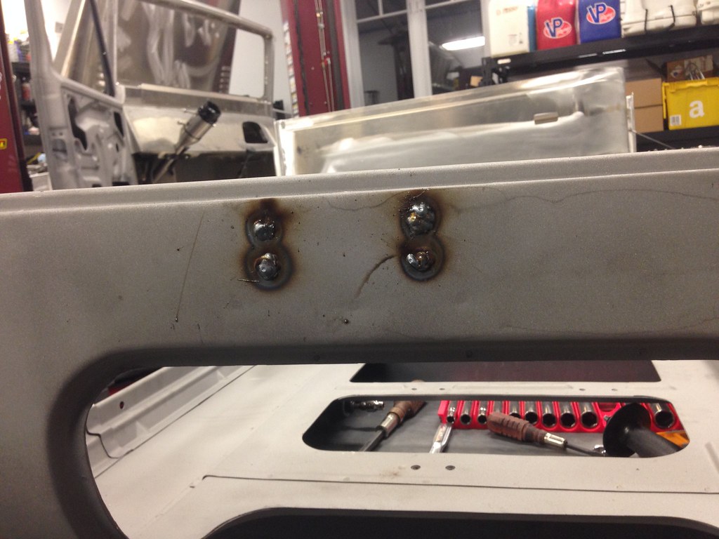

Fabricate new drivers side panel footing (rust), bond
Drill hard top to AQ body pieces (W/S from SOR arrived)

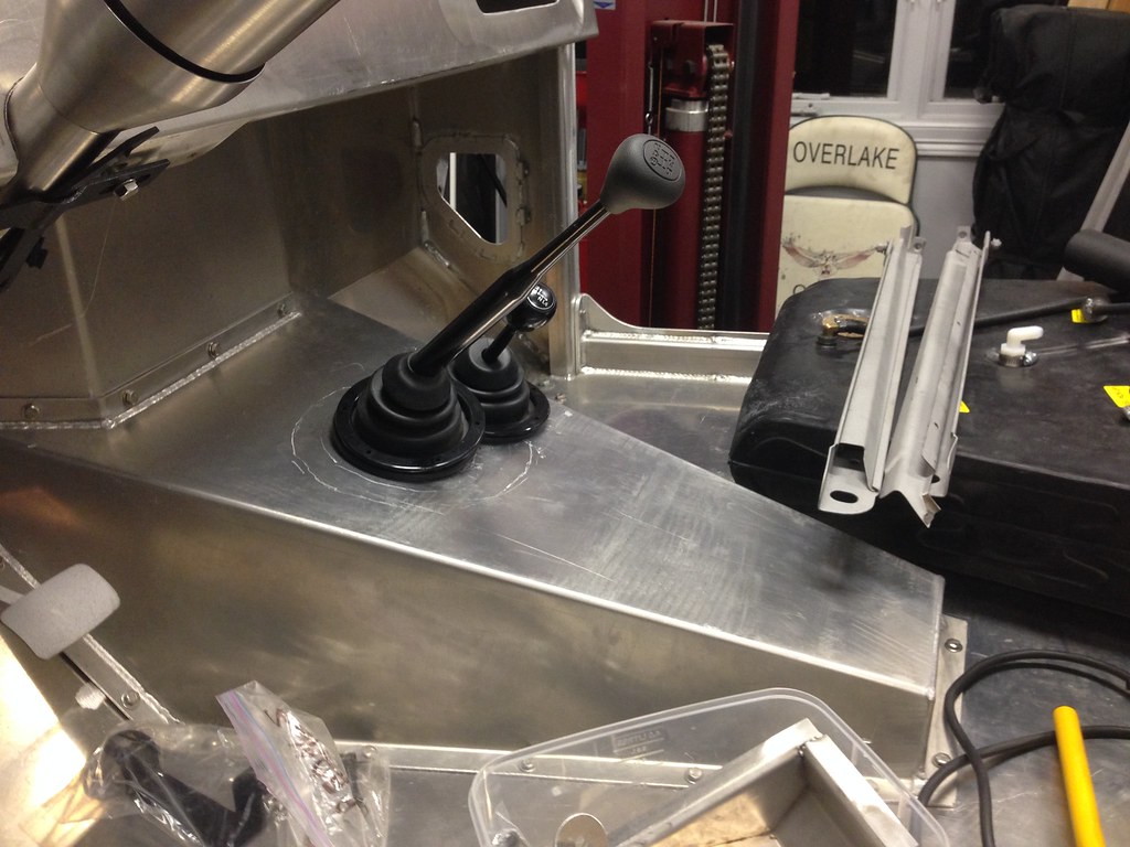

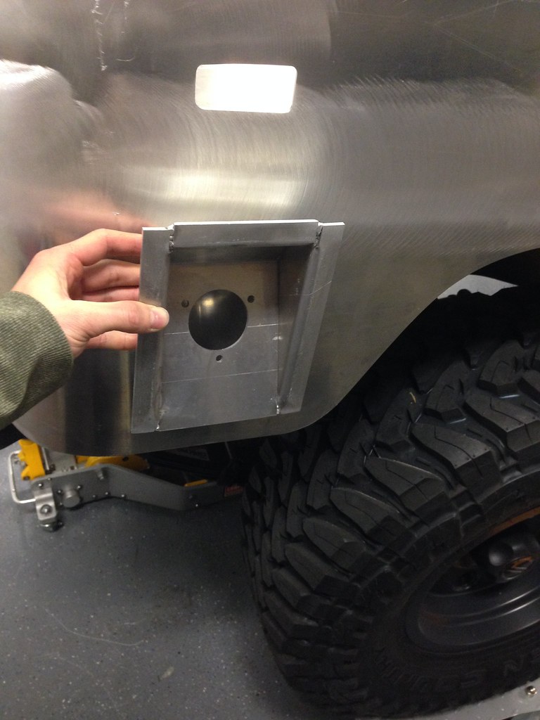

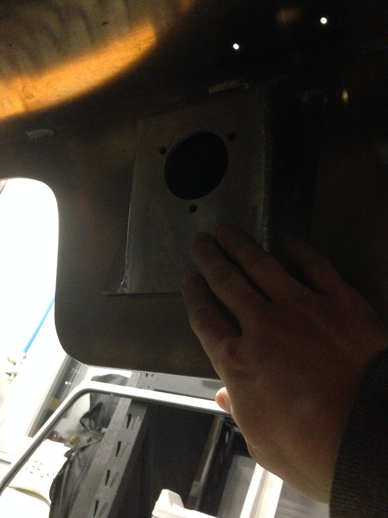

Cut out dash for gauges and fuel filler

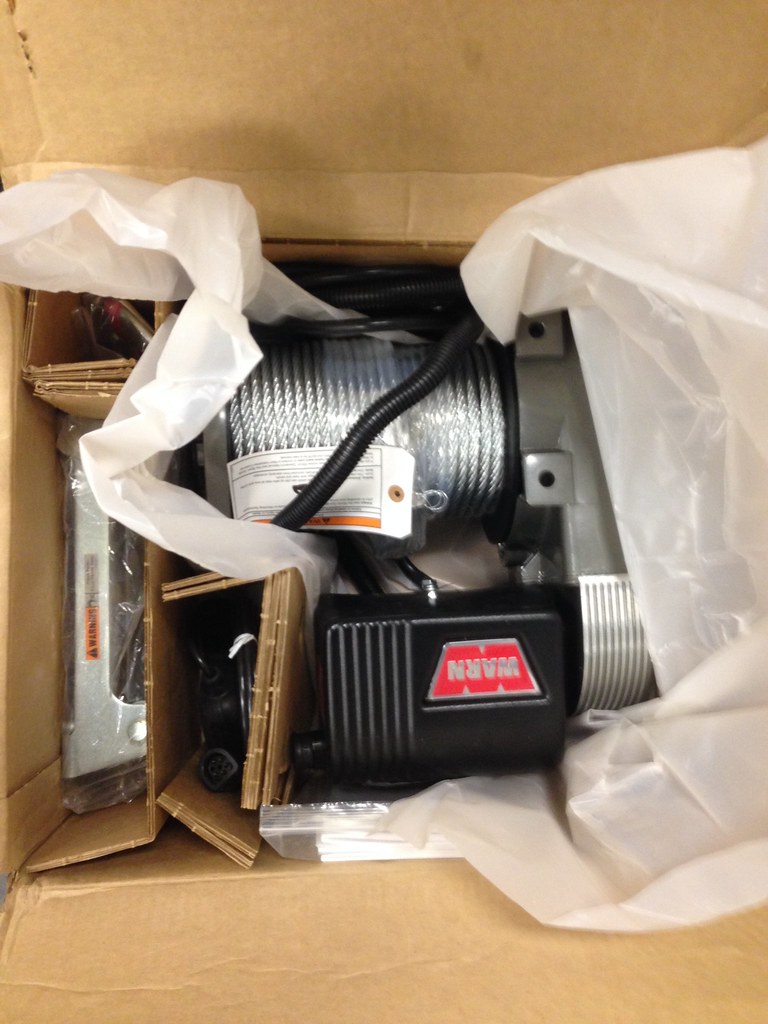

bumperettes for ARB bumper (winch comes today)

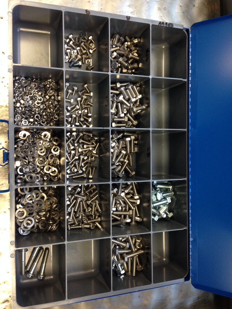

Ordered a bunch of stainless steel hardware from McMaster:

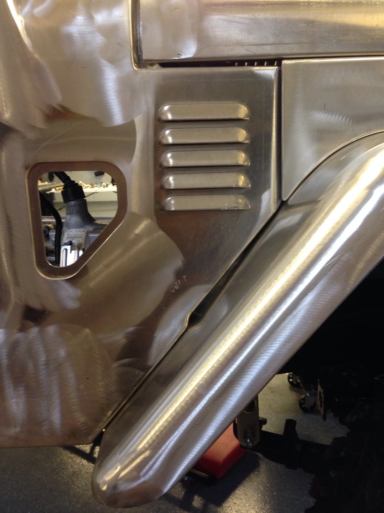

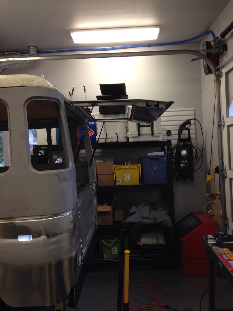

Installed the air shocks. Had to grind the truss braces for the hatch to fit (eliminate the use of the fourth bolt)

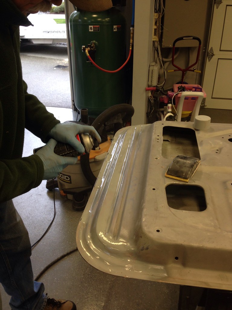

The FIL bonding the door with the skin work

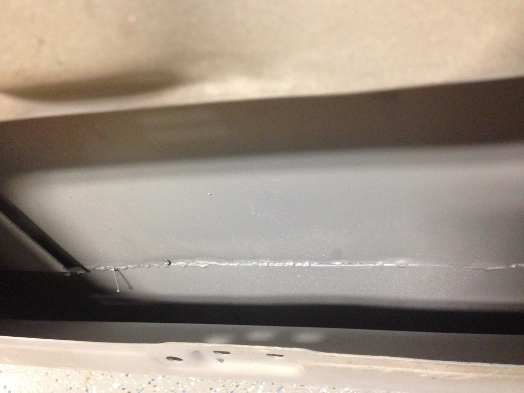

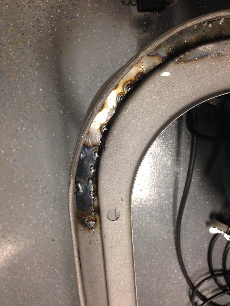

Had to deal with some random rust cancer here and there. Side panels took all afternoon to fix.
Put some Zero Rust on the inside of the doors:

Stock Radiator braces work well enough.

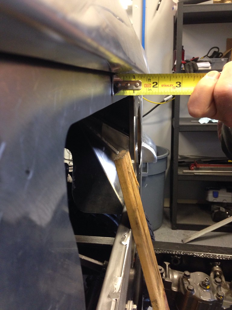

Cut the center transom
The aftermarket master takes 3/8-24 fittings FYI)

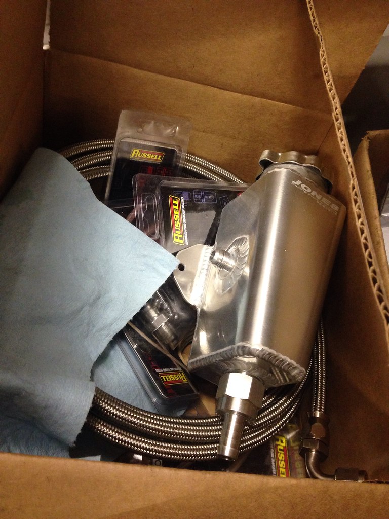

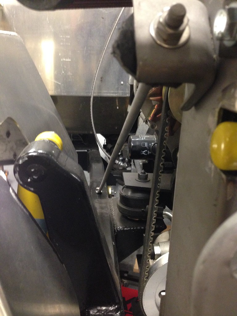

Power steering reservoir

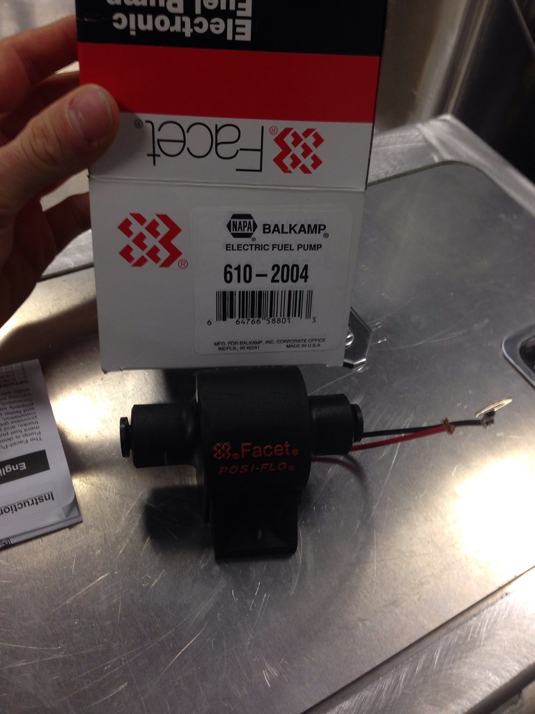

Found this cool little fuel pump from Napa to act as a lift pump for the injectors (plumb next to the gas tank). Solid state, check valve, 50 inch dry lift, 20 gallons per hour

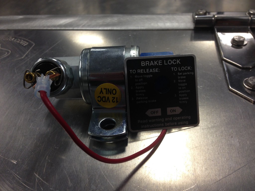

Mico electronic trail lock
UPS guy loves me now. This thing is heavy.

In the aerospace world CRES (aka stainless steel) in contact with AL is a major issue. Galvanic corrosion can eat holes in the AL. I think they have the same problem on boats.
Are you using anything to isolate the 2 material?
http://www.tefgel.com/contain.php?param=tefgel_infor
I am doing most of the drilling now, so a coat of paint should be there to protect the hole. But that is a good idea for any holes made after the fact.
also use lots of anti seize on those bolts. and dont you hate how those bolts are odd head sizes? lol
i use AntiOx on all SS bolts and it seems to work very well. (think a more liquid Anti Seize)
downside of SS bolts, they have no strength rating, they are weaker than a grade 5 so NEVER use them where strength is needed.
