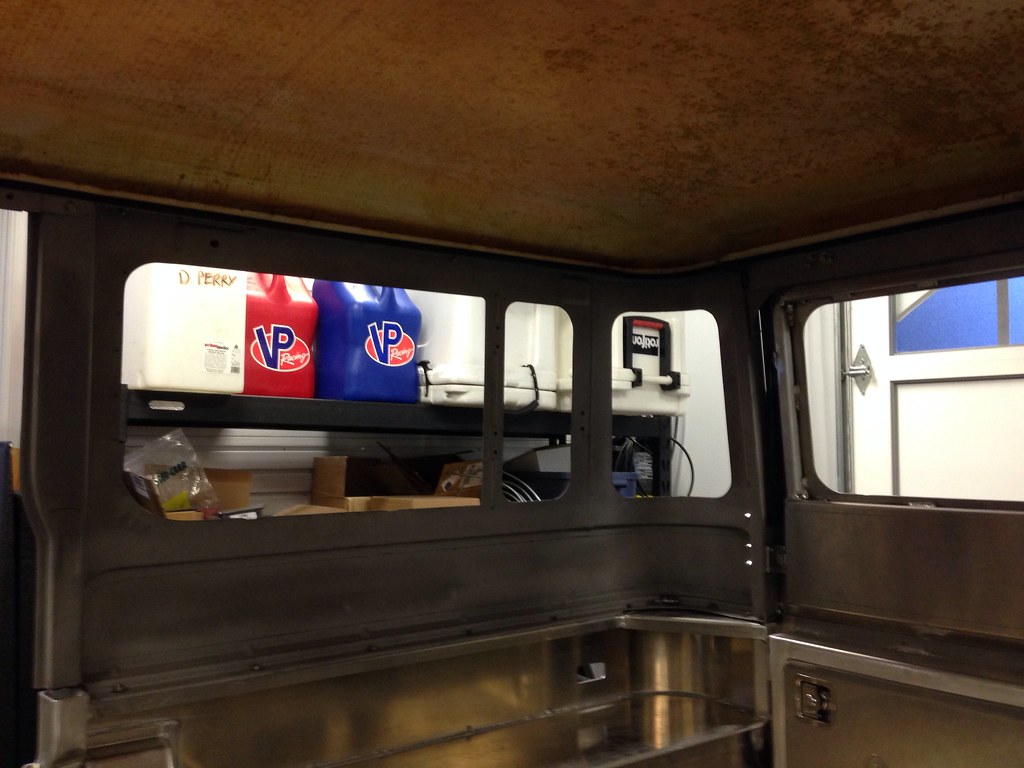

Well the top is all bolted up and finished. Monday we finish all the knick knacks and plumb the fuel line if we have time.
Had to cut off the posts to get the top to fit on the AQ body. My seat belts are going to be on a full cage with harness bar, so I am not worried.

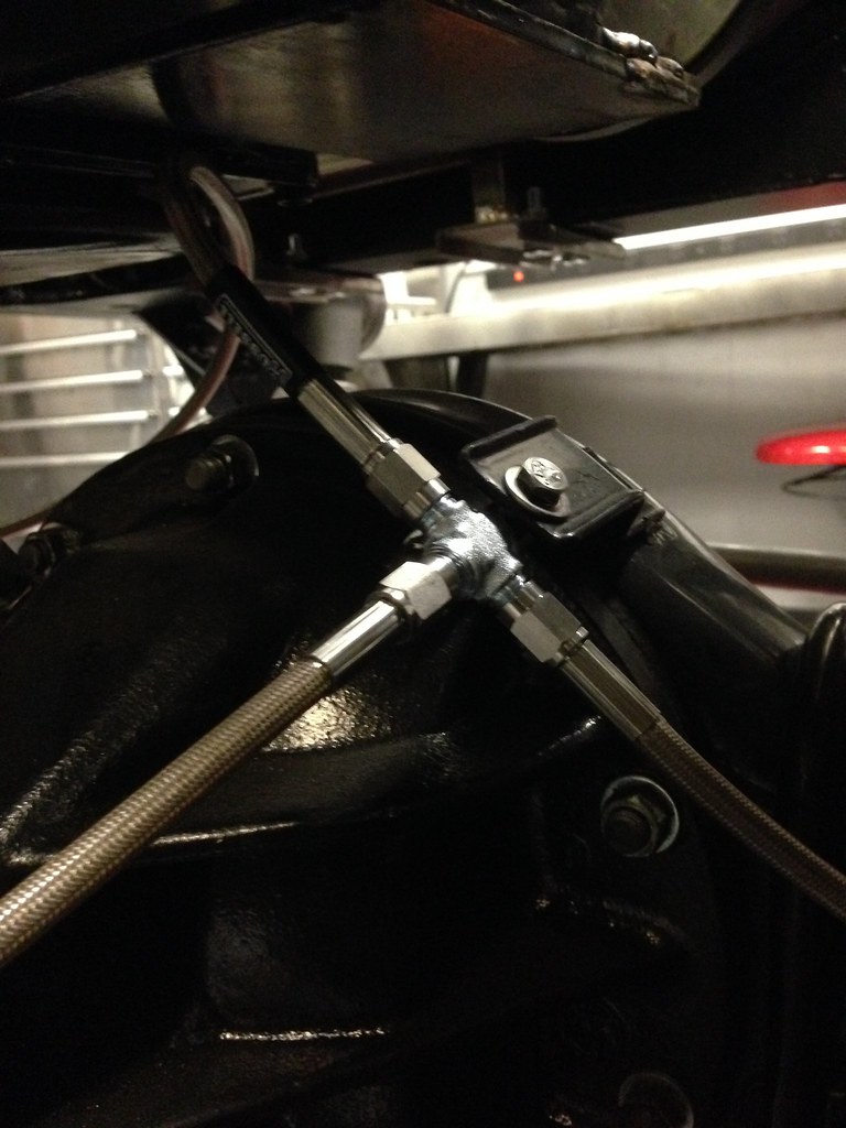

Diff Breather
Russel performance -3 AN tee fitting

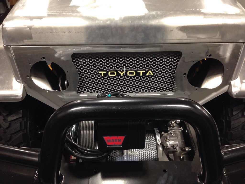

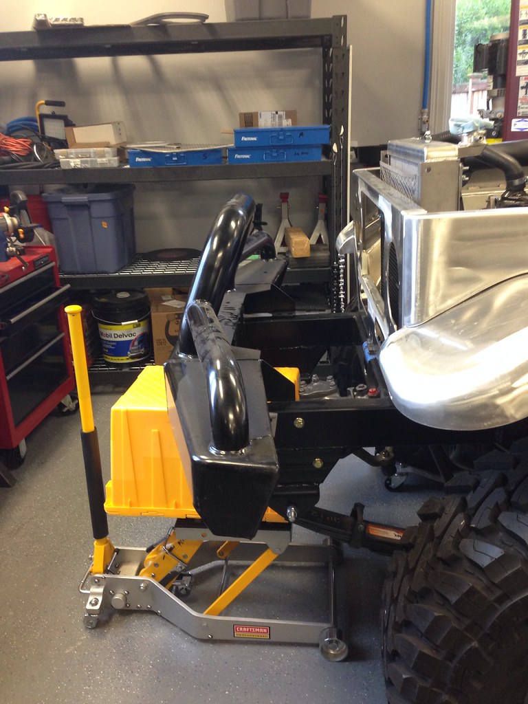

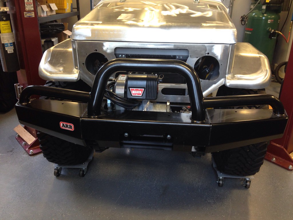

Bumper all mounted up this am
Go Hawks!

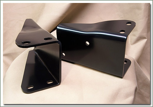

Bumper looks great! Did you use original bumper gussets or bolt right the frame rails?
The ARB bumper bolts right up to a stock frame, but I had to drill out the top and side anchor holes and attach aftermarket frame extensions like these:

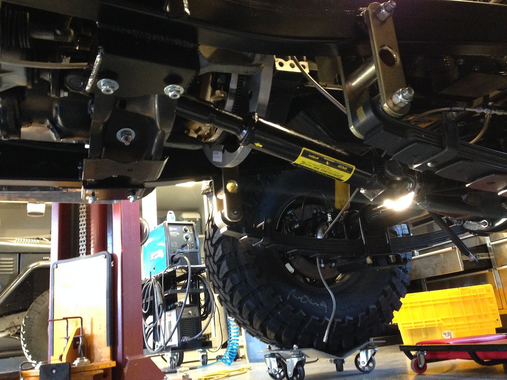

Beautiful build. One thing to check with the shackle reversal that I can't see from the pics is when you use an H-beam shackle , depending on the length of spring and potential compression, the center brace may hit the frame under hard compression. Something to double check before you jump it

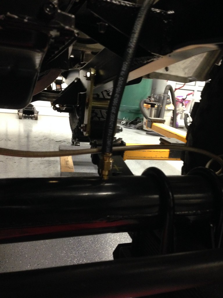

Brakes are all plumbed

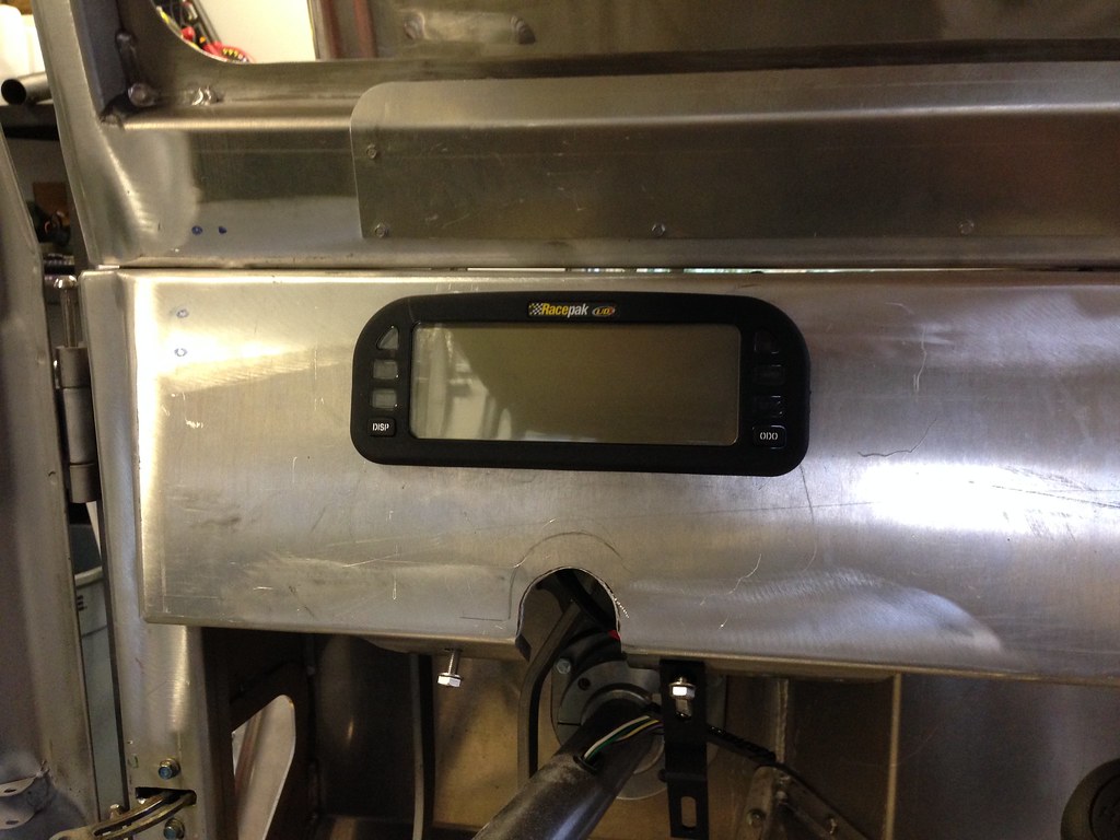

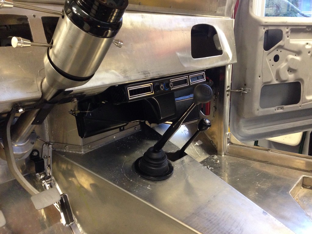

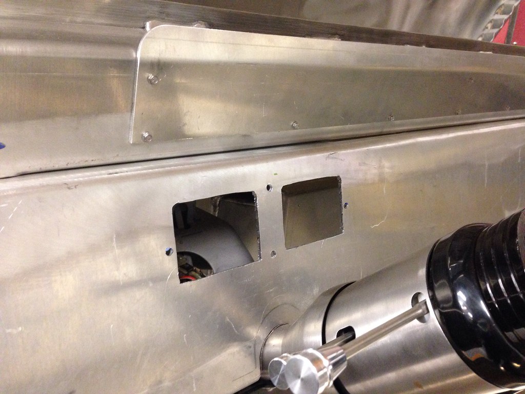

Cut the dash. I put it up higher for better eye relief.

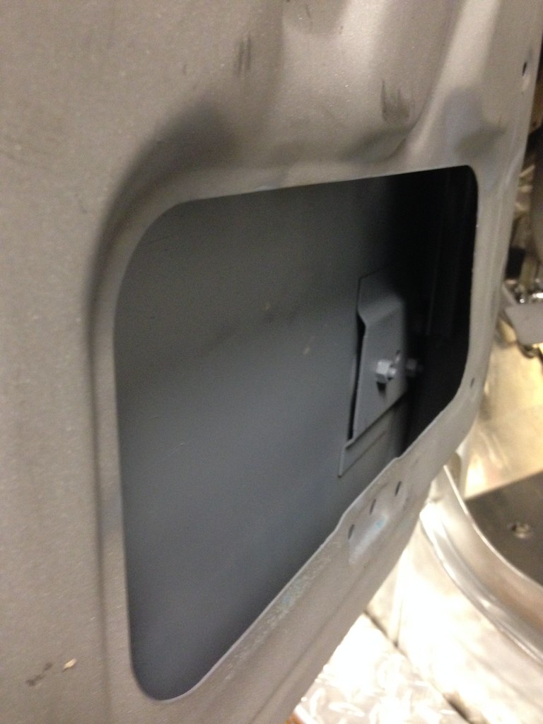

Fab'd up and welded on a new door stop hanger, and cut in the stop bases

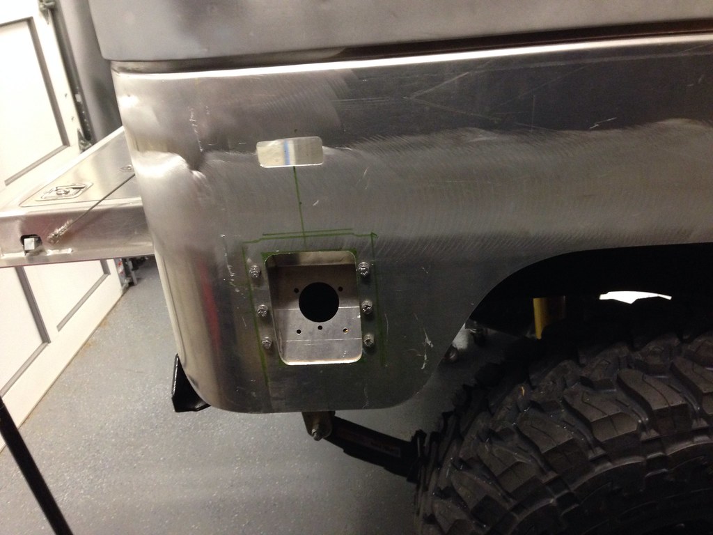

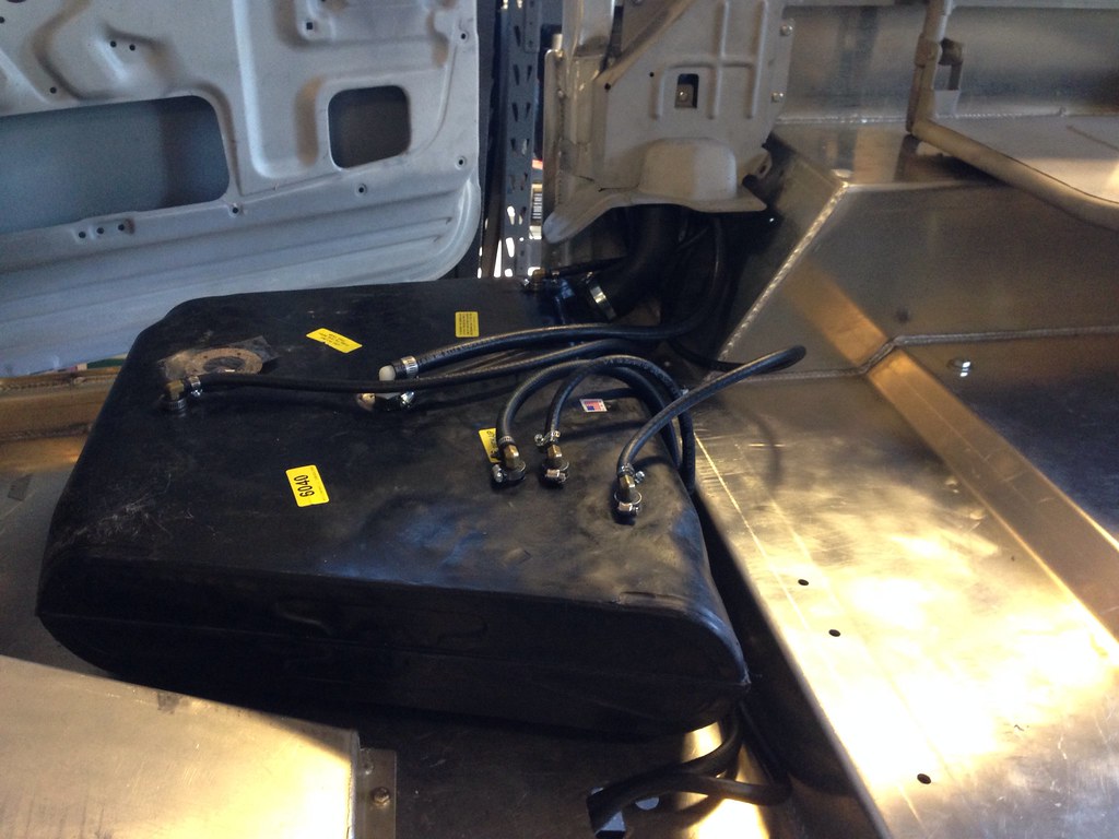

Added the Aqualu Aux. fuel filler

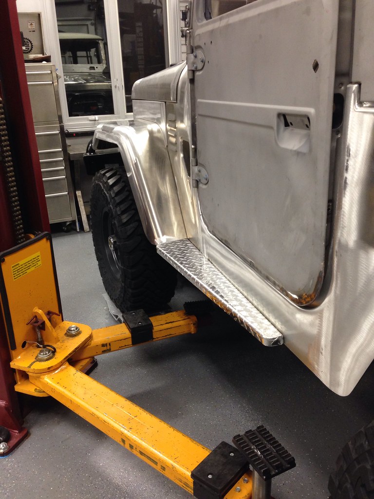

And running boards

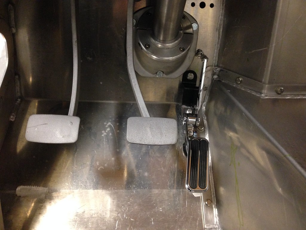

Lokar throttle pedal and cable

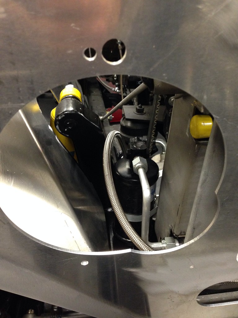

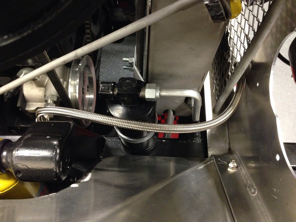

Started plumbing the power steering fittings, so I added the A/C dryer for fitment

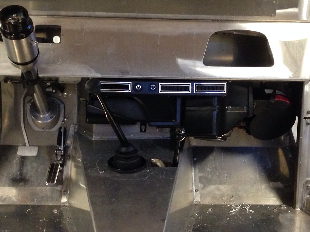

Pre drilled the vintage air unit

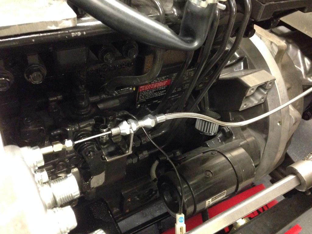

Added throttle cable/&bracket

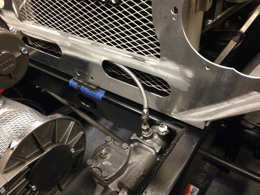

Finished up PWR Steering

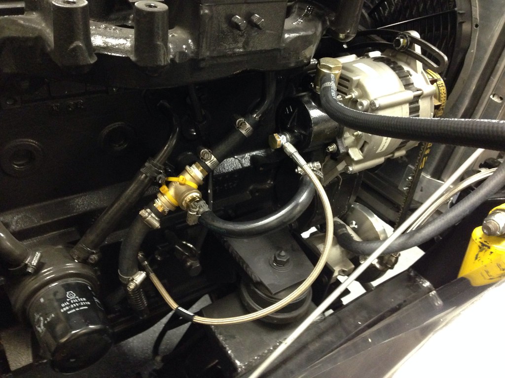

Plumbed the alternator vacuum pump into the turbo return line.

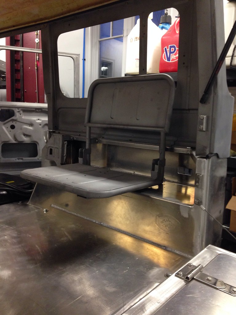

Installed the jump seats.

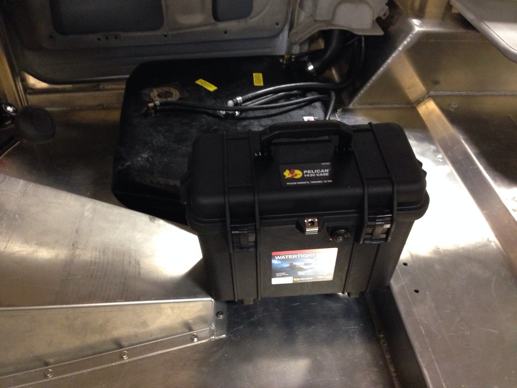

I am going to weld some custom seat brackets, so I figure I'd try and make a Pelican 1430 into my center console.

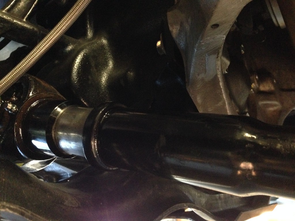

Installed the front & rear drivelines
Front clearance

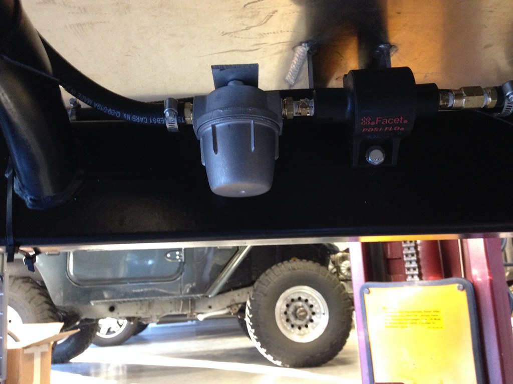

Pre Filter, Lift Pump, and fuel lines all plumbed
