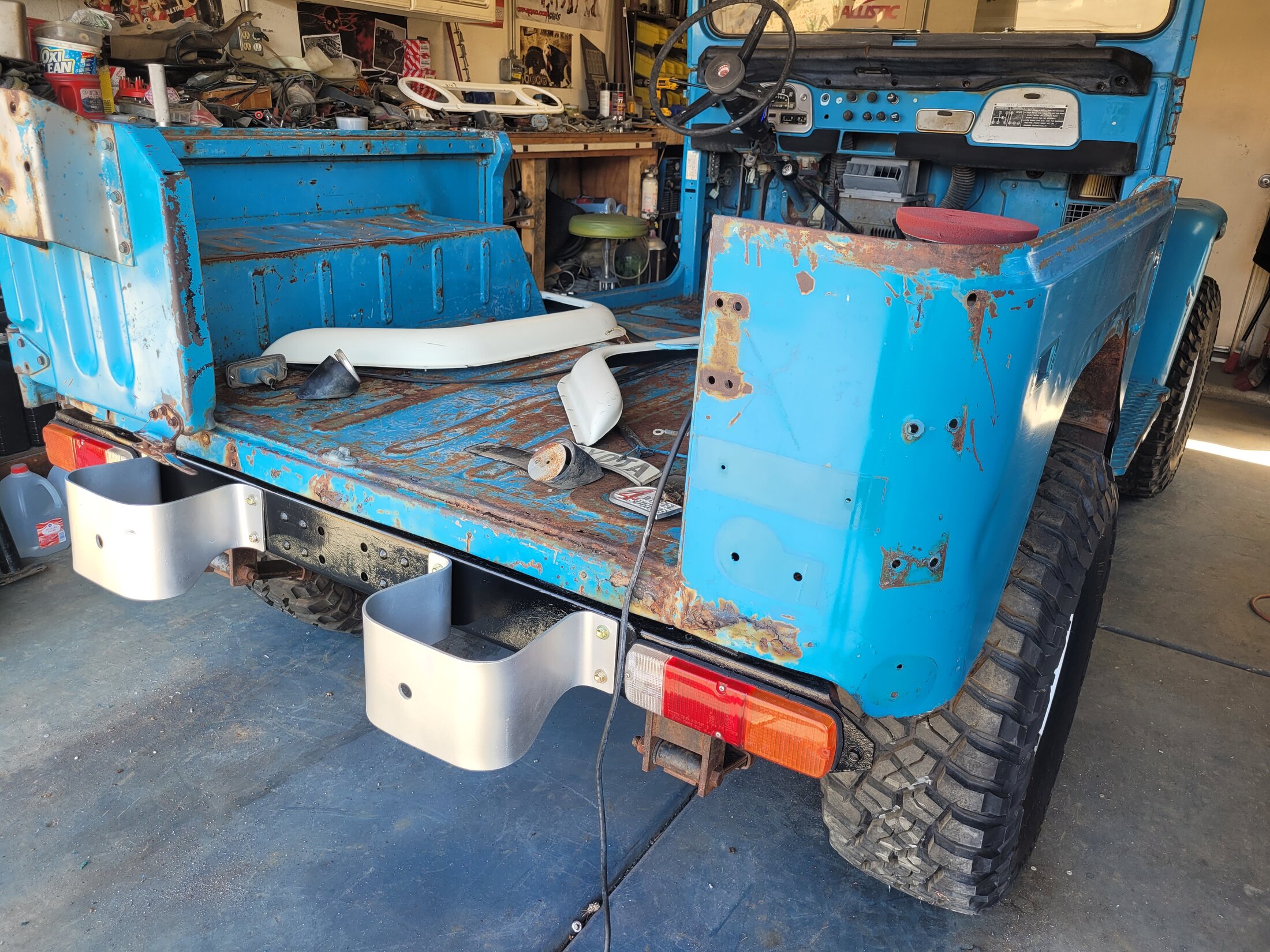

Cleaned up the rear cross member, painted it, and bolted on the bumperettes. Didn't realize one was so out of wack.
That truck is so nice looking. I can’t wait to see it all buffed out. It really needs the 4Plus bumper I have for sale. Those seat covers could be made from genuine rat a$$ from the player haters ball.

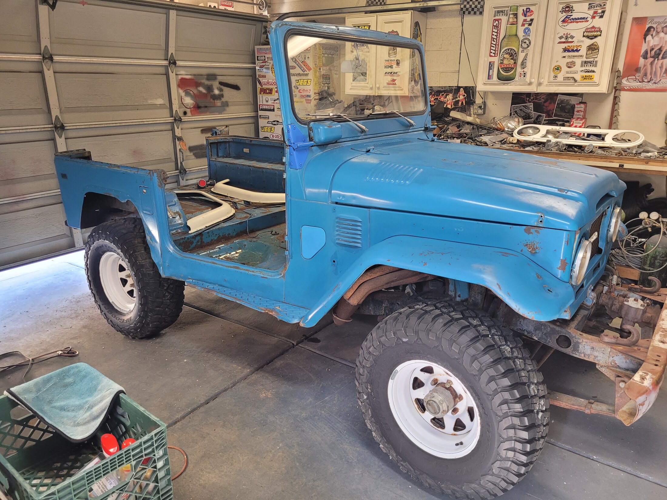

You've got a blue 40 fetish I see. Also, I really dig this 40.
Jack unless the 327 is absolutely toast, you should check the numbers on it. If you haven’t already. It looks like a big harmonic balancer, which is usually a HiPo motor. It could have come from a Corvette or Camaro. The restoration guys will pay decent money for them.
If you do end keeping the V8 I would consider finding a H42 top cover from a FJ60 and the transfer shift lever from an early FJ60. With the boss for the T case shifter forward on the early transmission case those levers were bent backwards. 60 series transmission tower is further back. Those two things would help with the original look in the cab. Personally for the desert I like the heavy cast iron block of the F series engines. Then the close to double oil capacity helps in the desert heat.
