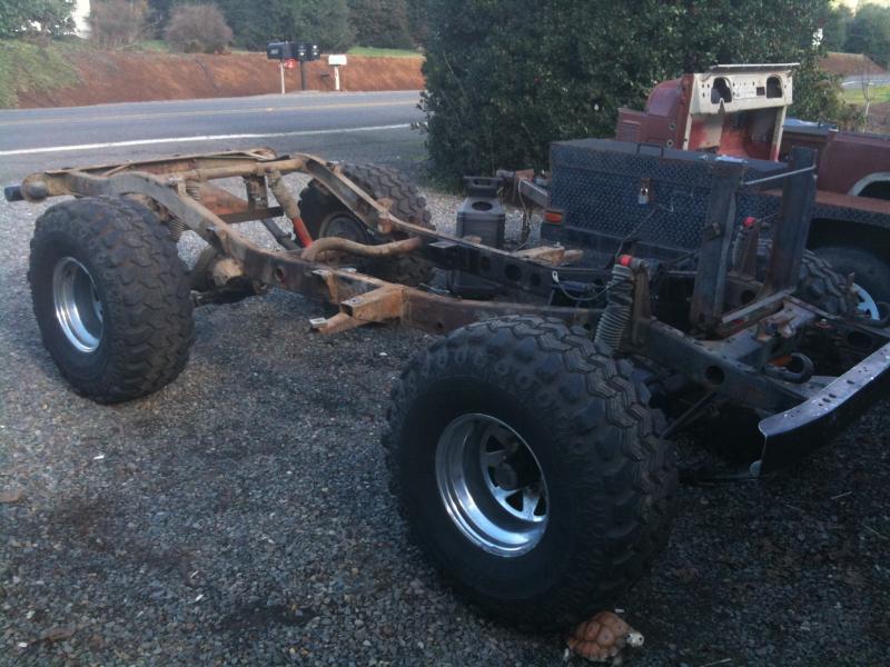

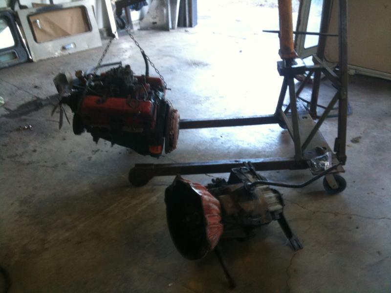

Got the engine and drivetrain out and some other misc. stuff. Pretty much just a rolling chassis now. Dropped the tub off at the blaster's today and we should be expecting it to get done within a few days. From there it goes straight to the guy who is doing all the body work and paint. He's going to get started on that while we try blasting the rest of the pieces ourselves. Tried blasting a little bit on Sunday but that didn't work out too well. The sand I bought wasn't fine enough and some pieces clogged up the gun every few minutes. Lesson learned.
I'll get some more pics up of the tub and other parts after they're blasted. Has anyone ever tried wet sandblasting? Was reading up on that a bit and it didn't seem like a bad way to go.
Also, we're looking for a fresher 350, auto tranny and maybe even GM t-case to swap in there so if anyone sees one for sale up in the Northwest be sure to let me know.

More parts blasted...
1st pic is front end of the frame part way done...
Had a guy some out Saturday and soda blast the frame and everything else we have. Now it's all dropped off to the guy doing the bodywork and paint.
While we're waiting on that stuff to get back we'll start rebuilding the engine and hopefully find the automatic tranny and the adapter we need. Just wondering whether to go with a th350 or th400. I've checked out some specs on both. Anyone have any personal recommendations?
