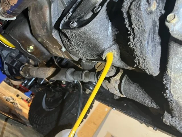

Getting my 40 ready for her maiden (to me) voyage, and was checking my driveline fluids when I came across this interesting sight. I guess my question is, when replacing the mustard fluid in the transmission, is it best to stick with the OEM Yellow Mustard? Has anyone had problems with honey or Dijon mustards in their transmissions? My stomach doesn't like the spicy mustards but perhaps the pep will be good for my 40?

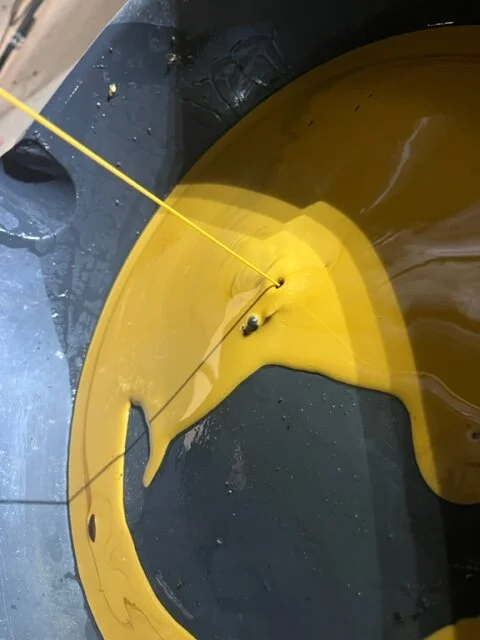

That's a very unnatural color for even the stankiest of tranny's, looks like paint!
Curious if it has the consistency of transmission fluid or????

Like cartoon paint! Smelled and felt like gear oil still, but super weird the color. I'm familiar with the milkshake from coolant and leaky HG, but this is new to me.

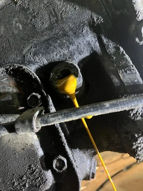

Since it's an early four speed I would suggest removing the on for a PTO on the left side and have a look inside.
Great call, I'll do that.

My working theory is the trans was submerged and water got into the breather and then sat for decades.
Wow! I wonder if that is fluid meant for some other application or some off brand that made it that color to be special.
Any water I have ever seen mixed with gear oil, quite a few times with Outboard Engines, it always had that milkshake color.
Even the synthetic Lower Unit Oils still had the milkshake look.
That color looks like the marking paint for setting gear mesh to me.

That is definitely something meant to be that color. Maybe some type of industrial fluid.

Ok So this is a thing…apparently, the guys on the tractorbynet forum have seen this before…
So "Hot Dog" is still available I guess.
Not many people know what yellow Cel Vinyl looks like. I'm impressed.
Drain it, turn it in on your next hazardous materials collection day, and move on.
This is going to the recycler for sure. I’ll probably drain-n-fill once or twice and let that be that. Can’t win’em all, or at all.
