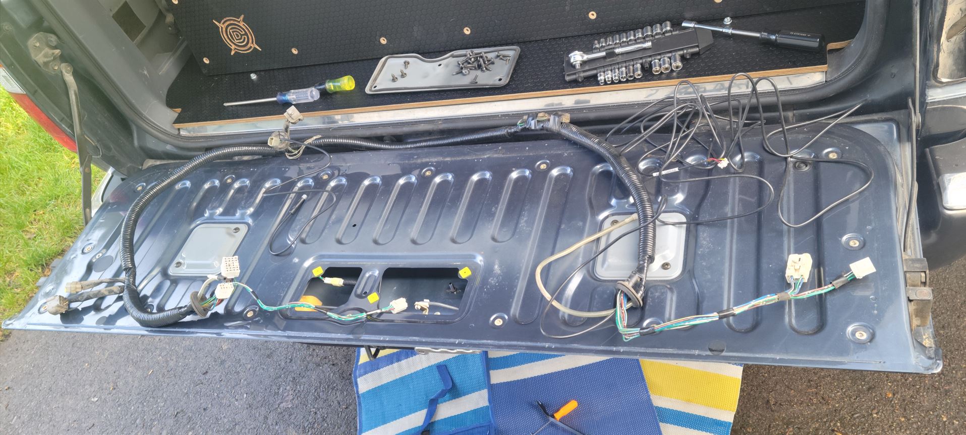

Here's continuation from post #18. I was able to find a harness locally that need to a little fixing, but the part I needed was in good shape. I was hopeful that replacing my old harness with a good one would fix my issues, but it didn't. At least I have the piece of mind that the harness is fixed.
