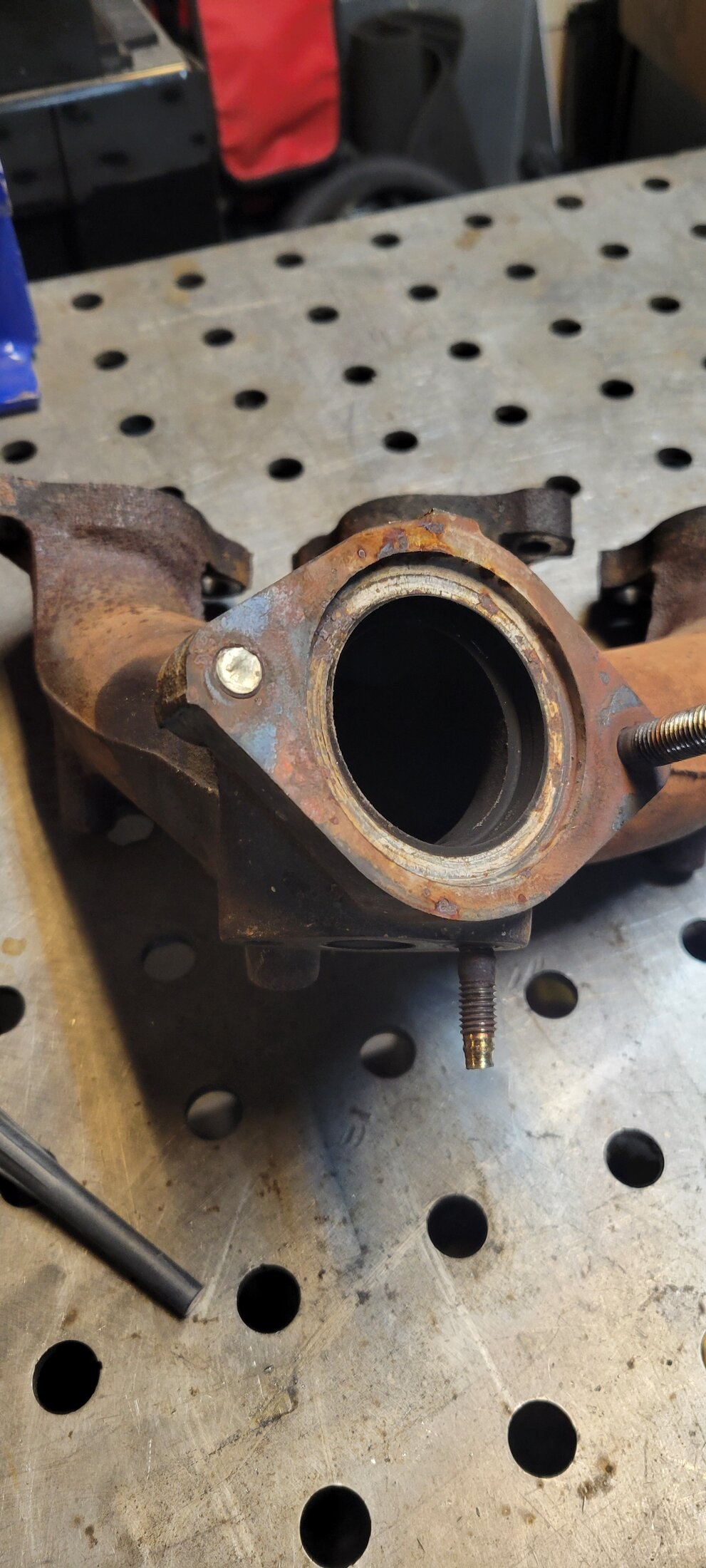

I've been slowly plugging away at the exhaust for a couple of weeks now. What started as a simple O2 sensor change has ended in new exhaust. While removing the O2 sensors I noticed several small holes in the downpipes. Based on how the nuts and bolts looked, I can assume this was all original. I cut most of the parts off with a recip saw, and ground a couple bolts down where it mattered. While removing the downpipes from the manifolds I snapped 3 of the 4 bolts, so I had to remove the manifolds too. I should have my new studs today, and manifold gaskets tomorrow.
Additional progress on the manifolds. All of the original stud have been removed, and replaced with new hardware from Yotashop. I'm hoping to install the exhaust and new O2 sensors next week.
For anyone that has removed the exhaust manifolds before. Did you replace the studs in the head? Or just leave the originals.
The exhaust is finished, and this took way longer than it should have. The new exhaust and O2 sensors really helped smooth things out.
