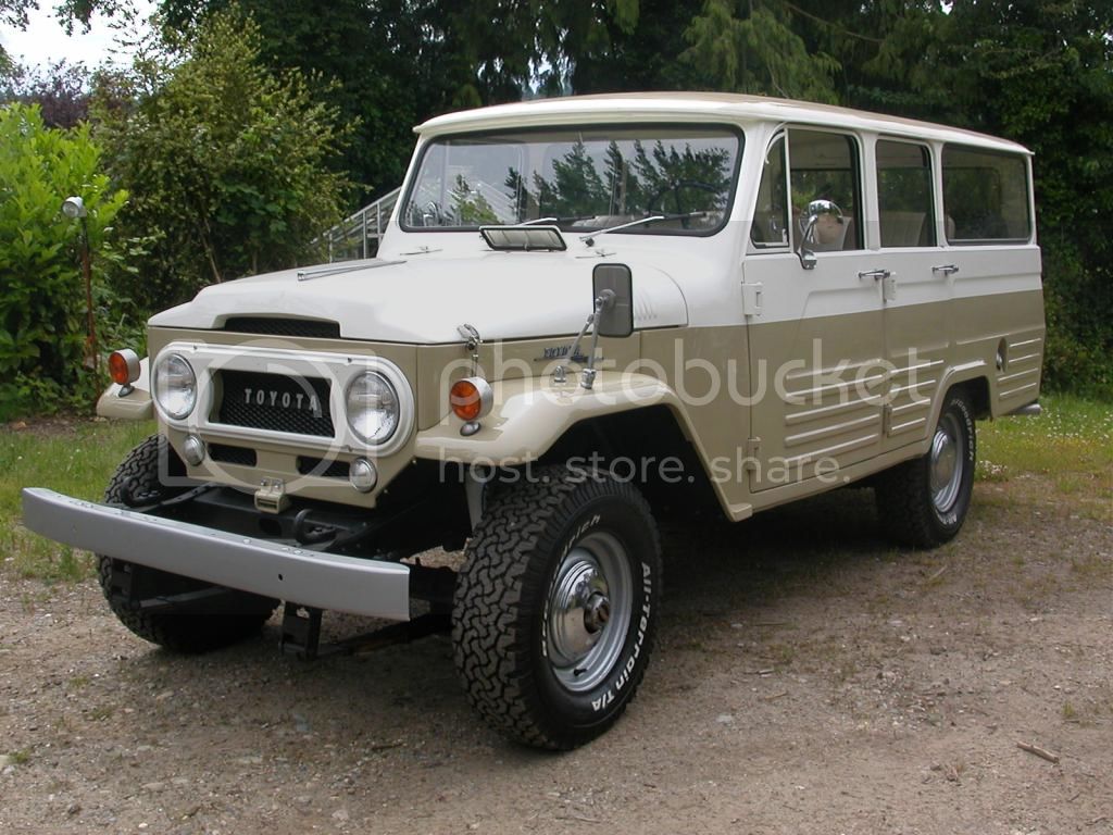

63-65 fj45 wagons had a cowl vent that raised with the open end facing the hood(like a hood scoop ) it brings a ton of air into the cabin......also bugs. I havery one of the original plastic screens from the vent but it's just a bit different than my vent...darn 45 wagons had some random changes

Oh, now that is a cool rig Landpimp. I dig the fender mirror
