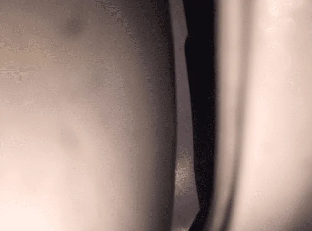

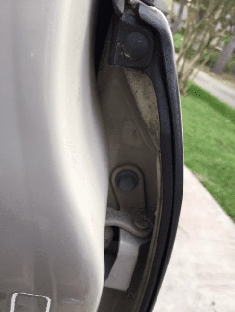

The plastic piece in the rear of the front fender is near impossible to get a picture of, I get a glimpse of it with the door just right, and I can stick my hand in and feel it, but the leading edge of the door obscures it with the door open, and there is nothing to see with the door closed. Let me see if I can figure a way out to get some kind of picture.

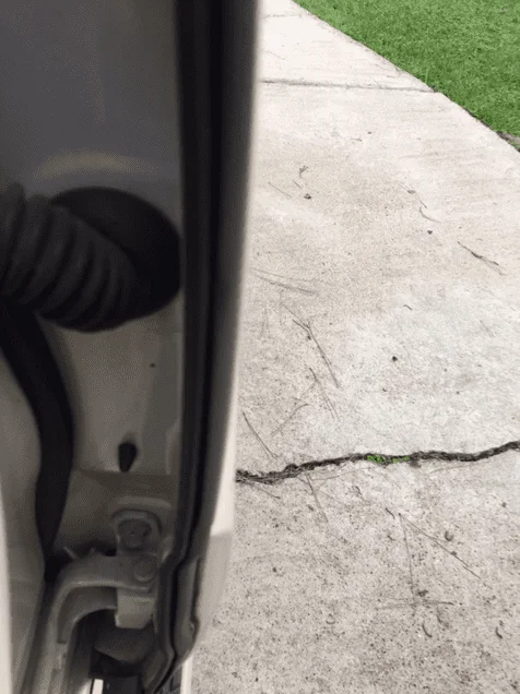

Showing the leading edge of the driver's rear door:
Best effort at inside rear of front passenger fender (shot from outside with the front door open all the way, sequence top to bottom):
@jLB Thank you very much for the pics! I do appreciate them as I do not have access to an LX in my area to look at.

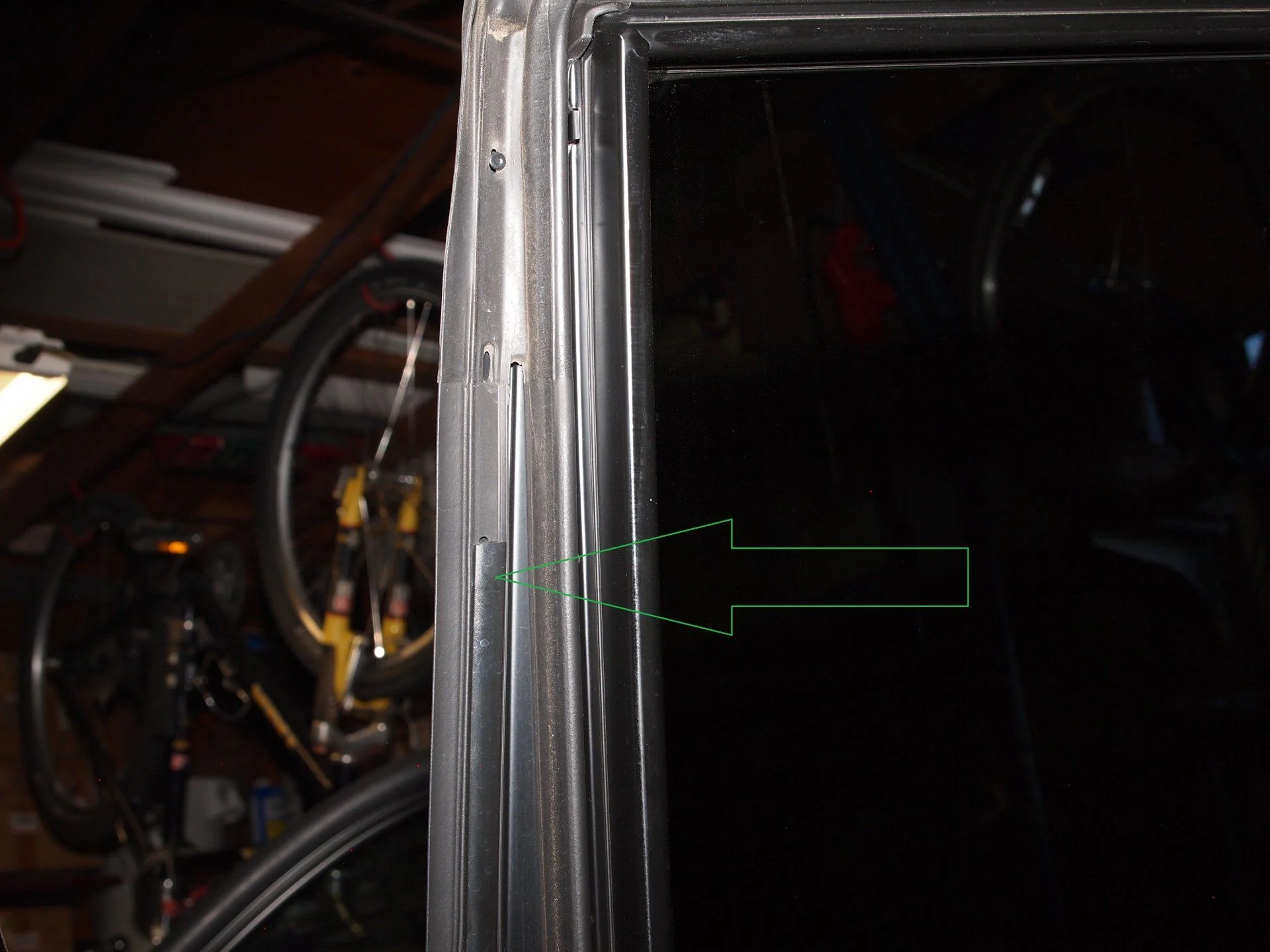

I've found a difference with 01 LC & 07 LC between the doors over B pillar. The 2007 has raised rivets anchors that a plastic strip attaches holding on rubber seal. No rivet anchors on the 01 LC rear door.
This piece was broken:

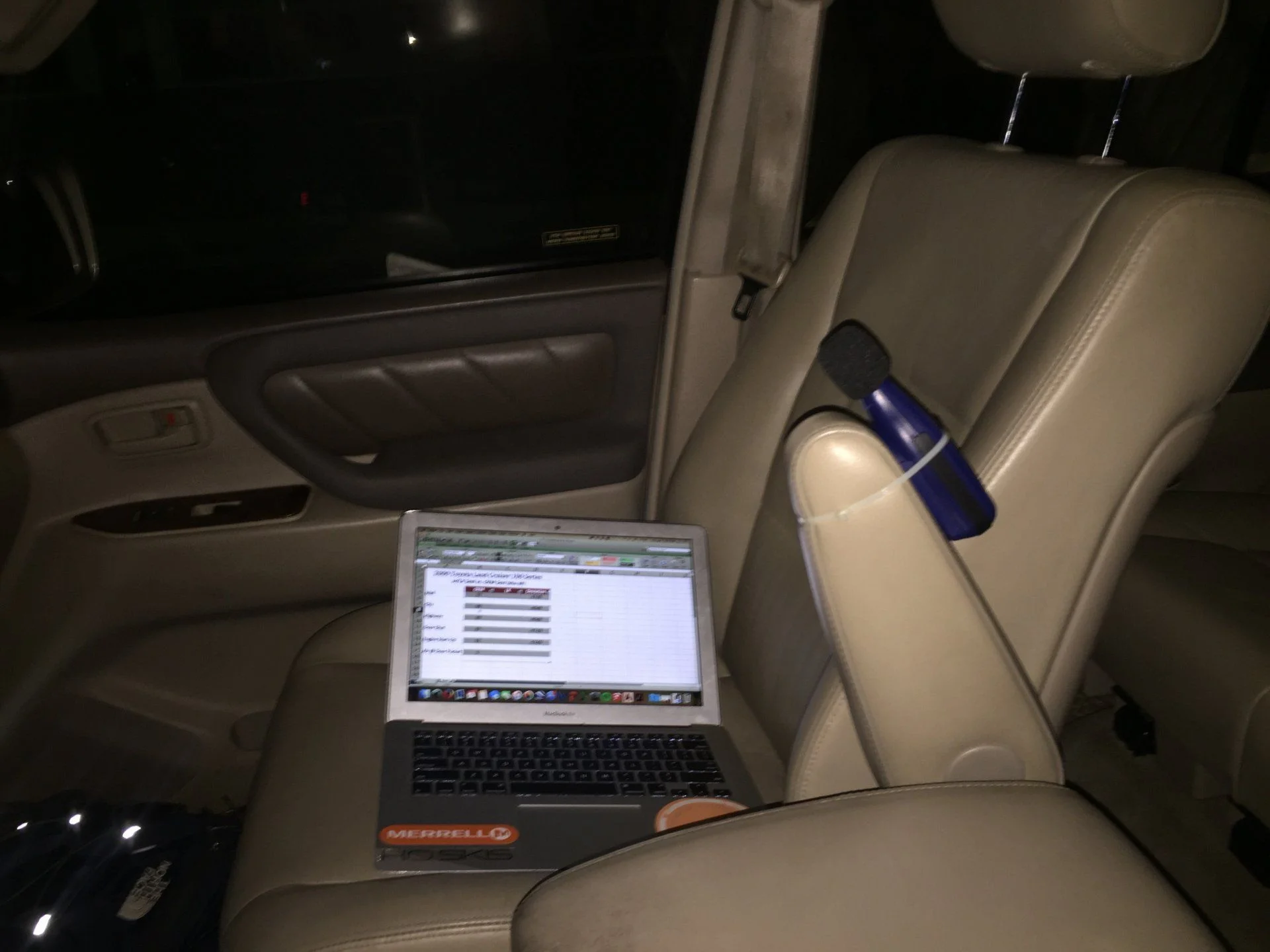

Thanks all. USPS shows the LX seals arriving tomorrow so I decided to start recording the control data without the LX seals during some free time today. I quickly realized a few things:
1) There are sooooo many variables that play into the noise that enters the cabin making it very difficult to obtain accurate results. Think of every variable you can, multiply by 3, and that's how many there really are. I just want people to realize the results I get are my results and that yours may vary. I don't run oversized mud or even aggressive all terrain tires like some of you (I'm sitting on Yokohama Geolander's), I don't run real high psi in my tires either (36), also Arkansas roads suck and there are a ton of potholes that make the decibel meter spike significantly, I can go on and on...
2) I figured out the best place to mount the decibel meter was on the passenger seat arm rest closest to the center console. My reasoning for this is that if I put it in the Ram mount by my knee I noticed a ~3dB increase as opposed to when it was on the arm rest. I contributed that to sound reflecting off the dash and also that is closer to the engine. It is also in a very good location inside the cab - almost in the center and away from anything that might reflect sound back and skew the results
3) I still managed to record what I think are accurate results for the control group after quite a bit of trial and error, as well as multiple attempts at each trial. After running a trial, adjusting a few things, running it again, and then running it a few more times to see if I get similar results I believe I finally got the technique down
Should have final results and my thoughts on if it's worth it by Wednesday. My expertly constructed experiment:

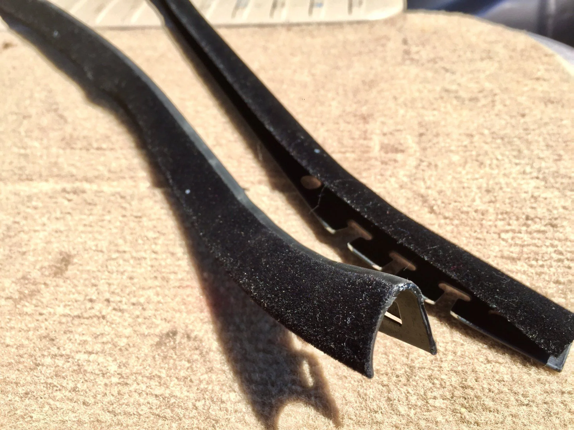

They are velvet-lined plastic strips. You actually have to remove the screws at the bottom of each door panel and there are matching holes on the weatherstrip that line up when you replace the screws. The ends are flexible and there's nothing holding them against the door, but once they are bent to the desired curvature they seem very rigid and won't move freely. I'm happy with them so far and first impressions are good!
