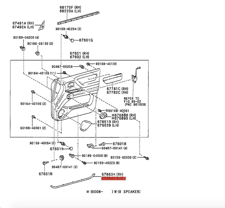

Is the part number possibly 67864-60020? If you look it up it appears to be the lower weather strip on the door but I'm not sure if it is the "extra seal" we're all talking about.
Has anyone confirmed this "extra seal" works and/or installed it? Or the one between the 2 doors?

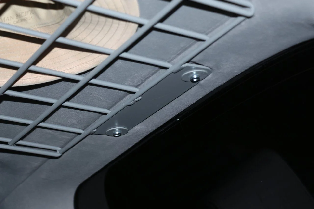

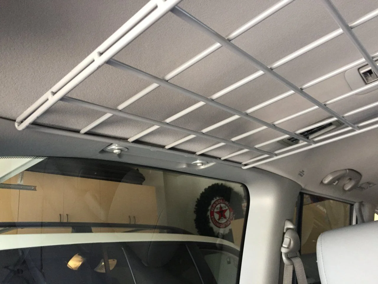

Having owned both a 2006 LX and Land Cruiser I always felt the LX provided a quieter ride than the Land Cruiser but never had any proof. Recently I installed a Attic Rack in both a 2006 LX and a 2006 Land Cruiser. The LX has more insulation in the ceiling also where the Land Cruiser uses raw plastic the LX has fabric.
The Attic Rack in the Land Cruiser bolts tight against the metal body.
The LX requires a 1/2" spacer at the same mounting location to keep from damaging the fabric and insulation. You can also see the fabric at the mounting location along with the window surround.
Phil, where did you get that attic rack? I like that a lot. Is that something I can purchase somewhere?
