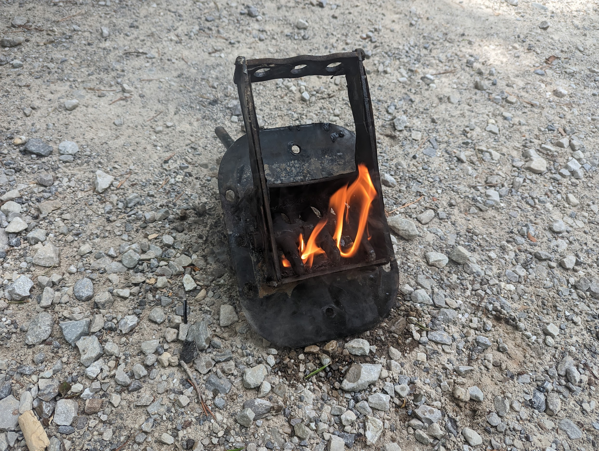

GSMTR 2023 was fun. Went to go do walden's ridge and my shifters were stuck. Pulled it apart and they all rusted together. Must have been from the last cape lookout trip, so that was great. Tried to take it apart on the side of the trail.
Got the cables out, but the rail didn't want to move. Set it on fire, but that didn't help.
Had to cut the rail into pieces, then drill out each section inside of each lever, then pound each slug out. Didn't damage the levers, but f*** me, that was not great. Replaced the rail with a piece of 3/8" round bar, drilled for cotter pins, with some new washers to set lever spacing. Since the rail is floating now, it seems freer than it ever has, so this appears to be an improvement. Anti-seize for the win.
that's a copious amount of antiseize. well played!

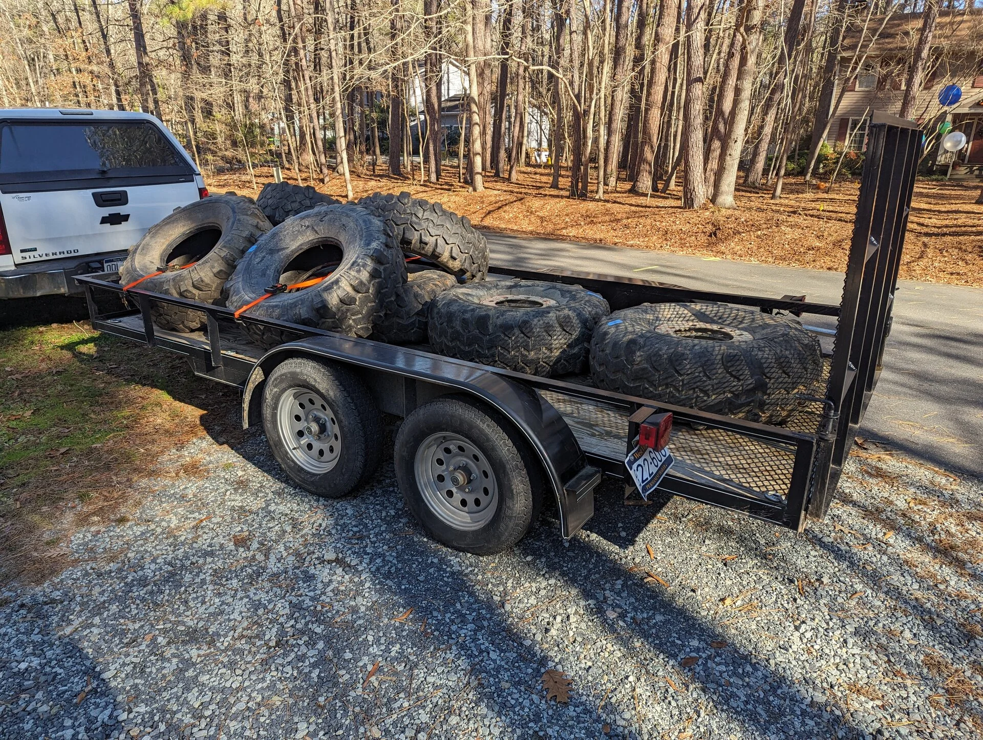

So what are the new tires?? :D

As for the new tires, haven't decided yet, but I'm thinking racelines and 39" reds.

You should have bought those 40" sticky Treps I had for sale! Your rig is too heavy for Reds. If you go slow and cone dodge, they are great. If you wheel Hard, they will cut. They are "the best" rock crawling tire. wish they were tougher. I destroyed a ton of Krawlers racing.

I trust you! Not ready to buy tires and wheels just yet sadly.
Which tire would you pick for moonshine, sticky treps?

Treps would work well, here on the East coast, or some Sticky SX swampers. On a Budget you could do some 40" Maxxis Razrs. If you want to make a trip up north, I can get you a deal on most large tires.
@Hokie LX found me a sick deal on a set of 37" bfg ats not long ago. 18 months old or so, and still have the nipples on them. A set of 5 for a grand. I'm a fan. They fit the truck way better than the old 315s.
