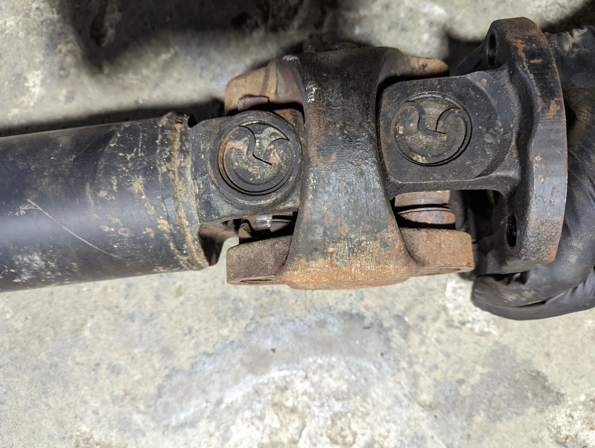

On the way to Cape Lookout, I had a ujoint wear out in the rear driveshaft CV. Appeared to be two caps of one joint in one axis, which is an odd failure. Center pin felt fine, didn't feel like tearing the whole CV apart to replace, so we went on. 350 miles of driving out there, around the island, and back home, and the vibe got much worse at low speed, but it held up.

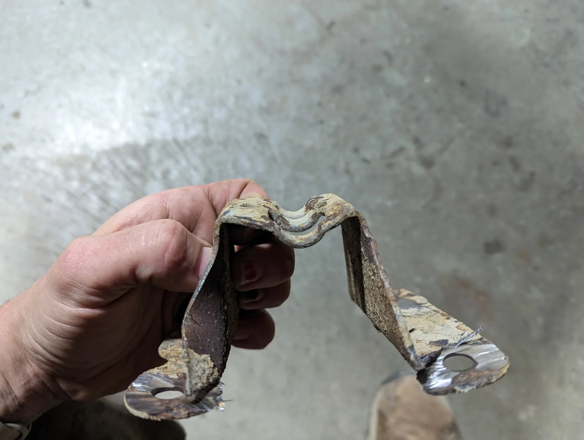

Just pulled the failed driveshaft out last night, and all four caps that are pressed into the outer yoke section of the CV failed. None of the other caps appear to have failed. Very strange. It's going back to tom woods to investigate and repair. You can see the three of the four broken caps in this pic, along with how the flange and shaft yokes are misaligned. Tons of slop.
I did see a scrape mark on the driveshaft from the OEM e-brake bracket I hadn't noticed on the other shafts I've had in this truck. Either way, it's outta there now.

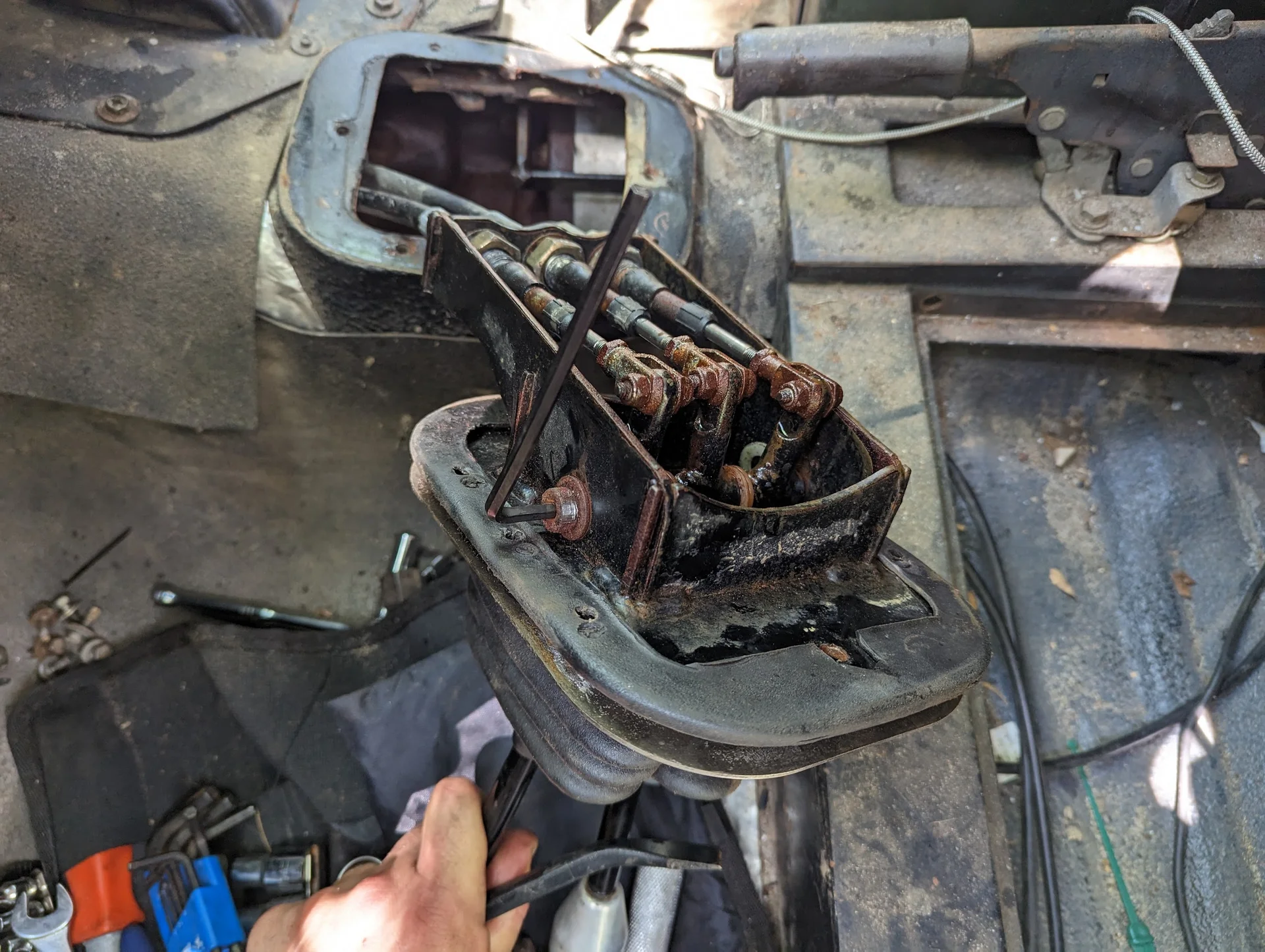

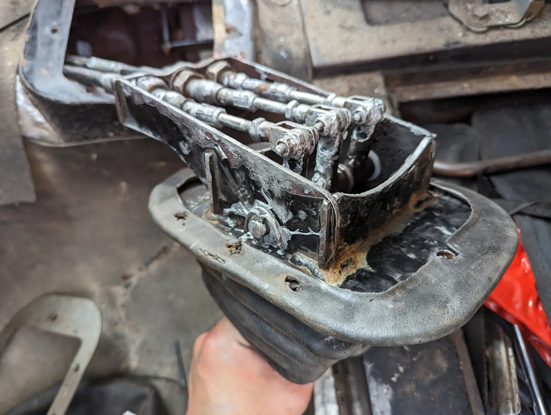

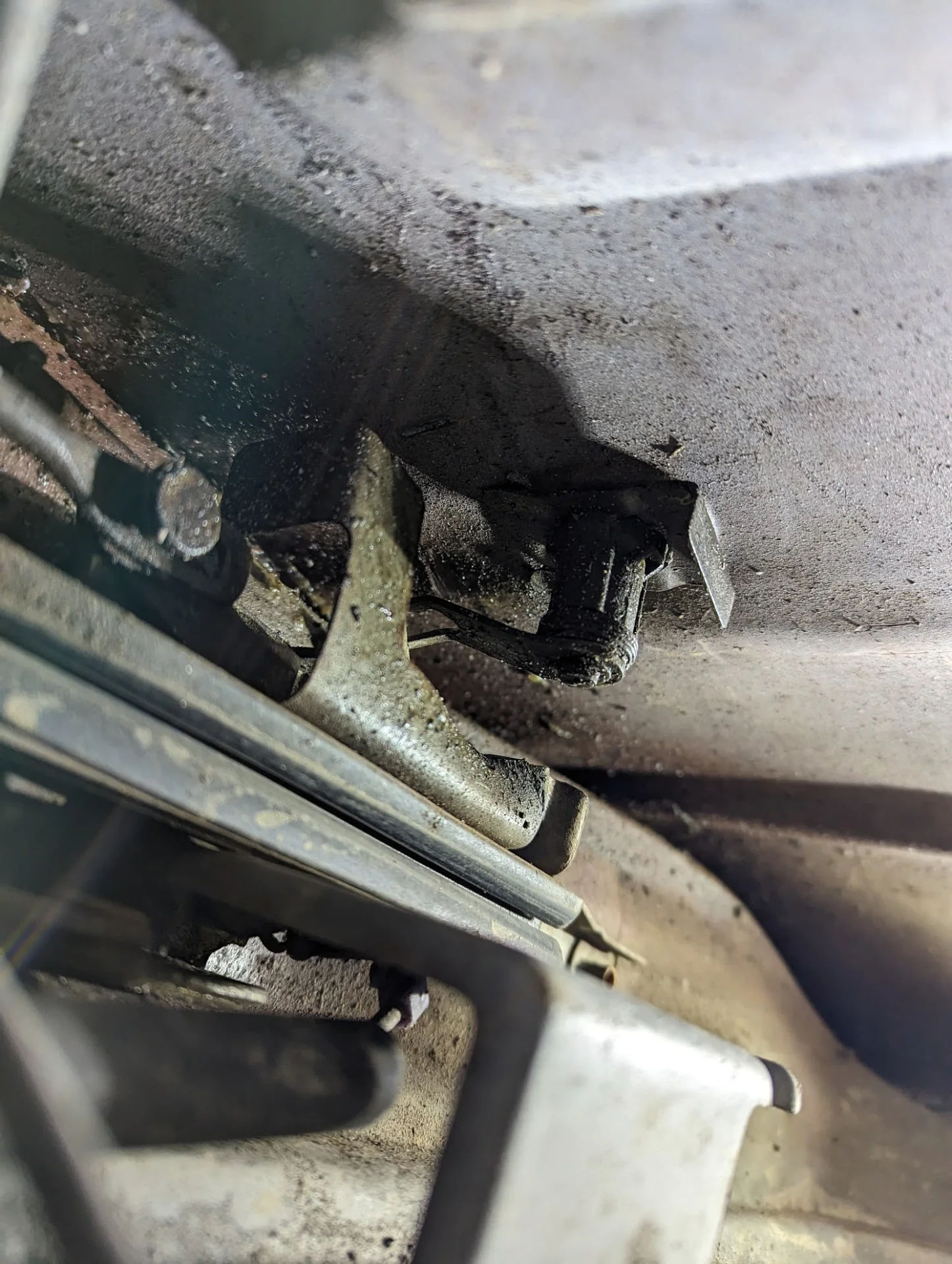

GSMTR 2023 was fun. Went to go do walden's ridge and my shifters were stuck. Pulled it apart and they all rusted together. Must have been from the last cape lookout trip, so that was great. Tried to take it apart on the side of the trail.
Got the cables out, but the rail didn't want to move. Set it on fire, but that didn't help.
Had to cut the rail into pieces, then drill out each section inside of each lever, then pound each slug out. Didn't damage the levers, but **** me, that was not great. Replaced the rail with a piece of 3/8" round bar, drilled for cotter pins, with some new washers to set lever spacing. Since the rail is floating now, it seems freer than it ever has, so this appears to be an improvement. Anti-seize for the win.

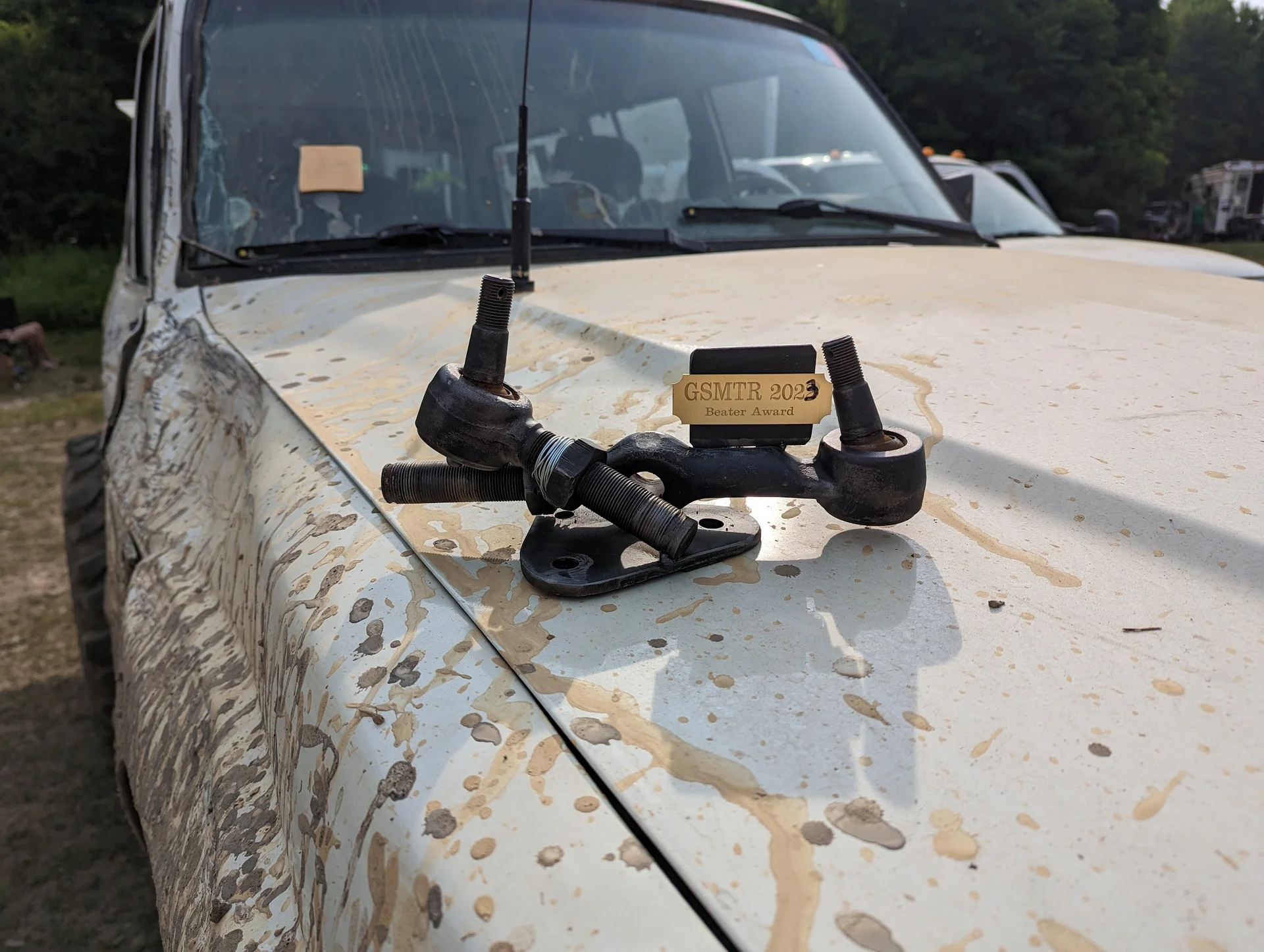

Then, I won the coveted beater award :grinpimp:

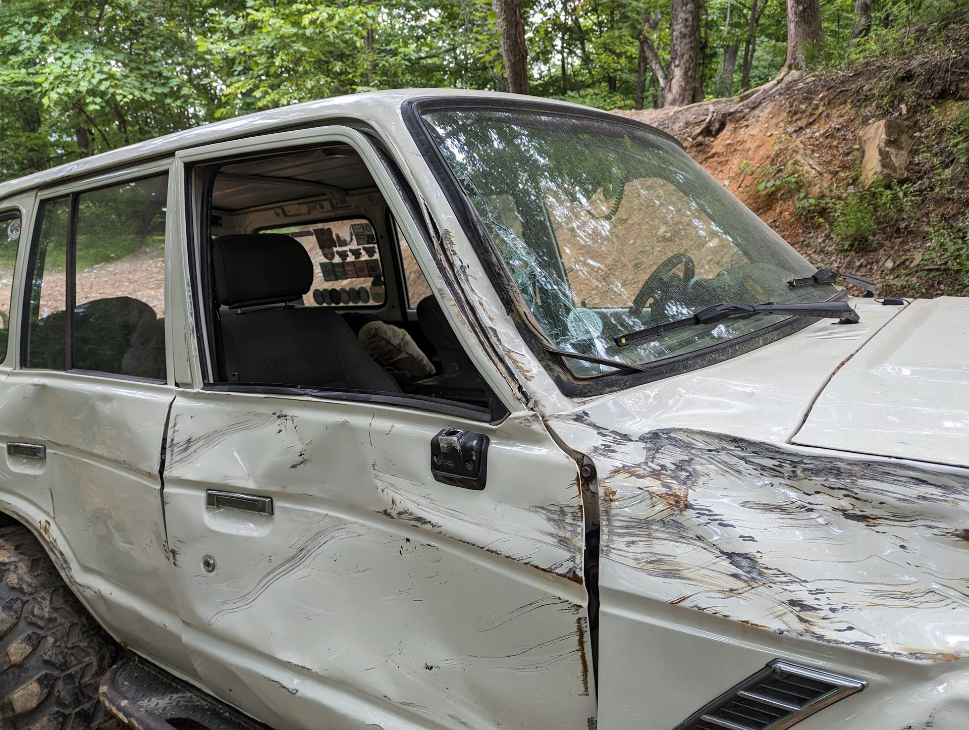

Since moonshine doesn't keep the rain out anymore after popping the ps front door glass and crushing the a-pillar, she's gonna live in the trailer for a bit. I'll pick up the parts I need, straighten the a-pillar, then mull over putting a cage in this thing. @Hokie LX gave me a killer idea for putting the a-pillar cage bars inside of the body a-pillars, so we might explore that later this year. Once I get a cage in it, I'm applying for Ultimate Adventure.
Ouch. Body took a beating. Ever thought about more tube work like tube doors? I like your buddy's cab exo coming through the fenders.
It would be awesome to see moonshine on UA.
I have thought about tube doors, but half the time at windrock (east coast in general) it's raining. With these tires I'd be about as dirty as the sxs guys. Plus, instead of the door folding, tube doors would **** up the pillars more I'd bet.
I've got a set of front doors I plan to make into half doors, so that should scratch the itch.
UA has been a dream for a long time, but the cage requirement kept me from applying.
