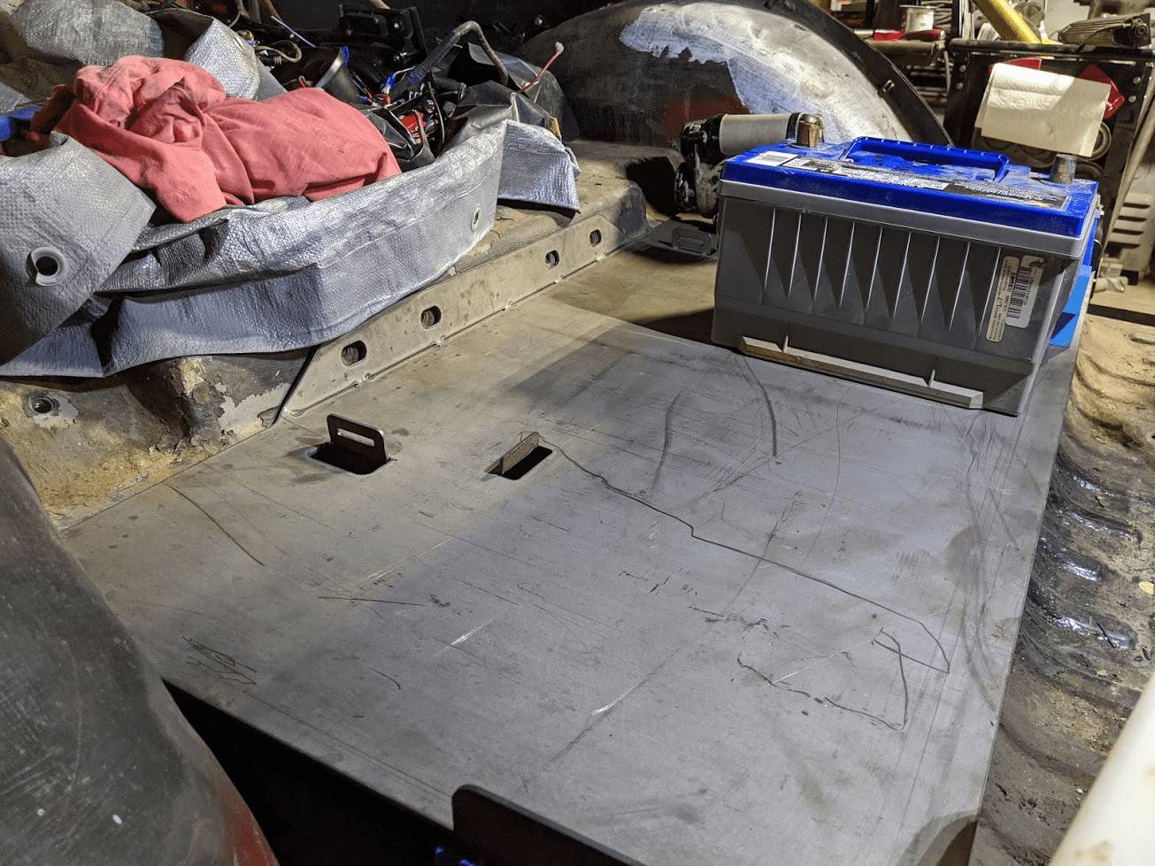

Got the tray to a point where I could bolt it in. Braced between the feet with a 1/4" bar cut on the table, because that's what I felt like using.
Designed and cut out a header panel that will protect the batteries from junk i throw behind the rear seats, and provide mounting points for the future sleeping platform. Used tread plate because it's what I had. I think I like it.

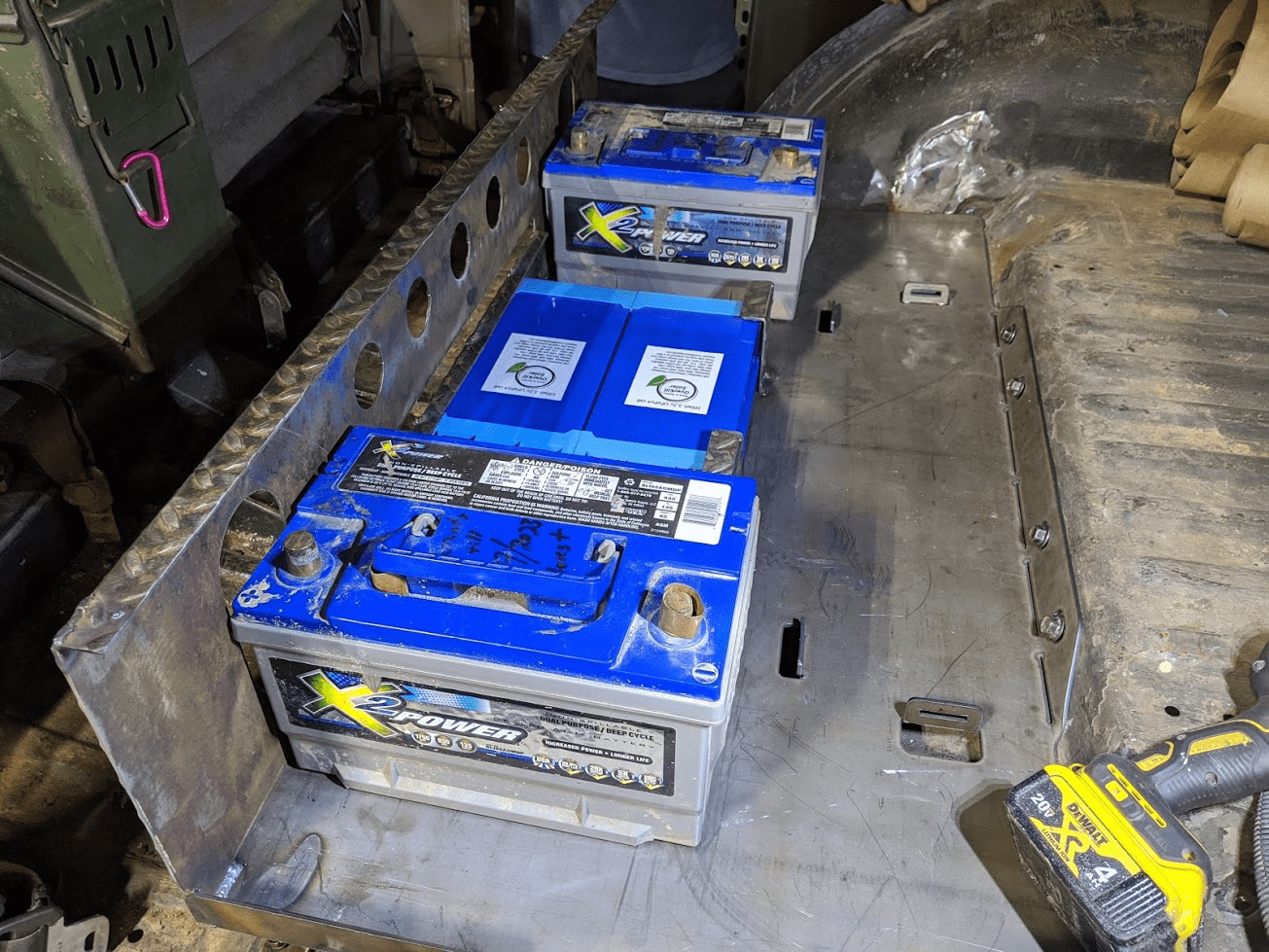

This is the final arrangement of the batteries. LiFePO4 in the center, held in place with tabs with enough room to get them in and out through the top. They'll be insulated when they go in for the last time. The AGMs will be mounted in the same trays I built for the front a few years ago, with the brackets cut off. I think I'll juts weld them to the base plate. Water tank is at an angle because the back bolt heads are too tall, but I've got a fix for that.
Once I get the AGMs mounted, I can move back to wiring the rest of this up.

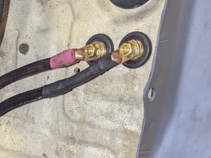

Ran bulkhead fittings to get powah from the batteries to the starter and alternator. Thanks again to @J Mack for helping me get to this point!!!
Hoping to get some more done tonight, then do a full systems test.
This it's pretty neat .. love it .. where did you got it ?
Agree, very neat. Makes it easy to connect to the winch from this point as well. @J Mack turned me onto them.

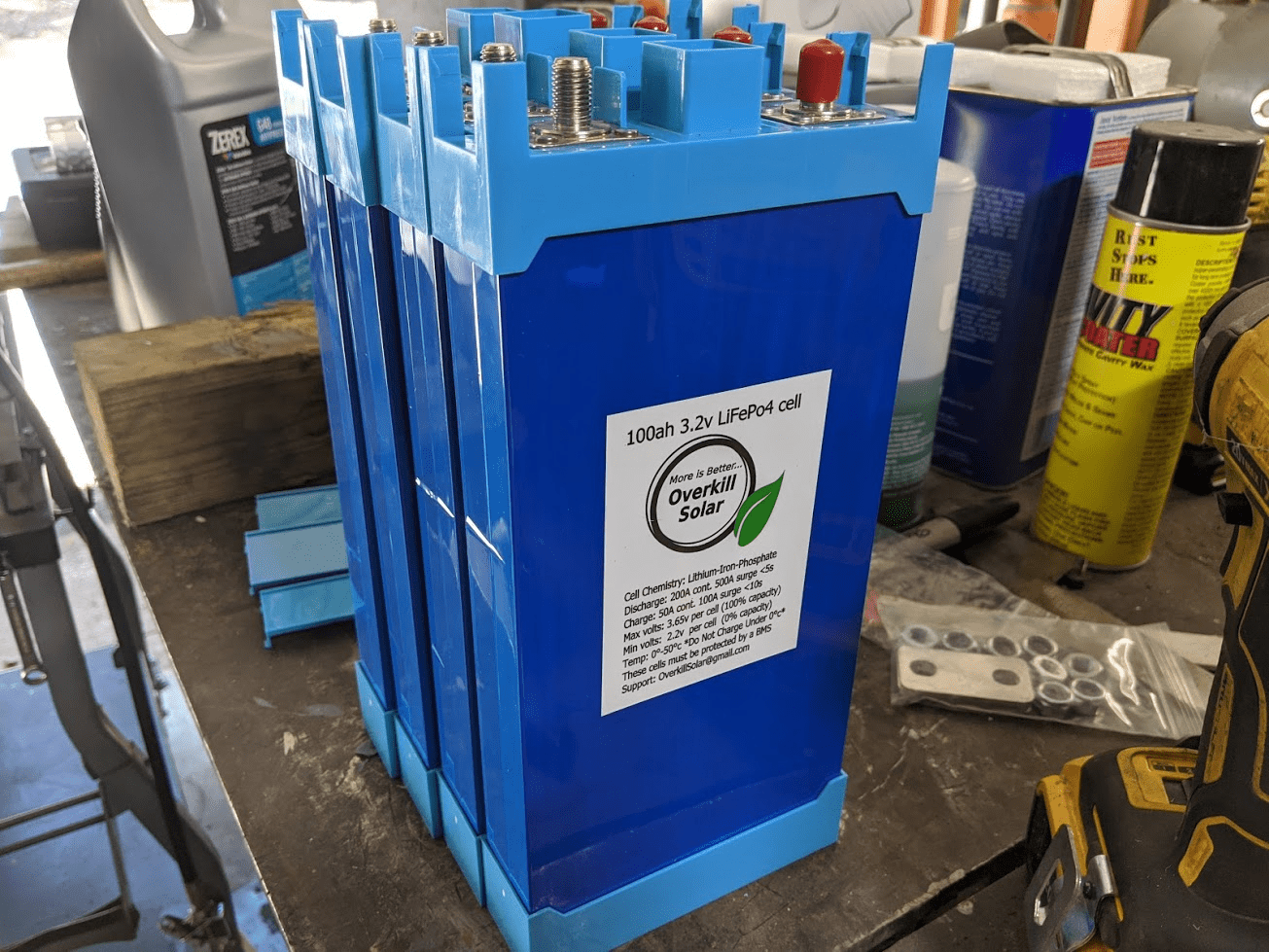

Tried to charge up my LiFePO4 battery bank with a regular battery tender I had around the house. When charging up my AGMs, it would bring voltage up to ~14.2, which is about what my alt will put out, so I figured it would serve as a test. Unfortunately it seems these types of battery tenders are amperage controlled, not voltage controlled, so it was only charging the LiFePO4 bank at ~13.5 volts, but a full 5a, which was the tender's rating.
Data below. It looked like it was working despite the low voltage, as lithium banks should be charged at about 14.6v. Amperage was going into the battery bank (as registered by my battery monitor, and BMS), but after disconnecting the tender, the cells would balance themselves and the amp hours would drop.
Anyway, this proves you can't use a regular battery tender charge a LiFePO4 battery bank, at least not like the ones @J Mack and I have.
