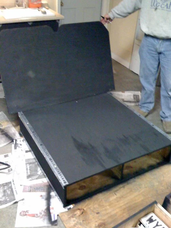

The astute (and long-time) readers of this thread will say "Hey Johnny, why does that painted black plywood look familiar?".
Well Mr. Observant, that's because this piece of plywood has been riding around in moonshine since ~2008, sleeping platform 1.0. Here's a pic from 2009 when I painted it black. Thought it was neat that I was able to reuse this wood from so long ago.
