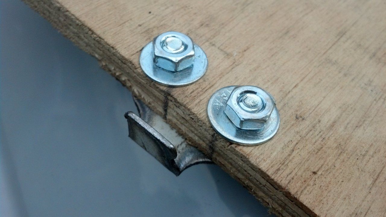

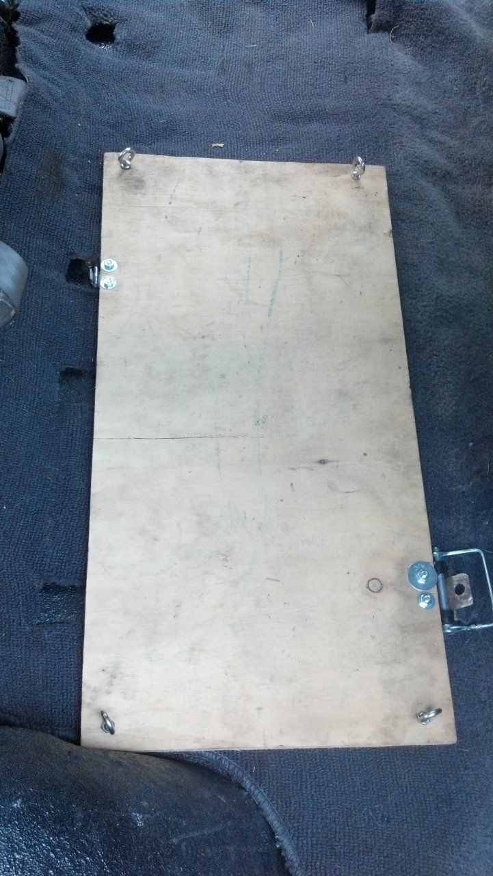

The fridge sits on a piece of plywood, hooked to it with the ARB handle tie down straps to 4 eye bolts at the corners of the plywood. The plywood is held down with some brackets I built that go to the existing floor seat mount brackets. Low tech, low buck, but functional.

Right, so you haven't built a platform around the fridge, it just sits alone on that platform on the floor, right?
Oh, and that hole in one of the brackets can be used to attach a ratchet strap for other stuff...
