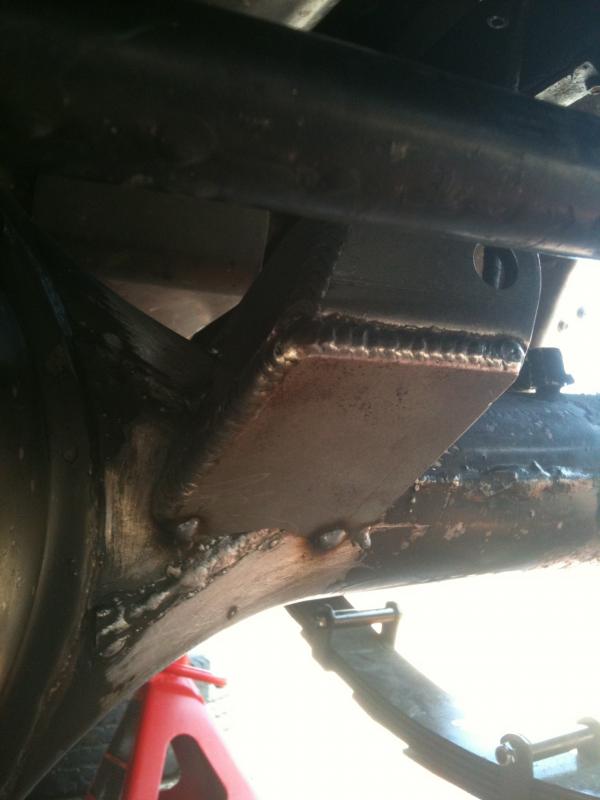

Prepped the front axel to weld side axel shock mounts and HA bracket. Test fitted HA ram and checked stroke for clearances, all is a go. :clap: I can truly blame IH8MUD for feeding this sickness:flipoff2: I'm going to have to go to therapy three times next week:D
Axel Shock Mounts
Got the side axel shock mounts welded on and painted.:clap: Gained about 3-4" of droop travel and the shock is in a better position to utilize shock travel more effectively:cheers:
That's exactly where my shock mounts are on my front axle. I wonder if you'll have clearance issues with it set up like that.
