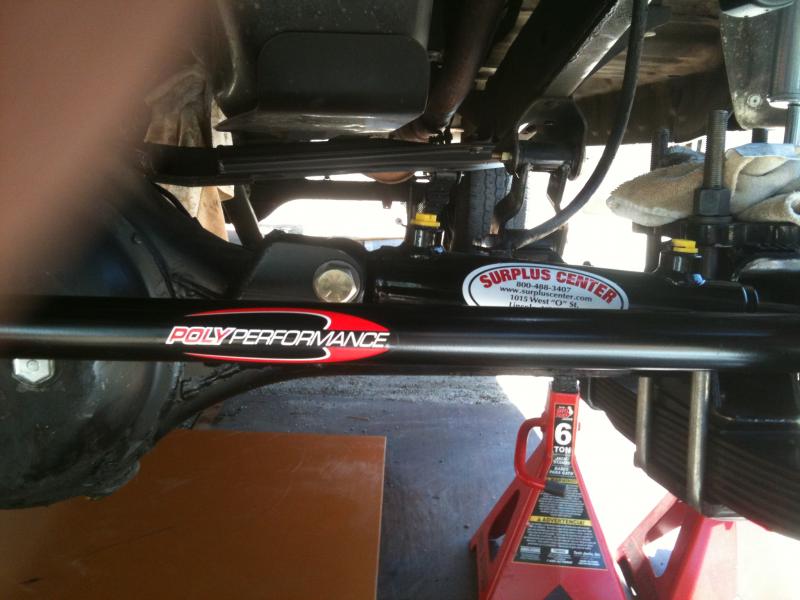

Working but got More Goodies Today
Picked up my TRE's, 4+ monster tie rod at 1-3/8 .285 wall:), relay on back order:mad:Hopefully this weekend can get tie rod installed work on the tie rod attachment to new rod and some TRE's, and get the rear axel pushed back. Also Put back together the ported PS box and may install this weekend also:cheers:

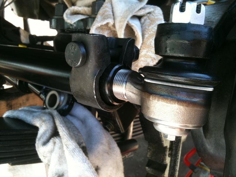

Tie rod & TRE's
Got the old tie & relay rods out:) installed 555 TRE's and lightly installed and test fit the HA ram. Tie rod is huge compared to stock and about 1/2" clearance off front of pumpkin;) Definitely HD enough to handle the ram. Getting a PSC 1-3/8" clamp system for tie rod attachment of ram. This will allow fine tune adjustment, ease of install and looks clean!:D

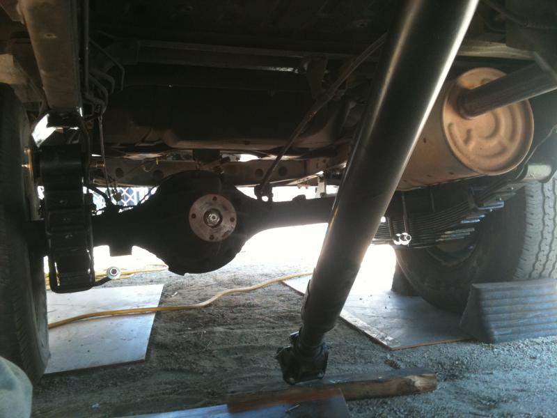

Rear Axel
Got the rear axel pushed back 1", used 4+ blocks drilled for 1" offset. Helped a lot and gave the rear DS the room to slip:) Installed the longer u-bolts made by Deaver Suspension and will cut to fit. Installed the Bilstein 5125's on the rear axel.
I have found nothing in Bilstein info to indicate 5125's are position sensitive. And I can't tell you how many pics there are of body up & body down shocks. Yes some are position sensitive...But I will listen if someone can convince me otherwise. But if that were true then the fronts are in wrong? :)
More Pics of Todays Events
Got the rear u-bolts cut down to a more reasonable length;) Tightened up nuts and bolts. I like how the rear tire sits in the wheel well under normal load as well as freeing up slip in the DS since moving the axel back 1". The new front DS from Tom Woods should be coming this up coming week. Guess I can start the order for the Marsh Racing Wheels think I'll go with the 17" with a 2" BS. This will let me use wider tires and clear the shock bodies on the front end under articulation.:clap::cheers:
