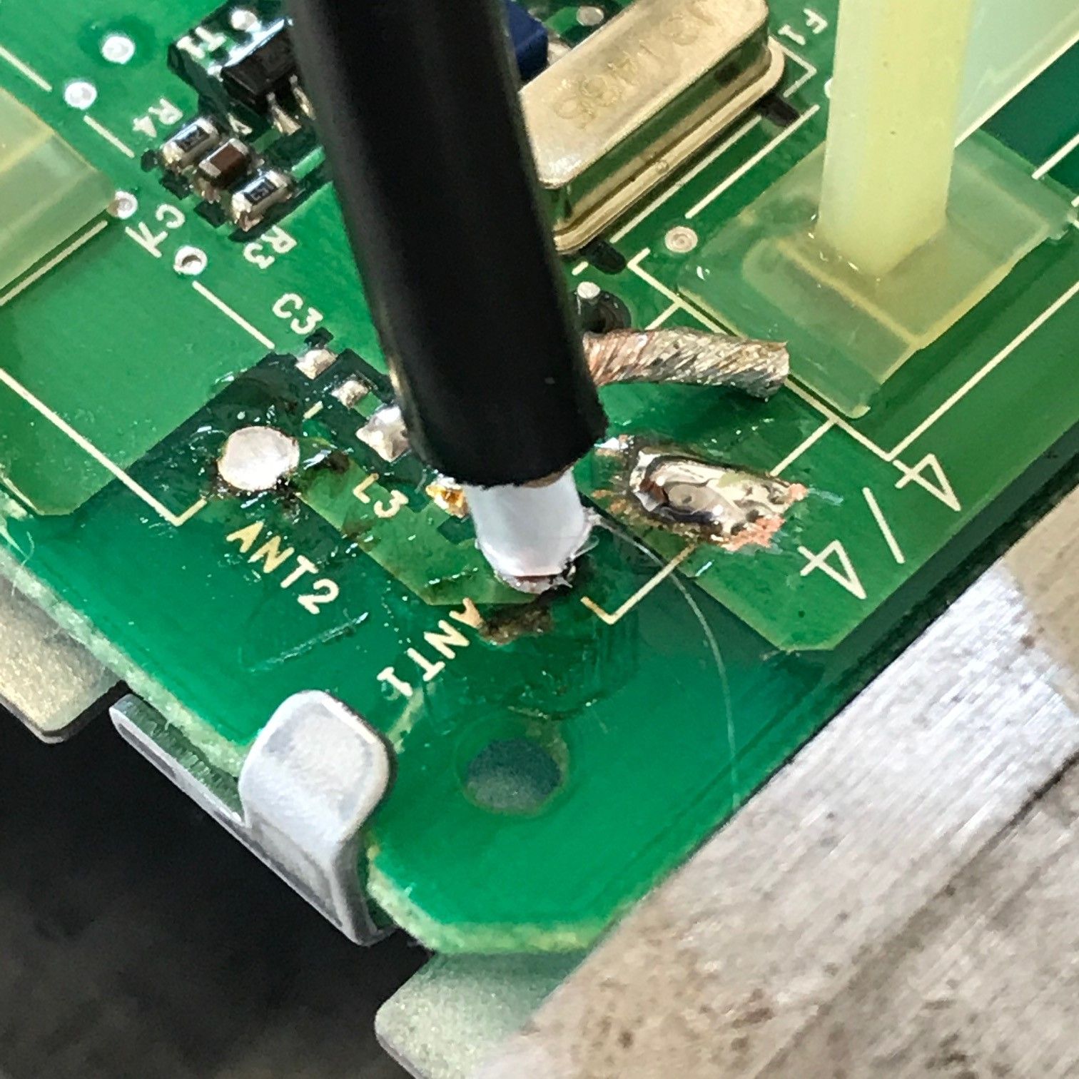

Remove the two antennas by desoldering them where they connect to the circuit board. NOTE: The part "C1", and any other parts that may be neaby, are DELICATE and easily damaged by a wayward soldering iron, so steer clear and be VERY careful not to knock anything else.
Next, use a knife to gently scrape away some of the green coating from the large copper section next to the antenna connections, exposing grounded copper underneath. The circuit boards can vary in design, look at the other pictures later in this thread to be sure you’re exposing the correct copper section. Again, be very careful of other components, scraping AWAY from them.
Apply some solder to the exposed copper area.
Next, prep the coax cable as shown below. If your cable has two connectors cut off the one you don't need (double check by screwing on the antenna) and strip away a small (1/8") length of the center conductor. Gather the braided shield together and apply solder to it to keep it together.
Solder the center conductor to the ANT1 hole (either will do, electrically), and solder the braid to the exposed copper pad.

Next, use a knife to gently scrape away some of the green coating next to the antenna connections, exposing copper underneath. Again, be very careful of C1, scraping to the right, AWAY from it.
