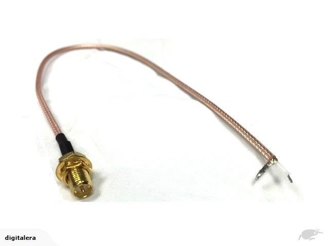

Is there room to mount an SMA connector to the board? It would make for a cleaner install, I think.

Mounting a rigid SMA jack directly to the board would depend on the jack’s design, there are a ton of different configurations. A better option would be to install a jack through a hole in the plastic cover with a short coax pigtail to the board. That would also eliminate strain on solder joints.
Something similar to the above is: 0897611670 Molex, LLC | Cable Assemblies | DigiKey

This looks like a great solution, actually. The thinner coax would be easier to work with in the box and the bulkhead connector would be an easy install. Any reason why you couldn't use the more flexible RG178 all the way to the antenna? Seems like it'd be much easier to run.
You could use any type of 50-ohm coax cable. The pigtail cable above uses smaller coax because it's meant to install in an enclosure (like ours) and a tighter bend radius helps to wind around internal components for easier assembly. For outside the box the smaller coax may be too fragile and more expensive in longer lengths. The black jacket of the larger coax cables are mostly for durability.
