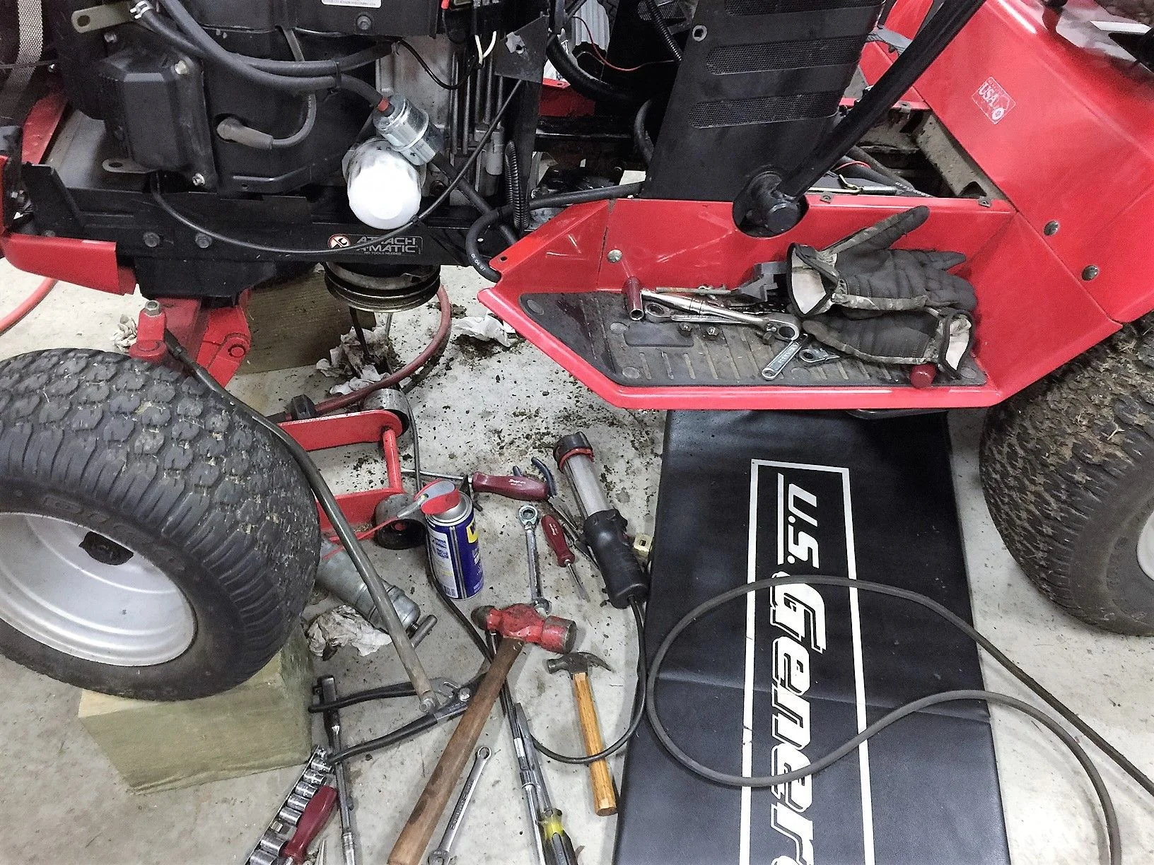

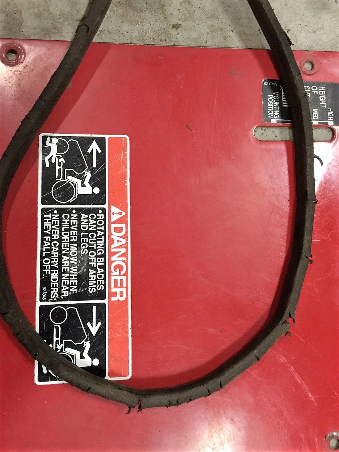

I finally got the Toro engine up and running after cleaning the micro switches and all the other electrical connectors. While I was under the Toro I noticed the hydrostatic trans-axle drive belt was full of cracks and pretty beat up after 18 years of use, so decided to remove it and in the process had to remove steering and pedal components.

I've never seen before a belt so badly worn out.

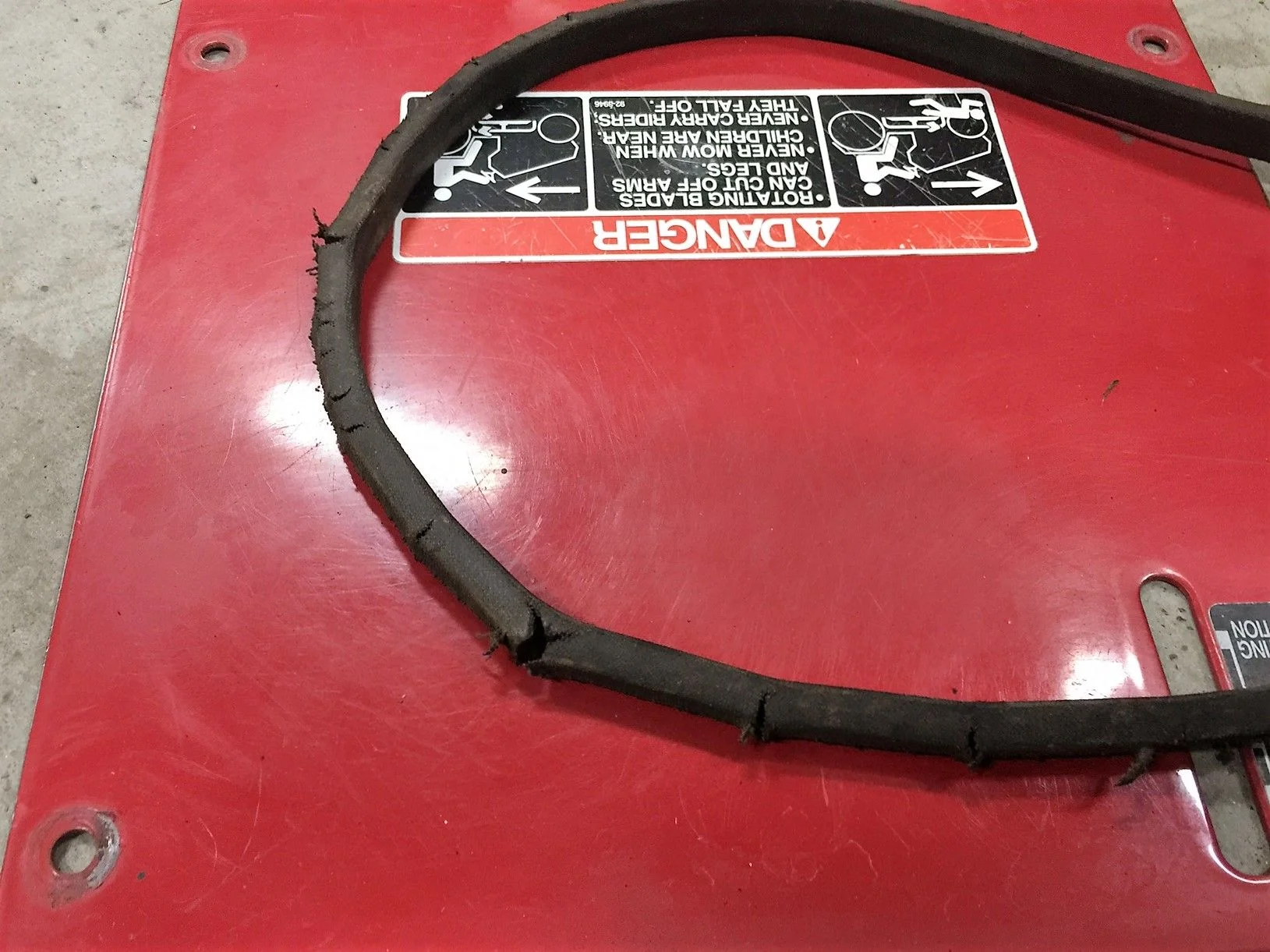

Looks like it still has a good 6 years left, Mike :smuggrin:
The work never ends does it? Your lucky you caught that.
I did catch it in time, but it took all day to remove the old belt, for a moment I thought it was a German car!
Two things -
Have you ever checked the electric clutch on that Toro and adjusted it ? I see a lot of material showing on the pulley , or maybe it's just dirt .
Second - what is the US General thing under the Toro , a creeper ?
Sarge
I'll be cleaning it prior to re-assembly, how do you adjust it?
The US General is a Harbor Freight creeper mat, I use it for small projects, however, this one turned out to be big. I should've put the old Toro on the lift to make life easier.
