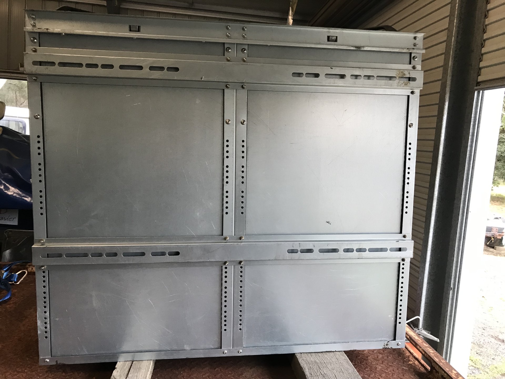

Been thinking about a layout for the rear for touring, have a 60lt Engel fridge freezer combo that I have had for years. Bought a Engel fridge slide for that 2nd hand still in the box for a good price but wanted some drawers. After deciding I wanted two stacked drawers I saw someone’s set up where they cut some Titan drawers to make a stacked set up. This is what I wanted.

I just had a look at my Titan frame which is now on the bench. Looks simple enough to cut the floor mount cross beams in half, then change the bolts holding the inboard bearings as these keep the two drawer casings together. If piggybacking doesn't work out it's simple enough to bolt the halves back to original side-by-side configuration using the longer bearing bolts
In case you don't have the instructions....... to get the drawers out, pull the top decks off (remove all tiedown points and any screws around the top edges), then remove the internal bump stops. Be careful; the stainless screws are crap quality shallow-head jobbies and very easy to round out with an allen key.

Then moved onto dismantling and cutting the drawers into stackable items. After pretty much removing everything I noticed some rivets were not fitted correctly so drilled them out and fitted new ones. Also cleaned up a few sharp edges on the steel as l was handling and lifting these around a bit. You can see the rivets in the pictures below, l guess that’s what cheap quality means. I also cleaned the glue overspray off the fridge slide runners.
The cutting was straight forward.
One drawer mounted up for positioning, am thinking of adding another side bracket to the floor to stiffen up the drawers and making some flat brackets to mount to the sides to attach the top drawer. Trying to keep the fridge slide on the bottom drawer.

Good to see you are using the 3rd row seat bolt holes to secure the base, particularly as both drawers and their contents will now be held by half as many fasteners as the side-by-side configuration.. The instructions suggest using the tiedown bolts but they are frightfully small.
Not telling you to suck eggs, but be careful not to use too long a bolt. Those holes are not 'bottomless' and I think the fuel tank sits pretty close....
You may also find the frame won't sit dead flat on the floor as the 80 cargo floor isn't flat. Shim it with washers if needed so you don't twist the frame.
