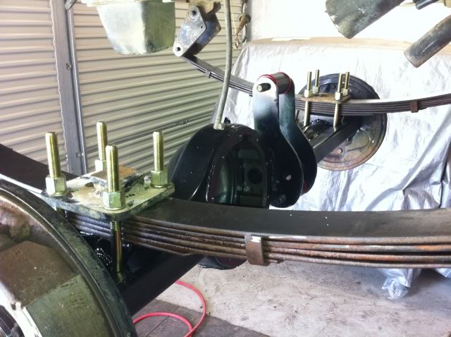

I have already moved the fixed pin hanger back so I could you 60 series springs instead of the 70 series ute springs. I could move them forward a bit as they are only tacked on, but it would be a bit of a pain in the arse. I'll have a look at it today and see how hard it is to cut the tacks off. Incidentally I would have thought having the longer shackle would give more travel, the arc in which the shackle would cycle in would be larger resulting more travel, that's my understanding of it. What's your thoughts mate?
exactly, longer shackels allow more movement and better articulation.
i was thinking the shackel end moved back toward the rear of the frame would allow better departure angle vrs moving the fixed end ahead ...
well, that is my thinking anyway.
Oh ok, well I'll be flipping the springs, as in re-drill the military wrap leaf so it will move the axle back, so after it's all done the axle will be about 3 inches further back than it is now. I might just stay with the longer shackle idea at this stage but leave the fixed pin tacked for now in case I want to change it.
longer shackel is a good idea, the rear won't be affected by caster. how long will you need to make it?

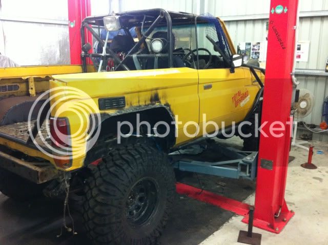

The cruiser is back on all fours! Here's some progress pics.

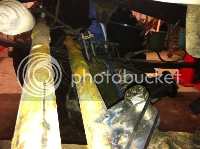

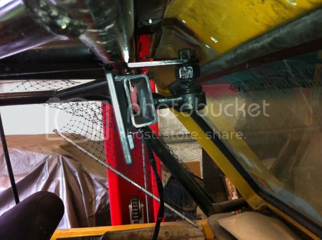

All Braced, shaved and the ladder bar bracket.

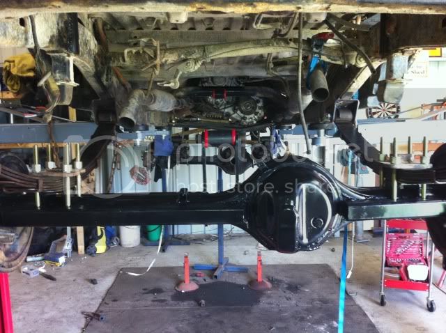

New axle location, about 4 inches further back than before. I moved the fixed spring hanger back to match the length of the front, redrilled the wrap leaf and flipped them around.

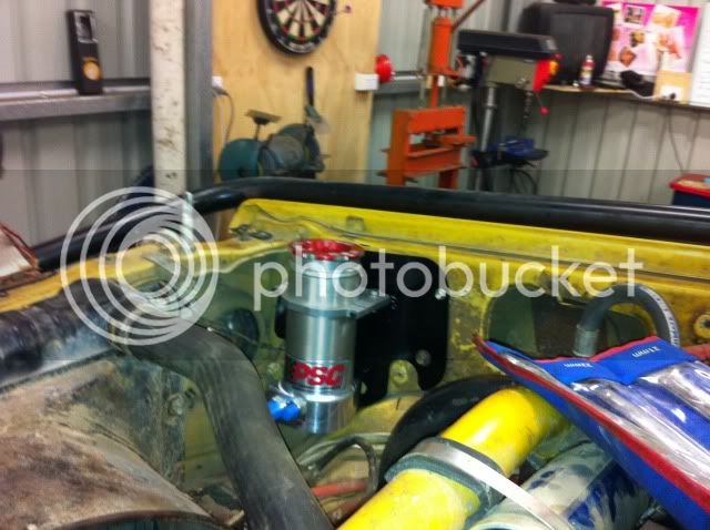

Reservoir for the hydro assist

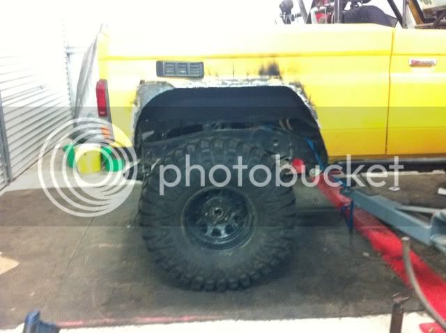

The new ride height, its about 2'' lower in the rear now than it was before.

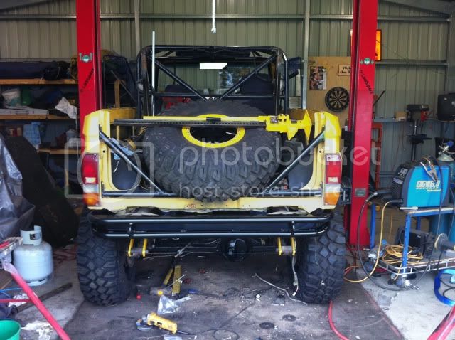

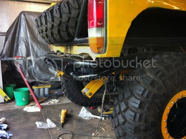

Here's the new look rear end, new rear bar, new tyre and hi lift jack mount, fully sick yellow shackles.

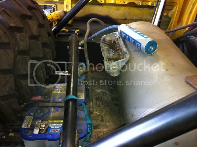

Gas tank mounted and new spot for the batteries.

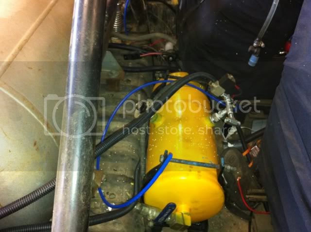

Air tank, will run the front locker, air free spool, the ram the engages 4wd/2wd and probably a air horn.

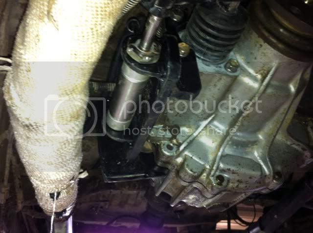

The air ram 4wd/2wd

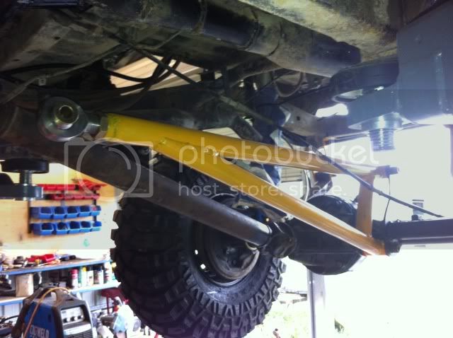

New wrap bar

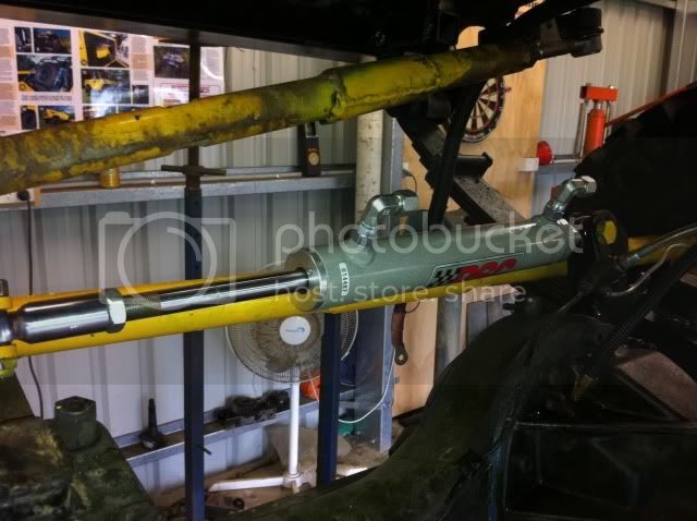

Hydro assist ram mounted, all the hoses are done, just got to put them on and fill it up.

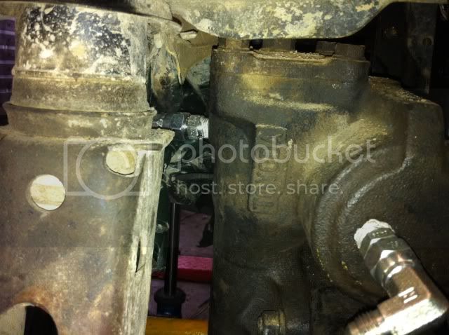

Tapped the steering box

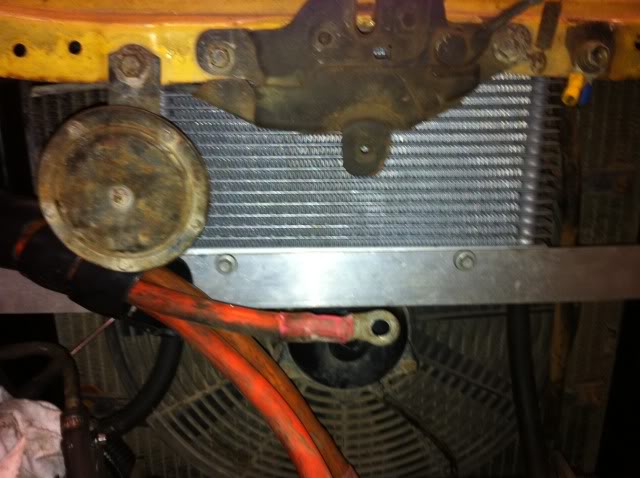

Cooler for the hydro assist

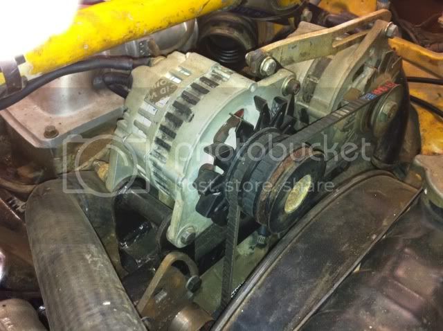

Simmo went through and remade the alternator brackets from scratch

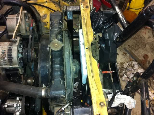

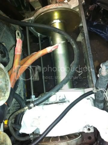

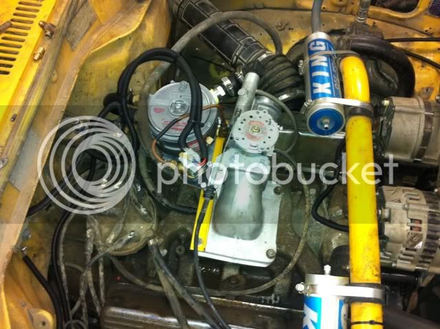

Radiator spaced back 100mm to make room for the winch, new fan shroud fabed up

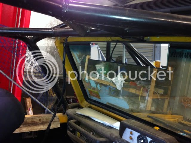

My heavy duty rear view mirror

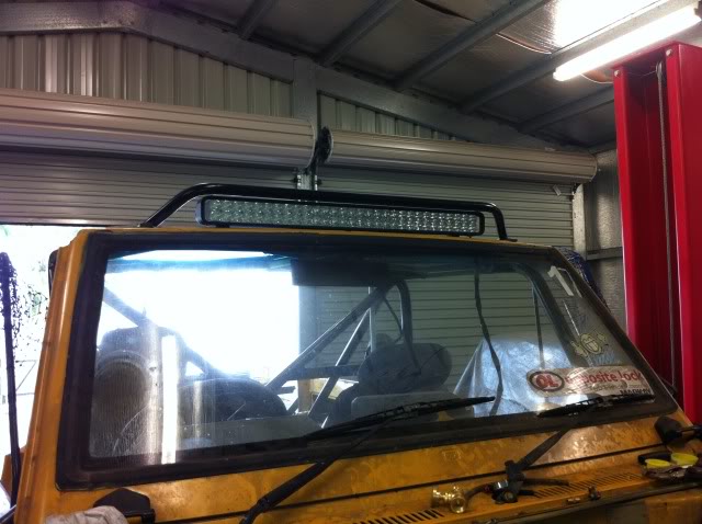

32" light bar, I'll be removing the spoties from the front as they look pretty dicky. I've got a 10" light bar coming for a reverse light which means I can get rid of the other lights on the back

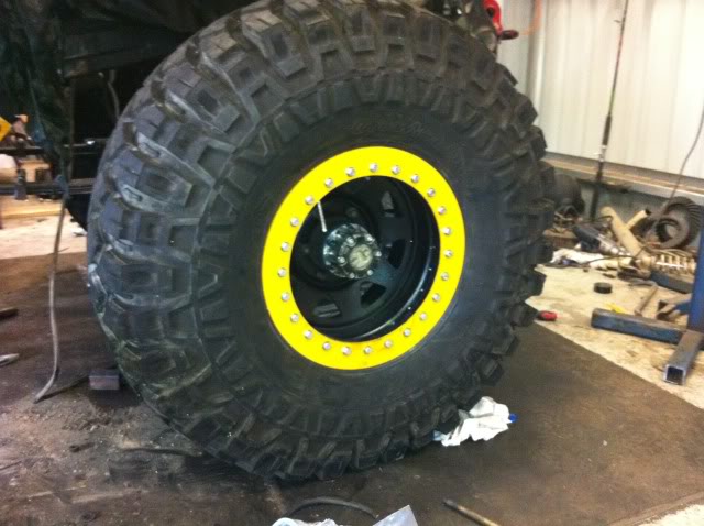

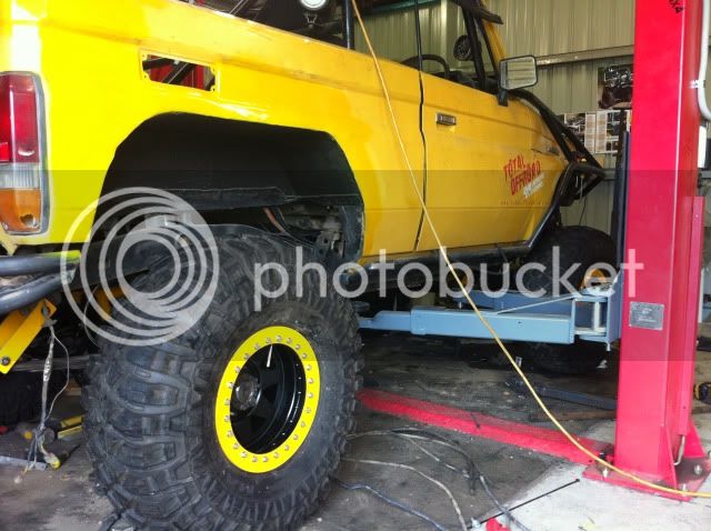

Beadlocks went on yesterday.
Thanks mate, I'm pretty happy how the bar turned out and the whole truck is shaping up in general. I'll take a photo later on to show a comparison between high beam and the light bar, it will only be on the shed wall but will give an idea anyway. I think they are pretty bloody good.
