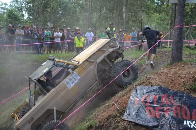

Easter is all done and we had a ball! We placed 16th out of 25 and didn't break too much. With more seat time and practice we can only improve. Here's a heap of pics mostly taken by the missus.

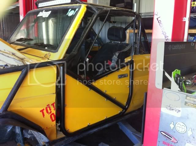

Only a couple of days until we make the journey down to Lowmead for the 3 car comp. We had a test run last weekend which resulted in me blowing the spiders gears in the welded rear diff, no great to do 2 weeks out form the comp but better to do it then instead of in a couple of days time. My door were looking worse for wear and I had a bit of a quiet week last week too so it gave me time to have a go at making some tube doors which came out pretty good and I'm happy with them.

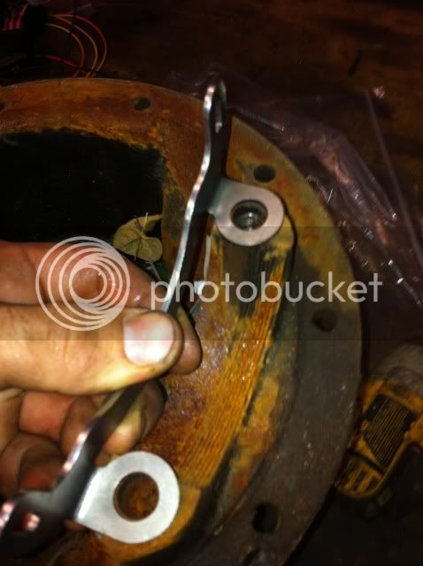

The fitted E-locker
In the photo I'm holding the bracket that hold the contact hub, for lack of knowing the actual term for it (where the wire goes into the mechanism). I didn't find it until I had already put the diff and axles as it was in the bag with the zip ties and it's not on the instructions anywhere so look out for that if anyone is putting an E-locker in there car.
The finished tube doors, the missus is sewing the finishing touches on the window nets next to me as I type.
