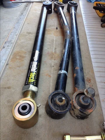

I had debated upgrading rear LCA's to something a bit more stout... but Uwharrie forced my hand. I slipped off a rocky stretch when I lost traction, and bent the LCA both upward and inward.
I did my research previously and went with Metal Tech's model. From my research, others require re-drilling and/or using stock hardware, however Metal Tech's comes with new hardware made for the 100.

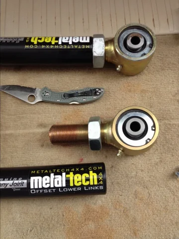

These also include Johnny Joints for up to 30* lateral motion to increase flex in long(er) travel applications. I'll likely never reap the full advantage of this, but in case I do I'm ready. They do need to be serviced, but from what I've read its around 30k miles for high use applications. For more information on Johnny Joints, you can view their video here.

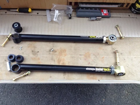

Start by taking out one LCA (if one is bent, use the other).
Using one of the new LCA's, rub some moly on the metal bushing tube, and insert into poly bushings. Whack it with a rubber hammer to sit snug. Grab your grease gun now if you want to top off the Johnny Joint (you'll see why below)
Use the stock bolts to line up the holes and extend the threaded end to your desires to correct pinion angle. Wade from MT recommended 1/4 to 3/8 when running a 2" lift.

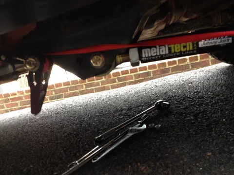

Install new LCA. You may need to use a ratchet strap to compensate for the extended length. Strap one end to the axle, and the other to rear hitch, etc.
Insert new bolts and snug it down. I went to ~90ft/lbs.

- I wanted to keep both zerks facing upward to help protect them. There isn't enough clearance between the frame/Johnny Joint to grease it up, so I will need to improvise a 45* zerk, or 90* grease gun adapter.

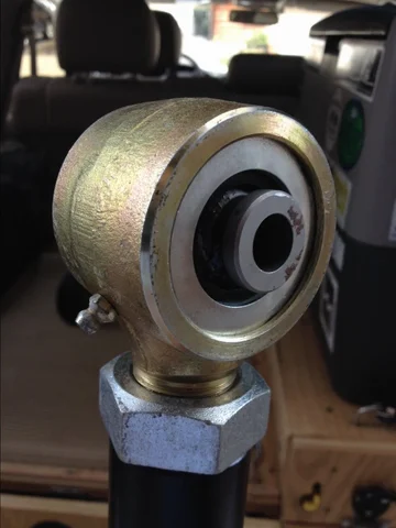

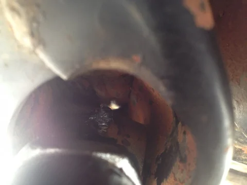

Here is an up close shot of the zerk thats tough to reach, not sure what others have done, but you may consider getting a 45* zerk before you install. I say 45* vs 90* because with the angle its mounted on the forward end, it should be just right - likely around a 70* angle overall. 90 may be too much.
I'm going to try this little gem I found on Amazon which should enable me to get the nozzle on to the zerk inside the forward frame mount for the Johnny Joint.
