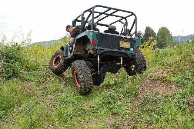

Next was the most major pain in the ass part of this whole project. My 4 link set up. I've always like the 1/4 elliptical set up and doing a lot of searching I decided to go with the F250 springs like Jack Rice, Mace and Chris (DHONDAGOD) used on their rigs. I have managed to keep the height the same as a standard SOA which I am pretty happy with. I has allowed me to keep relatively low to the ground. I am still around 23" to the bottom of the frame.
One unique feature about this 4 link is the use of or newly released hyper joints. They utilize a bushing from a XJ that is pressed into a machined hub. On one end the link is welded on and the other end is the hyper joint. The hyper joint uses a 1" bolt that is threaded into a main body that has been machined. Has a zirk fitting and wiper seal to help keep dirt and grease inside.

For shocks Metal Tech became a Sway Away dealer so I opted to get some 14" travel emulsion shocks that are nitrogen charged. They can handle up to 200 psi. I have it set up right now with 3.5" up travel and the rest for down. I really dig how my shock hoops came out. I still need to do some bracing on them.
You can also see I installed a IPOR rear diff cover. I smashed the crap out of my old one and it was starting to rub against my ring gear.

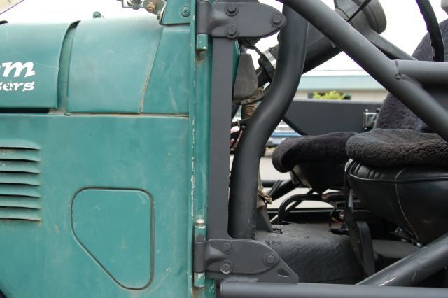

Finally I installed our newly released tube half doors for the FJ40. Here a sneak peak at the production set. Still doing some minor tweaks to them here and there. But this is what they look like on the 40.
