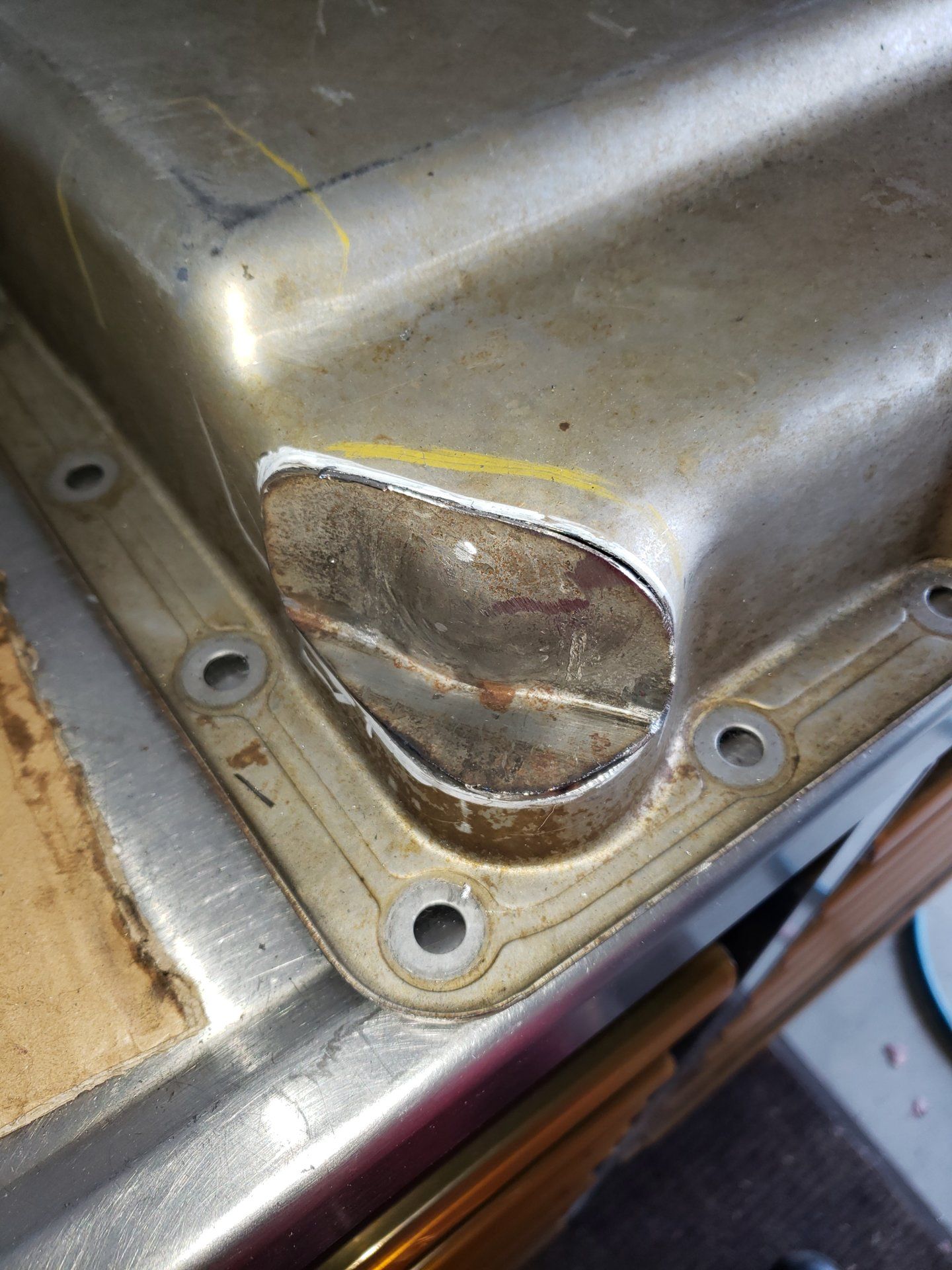

Last weekend we did a little fab'n. Not pro work but it should do. The CV off the transfer case is very close to the trans pan. We made a little piece to notch it.
We started small.
Not welded in yet. That will be this weekend possibly.

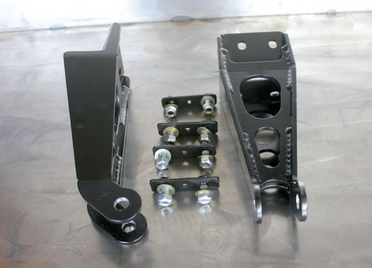

I designed my own shock towers and will have them cut out soon I think. I am trying to place the box and towers so I can get it all to jive.
