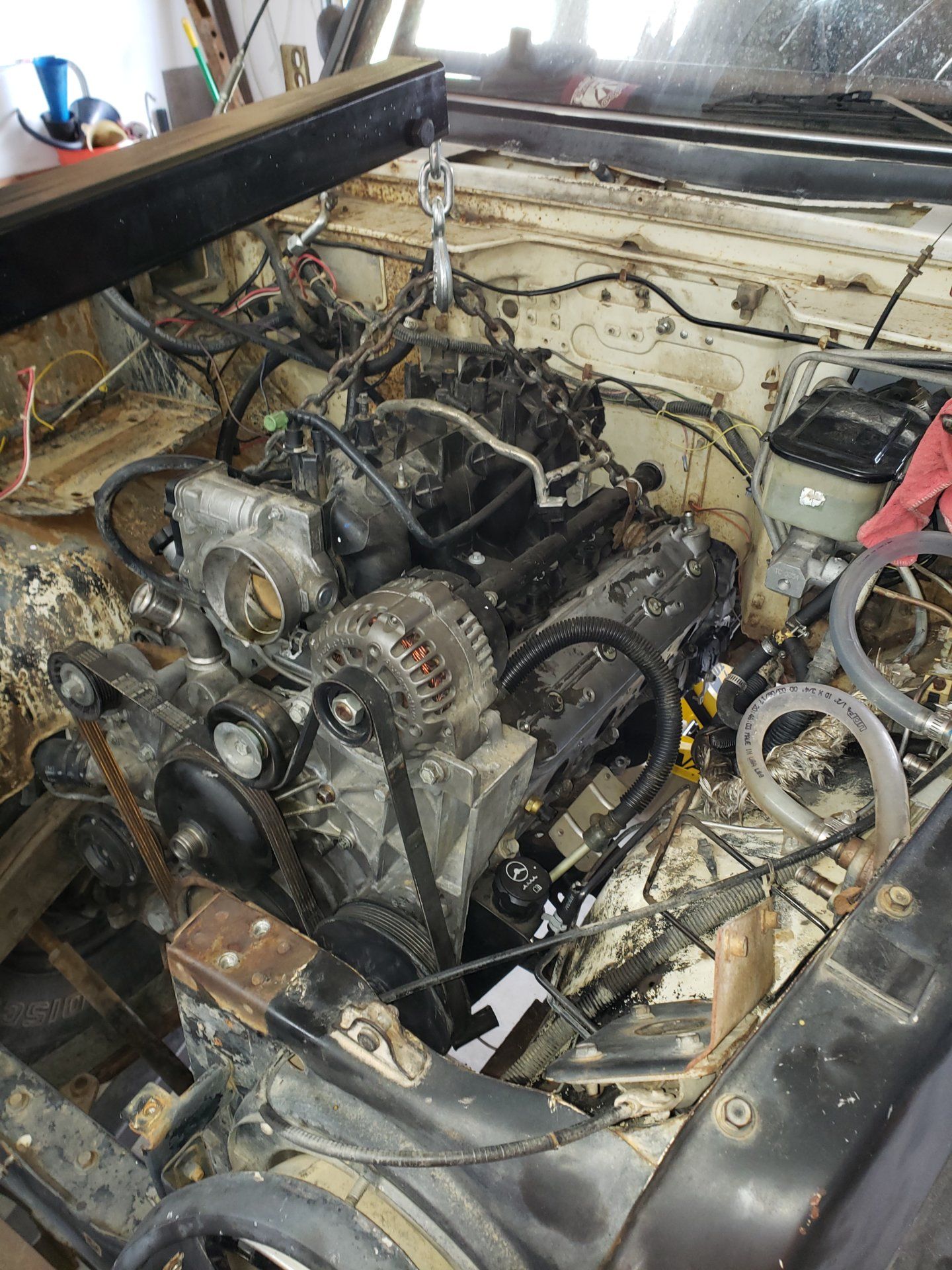

We tried to put the motor and trans in to check the fit. With all the guts out on the transmission it did not all want to go in. We just bolted it to the adapter and put the motor in alone.
We made some measurements and marks for motor mounts. It is still a tight fit up front but I think a cross flow radiator will fit with the clutch fan.
The height is good. May need to adjust the trany pan for the drive shaft.
Pull all the fun back out and started grinding the frame some more and cleared the passenger side of the bay.

Funny you should ask. I was just interwebbing oil pans just now. I think I should get a shorter one after crawling under it all today. The stock manifolds fit better than I thought they would but I think block huggers will be easier to deal with. I was seeing the vette manifolds were more compact.
On mine, the truck manifolds dumped right down on the frame rails, so I got Sanderson headers. I had bought the corvette manifolds and for some reason they didn't work out, can't remember the reason right now.
They look like they dump straight down and that might not work with the engine mounts.
