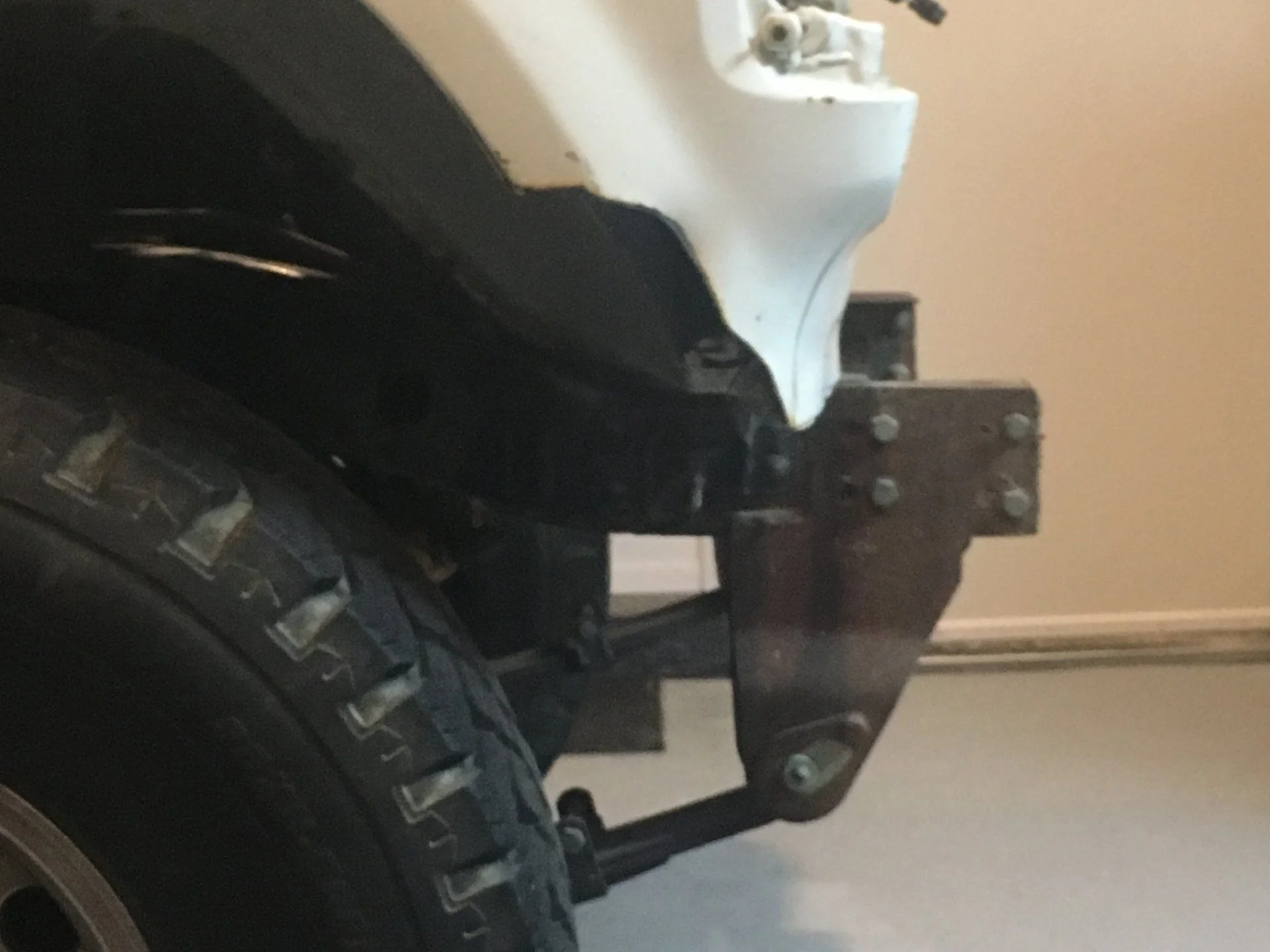

The front has the reversal with a 6.5" pin drop from frame. The shackle ange is pretty close to 90 degrees. I've spent an unusual amount of time reading through shackle angle posts. What changed my thinking about the whole thing was a Fore Runner at Turf n Surf that was running a frame mounted shackle slider setup. Interesting stuff.

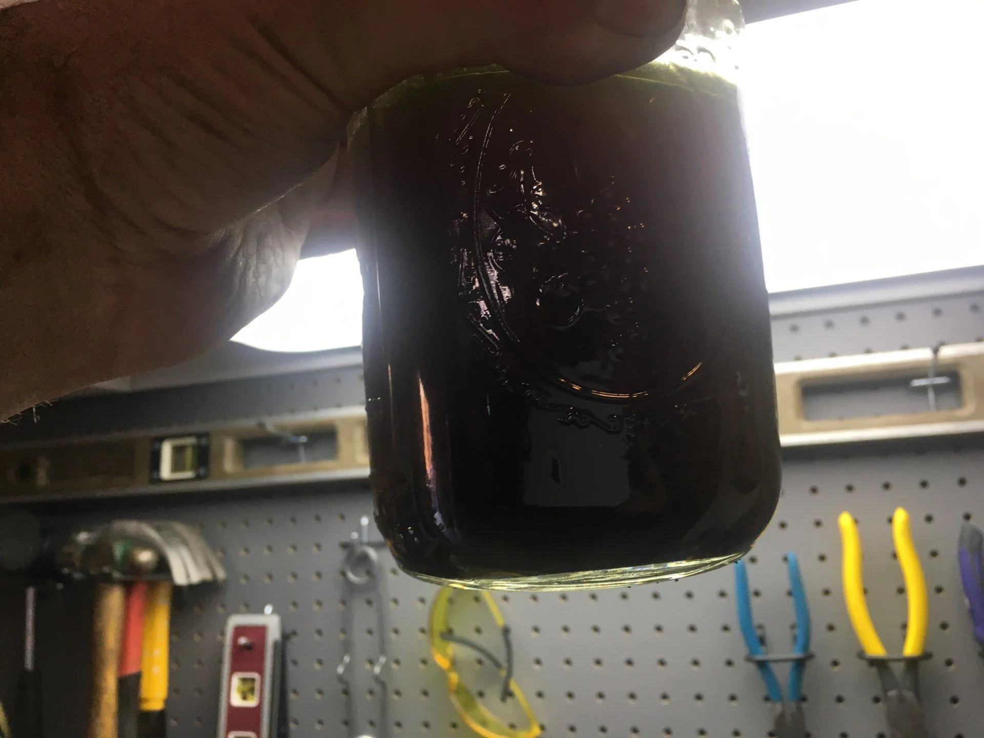

Got the brake line installed and bled the brakes today. Started with the proportioning valve then, driver rear, pass rear, pass front, driver front.
My method is to put the wrench on, then a piece of vacuum tubing on the nipple and into a mason jar with a little fluid in the bottom. Have someone pump up and hold, open bleeder, pedal still down, close bleeder, pump pressure and hold, open bleeder...repeat until no more air bubbles in fluid.
Open bleeder and pump pedal, vacuum tube submerged, filling reservoir as it goes down. Flushing old fluid out.
Did this for all 5 points. Got some funky old fluid out.
