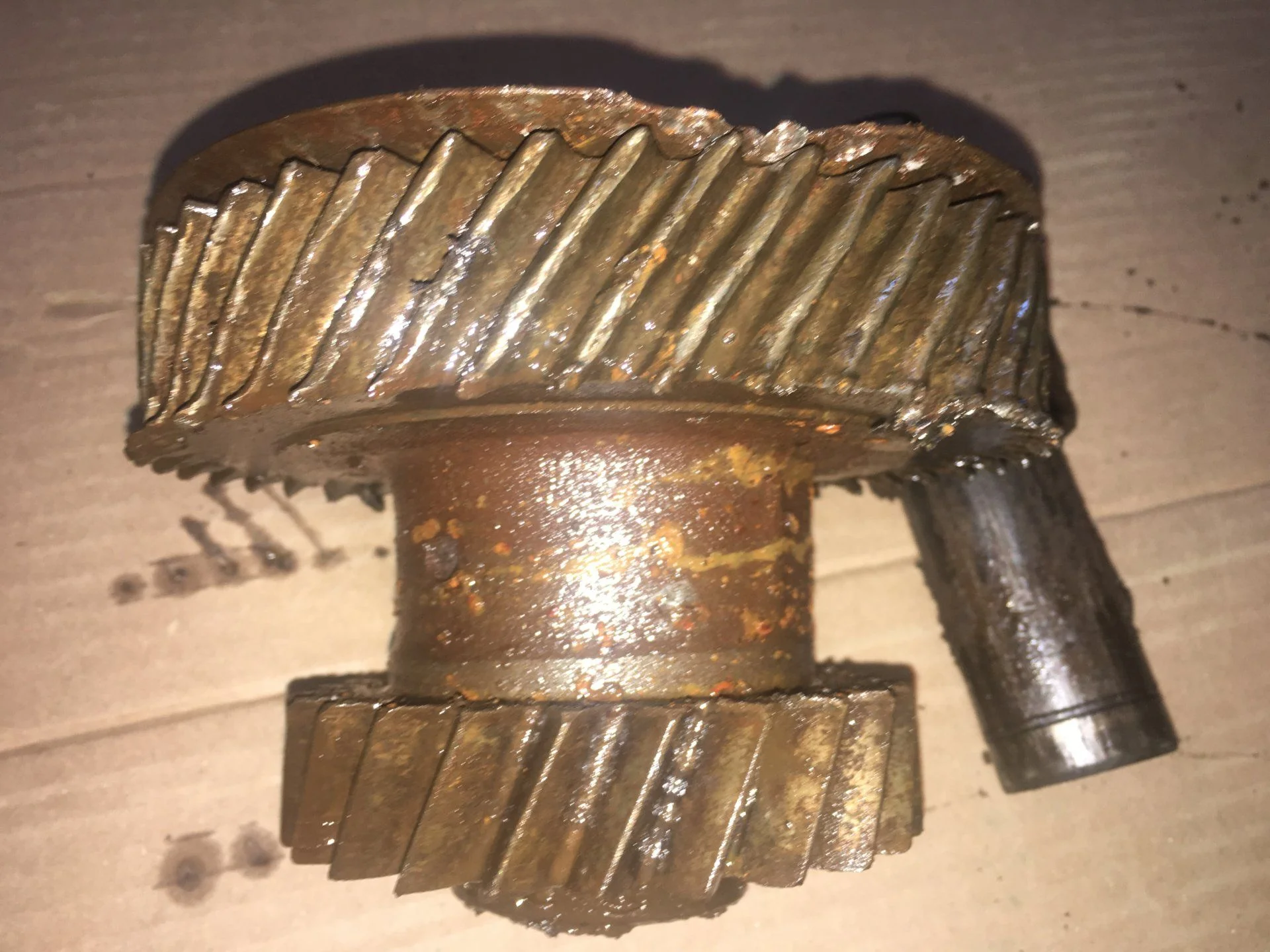

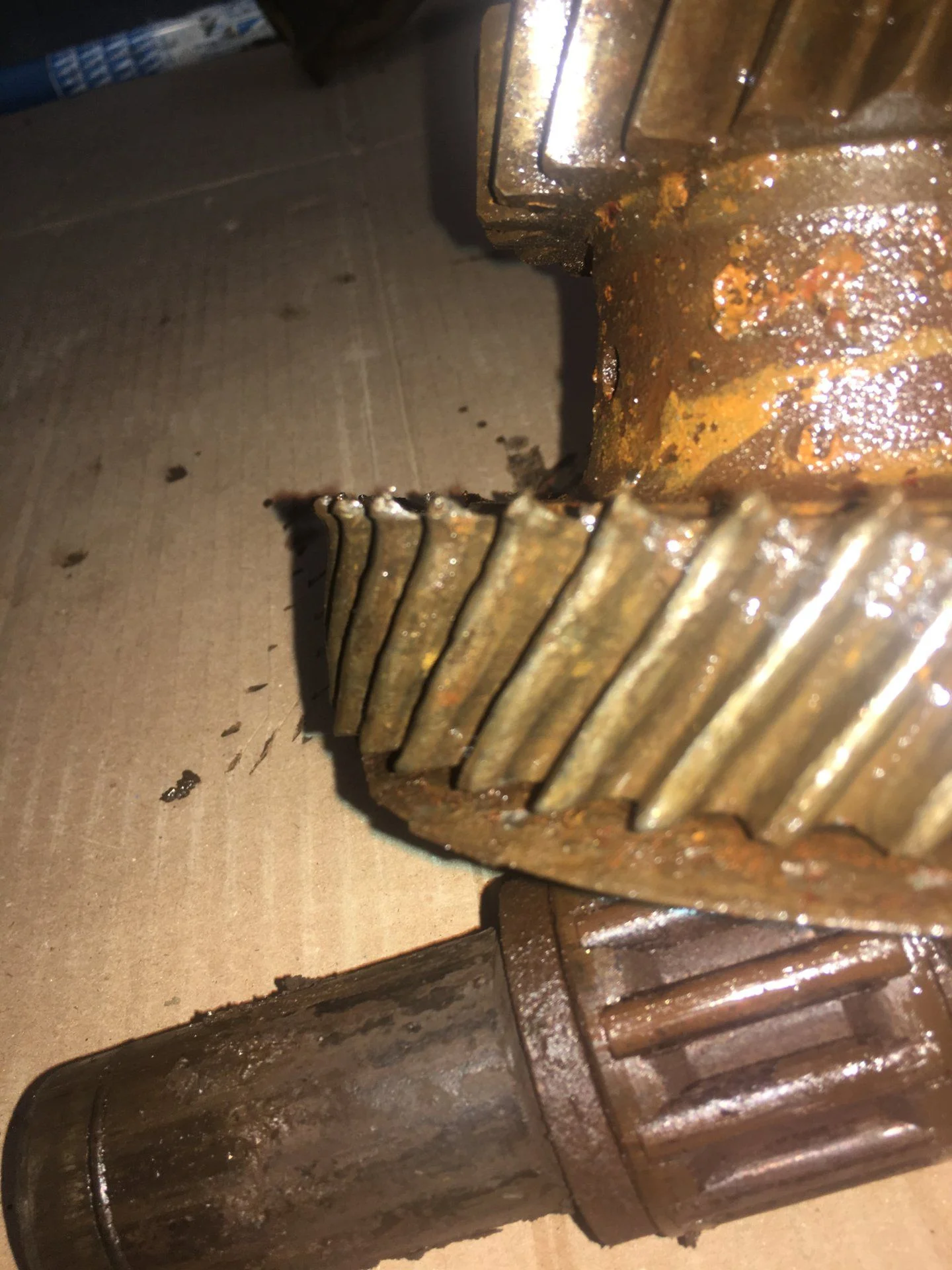

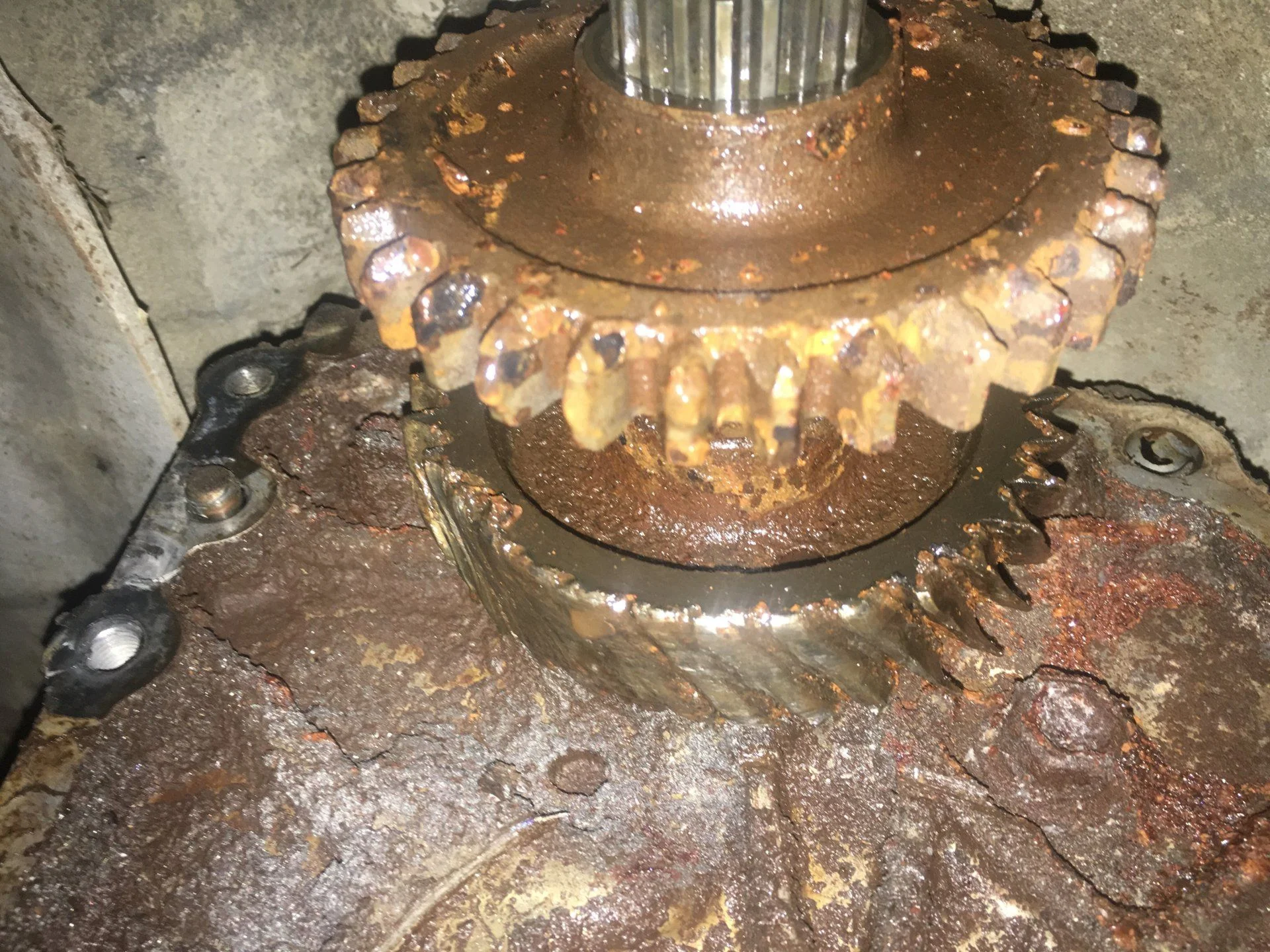

From under the rig arose such a clatter
I sprung into action to see what's the matter...
That’s a bummer!! What’s your plan of action?
I was going to head to the bank and add Georg as a joint account holder and go from there hehe. He will be in touch later today. Hopefully he has a rebuildable one laying around and I'll pick it up and a TT kit.
Ouch man that hurts!! Almost seems like the PO didn't quite have it in gear and just tried ramming it through something.
I was thinking the same, maybe rocking from D to R trying to get unstuck...maybe doing Neutral drops to try and peel out. Whatever happened, I think we may have found the root cause of why it was parked many moons ago.
OMG that is uuuugllyyyy. At least you can fix it however you want:).
...and a total TOTAL PITA to pull apart. The idler shaft was frozen to the rear case and everything else was just stuck. I would get a 1/4" separation, try to pound the idler shaft in...just pushed the case back on...eventually it came apart with idler shaft and gears with the rear case. A hard fought battle today.
