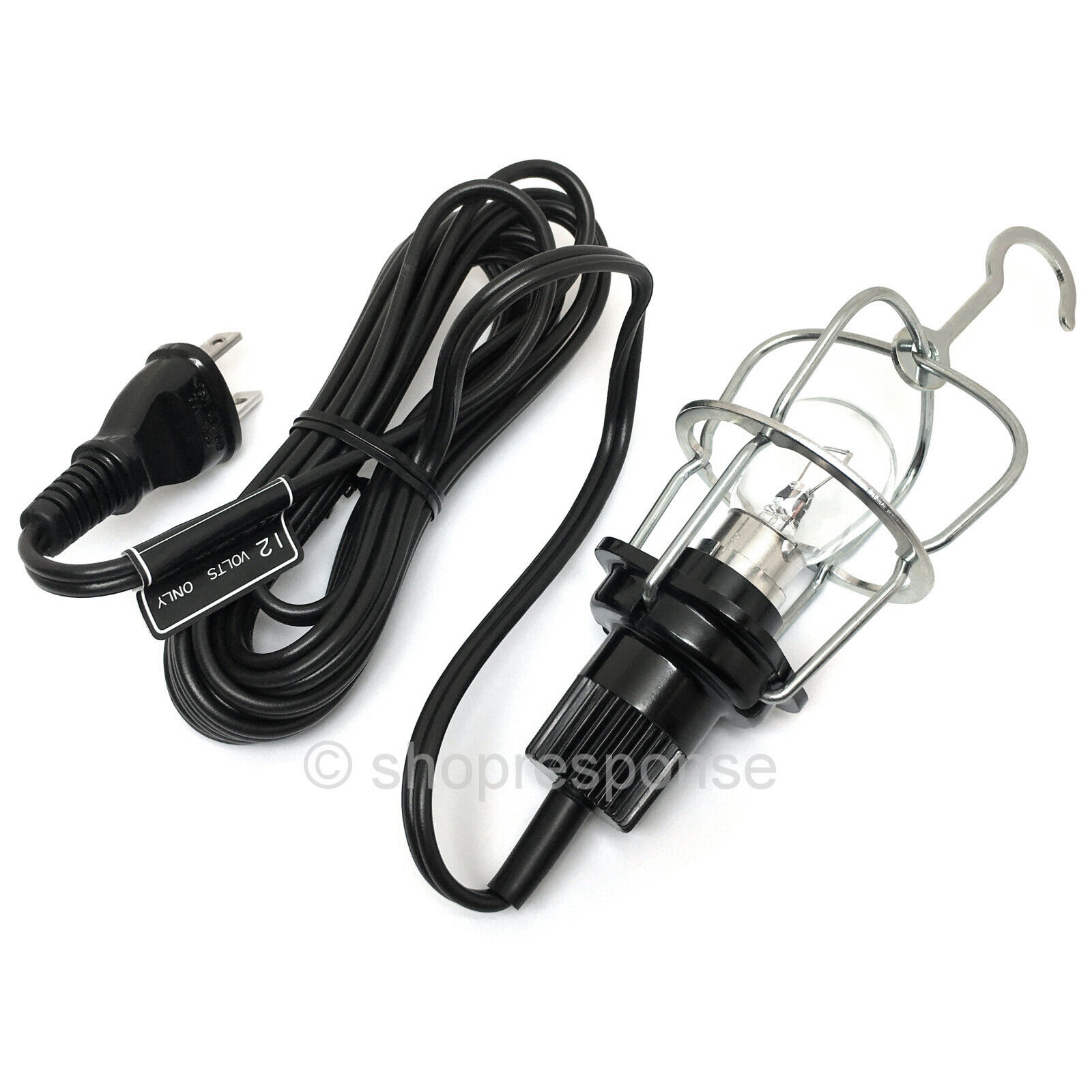

Then there is thus thing, I have no idea what it is, but it looks like I could plug 120v accessories in under the hood. Anybody got any thoughts?
Thanks
