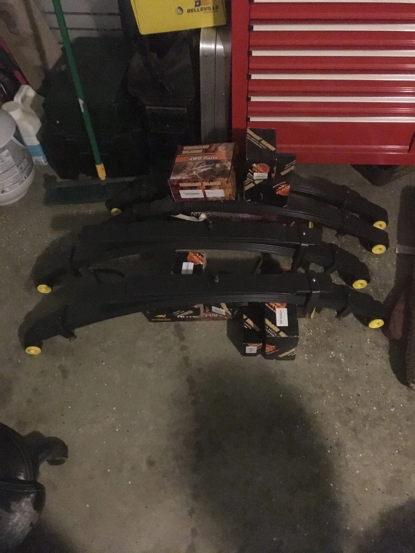

It’s finaly all here, thanks to valley hybrid!!!! Now to find time! (And a big enough jack....)
Great work bringing this 60 back. Curious if you’re gonna need new axel housings or be welding stock perches back on yours? Generally a SOA setup no longer has the stock perches. My son experienced this and found it was easier to sell his SOA’s via mud and then sourced some stock axles. Also, do you know if the front was cut and turned? Good luck and look forward to seeing your progress. Jim
@CenTXFJ60 notning was cut, just has plates welded on the front. I’ll take pictures as soon as I can. The rear just has the plates swapped. It’s really a mess it doesn’t look like a kit was used.... just hodgepodged.
