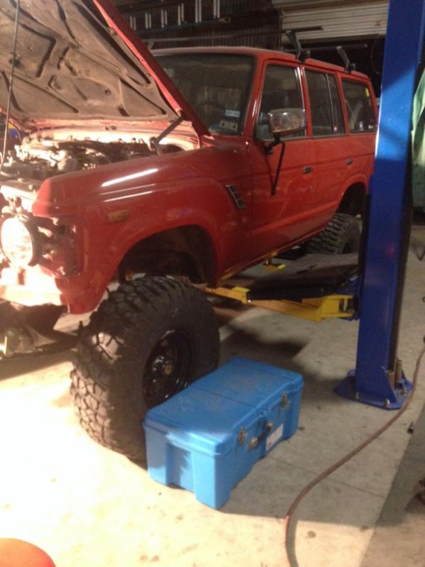

Got the front wheels on!! Really like the stance! It's a little high, but I'm hopeful that the bumpers will bring it down an inch or so.
Don't know if anyone else noticed but I love your shop seat. Very custom roller....
Haha thanks, my grandpa is pretty creative. He took one of my dads old office chairs and some live oak planks and put it together. It's surprisingly comfy!
Good job MJ, That lift should settle down a bit and yes the bumpers will help too. Keep it up.

Thank you reevesci, that is what I was hoping. I have a winch and a spare tire carrier so it should balance out nicely!

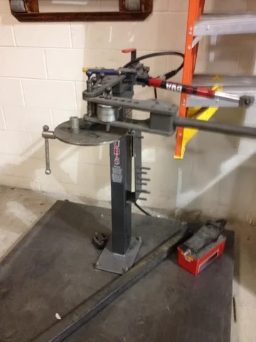

Built some shock hoops at school today. Still
Need to trim them up, but I'm happy with the end result considering it was my first time using a tube bender!
Pretty sweet machine!
