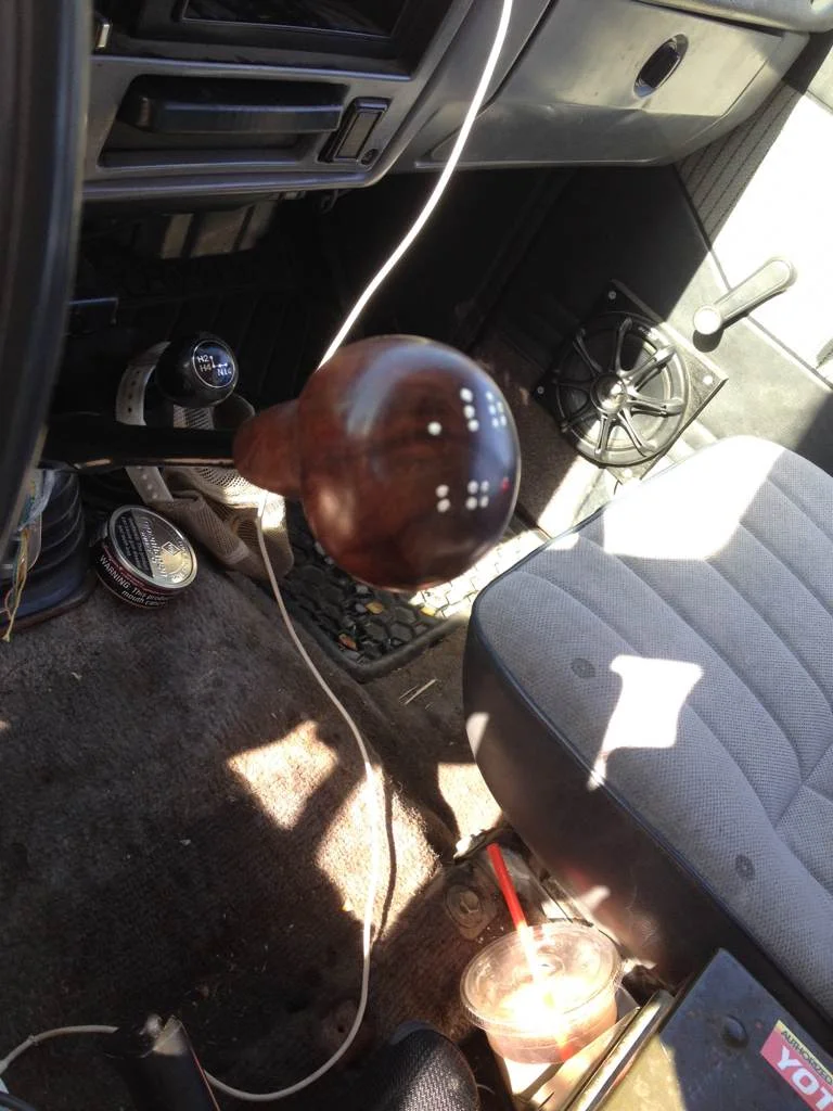

My grandpa and I built a new shifter knob this weekend and I think it turned out pretty cool. It's made out of walnut and we formed it with a rasp and sandpaper.

Nice Mj. I likey...
Its those things/memories no one can ever take away.
J
Thanks J. And I totally agree, I come up with the ideas and he helps me build them. It's always nice to have a wood nut in the family!
