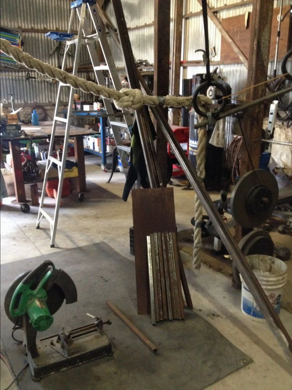

We'll I took a look at my steel pile and a light bulb went off in my head.. What can I make out off 1"x1" 14ga square tubing and some sheet metal?
Well if you guessed a roof Rack then you were correct! I am going to make one similar to the "diamondrack" design and most likely use their rain gutter mounts.

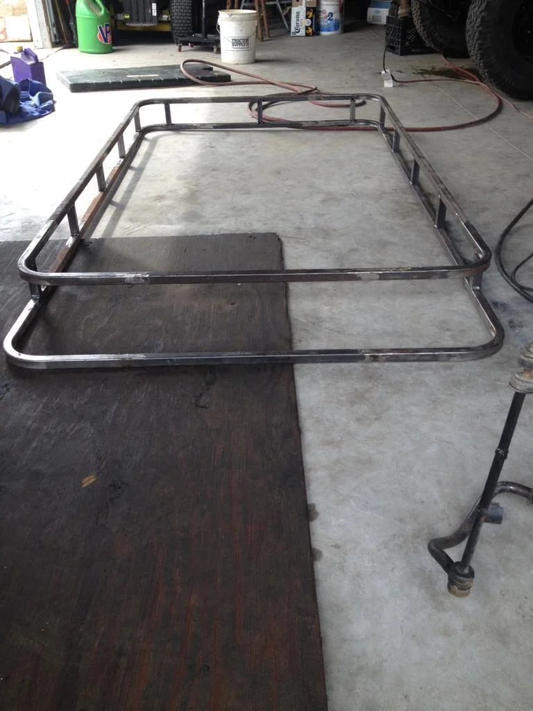

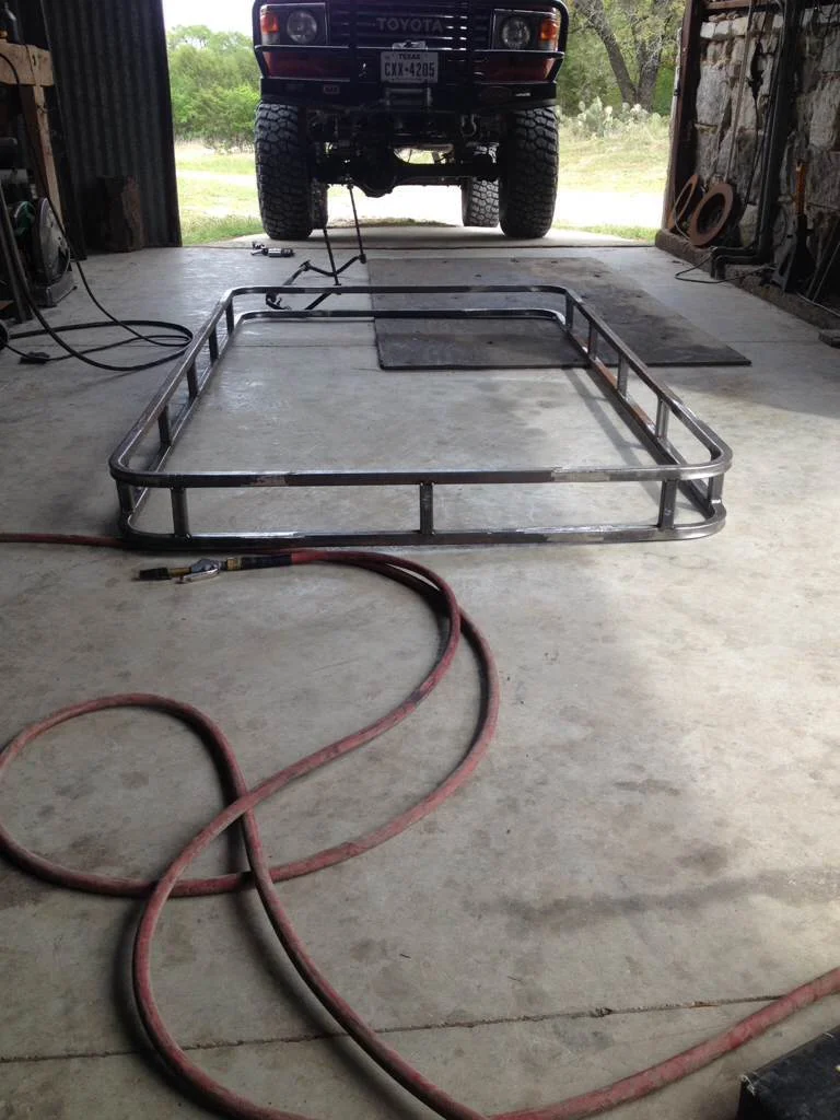

Here is a quick update on my rig:
Been working on my roof rack off and on, all that needs to be done is the horizontal crossbars that the rain gutter mounts attach too. Still on the fence about making my own or just buying some.

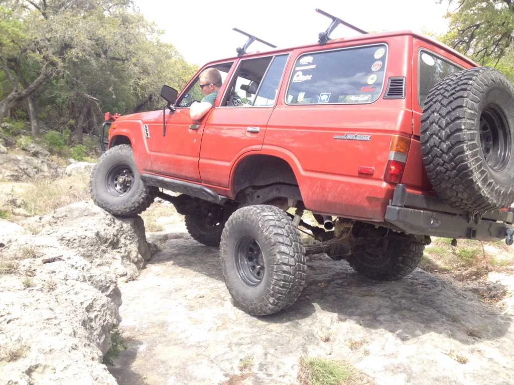

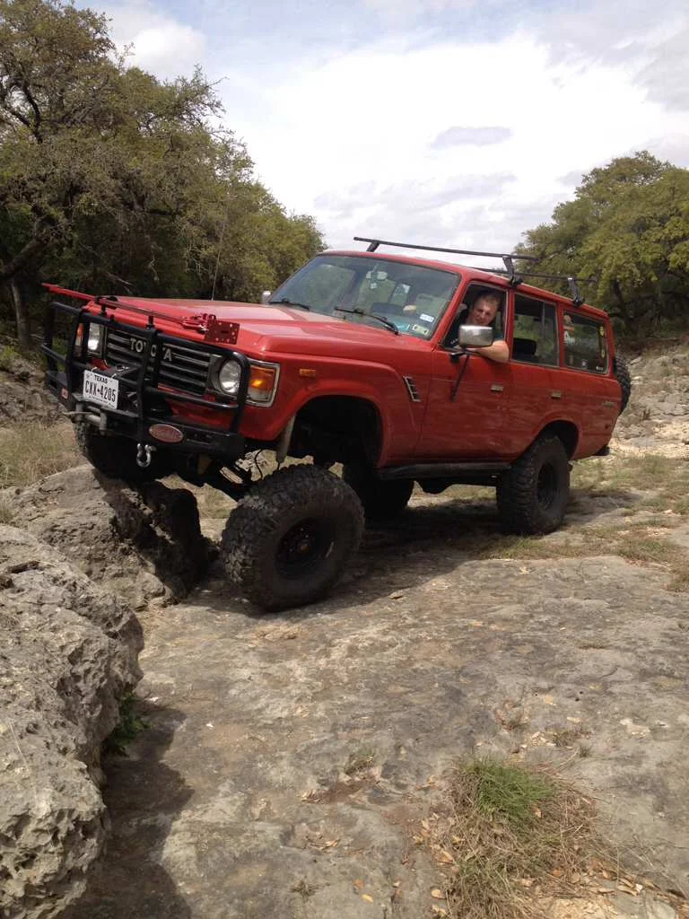

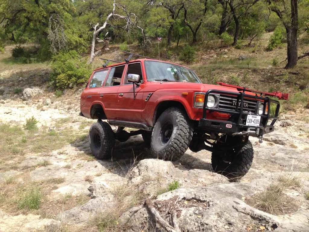

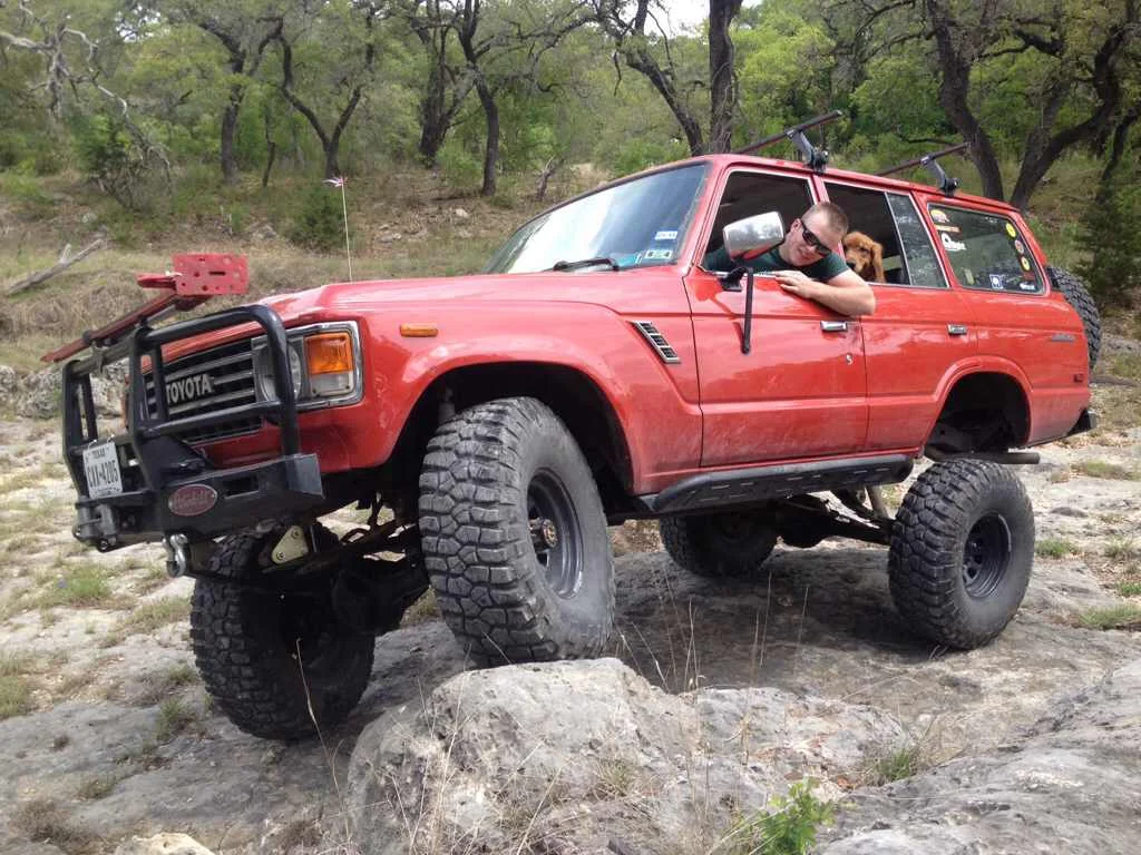

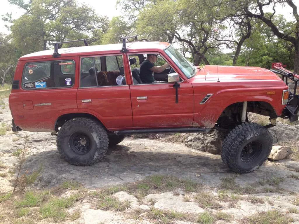

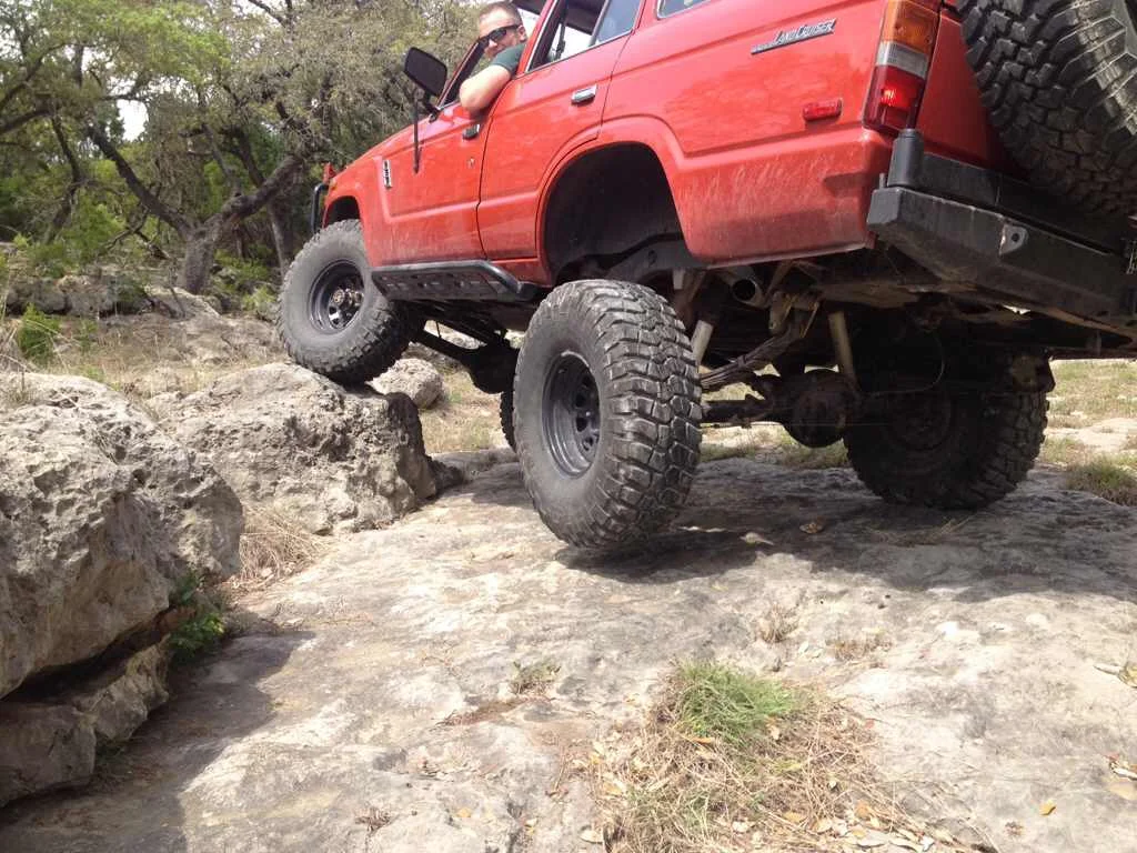

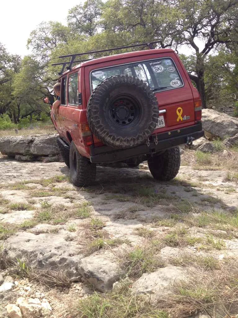

Then took my rig out to a local spot with one of my friends that drives a j**p. His front lunchbox locker was acting up so he turned into a photographer lol. Here are some pics:
Enjoy!
Mj
Looking good there Mj. Hope to be done with the traction bar this coming week and then the axles are off to powder coat. That is a good looking rack you have there, lol....
No pun intended lol? And please post pictures when you get the traction bar setup finished. I'm going to be getting my FF rear axle at the end of this month so I'm going to go ahead and install one then.
Nice flex MJ, rack looks like it is coming along nicely. What bender are you using?

Thank you sir. The bender is from school, I think I posted a picture of it in this thread a while back when I was making my shock hoops. I can't remember what brand it is, but can check on monday!
