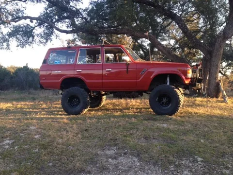

Took the cruiser on a 5 hour round trip drive today, I have to say I am very impressed once again! I was running 85 which is topped out I guess.. No driveline vibrations and everything felt really smooth. Since my dad has lift occupied with the 86 cruiser, I am going to start building a rear storage/sleeping platform. I'm starting to plan a fly fishing trip up to Jackson hole Wyoming in June, so I will also be making the interior more comfortable by adding some better seats. Also should be getting the longfields in Wednesday so I will be installing them this weekend. Here is a pic of the cruiser from today for y'alls viewing pleasure:

So much glorious Freeborn red in 60 tech right now...nice rig!
It's my favorite color on the 60s! My opinion is kinda biased though..:cool: And thank you!
It's a good color for sure :rolleyes: and very nice pic. :cheers:
Mj... those 35s look tiny on there.

I know it bothers me.. I'm going to hold off on the 37s until i can wear these out.. Too bad the old 2f cant smoke the tires:hillbilly:

Definitely needs 37s, you could always try and sell the 35s on craigslist and then get some 37s!
I was actually thinking about trying that. The problem is one of them has a small rip on the sidewall so I doubt anyone would be interested..
What sucks is they still have 50+ % tread.

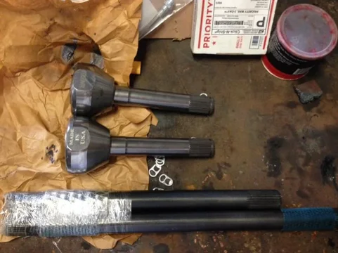

Longfields came in today! Super exited about that! I have a quick question though. I'm kind of confused about how the warranty works.. If I run the stock diff splines and they mess up the ends of the longfields is that still covered by the warranty? I looked online and they run about 70 bucks. Is it just a piece of mind to run them?
