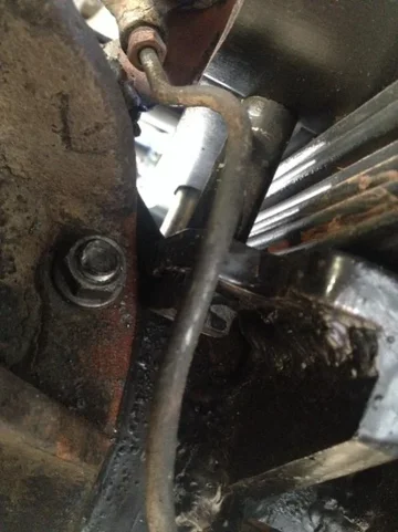

Mj, how did you deal with the passengers side perch? It is a pain in the %$^&%. I think that I am over thinking this way too much. The knuckles are throwing me off and setting the pinion angle before the C&T.
You are in the same boat that I was in.. Just take an hour and get to work on the grinding wheel. It is a pain to make that perch fit right.. You will also
Need to trim the u bolt hole on the perch in order to clear the differential. Like so:
Sorry for the crappy phone pic but you can see what I'm talking about.

Yeah, thought about trimming that before final welding. What was your pinion angel sitting at before you did your C&T? Seems like I read somewhere that it should be 14*. I tried to hook up my front drive shaft but it is gonna be too short by about 2"s. If I had a positive idea on what to set my pinion angle at, then I would feel comfortable on the rest of the fab. You get yours back together yet?

I cut a piece of pipe that fit perfect from the tcase flange to the diff flange and put a level on it and called it a day. And going to this weekend, I'm getting tired of taking the knuckles off..

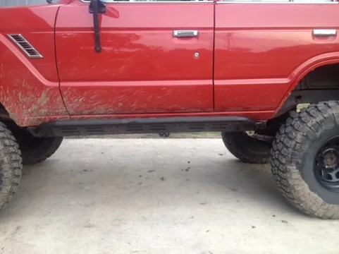

Finally have a reason to make an update. Installed my sliders today, they are heavy duty! Next on the list is too go to the tire shop and get them to switch out my rims for some wider ones that I have laying around. Finally ready for the LSLC roundup next week!

Where did you get your sliders, are they bolt on or weld on????
I got them off a wrecked cruiser we picked up a couple years ago. I am pretty sure that they are Man A Fre or 4+. They are bolt on with brackets that weld onto the frame, but I just welded the brackets and the sliders together so that I do not have to worry about them breaking. How's your build coming along?
