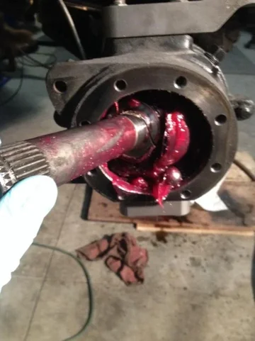

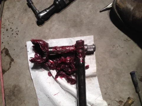

Well gents, experienced my first bit of carnage after only putting the rig in 4wd once.. I shattered my stock birfields.. I knew it was a risk running an Aussie locker with stock shafts. But hey I guess the only way to justify spending $400 on chromoly shafts is to destroy the ones you got! I wasn't even doing anything extreme just crawling up a few little rocks then SNAP.. Knew something wasn't right when I wasn't able to turn all the way to the left.. Oh well I will be ordering some longfields in the morning! Are they only sold by trail gear?

Here are the pics:

I posted up some photos for proof:p All i went up was that rock in the picture and a small dirt pile.. stayed in 1st gear 4 lo and was generous on the gas pedal:hillbilly:
Trust me I wish they would have broken while doing something more epic but it is what it is.. I knew that was the weak point in the setup so no one to blame but myself!

maybe i missed it, but are you locked up front? that shouldn't have broken your axle.
Yes I am running an Aussie up front. That's really the only thing that I can think of that would cause this to happen. When I heard the "snap" I was in 4lo 1st gear basically idling along and could feel that the steering wheel was hard to turn so the locker was engaged. I am honestly kinda surprised that this happened in this fashion.. But I have read around that the stock axle shafts tend to break when a locker is installed.
