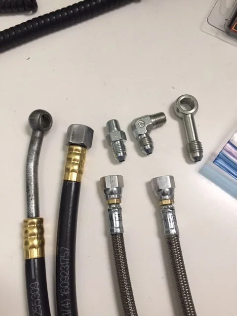

Here's the short story... I brought my original fittings in hoping to go to steel braided lines and the guy said smugly "we dont have any fittings like that" when I showed him which end attaches to the block. I told him I was looking to have a more permanent connection instead of attaching to the original fitting setup. He grabbed the cheapest hose he could find, took my fittings, crimp fastened them, and then charged me $30 bucks ($20 for 5 min of labor).
I left but felt like there had to be a better solution. As I was headed from my home in Sacramento to San Francisco yesterday, I remembered there was another Parker store on the way. So I stopped in and a dude who appeared somewhat new spent 5 minutes talking about what I was trying to accomplish while going through the old parts I provided. He immediately looked at the original fitting that connected to the block and said "this is 1/8 BSPT". He grabbed a new fitting 1/8 BSPT to JIS fitting. This would allow me to easy convert to a traditional thread. He also provided 10mm banjos as well for the other end. He cut some lines, connected everything together and double checked everything. This guy took great pride in his work and I thanked him like 5 times. I could tell he was proud of himself as he should have been.
Here is a link to the fittings....
Triple-Lok® 37° Flare JIC Tube Fittings and Adapters | Parker NA
In this picture you will see the black hoses the grumpy dude gave me, and then also the newer setup the helpful dude gave me. He even gave me a discount because of the service I received from the original shop.
I went with steel braided because I am running headers btw.
Josh

Josh- quality thread. Parker couldn’t help me out, I used your part number and they had them in stock.
@Jdc1

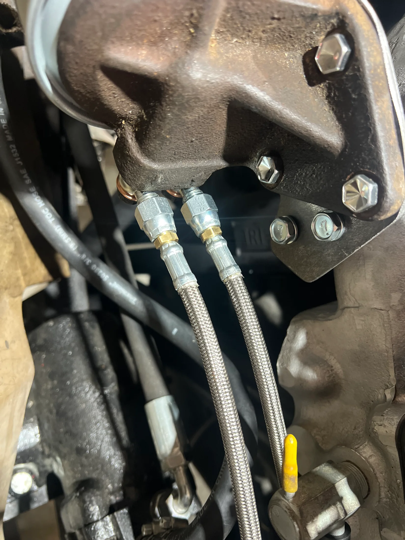

Did you end up making some on your own? I bought a hose crimper tool and been needing to make some new oil hoses :]
Parker made them for me. Used the part number above to convert from BSPT to JCI(-AN) and some M10 Banjo fittings. Pics below(beginning the rescue of this truck with a budget from a lot of POs, not a lot of my work in the pics)
