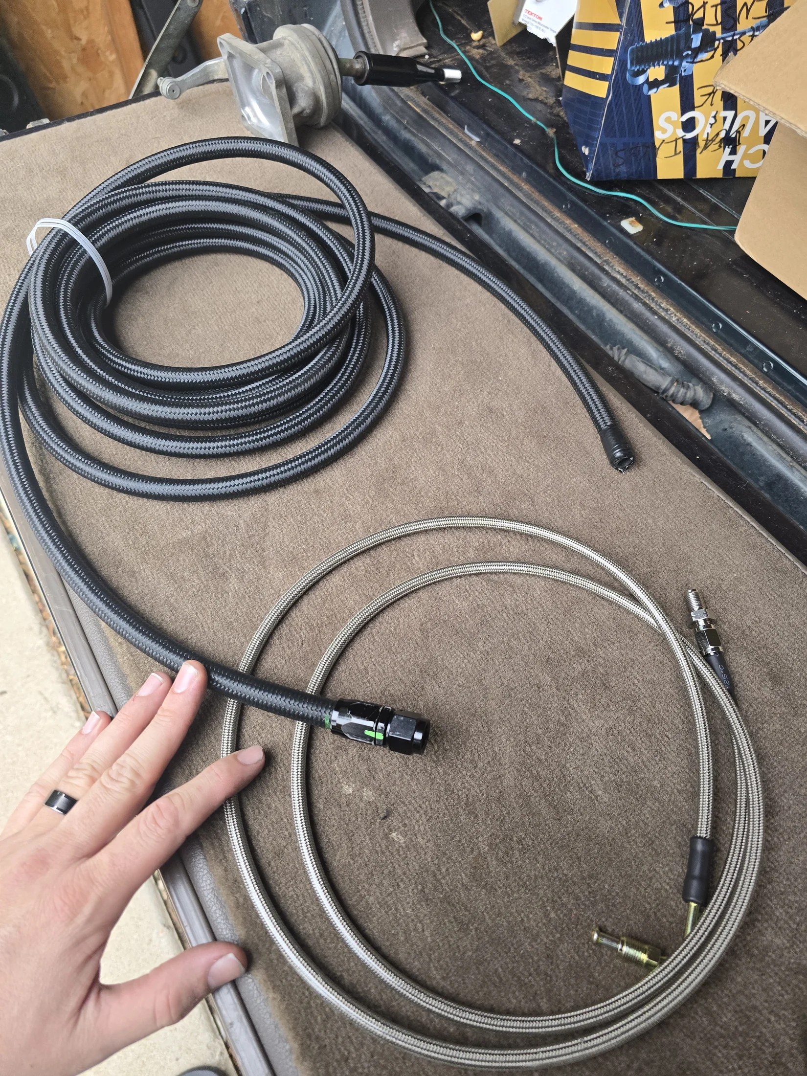

May get some hate for this, but whatever. Sourcing the correct hard fuel lines has been a battle, bending others have just frustrated me.
10an/6an steel braided PTFE is what im going to use, all the way from the tank, minus the terminated sections at the tank and diesel fuel filter assembly. The ends will be male barbs so I can use rubber lines to the fuel sender assembly, and fuel filter, PTFE doesnt work well with hose clamps.

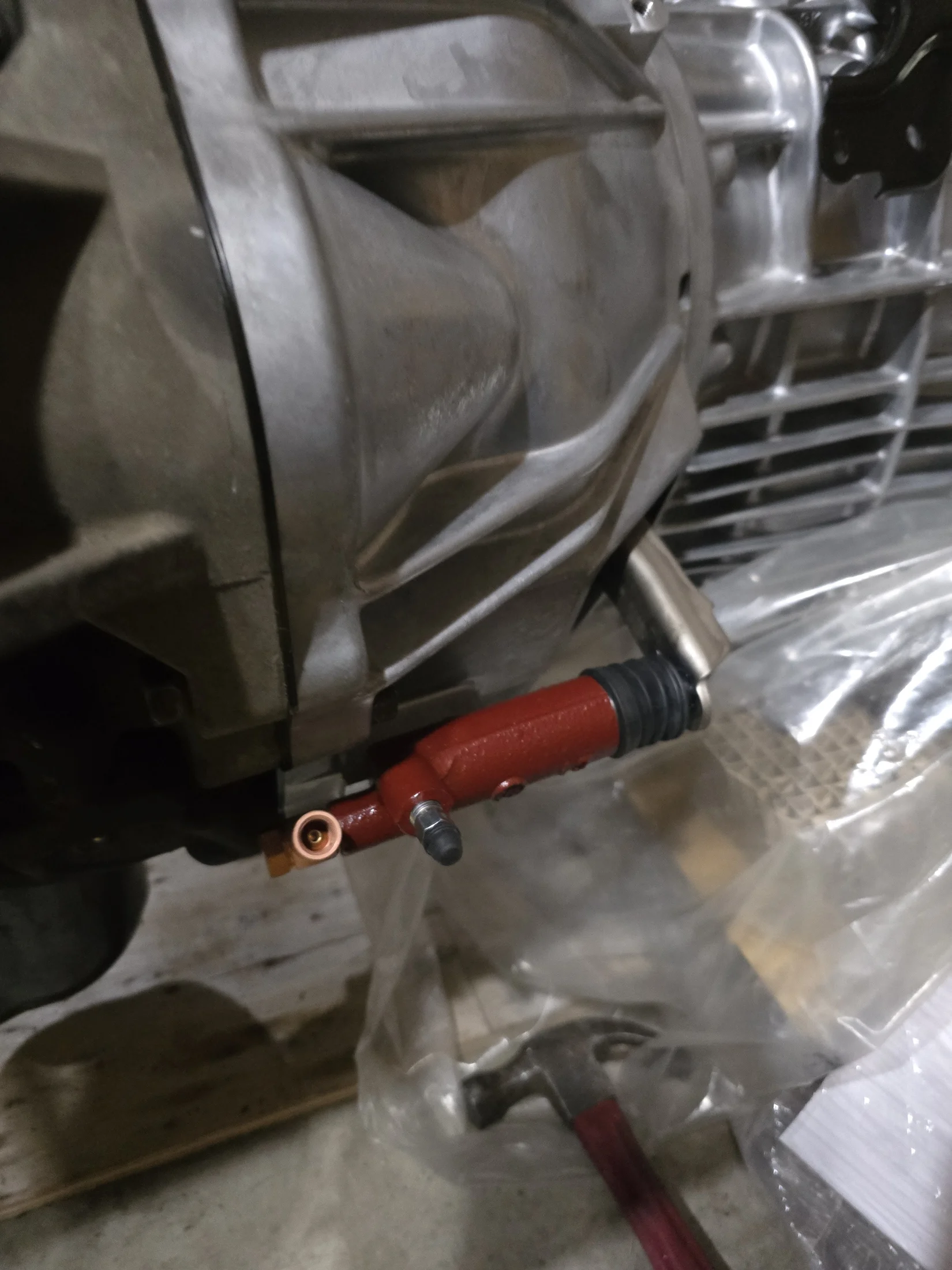

Something else that's hard to source, clutch hard lines, so im using a steel braided soft line. It's generic toyota, probably able to use it on every make and model. The fittings seem well made, and thread in to both the master and slave cylinder correctly.

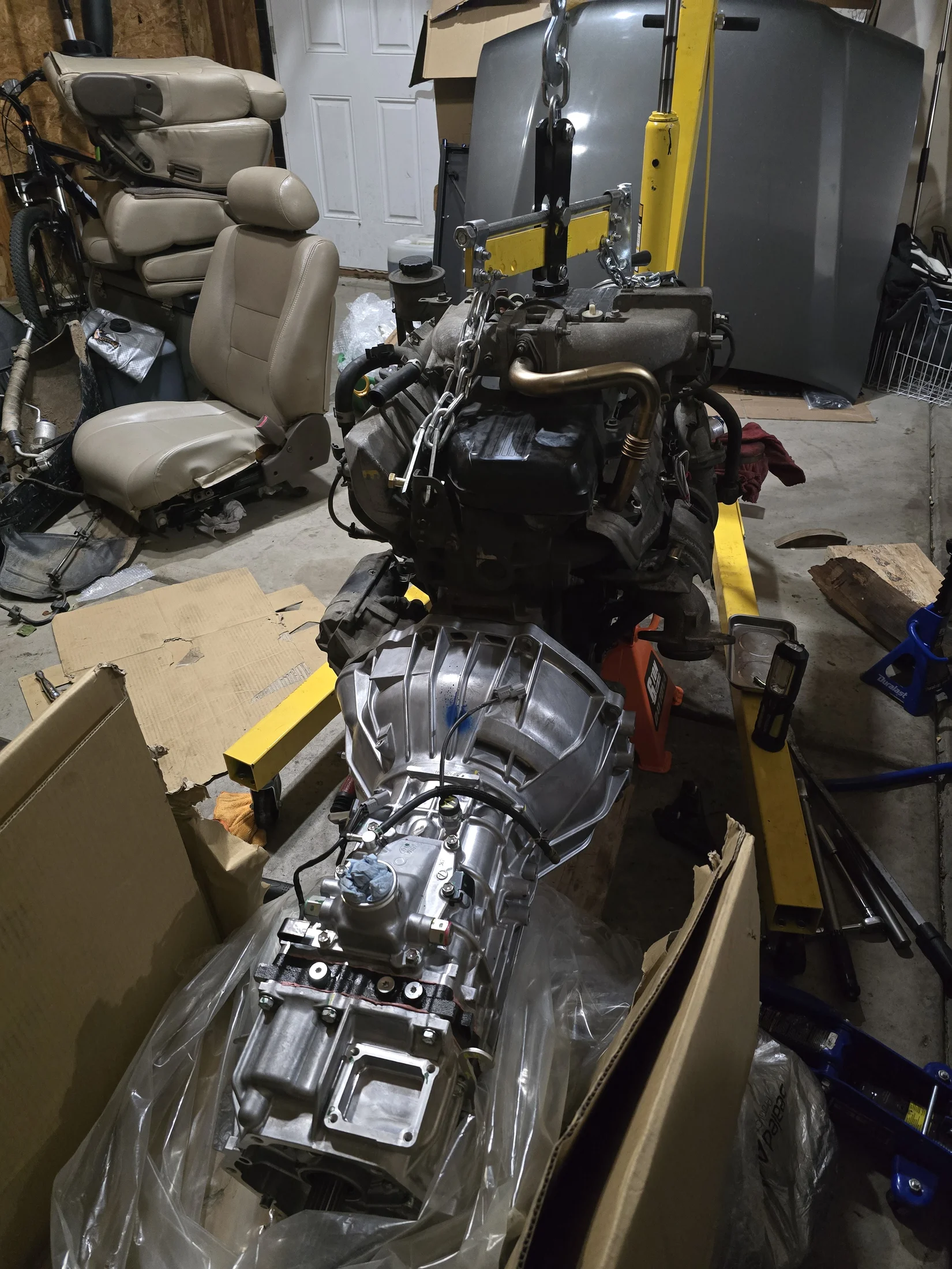

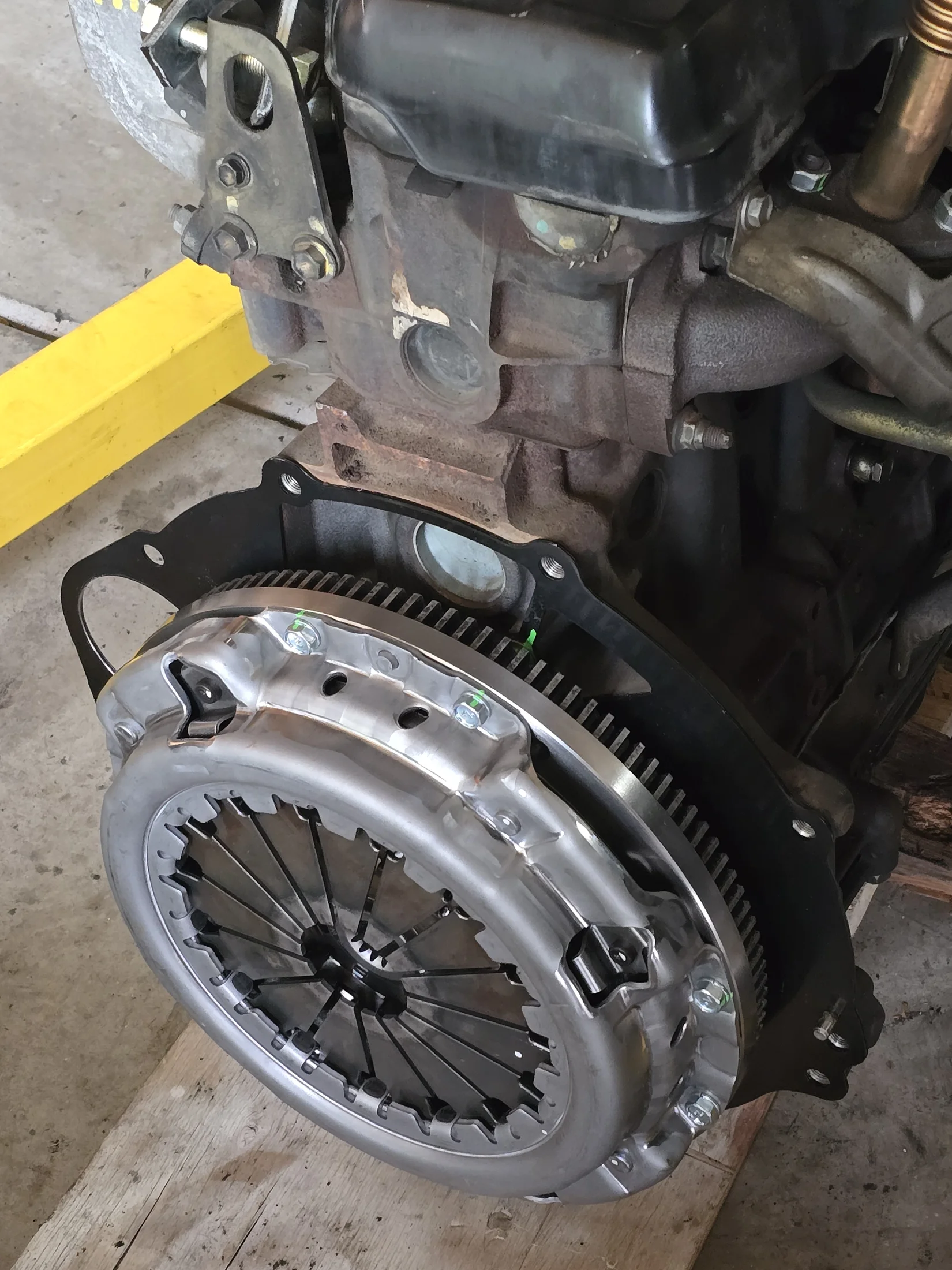

Rear main seal replaced, clutch assembly on, progress. Aiming to mate the trans up tonight.

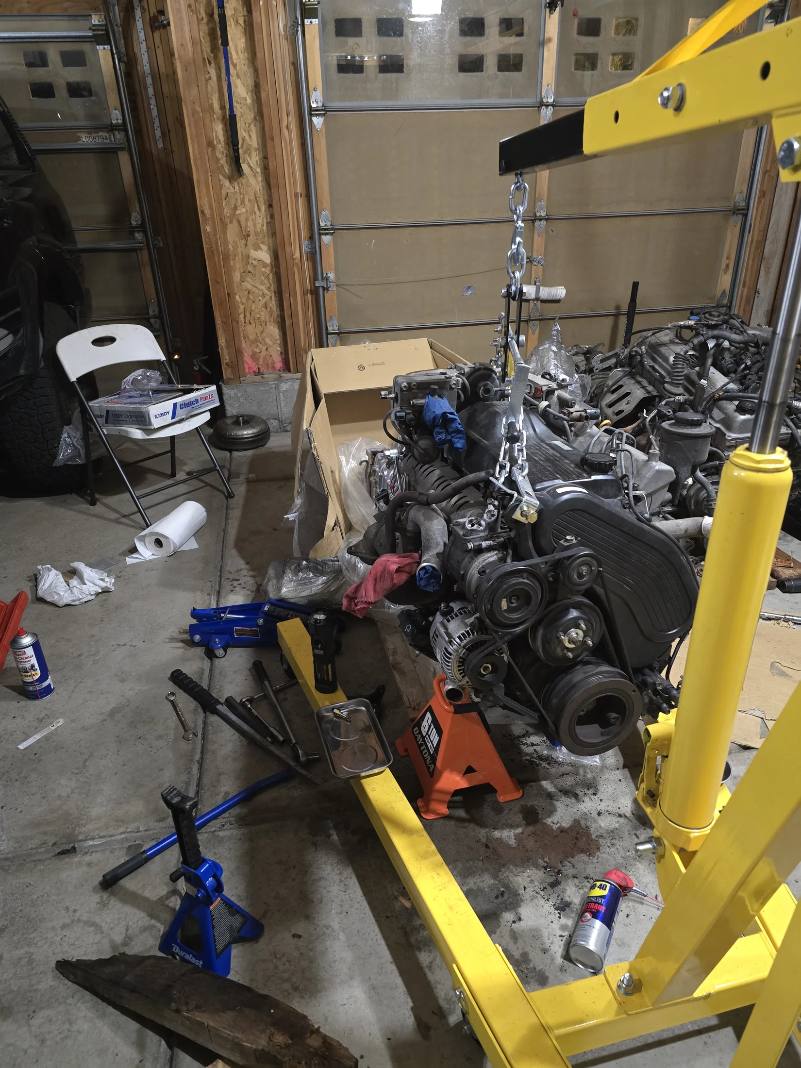

We out here just flat out winning. For something that should've taken me 45 minutes, it only took me 3 hours 🤣🤣.
nothing about this is professional or safe. But lets make it happen.
Holy s***, what a nightmare, from the lift being s***, chains being too short, load leveler falling apart, transmission shifter assembly ****ing up my tub.
shes in, and bolted tight. Id seriously think about doing another....

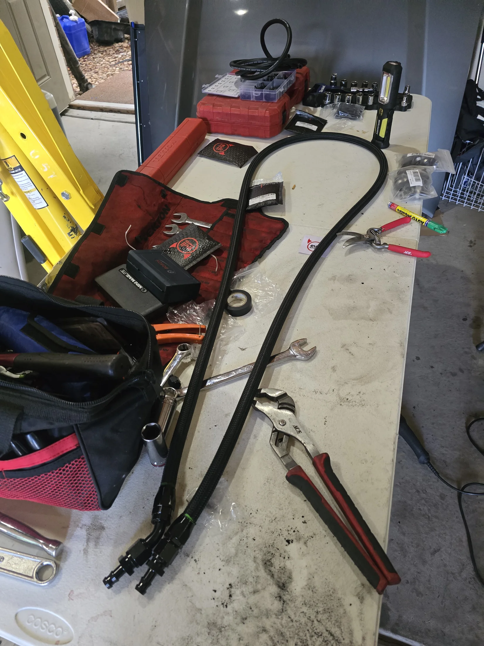

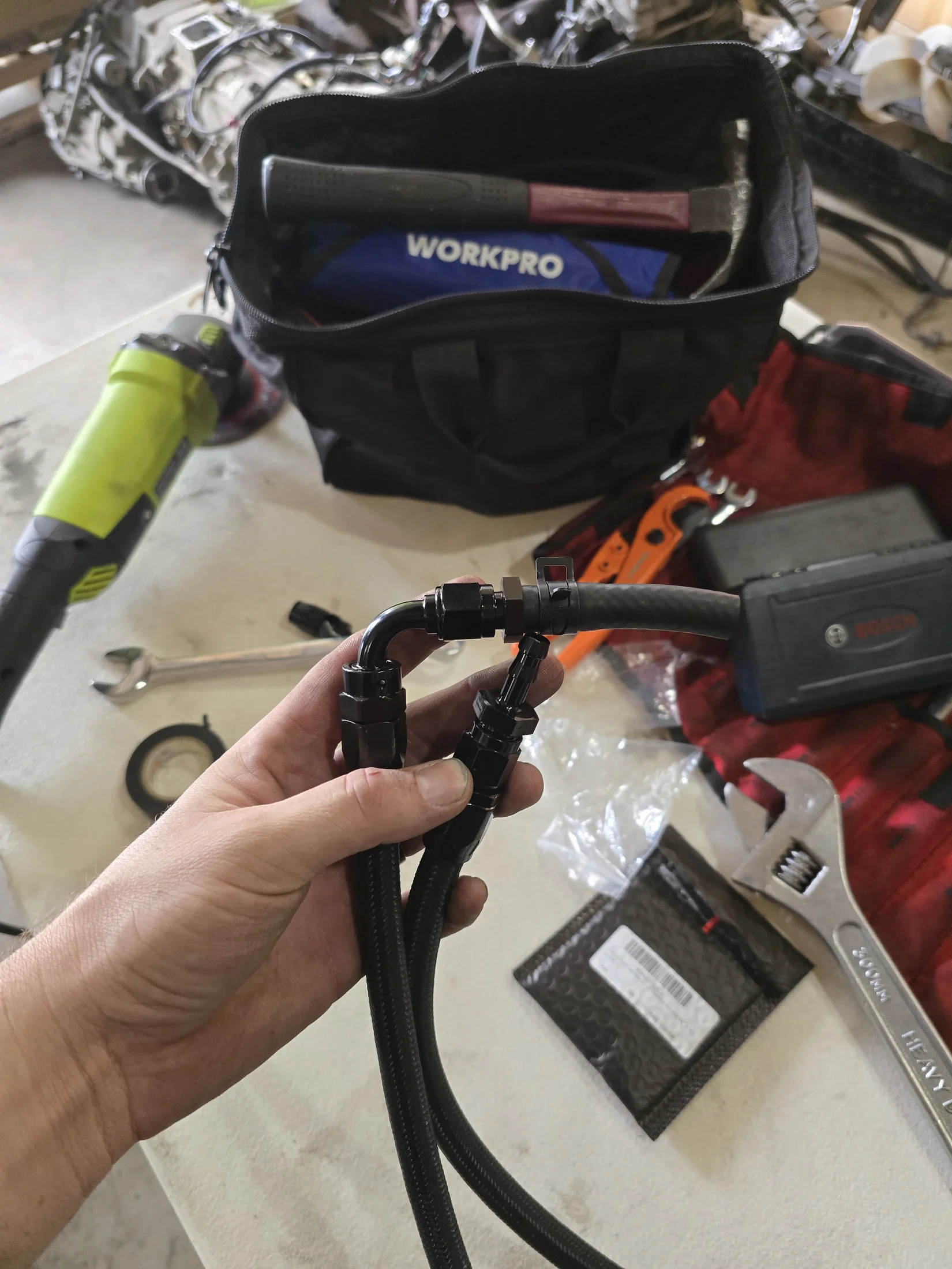

Evil Energy Steel braided PTFE lines. The 90 degree turn is tank side, these lines are seriously tough it seems. Gotta cut them with an angle grinder.
12mm send line all done.
For anyone curious,
How to cut steel braided PTFE,
1. Mark length
2. Tape ends with electric tape about an inch and half from the end or where you want to cut, 2 wraps will do. This is to keep the ends from fraying. If the ends fray, start over. You'll never get the line into the fitting.
3. Secure hose lightly in a vice or by some other means.
4. Cut with an angle grinder and cut off wheel.
5. Twist hose counter-clockwise, fitting clockwise, while pushing the hose into the fitting.
6. Make sure the hose is basically bottomed out into the fitting.
7. Pick which end you want, 90, straight, etc. Tighten into the fitting you pressed the hose into. Just make sure the hose stays in place and doesn't push out. I mark mine with a marker below the fitting you push the hose into.
These are rated for 625psi working pressure, and -22f to 248f temperature.

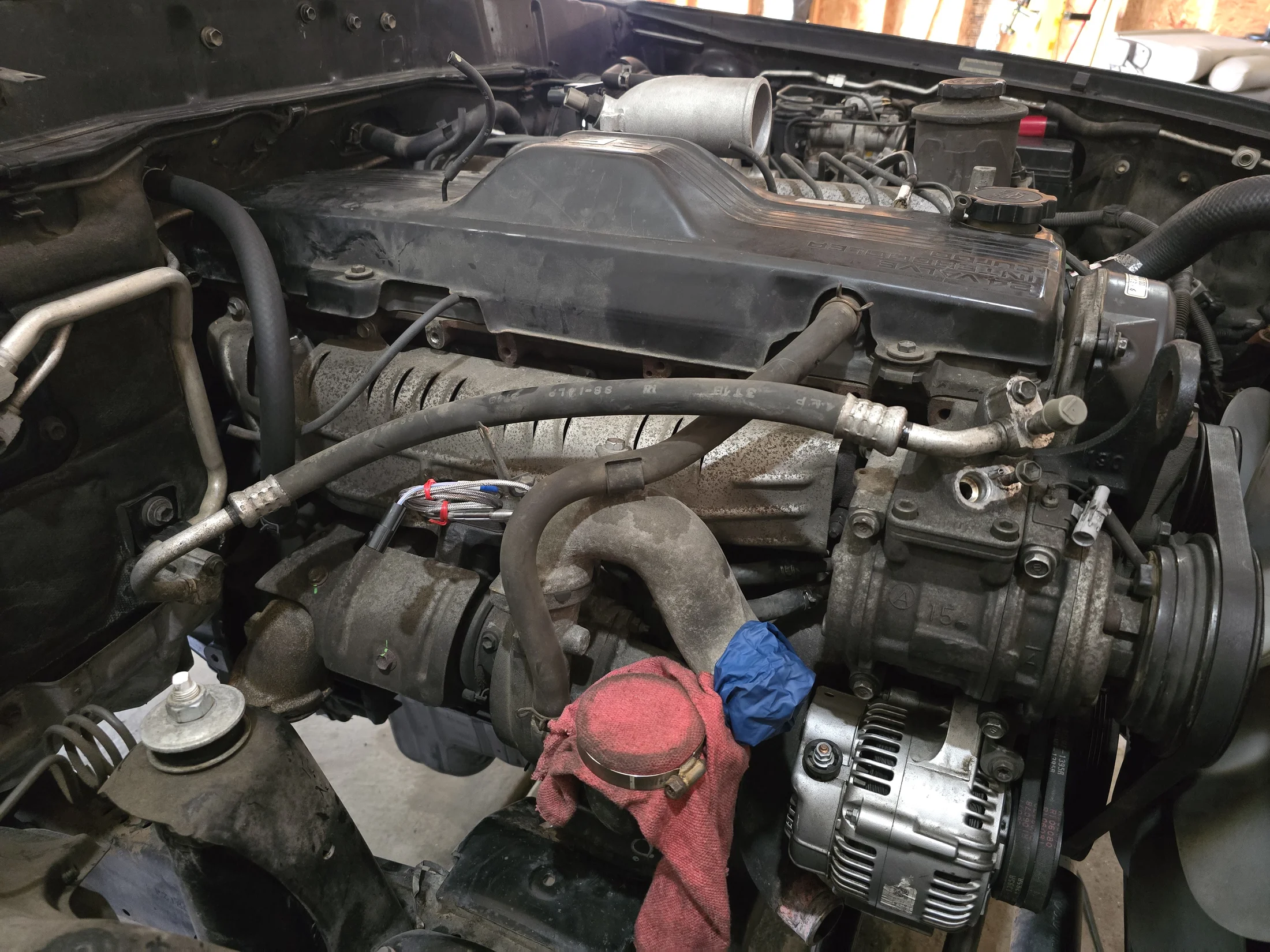

Progress, clutch bled, seems to be holding good pressure, surprised at how light of a clutch it is. Used to old manual Chevys lol.

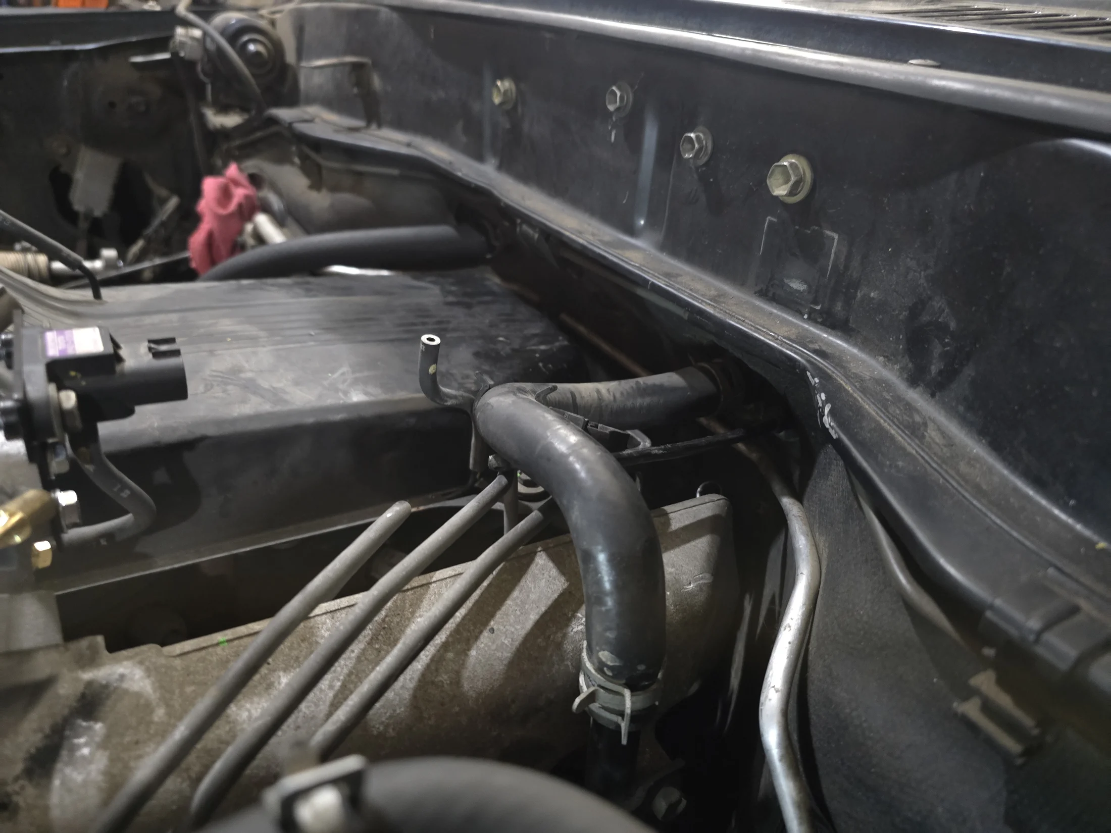

Heater hoses done, bypassed rear heater for the time being, ordered new heater T's
Power steering lines are a total s*** show. I mean they look like fidos ass. I want to re-do them for sure. Who knows if theyll leak. We'll see.

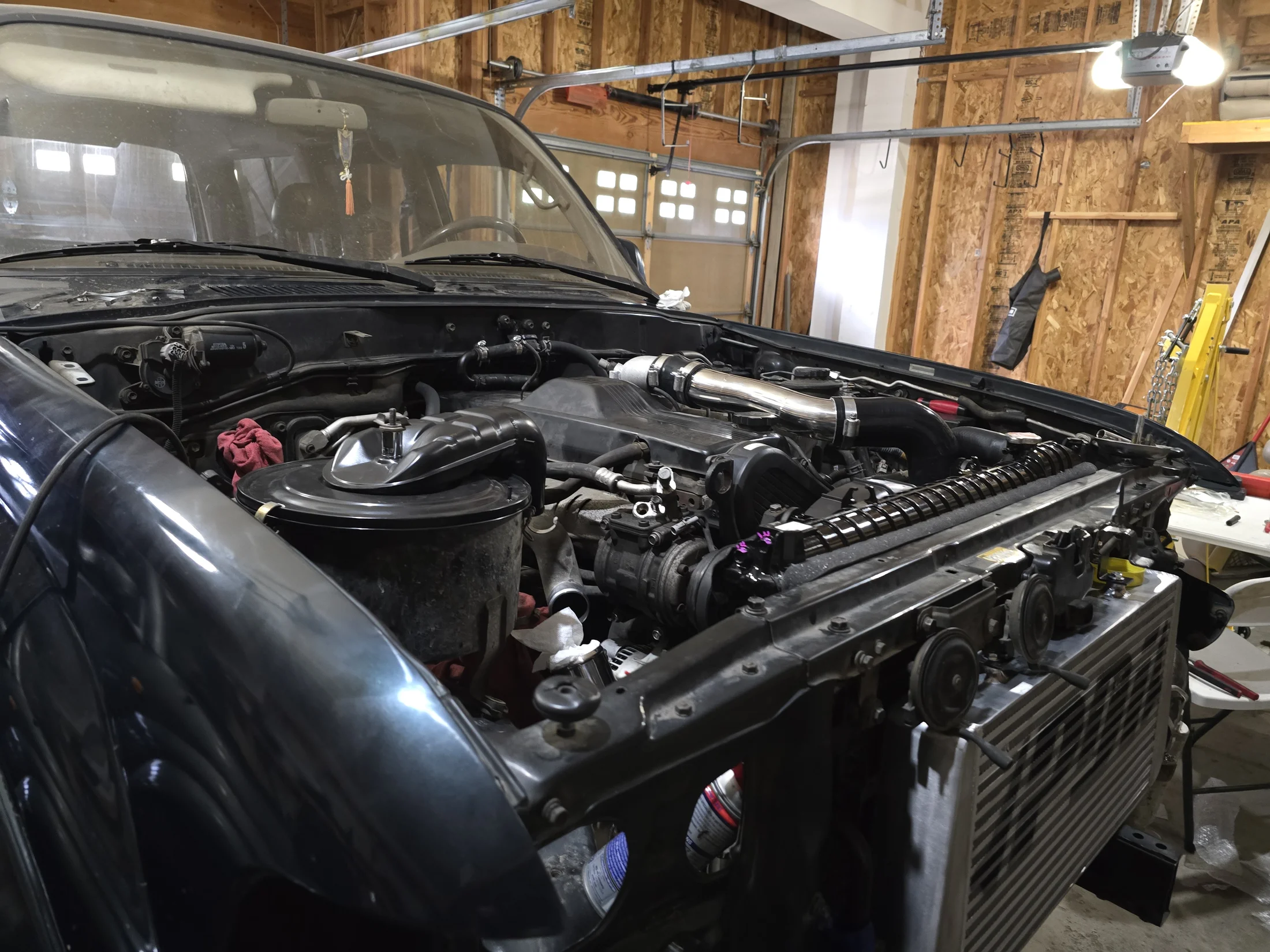

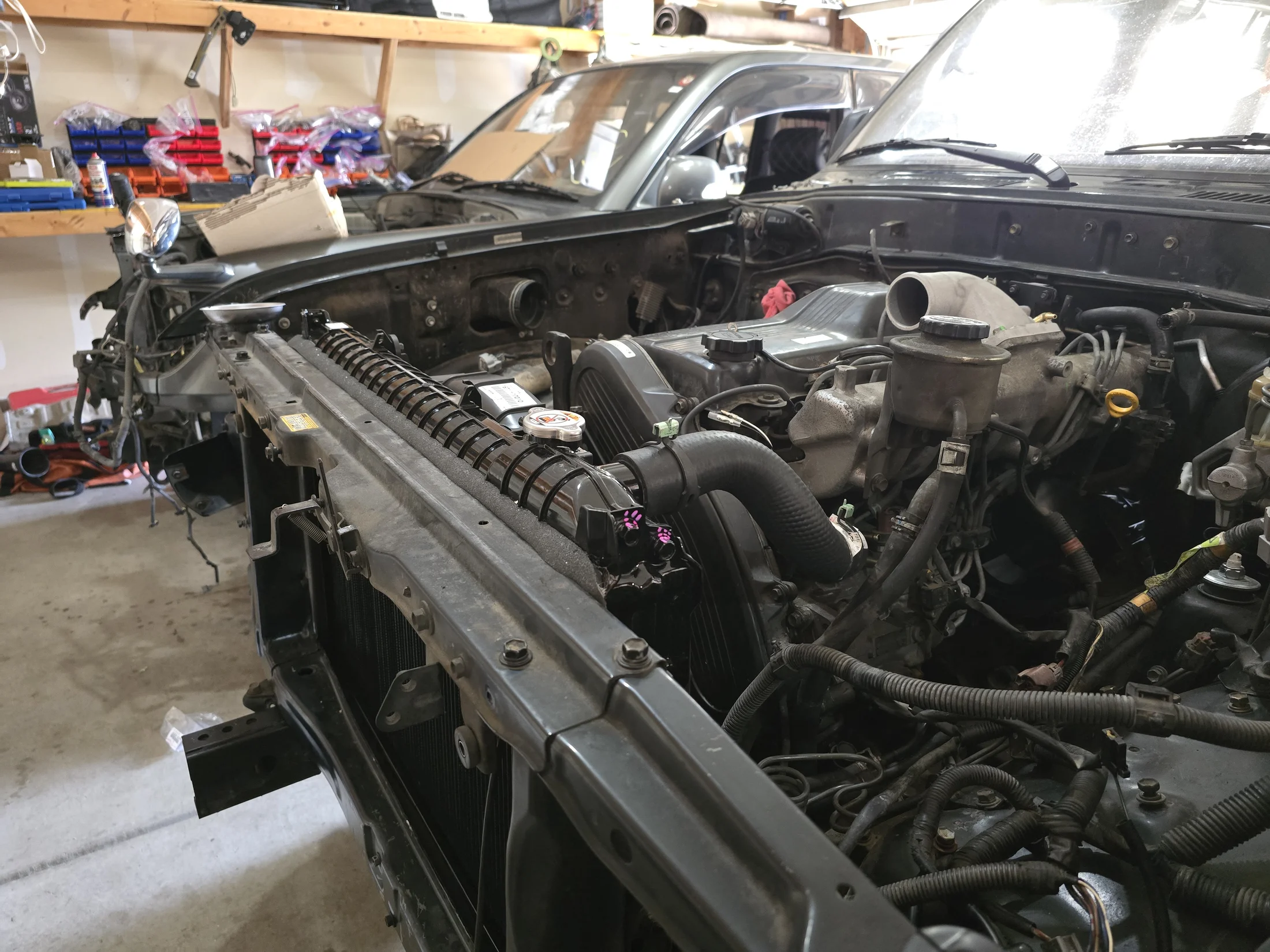

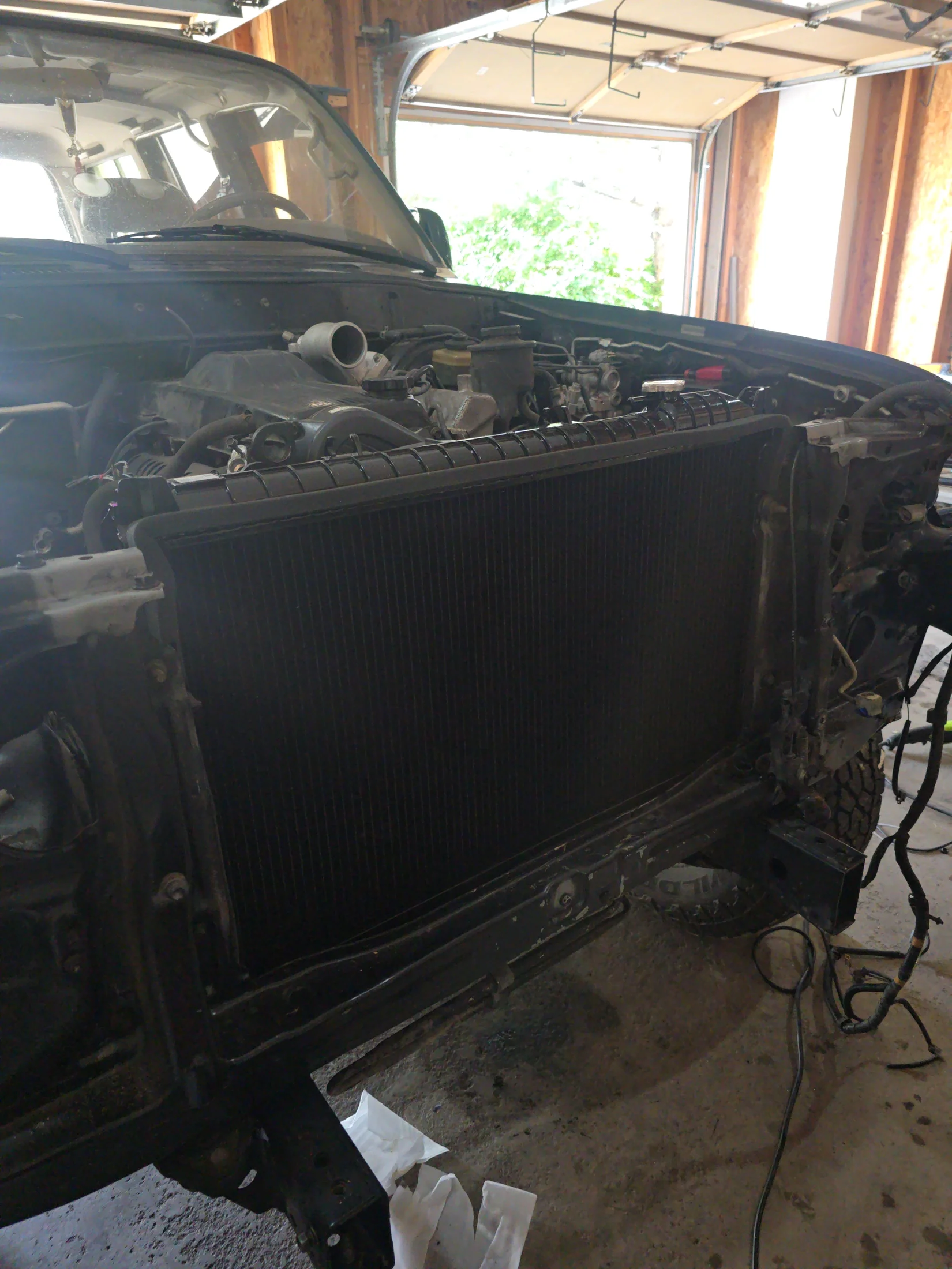

Tomorrow, PDI intercooler mock up. And if that goes well, we'll start to reassemble this thang.
Not a huge fan of the fitment from PDI, Its also setup for a aftermarket turbo, so im going to have to figure out some routing to make it work, got a few things ordered fingers crossed.
