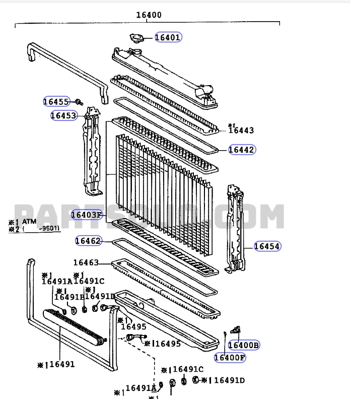

On the topic of cooling are you planning to use your 1FZ radiator and adapt a diesel fan shroud? My rad is new as of last year so my hope is to do just that, but haven’t got the parts in hand yet to dream up how to adapt it.
Since I have the HDJ100, I have that radiator, and honestly it's probably cleaner considering I was driving the 1fz-fe with mostly water because the head gasket leak. Something interesting though the radiator bracket part numbers are the same from 1fz -> 1hdj100 (Double checked this, they aren't RIP), the radiator is a different part number though. I'm going to attempt to use the HDJ100 radiator. ( I may see if I can move the brackets from my 1FZ rad to the 1HDJ100 Rad, We'll see. LOL)
For you though, check this out. You can buy the 1HDJ shroud still on partsouq, now will that just bolt up to the 1fz rad? I'm not sure. but it's worth maybe diving into.
Shrouds
1671117010
1671117011

Didn't want to screw around with guessing about radiators, and opted to replace the 25 year old parts anyway.
HDJ80 Radiator, Cruiser Outfitters
HDJ80 Fan Shroud, Partsouq
So I asked around, and you can get the HDJ80 fan shroud to fit the FZJ80 radiator by drilling extra holes into the shroud and probably using zipties or bailing wire.
Thanks @lelandEOD for helping me with the shroud part number!
Seems like a safe bet to just replace if old. I was eyeing the 1HZ shroud, and didn't realize PS had the HDJ80 shroud available. Ordered. 🤝
This is what I'd imagined, but hadn't seen it implemented. I'll probably try to do it with some fasteners and fab up a bracket to adapt if I need to.

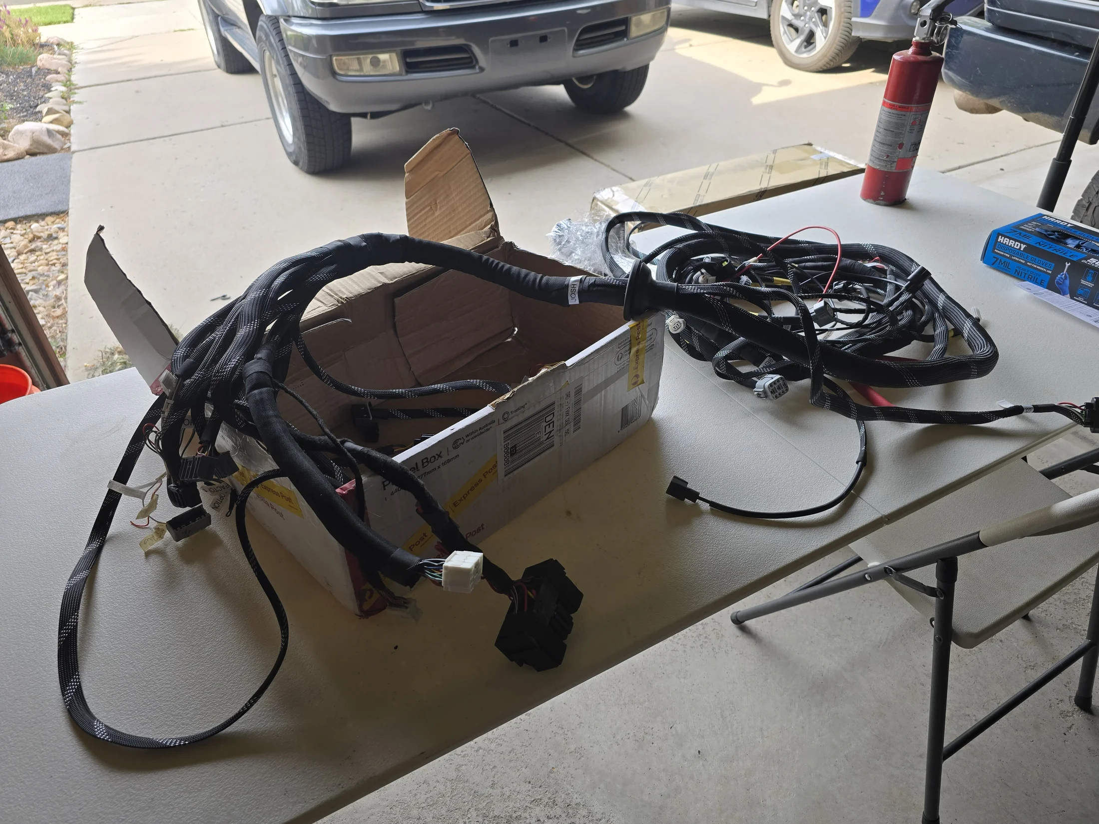

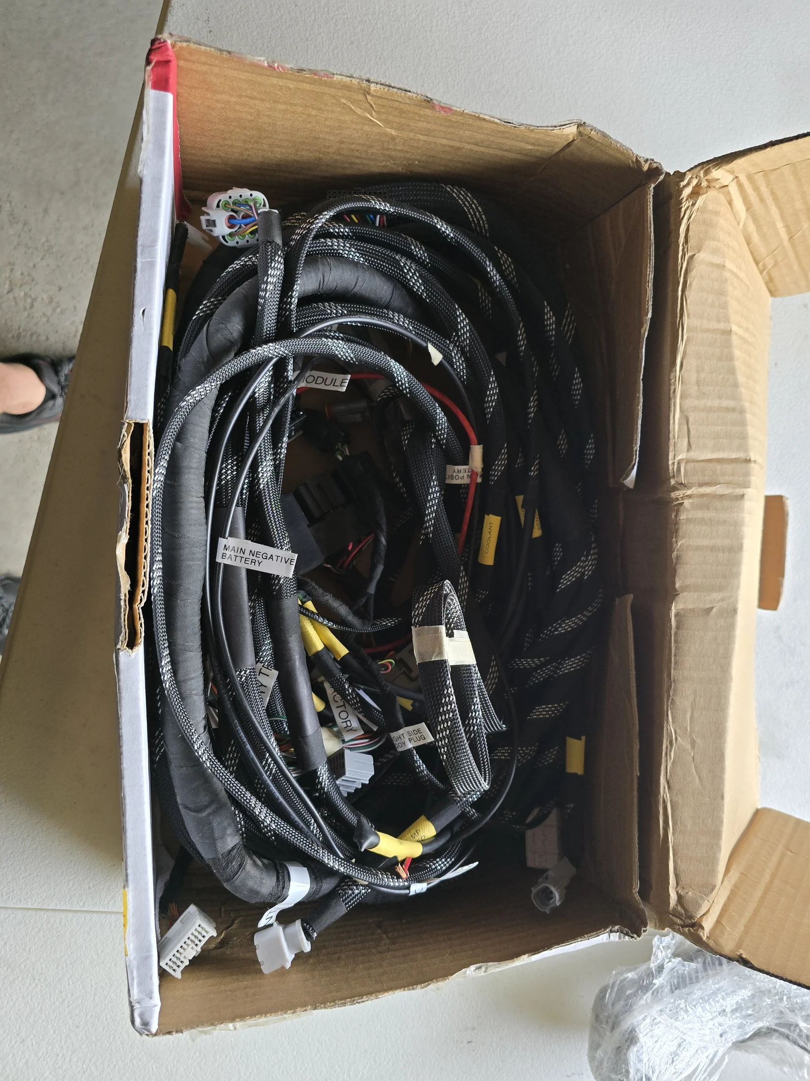

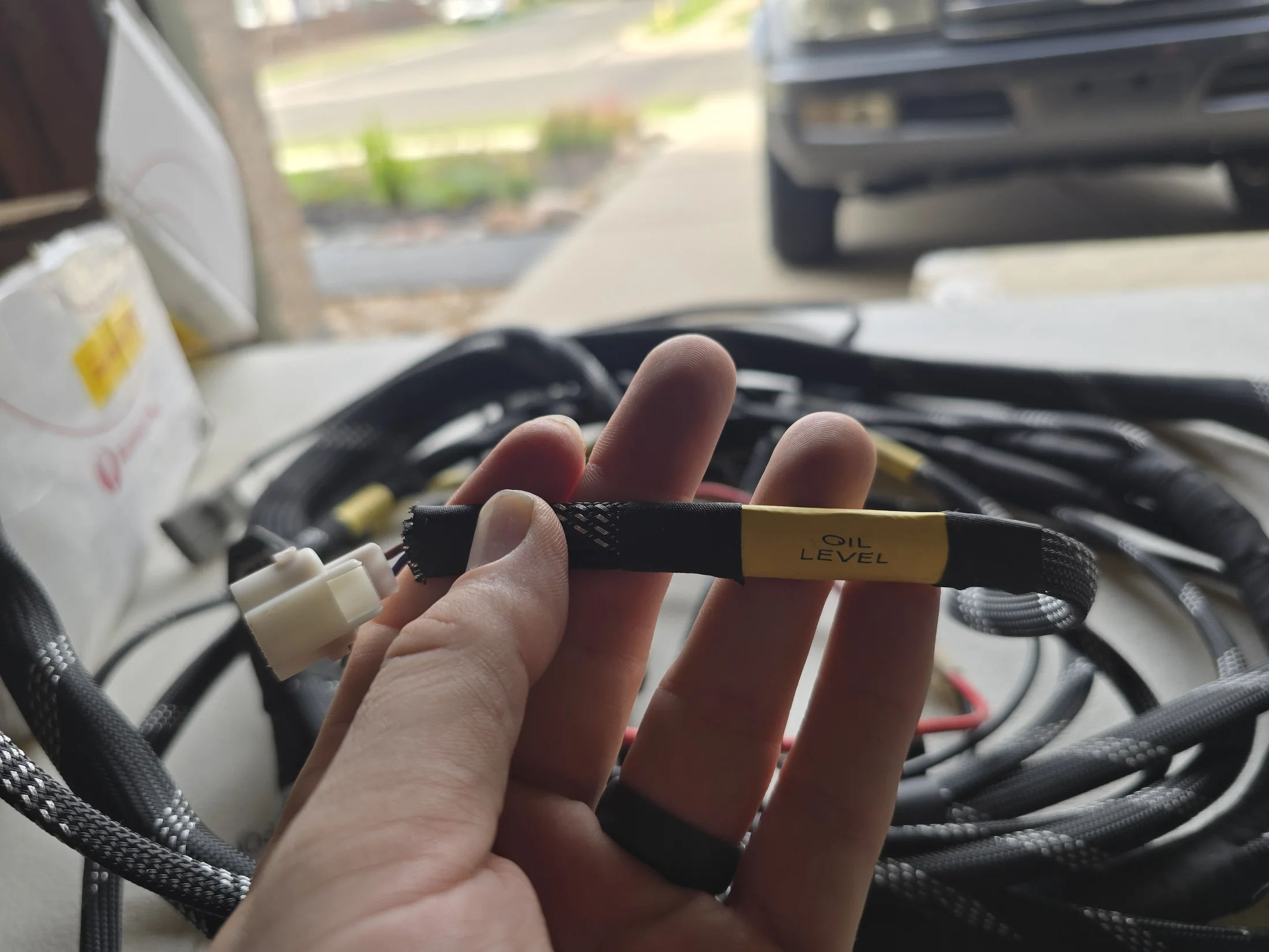

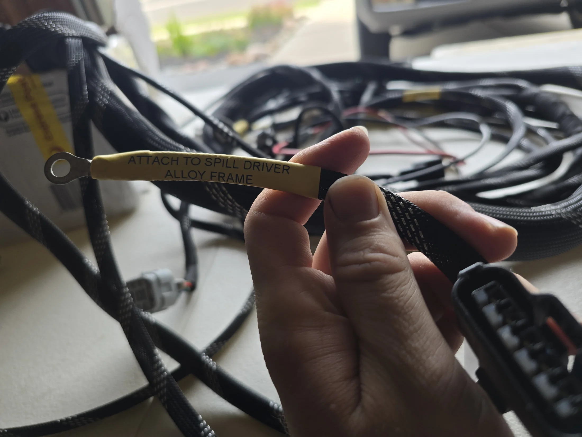

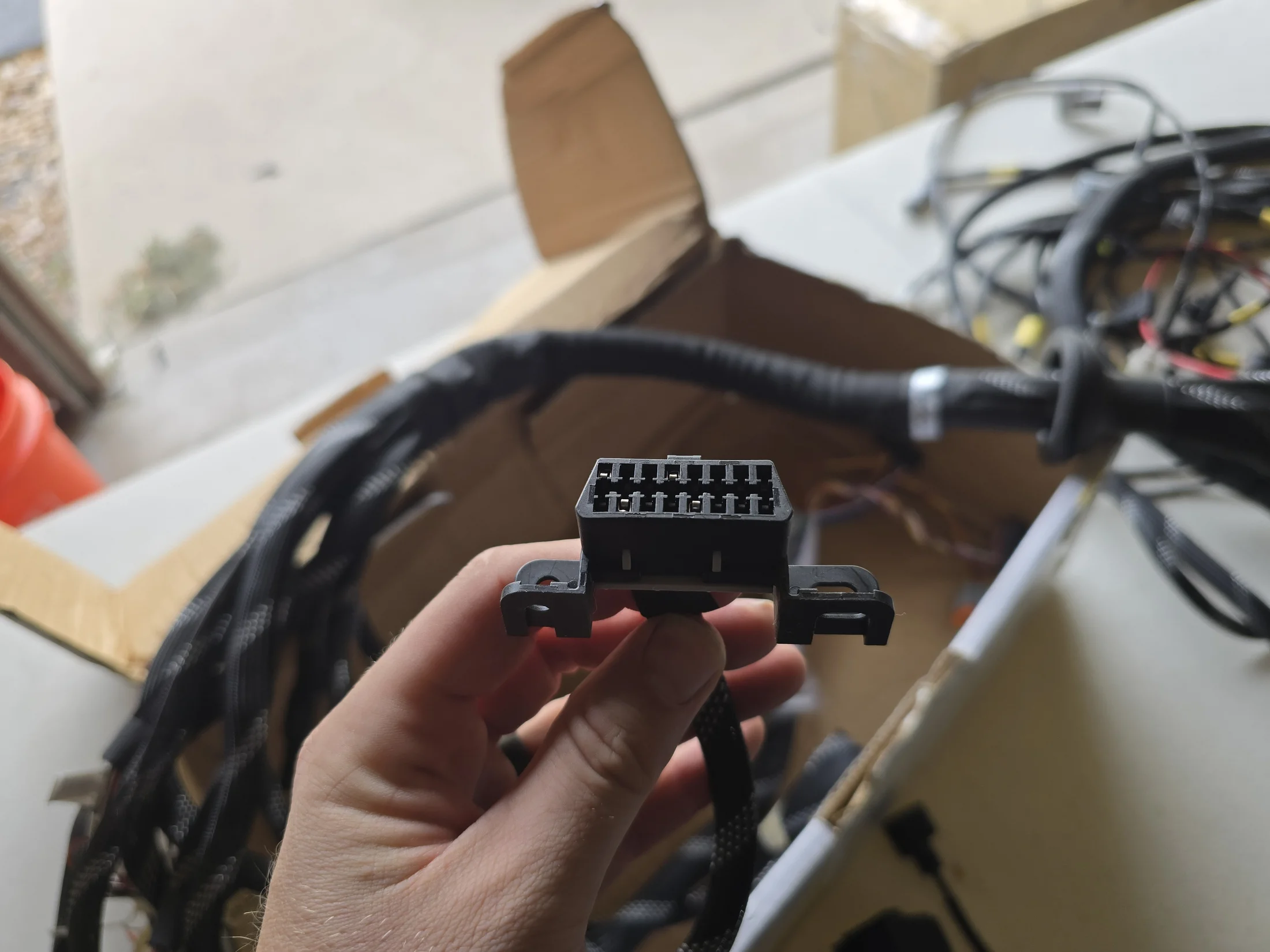

Dude does nice work. I've made a lot of custom cables for things over the years and that all looks excellent.
Yeah its definitely professional. I think it was totally worth the coin. Mick was great to work with in general and to be honest I probably wasn't the easiest client.
Total cost was 1900.00 USD for both the engine harness and transmission harness.
The thing I appreciate most is how responsive he is to questions or concerns. He was also super quick to ship after payment.
If you're going manual, I'd totally recommend Mick. If you're going auto, about the only person who'll do them are Thrashlux but I cant speak to his harness quality as i haven't seen it in person.

That harness from Mick looks absolutely mint. Looking forward to hearing your experiences wiring it up.

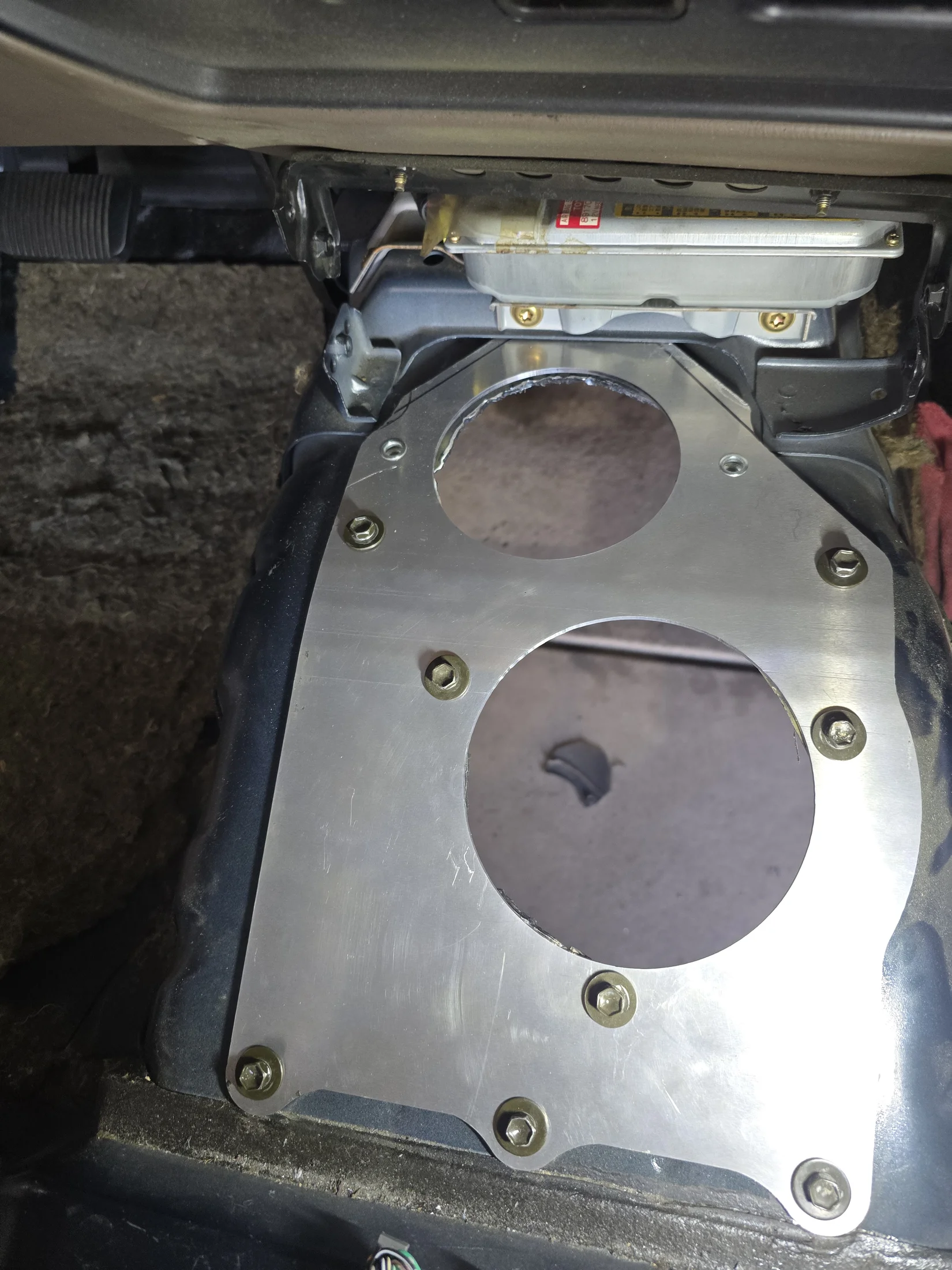

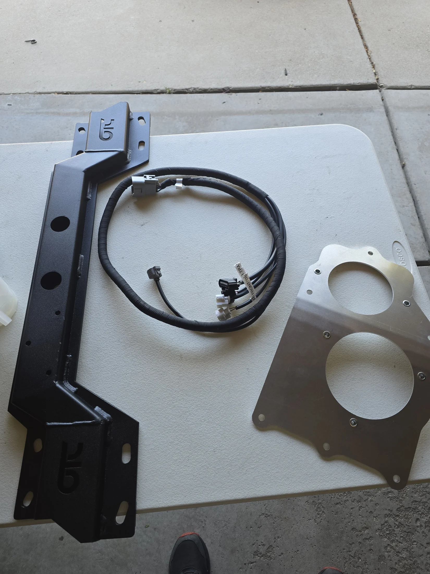

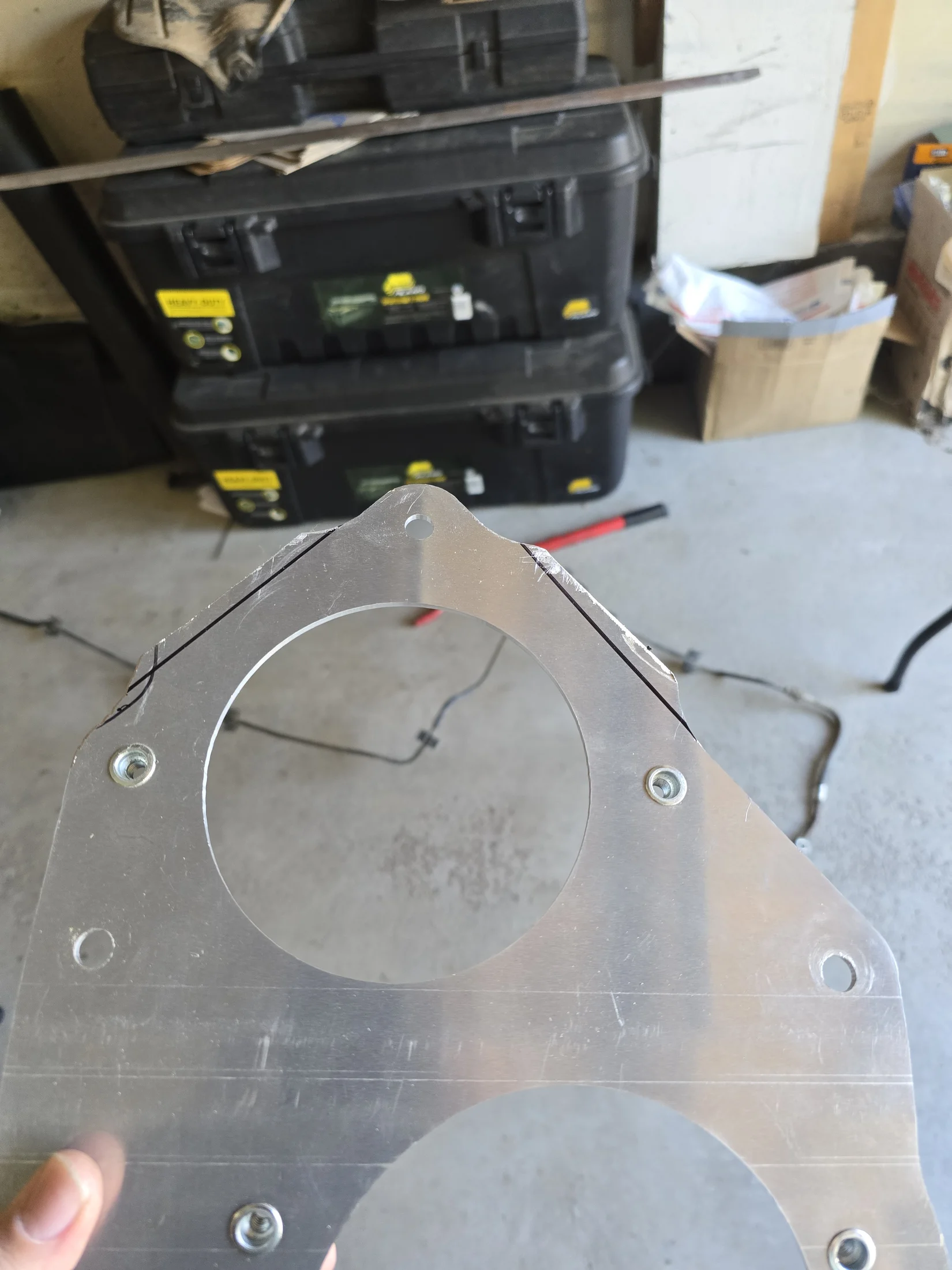

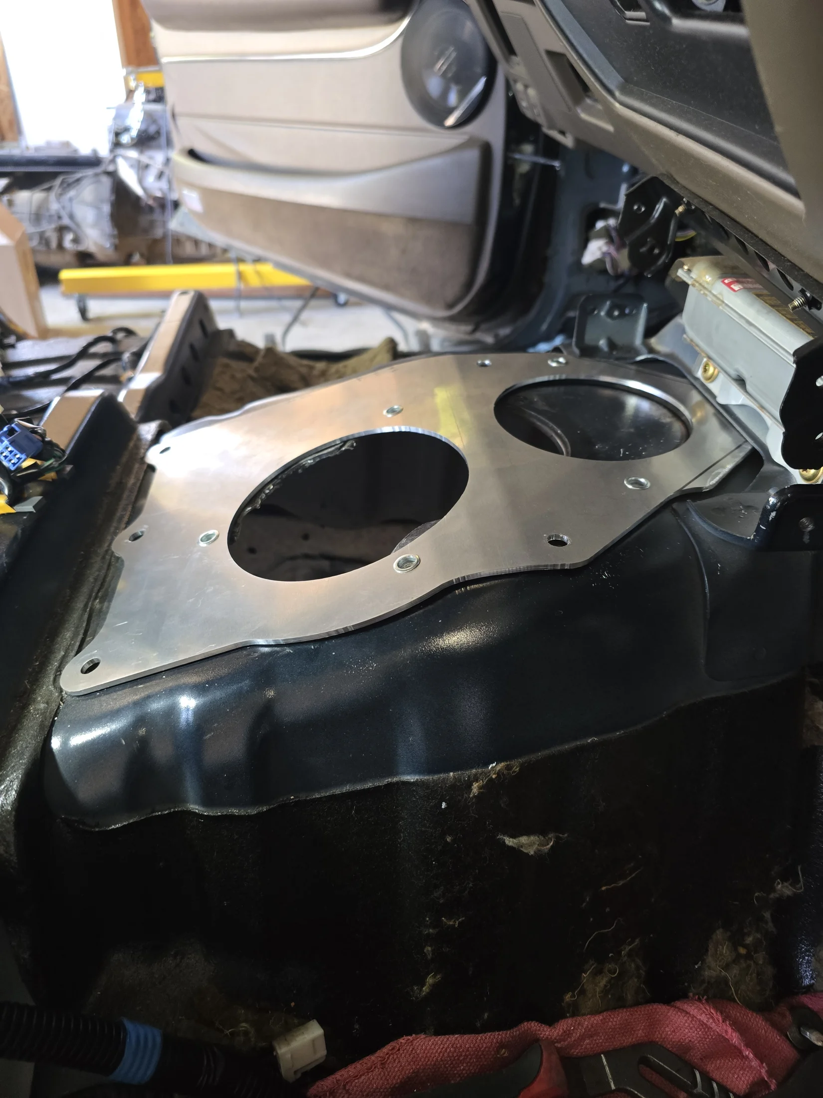

More stuff is here, just a few things left, finally starting to feel like most of the financial damage has already been done....
Manual transmission harness, OTC Auto to Manual crossmember, and auto to manual transmission tunnel cover plate.

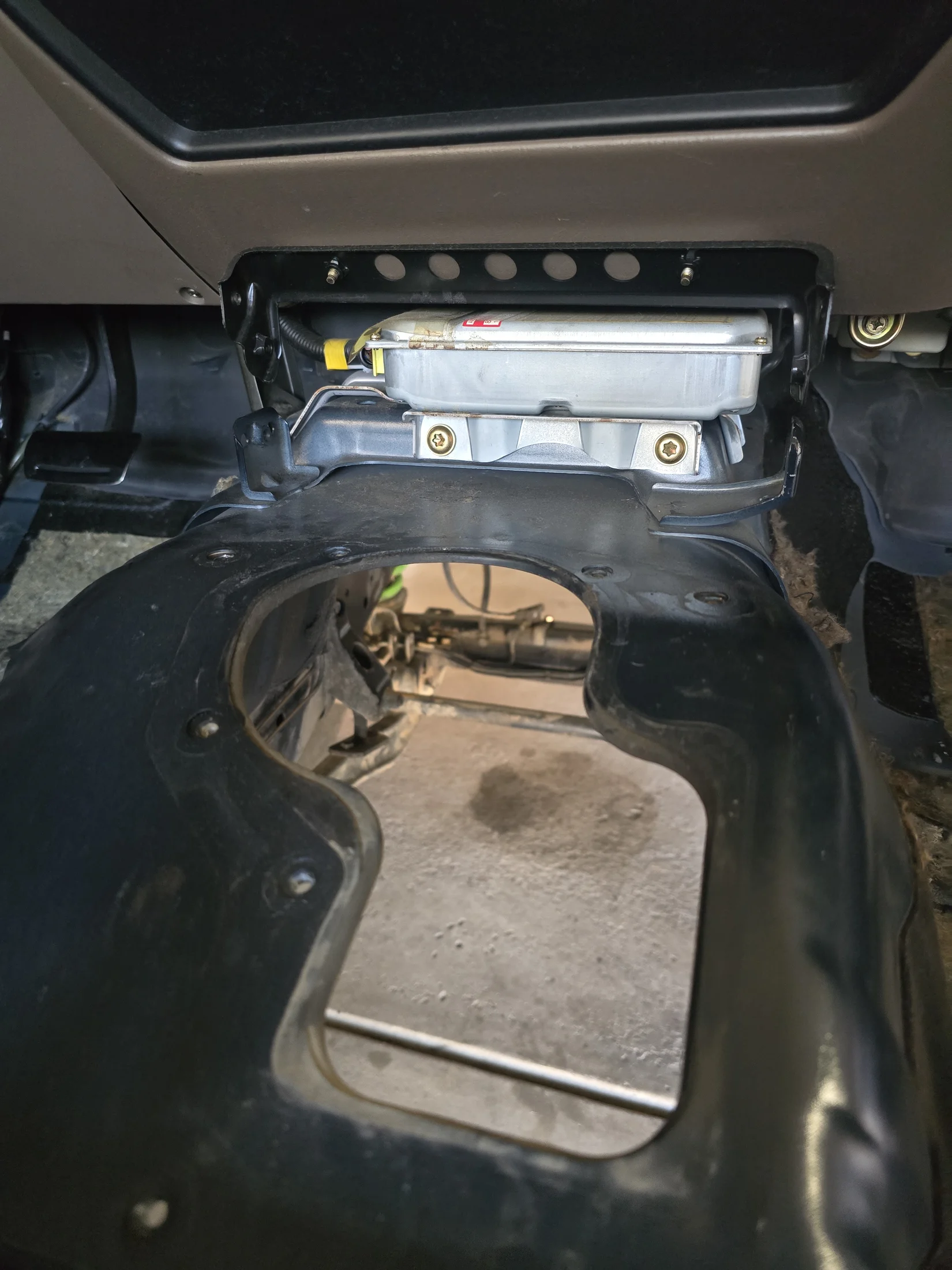

The cover plate will have to be modified a bit, since in the states we have an extra module under the dash at the top of the tunnel for airbags.

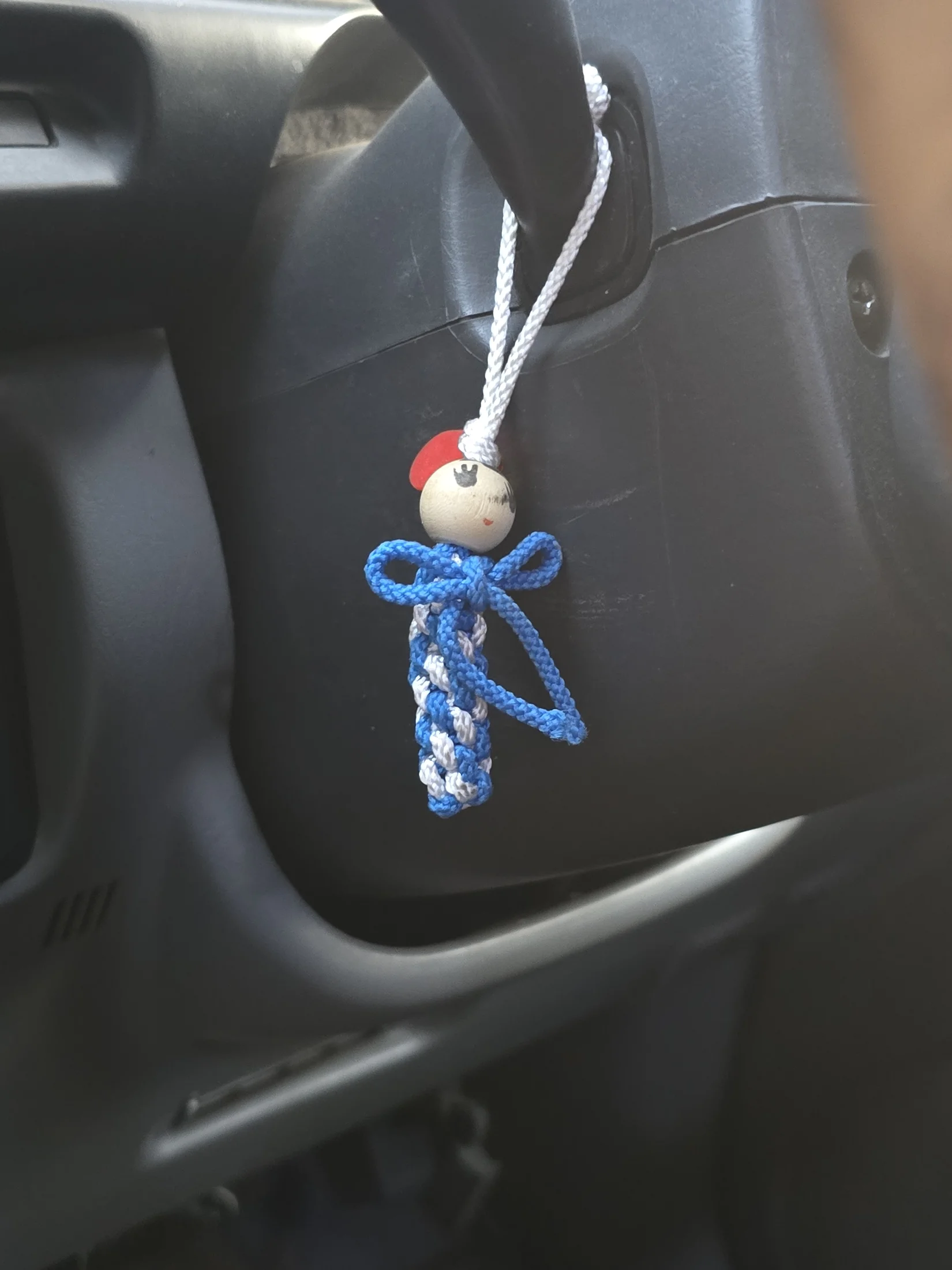

these came in the 1hdj101, figured i might share. Just some cool personal stuff from the previous owner.
They also left a business card in the center console, i reached out via email using chatgpt to make a translation, never heard back haha.

Yeah, you gotta keep stuff like that. I kept the PO's dashboard hula girl...
