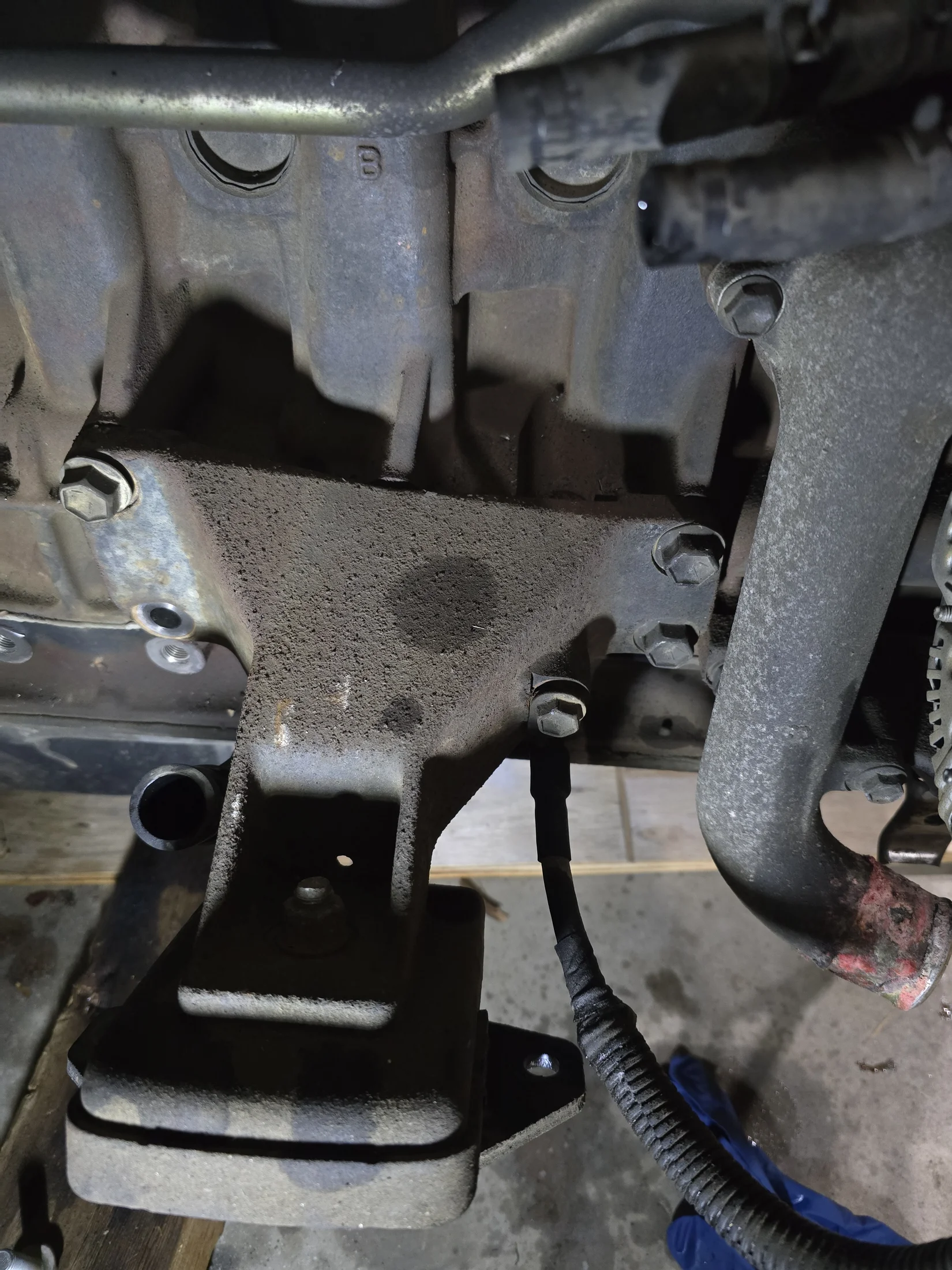

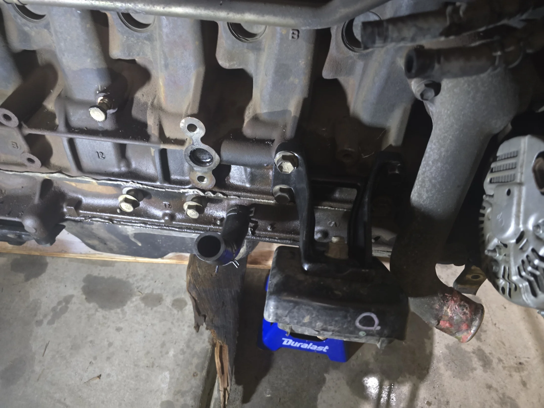

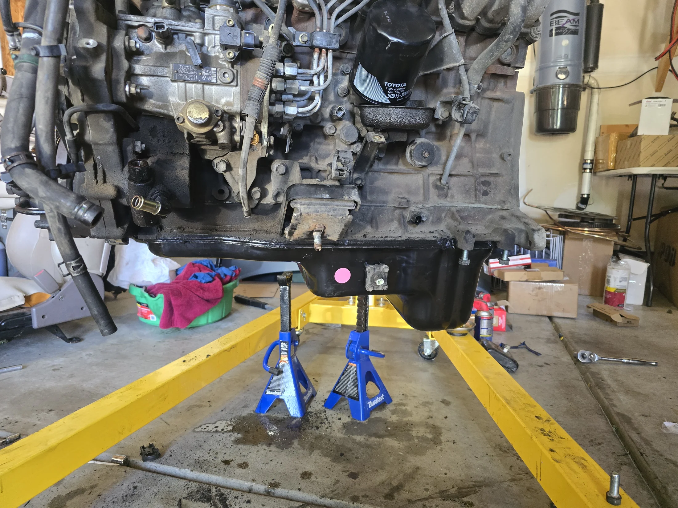

@lelandEOD, can you help me understand motor mount bracket placement? This should be the correct 1hz/1hdt bracket. It moves the RH mount forward towards the front ofnthe engine.
are the left hand/right hand motor mounts supposed to be offset?
do you use the motor mount frame side thats further forward? Thanks. Trying to verify this 100%, i really dont want to have to pull this again because i ****ed up a motor mount bracket.

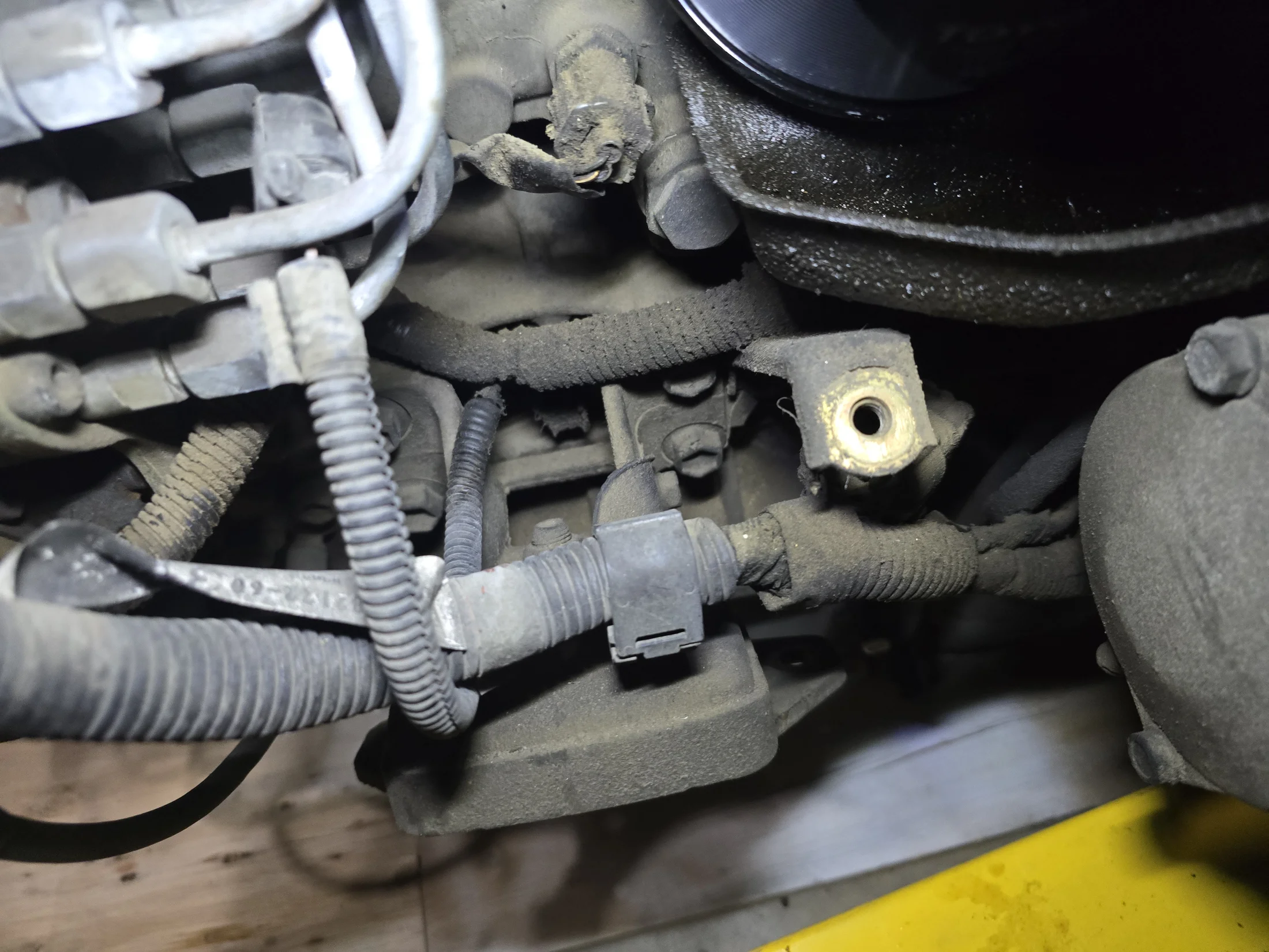

Got the exhaust manifold/turbo assembly off, phone died as I was taking the picture lol.
Ill check on the turbo tomorrow and see if there is any shaft play.

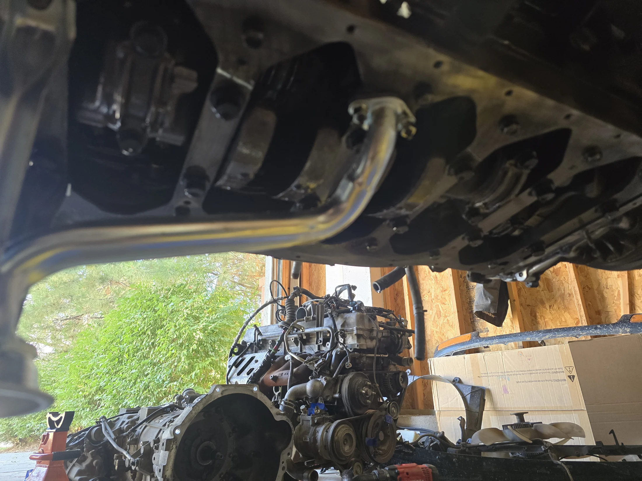

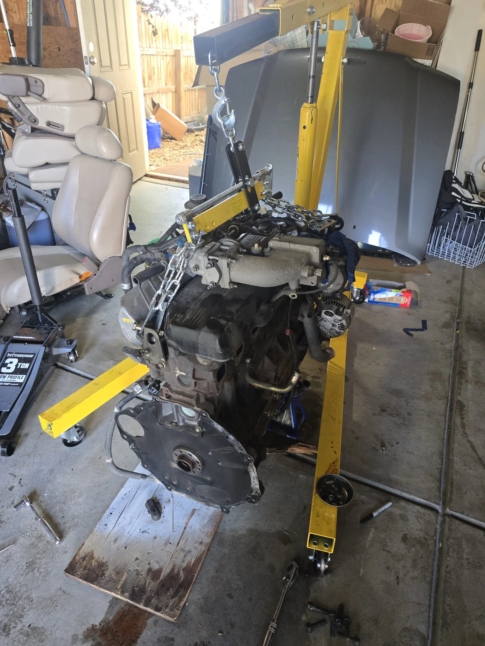

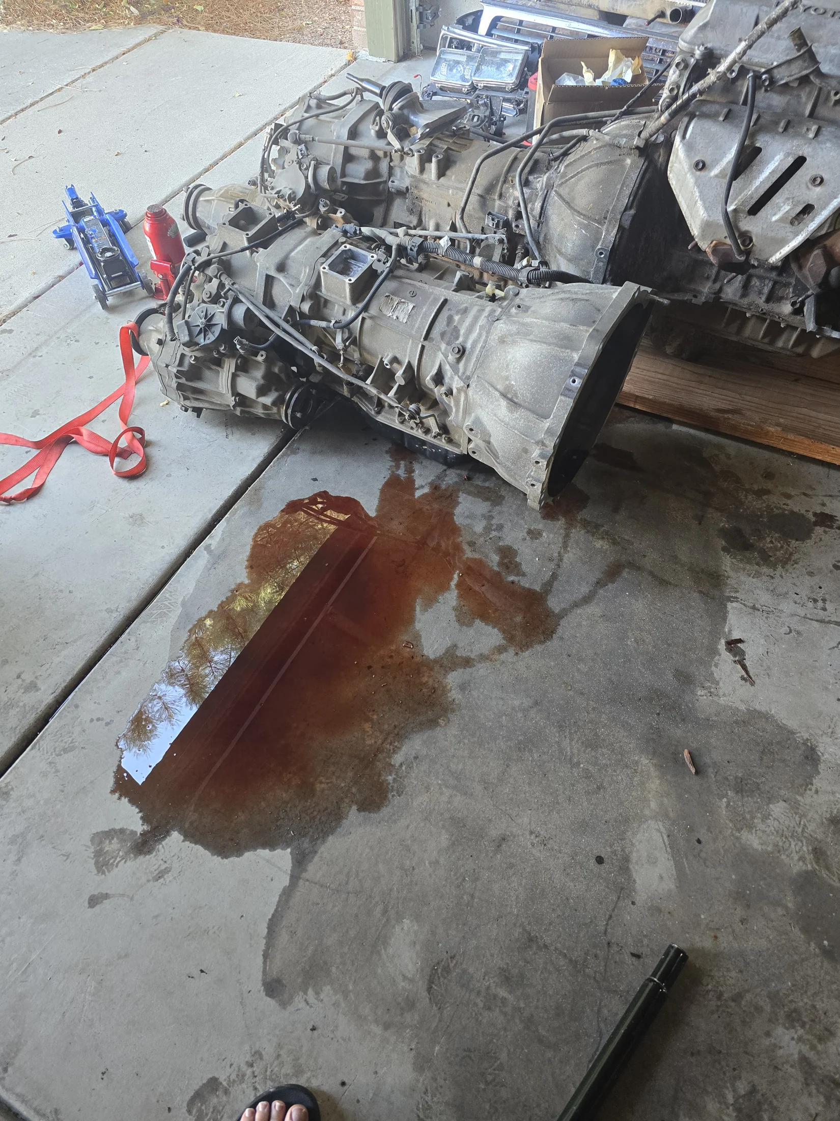

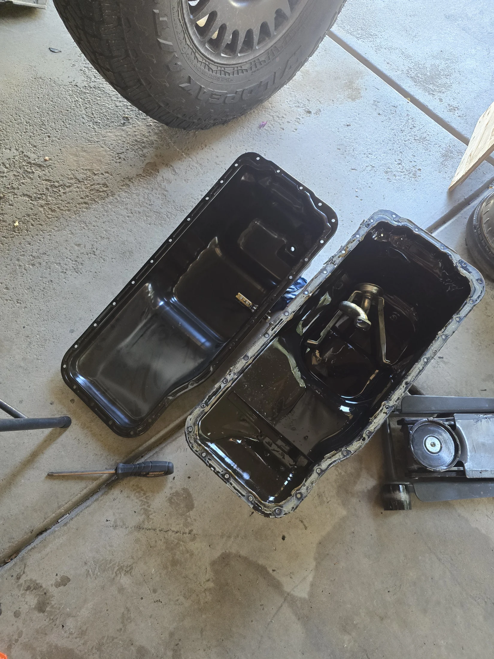

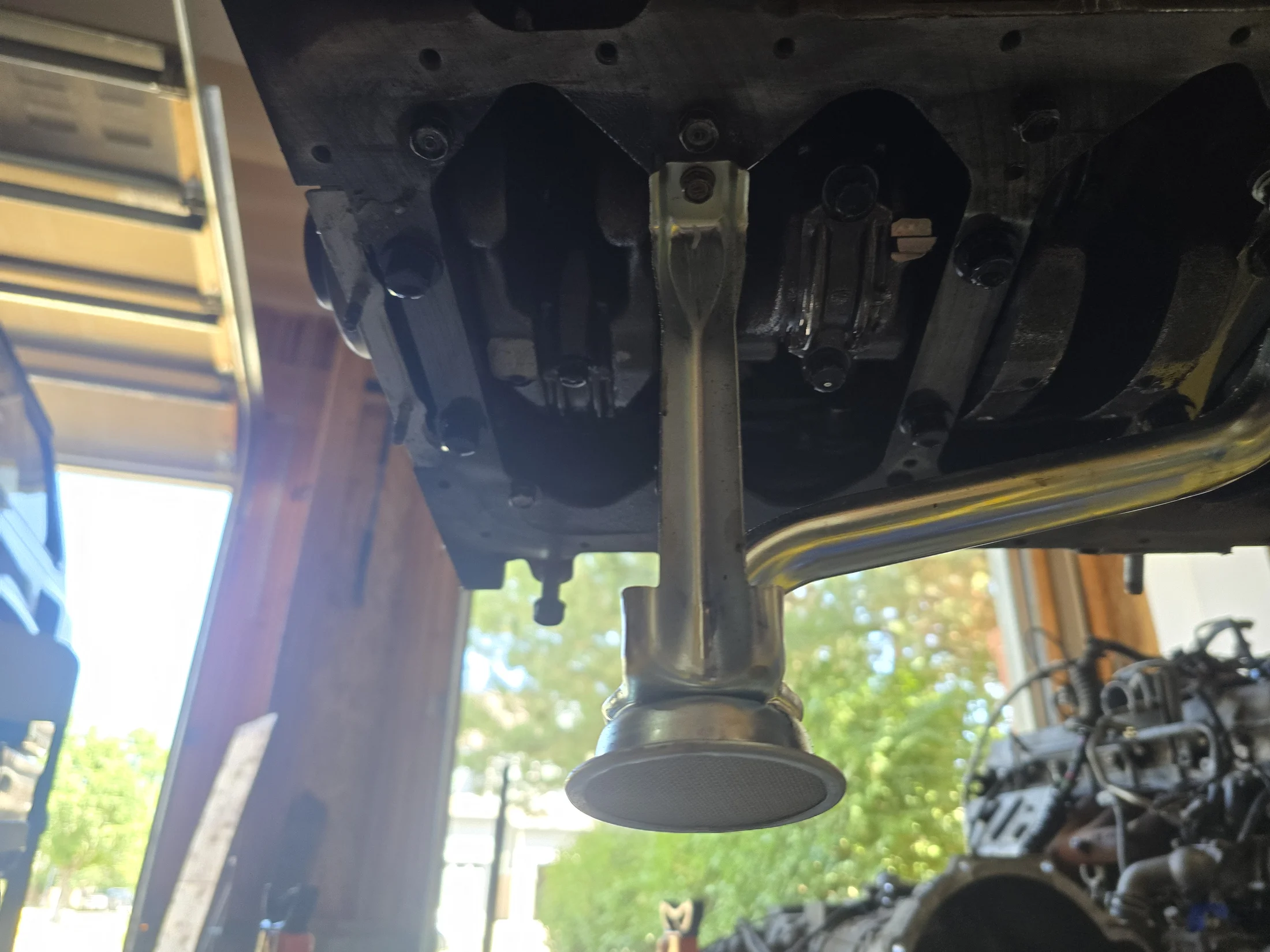

Productive day, tomorrow im going to separate the transmission, and change the oil pan.
Not much done today/tonight had to get some work done.
Motor mount changed to hd/hz

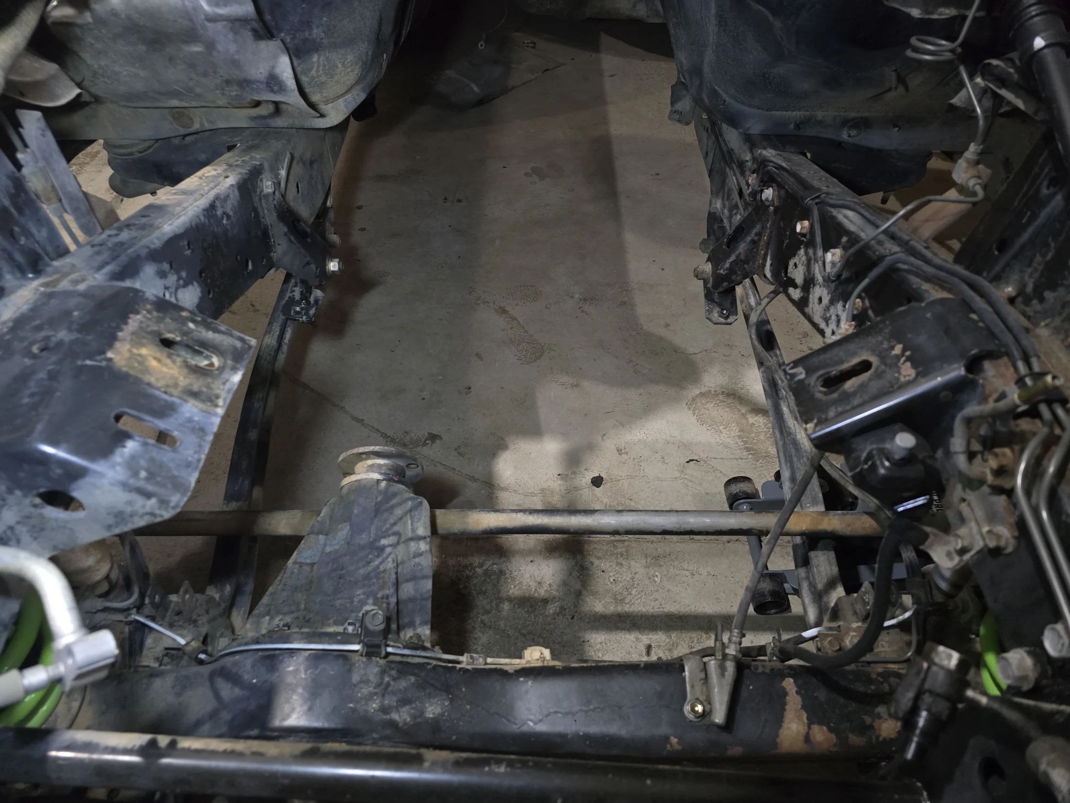

Got the oem engine harness off,
Checked turbo shaft for excessive play, good to know its fine.

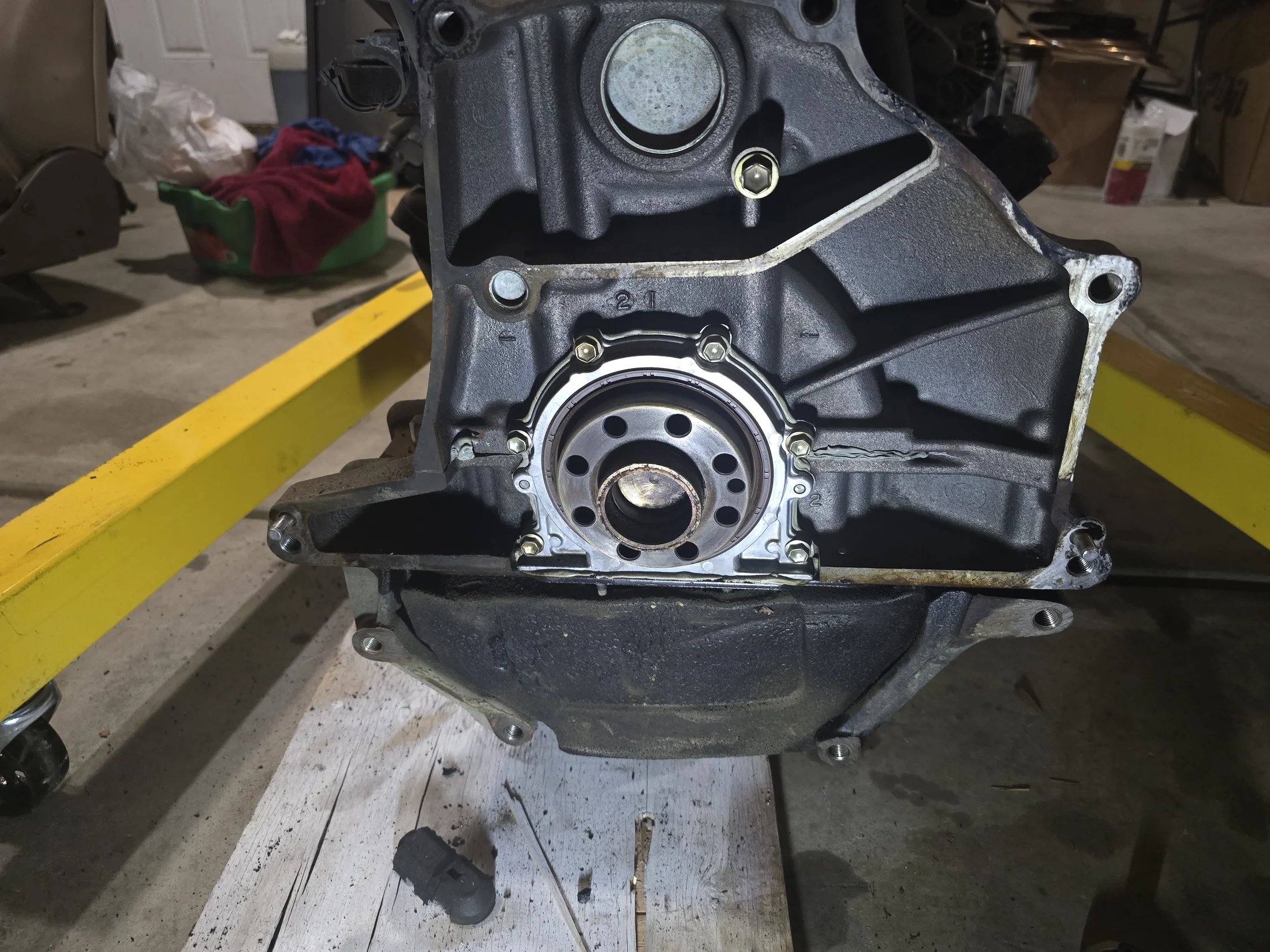

This might come back and bite me in the ass, but the rear main is dry as a bone, im going to run it as is.
Mainly because the essence of time.
Im sore, but as long as the transmission makes it here this week, she'll hopefully be sitting in the 80.
Looks good. The isolator will only fit in the forward most hole on the PS. If you were to try to use the other one, the engine will probably contact the firewall first.
Thank you!!!
Same - rear main was dry for me and looked mint, so I left it. Hopefully it stays gucci for a long while, otherwise I’ll regret not doing it.
Ya $15 part now or pull an auto trans later!? 🤦‍♂️ 👌
Cheers
Im not putting in an auto, im waiting for my h152f. Its not the money or effort im against, its time. This is my daily im swapping.
This isn't going to be a perfect engine swap, im sure itll be full of lessons learned, and sweat equity.
I just simply dont have the time to wait two weeks for a part that hasn't failed yet.

So you are waiting for a trans but can’t wait for a seal?
It’s been a standard to change a rear main when an engine (or trans) is out for decades.
Some lessons do get learned the hard way, hence me telling you to put the seal in now.
Your build your choice. 👍
