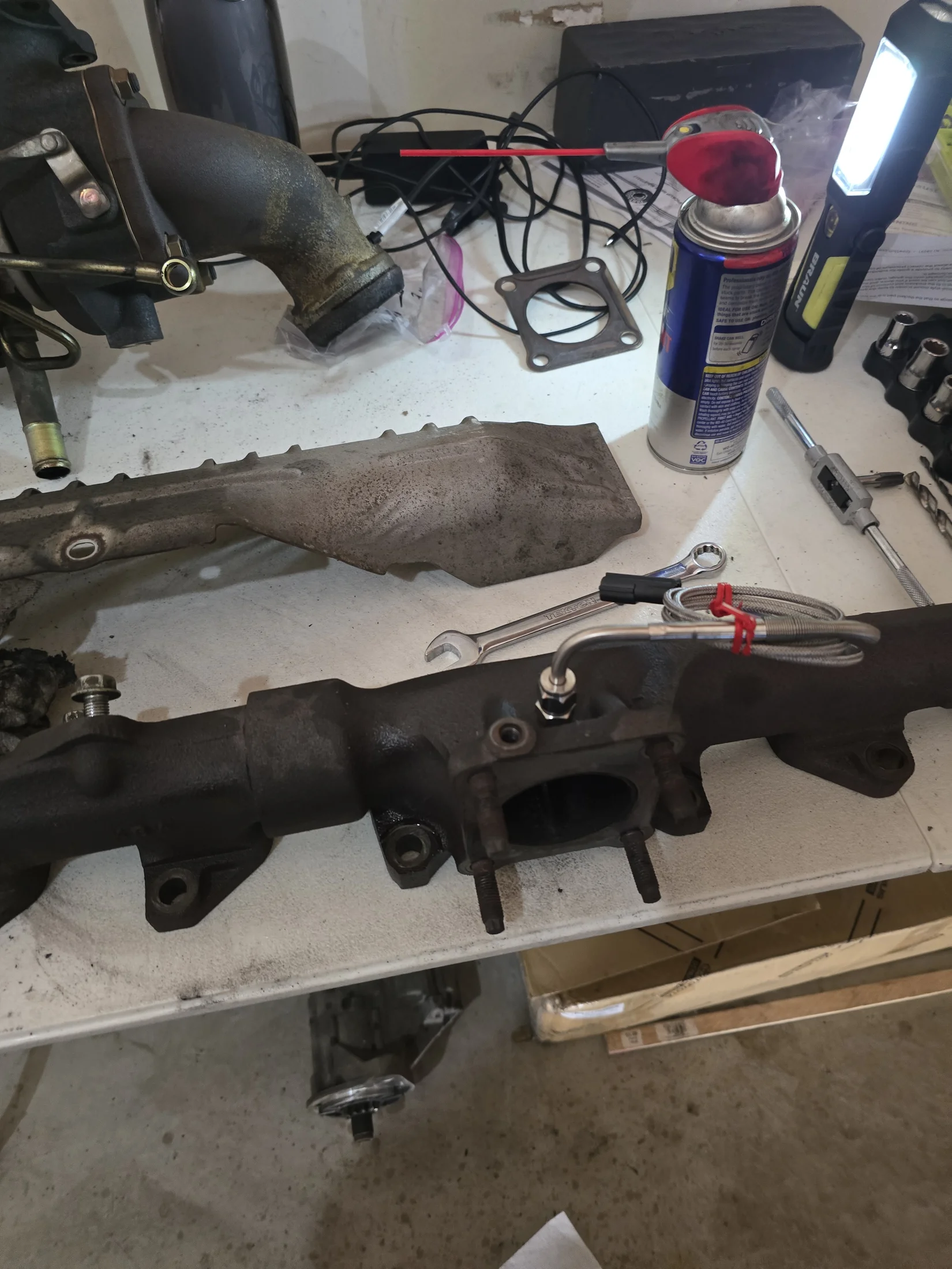

I did drill and tap my exhaust manifold first, Pre-Turbo EGT sensor installed.

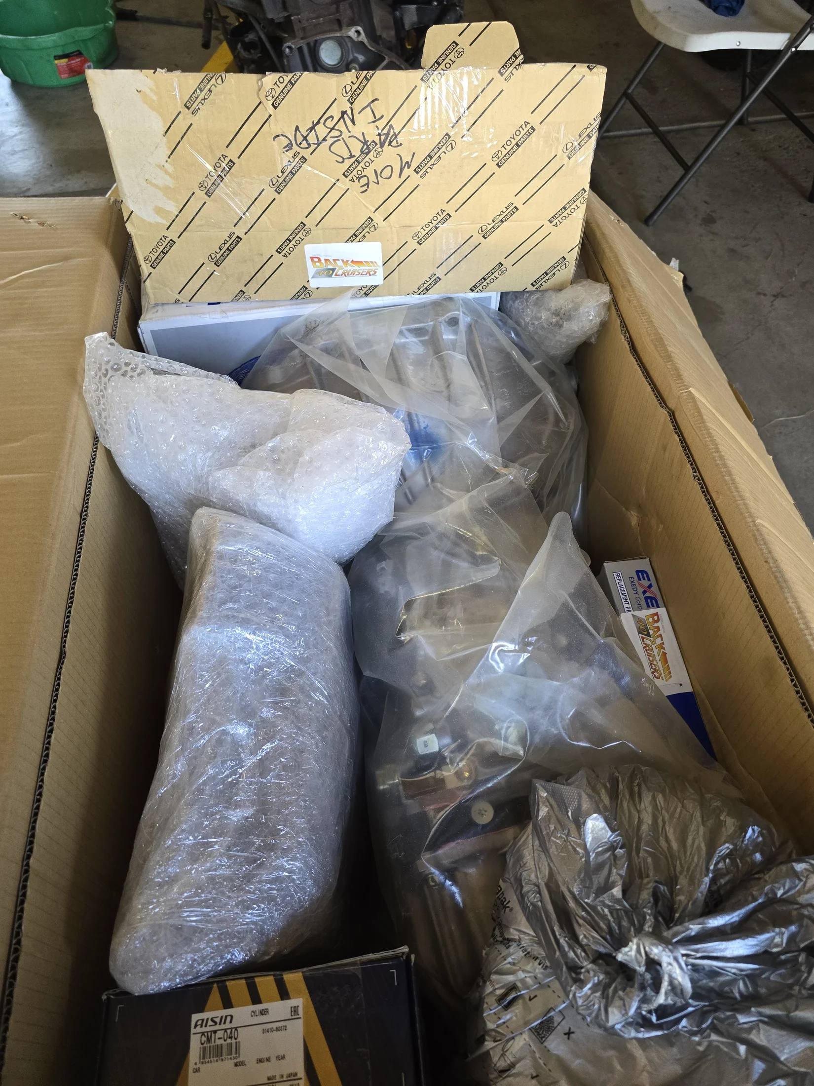

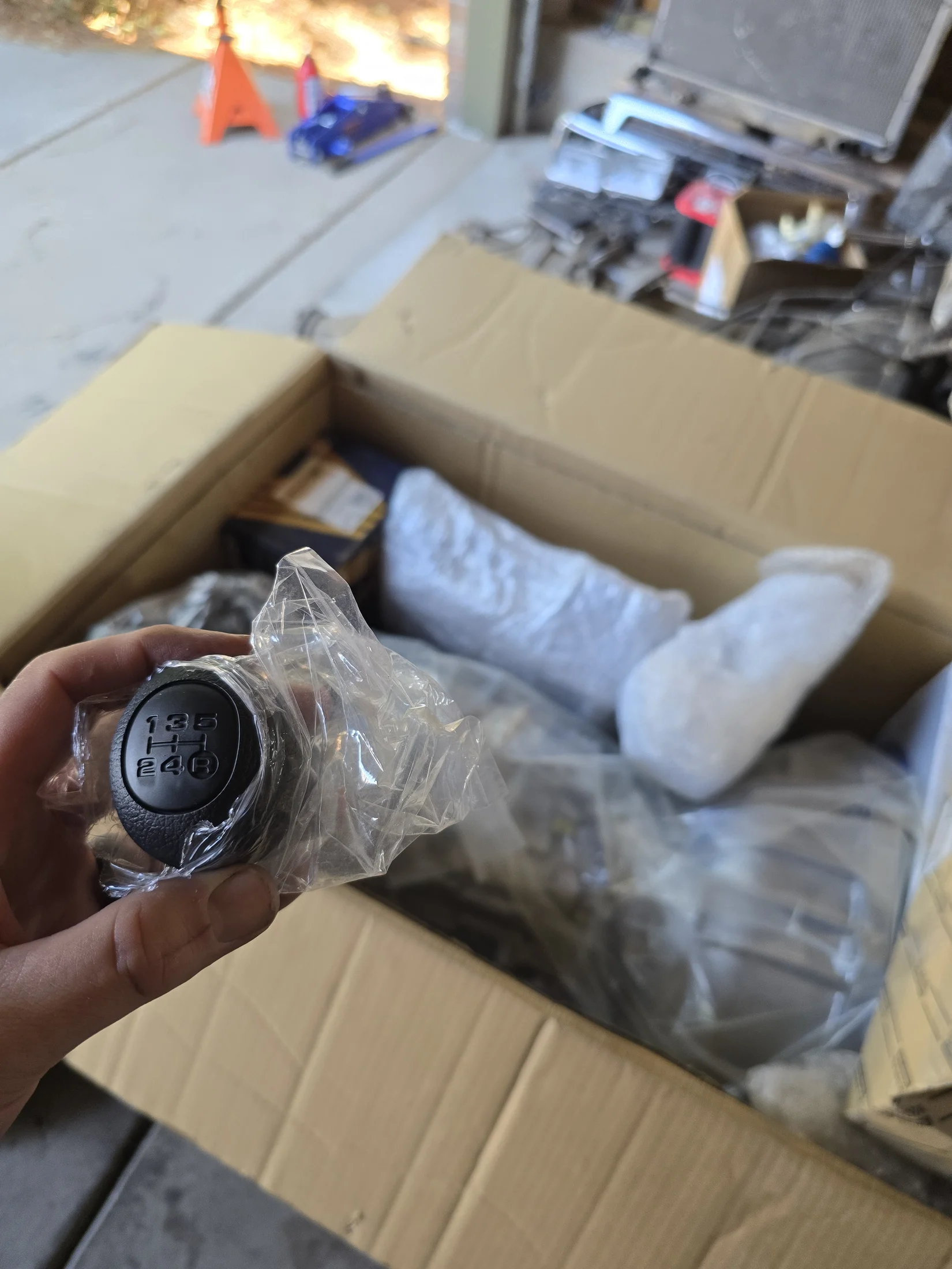

What do you actually have in there? My eyes are old and tired. Where did you source this large box from?
H152f swap kit, back40imports, comes with pretty much everything except the clutch hard lines.
Also has the correct input shaft for the FTE ready to go.

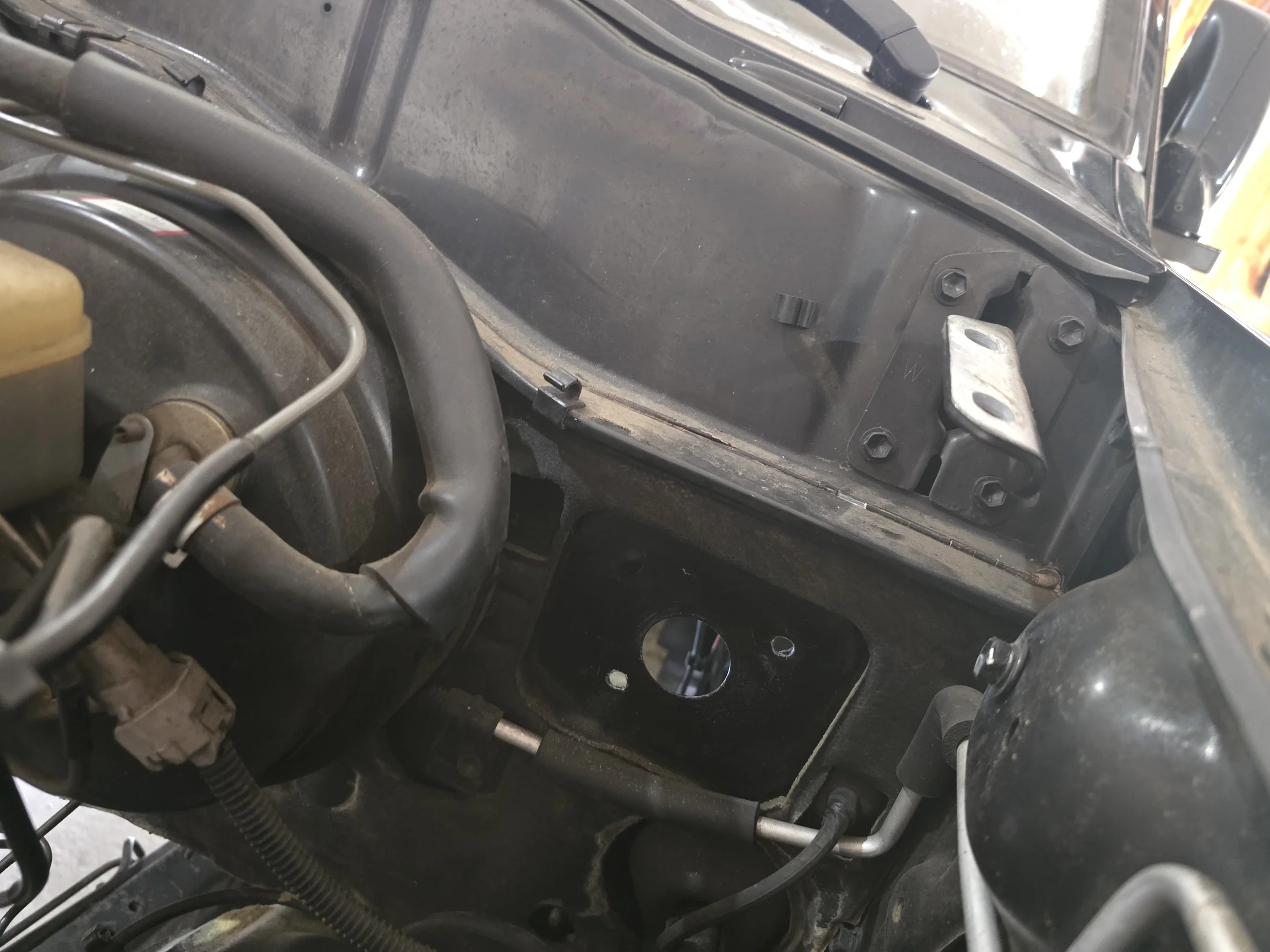

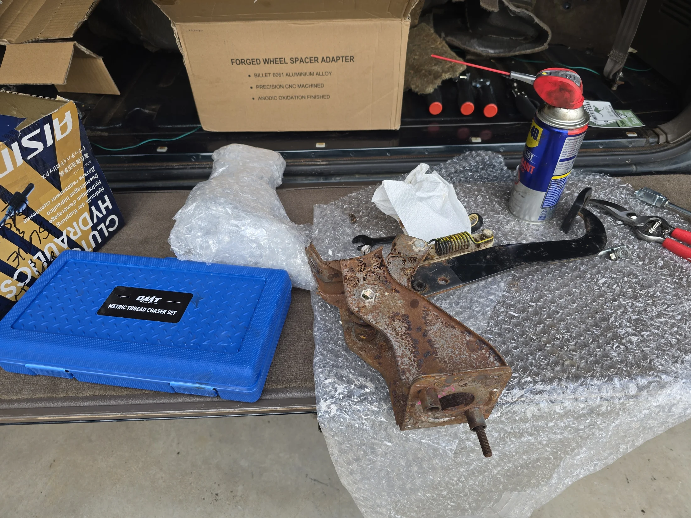

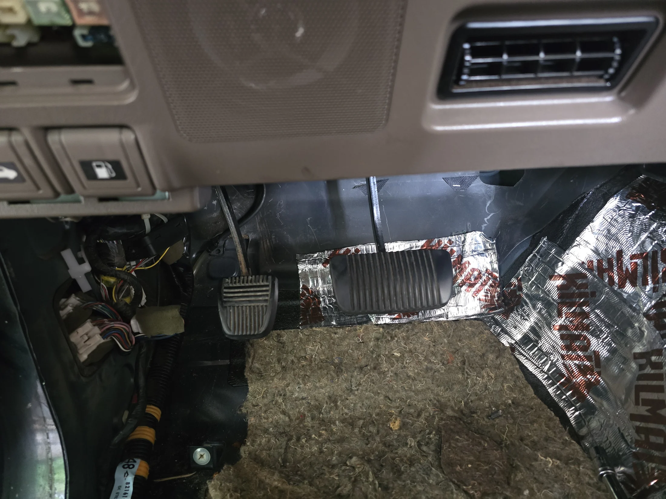

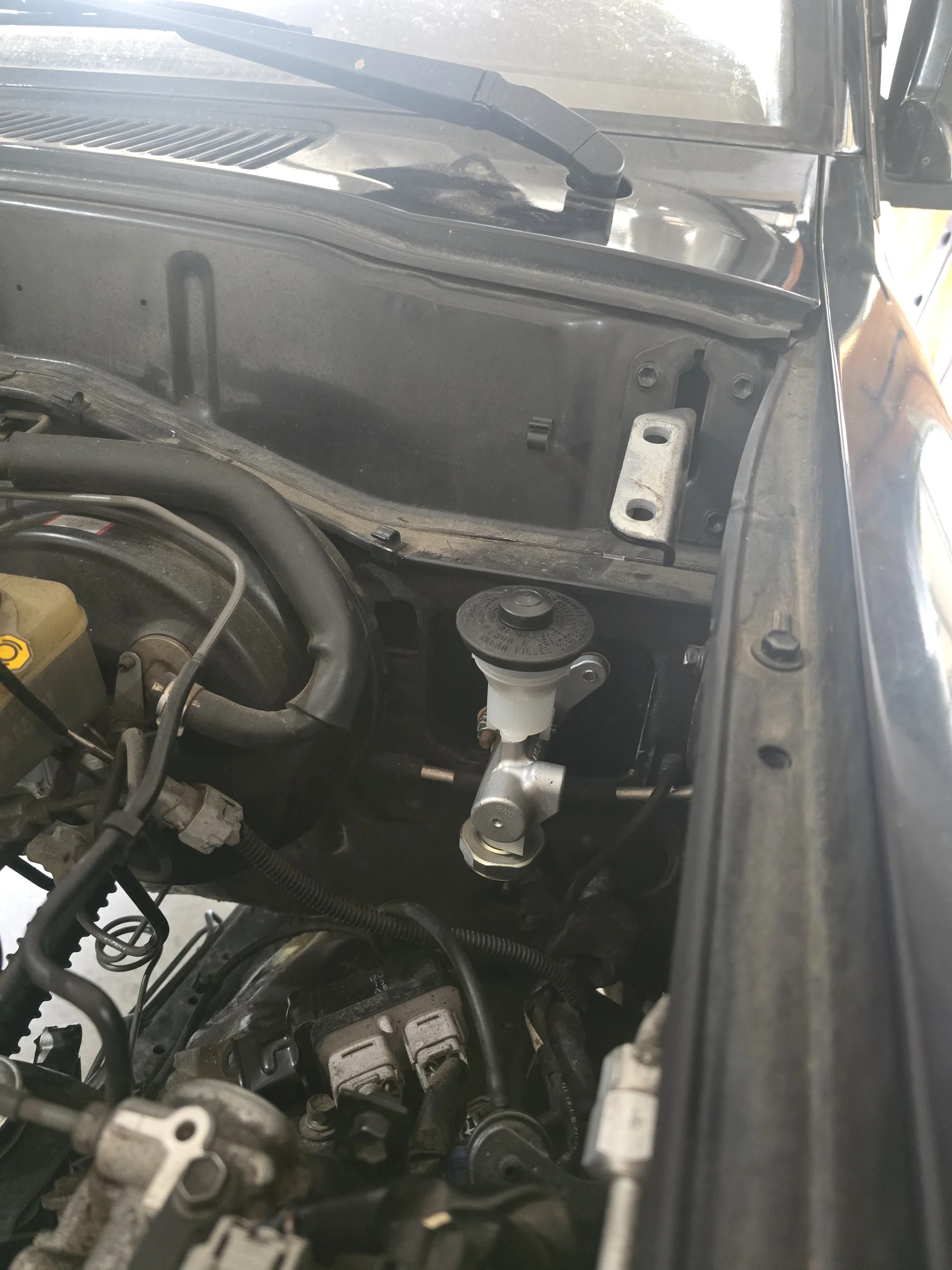

Boom!! Like it was meant to be there from the factory! I was going to clean up the pedal assembly, but got carried away and mounted the damn thing.
Shout out to @Rock40 his thread was a huge help in getting the clutch in.

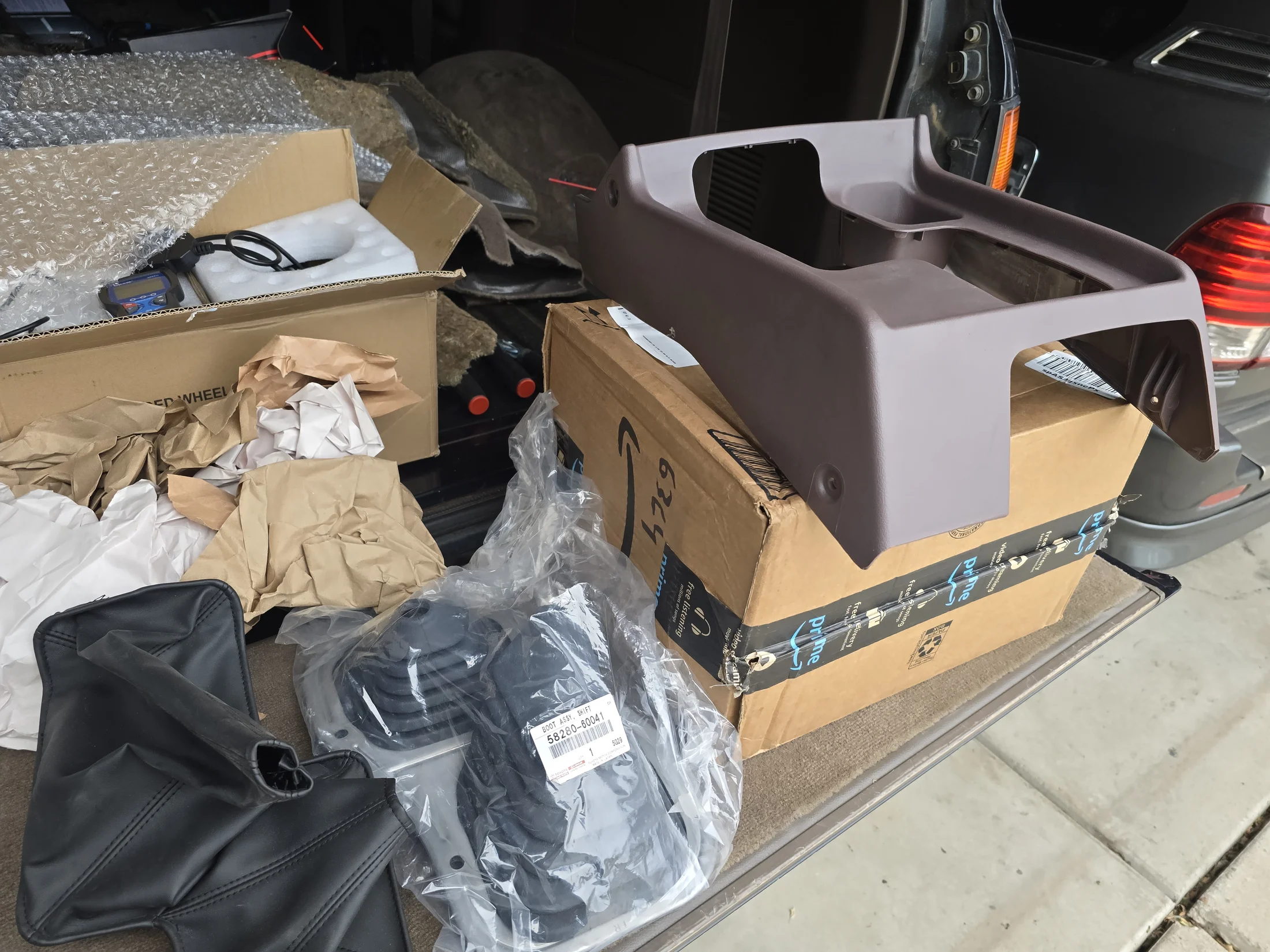

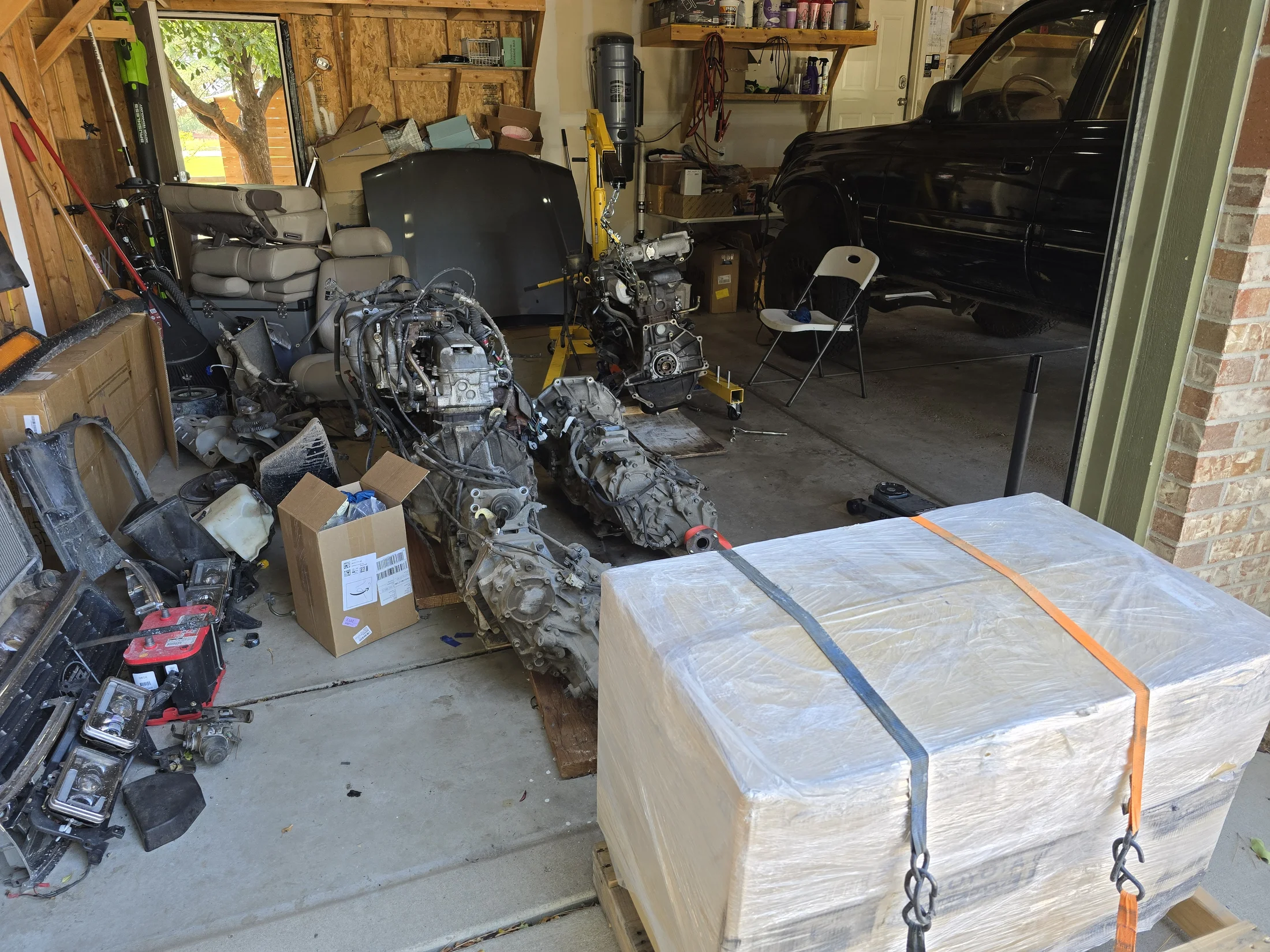

Awesome work! That pallet full of manual goodies has me jealous :flipoff2:
Is that an LHD 80 series manual console? The previous owner of my 1HD-FTE/H152 had hell finding one. I think he ended up buying a clapped out truck to get one just to 3-d scan for reproduction.
Sure is! I was surprised i got one as well! Lol.
