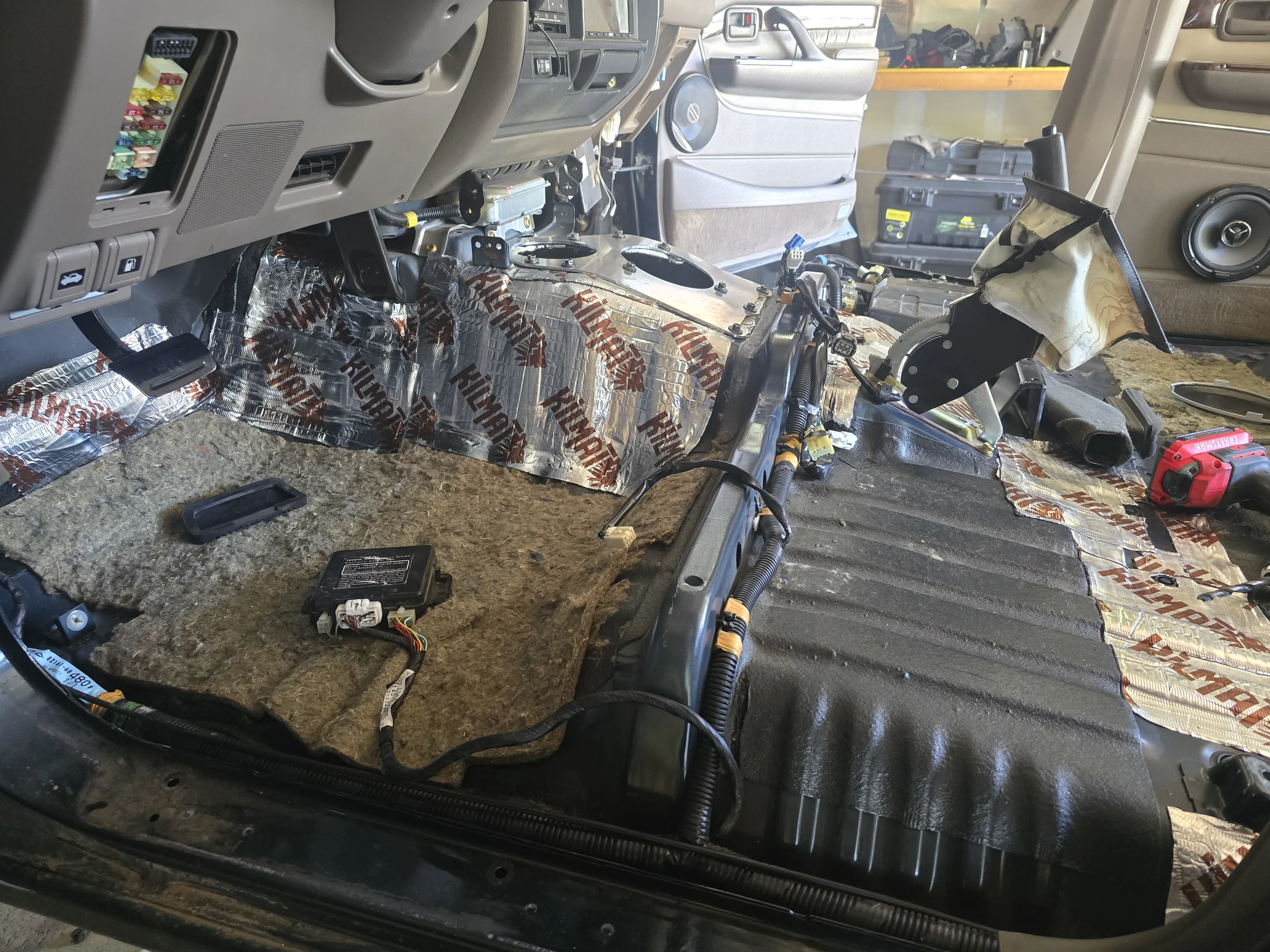

Had a few sheets of kilmat laying around, ordered a lot more, going to cover inside the doors and behind the plastics in the rear.

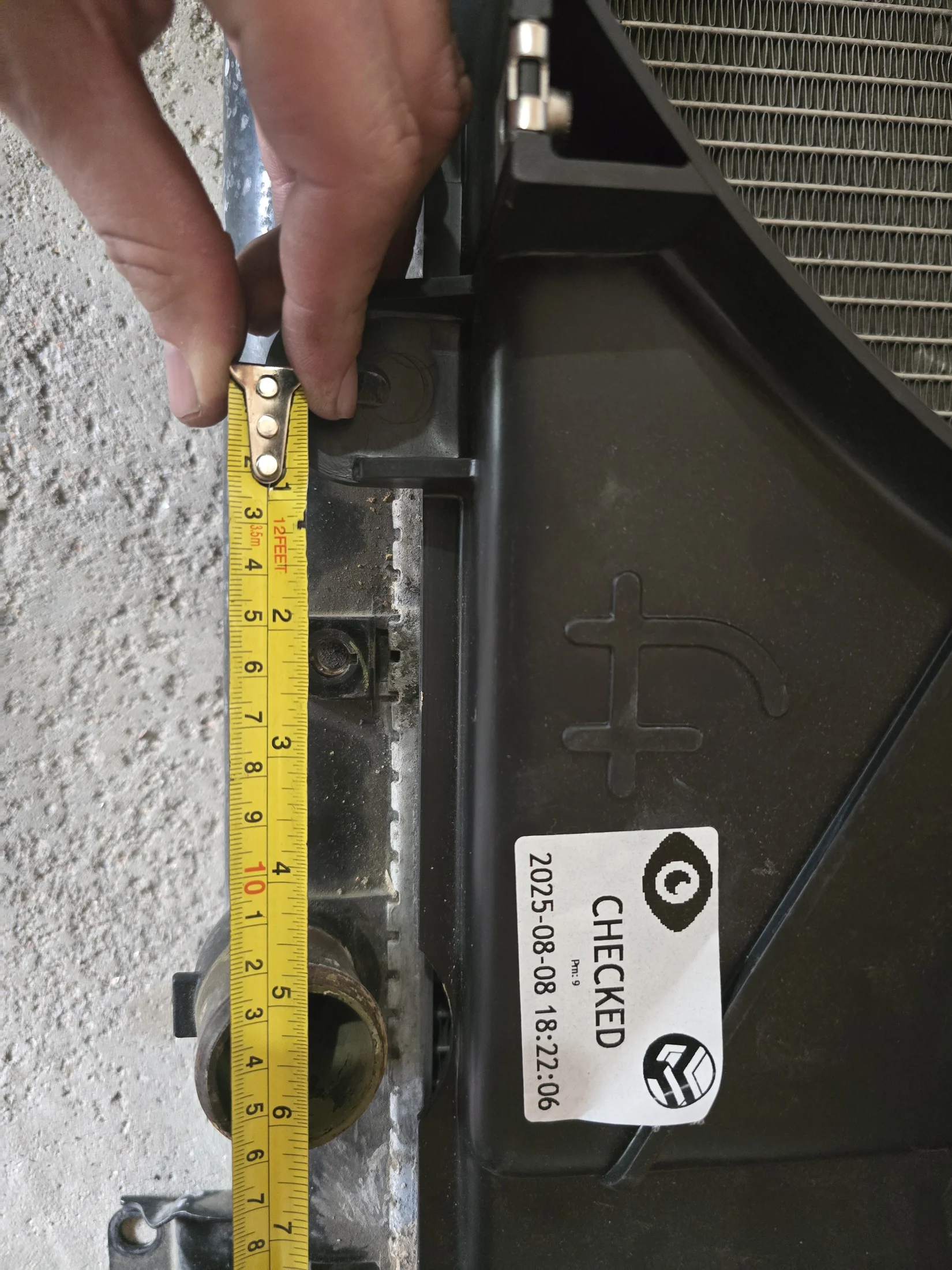

Hdj80 radiator, should be here today, friday the shroud should be here with radiator hoses.

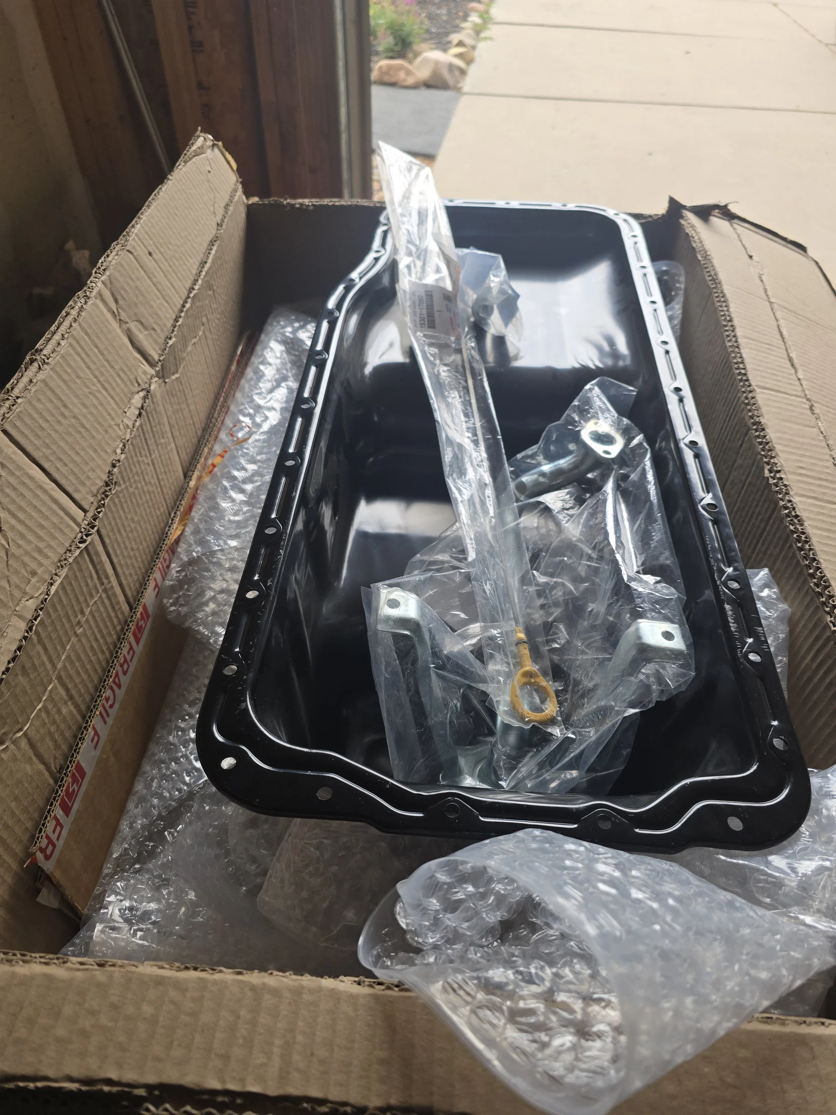

Oilpan, and dipstick should arrive fridag as well.

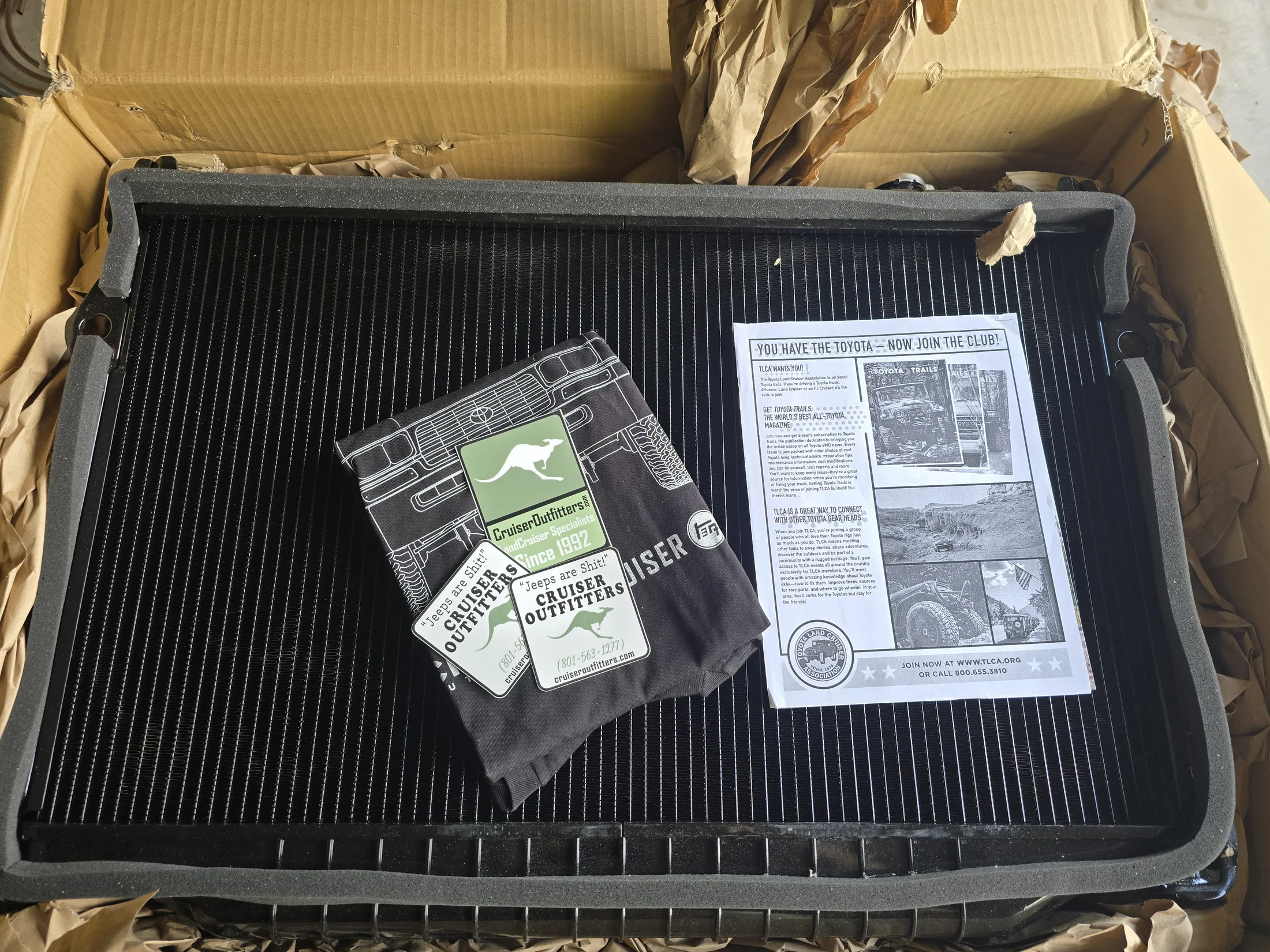

Oh yeah, the 16400-17020 is available from any Toyota dealership in 1 day. Weird, right?
Oh man, I got had on this one then. I did find the part while searching at my local dealership but didn't trust it because its diesel specific. Live and learn I reckon.
The free t-shirt lessons the sting 🤣🤣

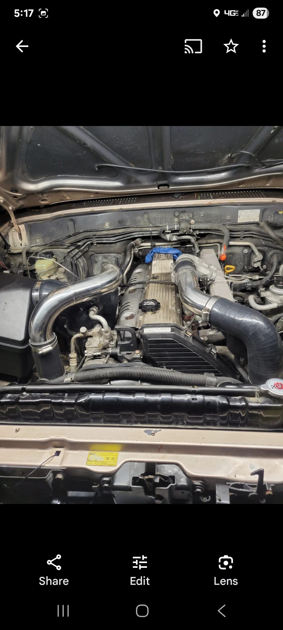

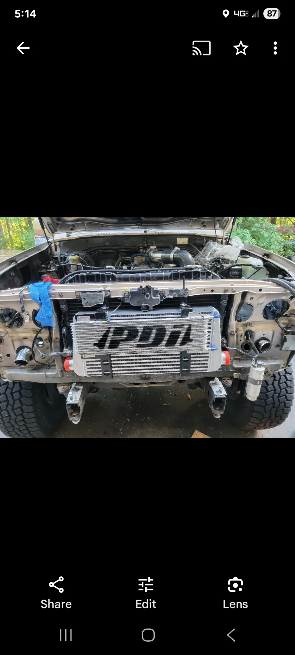

Just some install thoughts on your PDI intercooler. I put pinch molding around the holes you cut in the front apron. My silicone elbow that leads to the pipe before the intake manifold initially rubbed on my hood and against my power steering reservoir. Just things to watch for.
These are great references, what about the ac dryer and dryer lines? In every video it looks like a mess. Anything special you have to do to get the piping to fit around it?
Just some gentle bending, I also put some additional silicone hose cut pieces between dryer lines and intercooler pipe. But if you are not in a time crunch, relocating your dryer is probably best solution.

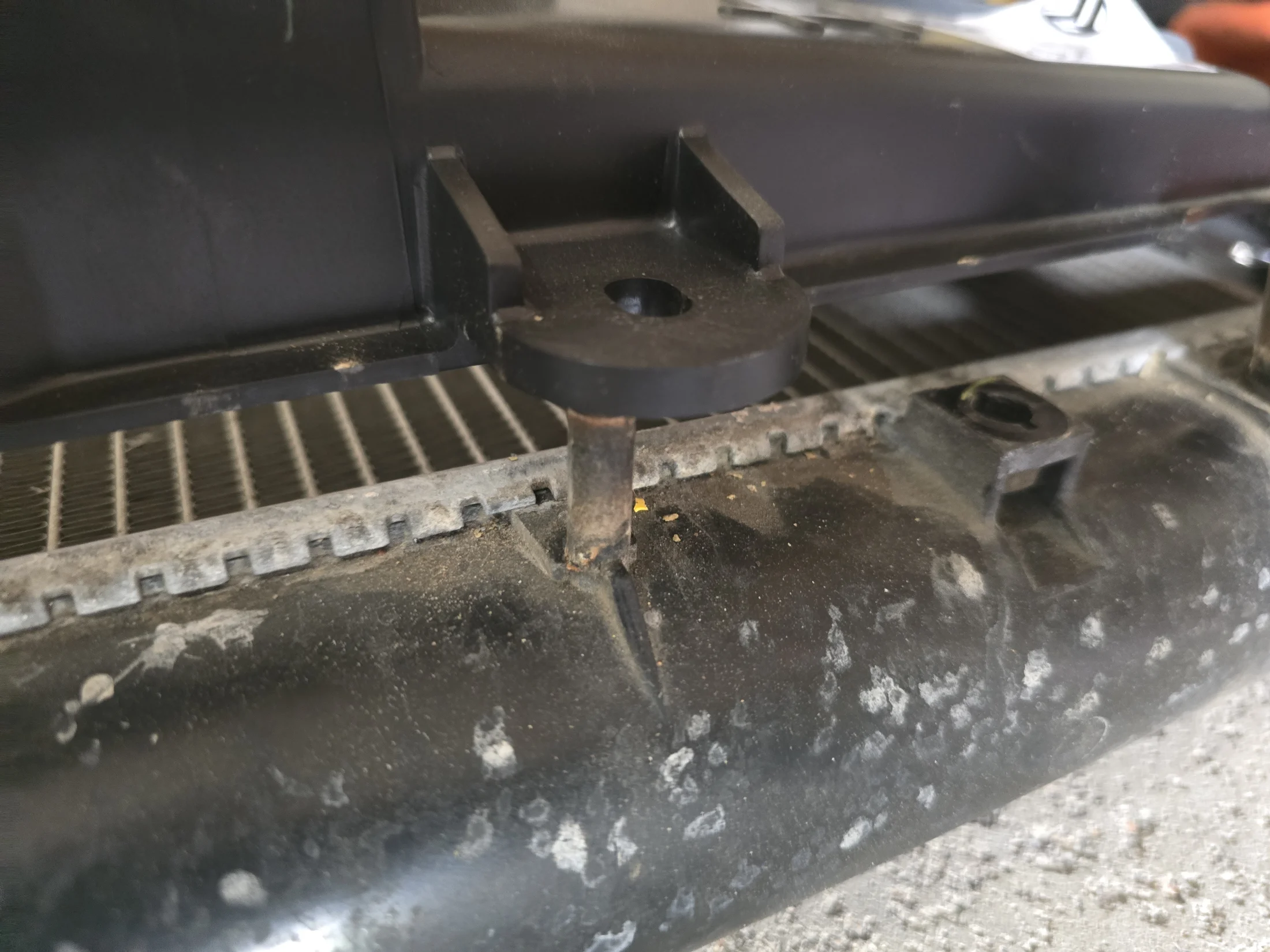

Hdj80, on fzj80 radiator, may give you an idea of what you'll be working with.

Great intel. HDJ80 shroud just arrived for me yesterday but I haven’t overlaid them yet.

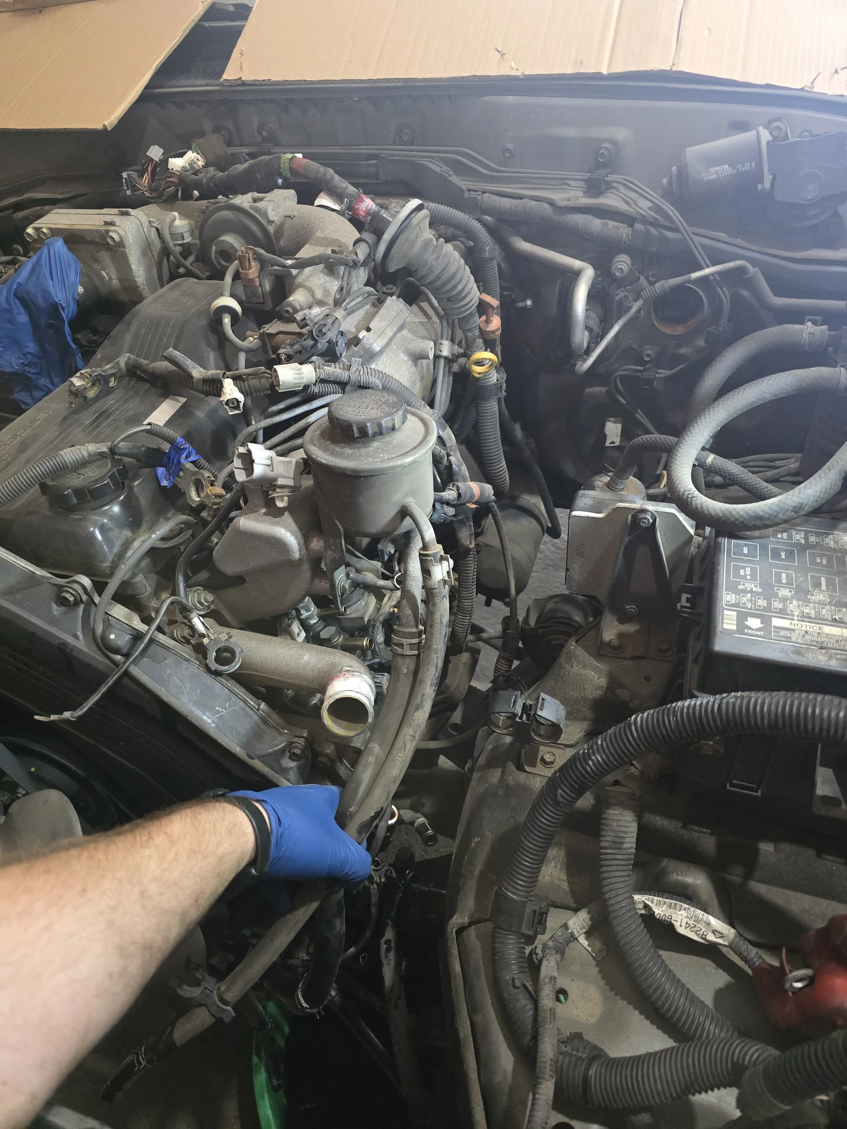

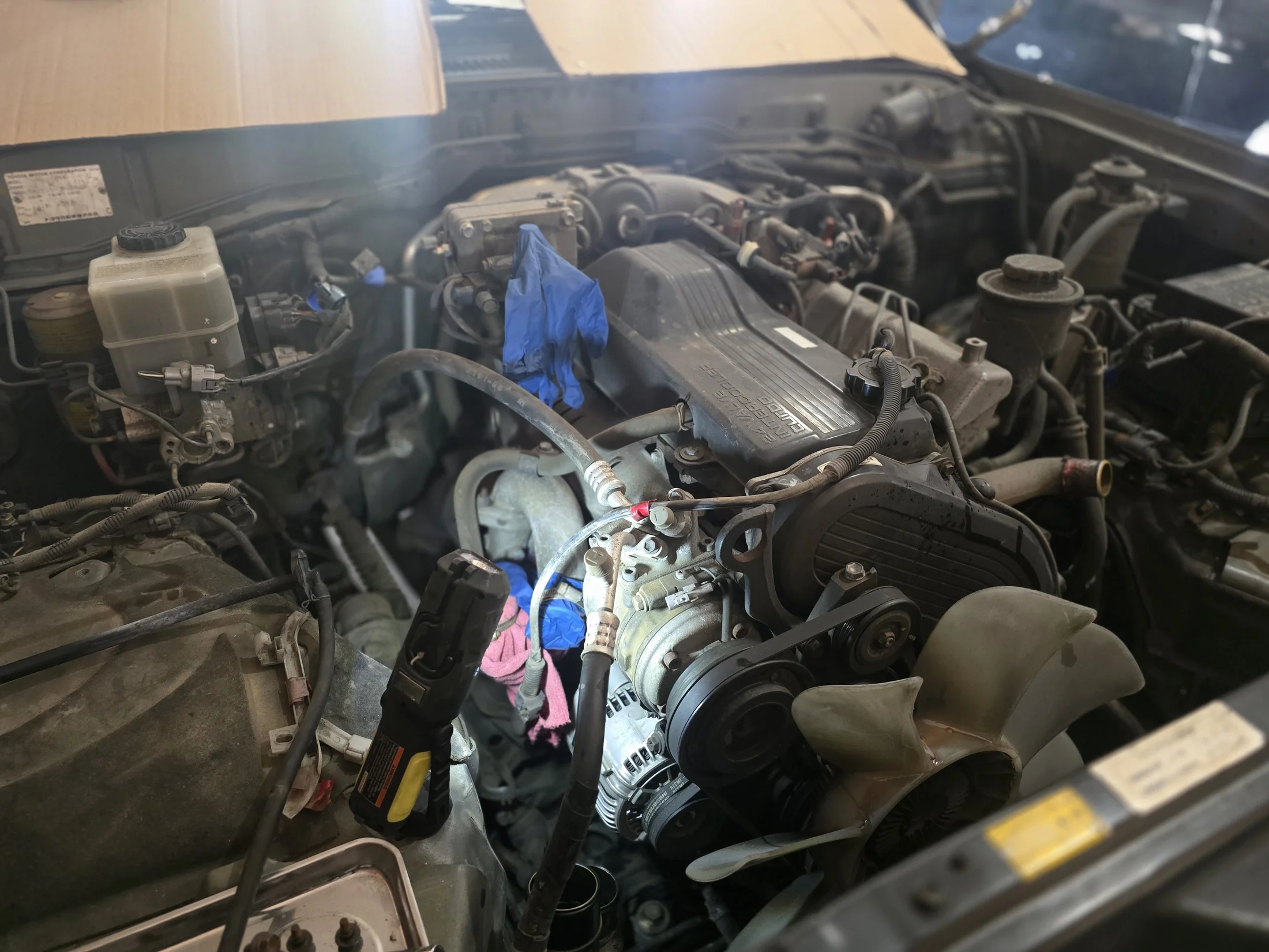

Everything is disconnected from the motor except exhaust, and AC. IM BEAT today.
Going to shoot for the rest tomorrow.
AC
Exhaust

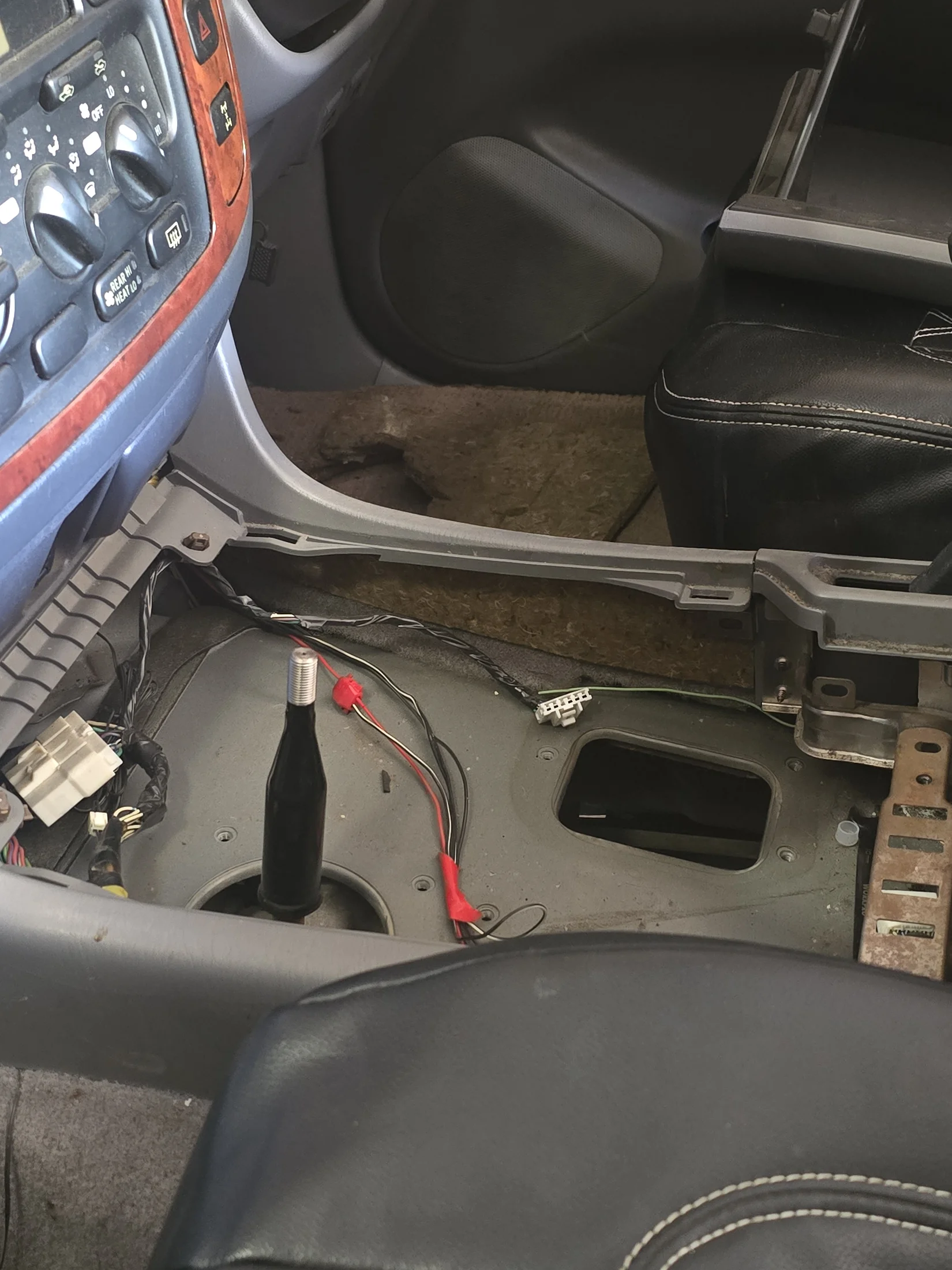

Shifter assembly
Drive lines.
Not following a TSM for this one, seems similar to a 1fz-fe pull tbh.
Booyah

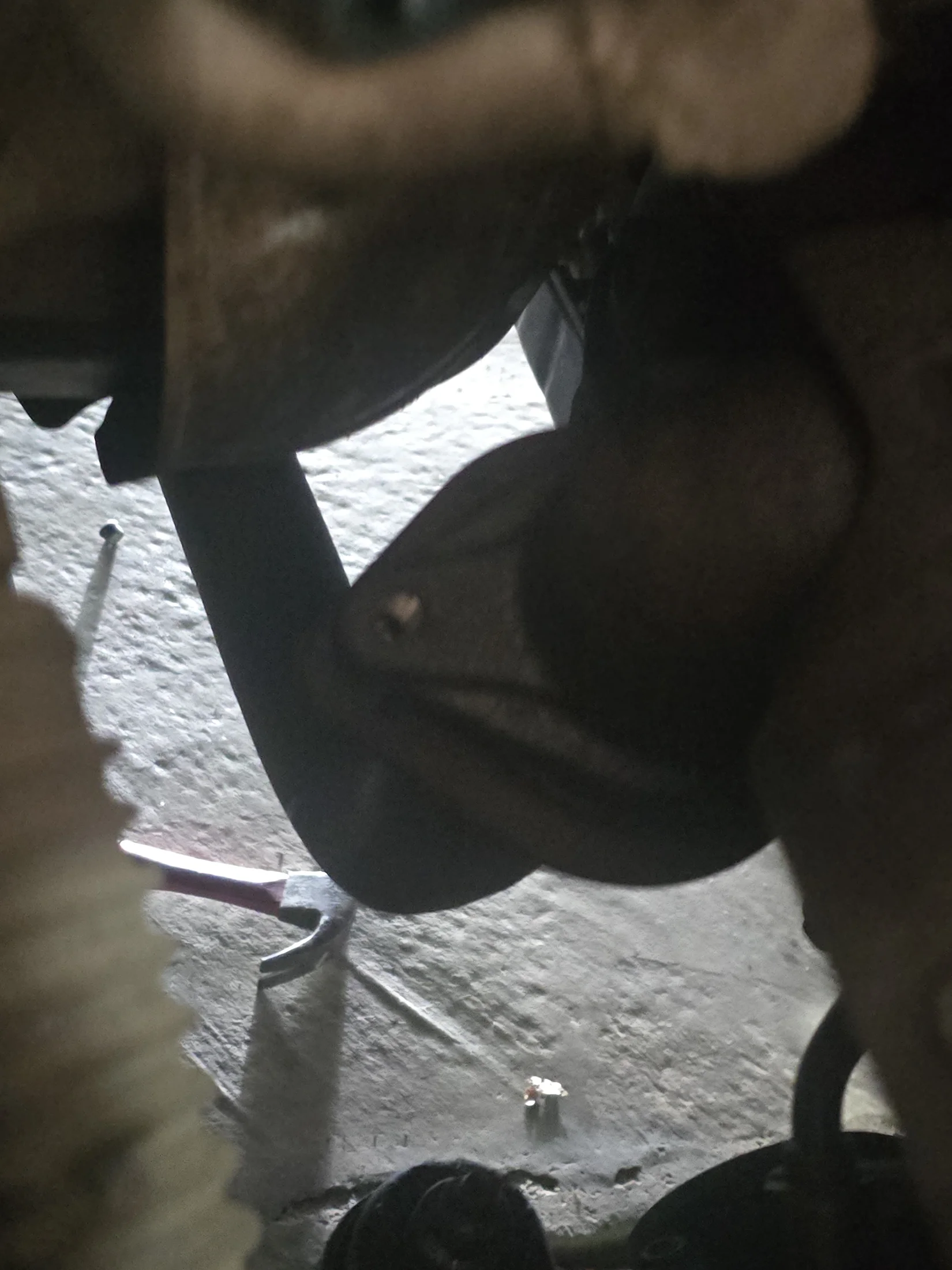

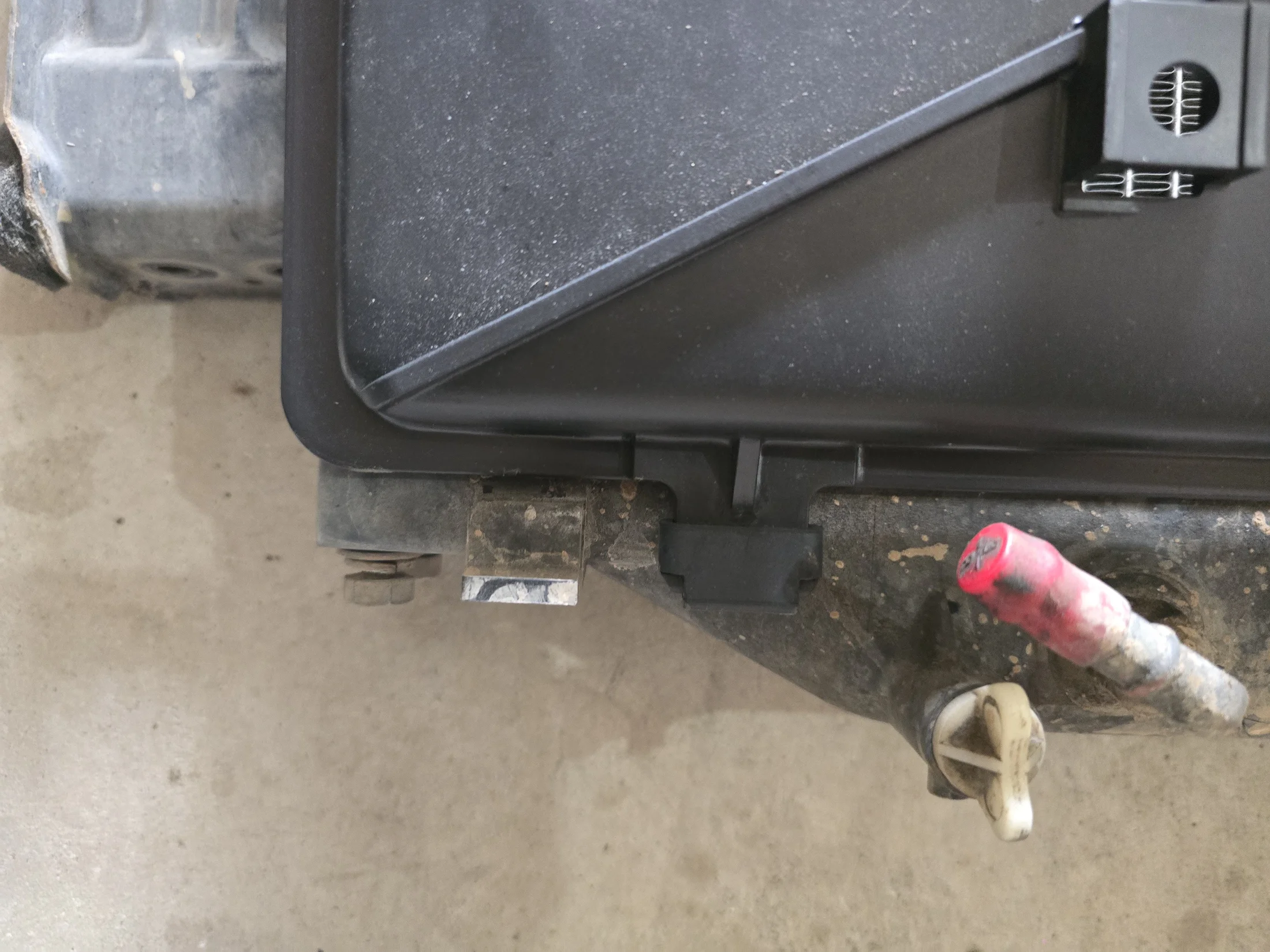

Transfer case shifter assembly is a bitch to get to, two bolts are nearly impossible, even from the top.
Ill probably have to drop the transfer case down a bit or just try and leave it and shimmy it out. Id rather take it off tbh.
This thing has almost zero leaks under it, i believe it may have a leak from the powersteering pump, but thats it, dry as a bone everywhere else.

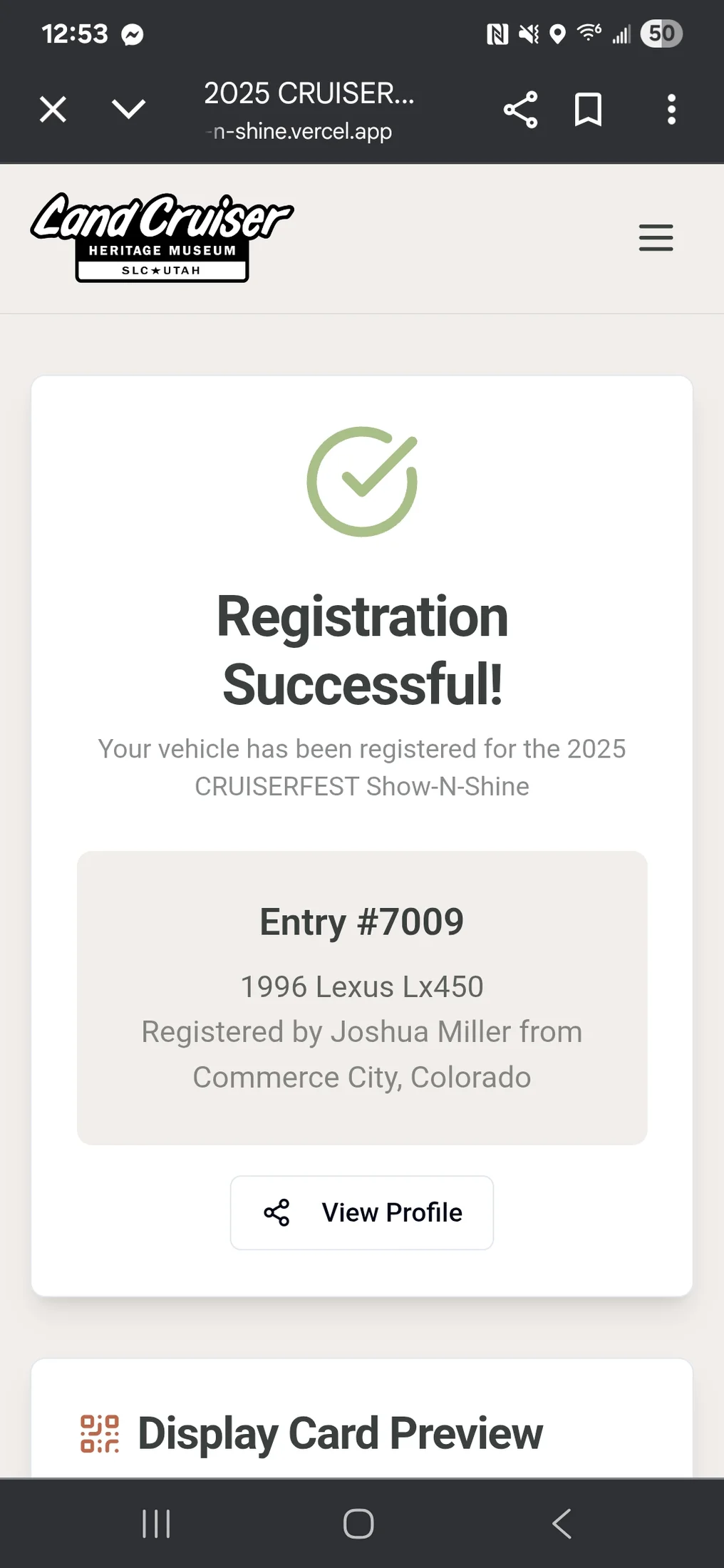

My newest goal, is i want to drive the LX450/FTE to cruiserfest September 5th/6th.
